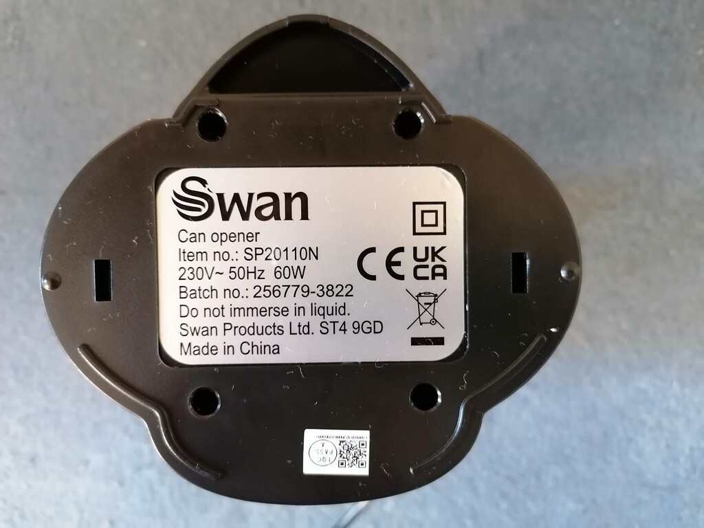

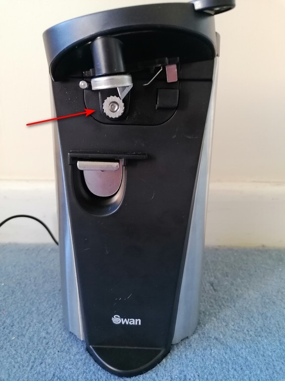

    I have this electric tin opener and the part that moves the can round (1st picture), doesn't move, I can hear the motor turning, but no movement, there's something rattling inside, so presume a piece of plastic has broken, or come loose.

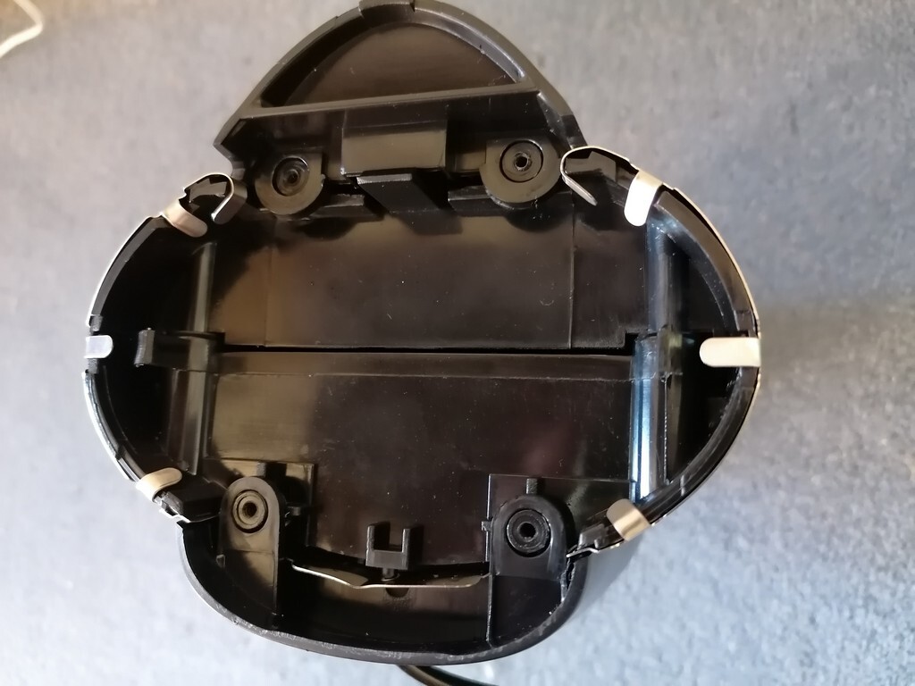

    Took the bottom plate off, but left with this (3rd picture), any ideas how to get inside?

    Maybe pry those metal tabs up and take these covers off. Could be that more screws are hidden there.

      I worked it out, the front and back plastic parts side off and are really tight (need a flat head screwdriver), then you can get the metal cover off (undo screws).
      Easy fix in the end.
