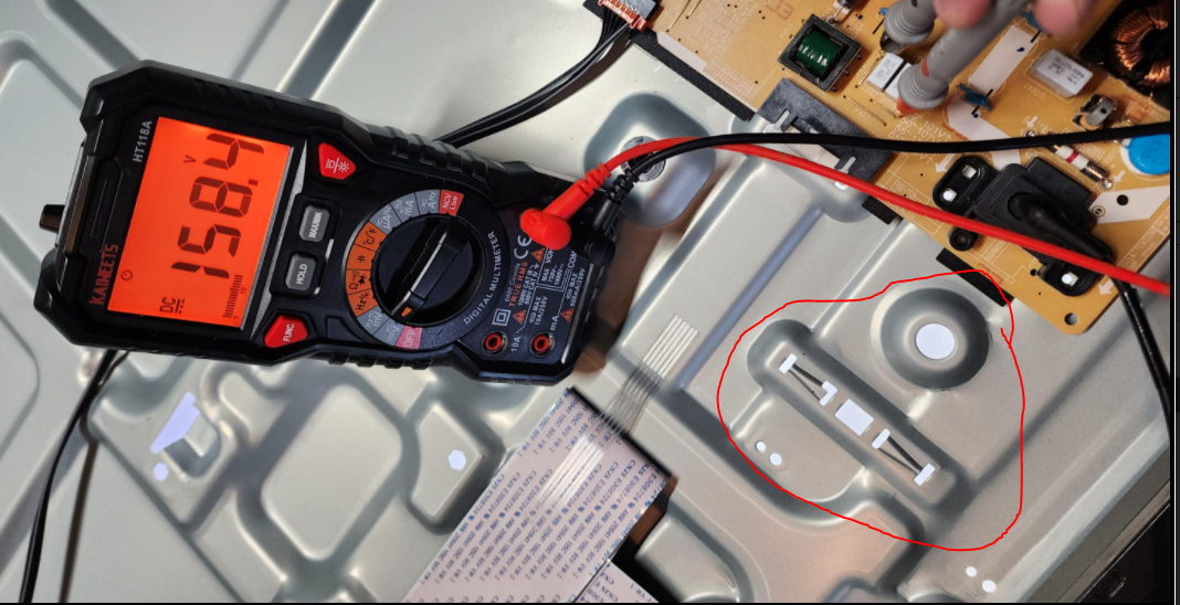

    But, through the holes you can see that the backlight is on, or so it seems to me.

      Re: UN65TU700DF picture and sound but no backlight. BL tests ok but repl. PSU didnt f
      Yes, this TV is put together correct and working properly now. Just showing working voltages and what led tester draws.
      This may help the OP
        Eazybone i think you are confusing more.. i don't know where your input can help the op, you had different symptom, no p. board self test done..
          TBH I don't know why this isn't already figured out. Samsung lights come on when you disconnect main from PSU. They light up. And if they don't it's the backlight or the PSU. He replaced the PSU, and he has image. I'm actually surprised it went further then this has. It's the backlights lol
            But why don't to come to conclusion after a test? Before dismantling a giant screen?
              Hopefully not taking this in wrong way lol but, isn't it confirmed? Two power supplies and literally everything else is working. He has an image and sound, so it's not panel or main board. He's getting two totally different voltage readings when testing the LEDs. There is only 2 strips one is reading 100 and one is reading 63. Mine both test evenly. At 150 which is all I was trying to show. If this is incorrect just disregard but I'm gonna follow and see what goes on here. I want to know the fix too!
              And in fact I have different tv and have just been unhelpful lol I'll stop here my bad

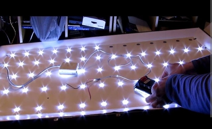

                                    Those 5 small strips connect to the 5 big strips essentially making 5 strips. 5 connections can't be split evenly so you will have a different voltage on each side. So no you shouldn't expect the same voltage if there is only 2 separate connectors coming from PSU. It should essentially look exactly like this picture. 5 rows with connections coming from one side only. And this picture is a great example because he also has a short in the LEDs. All light up except for that top right set. So it appears when using the LED tester that your lights are "fine" because you can't see them all. But the power supply knows there is an issue so it wouldn't light them up. And as RJ points out not enough amperage generally for the LED tester to cause the LED to fail. Mine has so far never failed me, but I have one that puts out 100ma.

                                      Originally posted by EazyBone
                                      this photo not Samsung TV BL right ? hisense !!!
