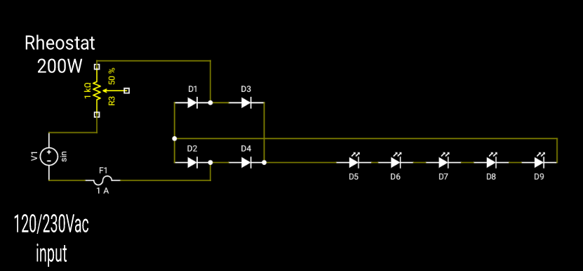

                    i will have to put this TV on hold for now... gonna order the stronger LED tester. wish someone would give me a recommendation which one to get though!
                    Don't fear the repair...
                    • nomoresonys
                      • Jan 2013
                      • 12370
                      • U.S.
                      #70
                      Re: UN65TU700DF picture and sound but no backlight. BL tests ok but repl. PSU didnt f
                      Looking at amazon and ebay, it seems that they are only going to 150 mA and 320v so any I guess one of those, they seem to be about 40-50 bucks or so.

                        You could make a simple cheap tester about 30$ with This
                        for input diodes you could use 4 1n4007 or an integrated one.. you could power until about 870mA Backlight.. if could be a problem you could limit inrush current with an NTC in series..
