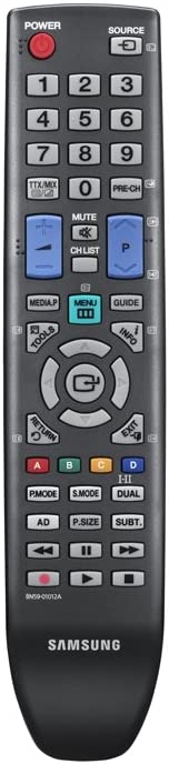

    I have this TV a small 20 inch that works perfectly except for the IR has stopped. I have confirmed that the remote control is fine and tried an alternative and even tried with IR blaster from phone. Remote 100% ok.
    Tried installing latest firmware but no change.
    TV won't respond to remote at all, not even to bring it out of standby. I have to use the touch sensitive front panel to operate, at which point TV is usable albeit with no remote.
    Tried replacing the IR receiver diode/bulb on front panel and no change so put the old one back. After tracing the circuit a little I found that the SIGNAL line of the IR receiver board (and bulb) is always LOW (less than half a volt). I think i'm right in thinking that this line should be 3.3v all the time until you press a button on the remote. At least this is how it's always worked when i've played with IR on an Arduino!
    Traced the line further onto mainboard and it goes into a WELTREND IC (microcontroller?). No bad SMD caps or open resistors. Seems like issue with WELTREND IC? Incidentally, the other lines on the IR receiver (GND and 3.3V) are present. I measured the SIGNAL line with Oscilloscope while pressing remote and could see a square wave IR code but extremely low voltage (like half a volt or less). So seems like the issue is with the voltage being pulled down on the signal from sub micom?
    I'm not sure if doing a standard USB firmware update would also update the sub micom, maybe someone can confirm? If it does then perhaps the IC itself is bad because I initially thought it might be corrupted. I seem to recall having a Samsung one time that needed to have the sub micom chip reflashed to fix this kind of issue. Wondering if anyone has experienced this or even has a copy of the firmware for this IC? or any advice in general?
    Many thanks,
    James.

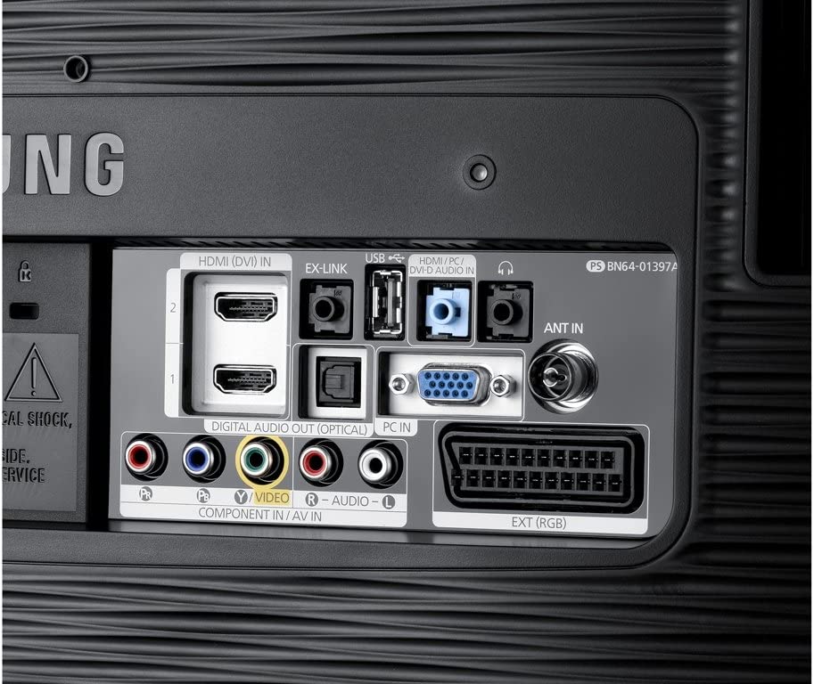

    Re: Samsung B2030HD IR Remote Receiver Dead, shorted micom?
    are you sure its a tv? that model number refers to a pc monitor.
        Samsung B2030HD
          thanks lotus, ant in right there, clears that up its a tv.

                Signal line is still low even when IR board is removed so guessing its not the ir board itself?
                Thinking more along the micom firmware but can't find any, hunted high and low. Maybe someone here has a copy?
                Remote is 100% good, tried with phone IR blaster too and confirmed with camera.
                James.
