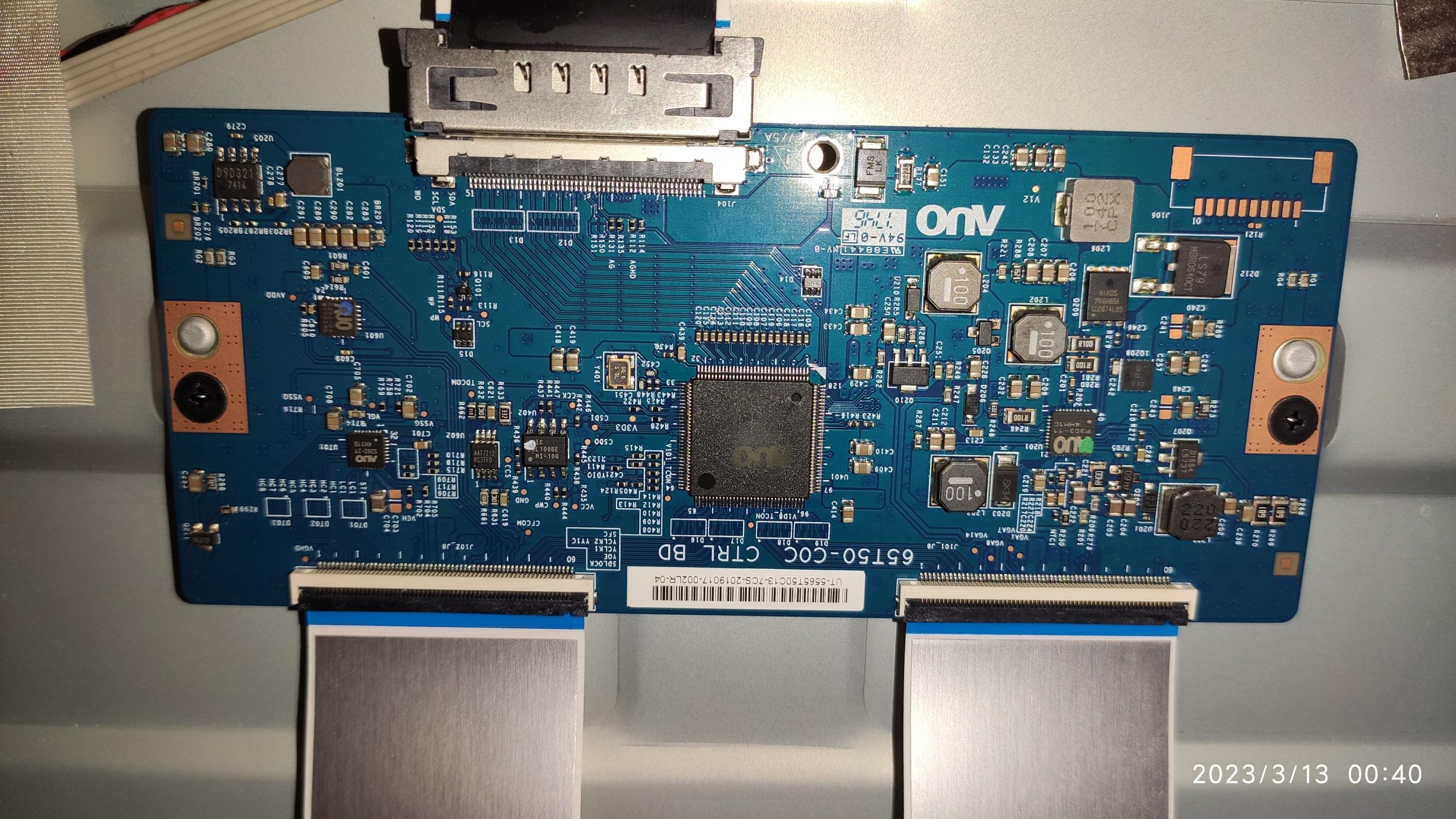

    Is the Main board broken or is the T-Con board broken ??

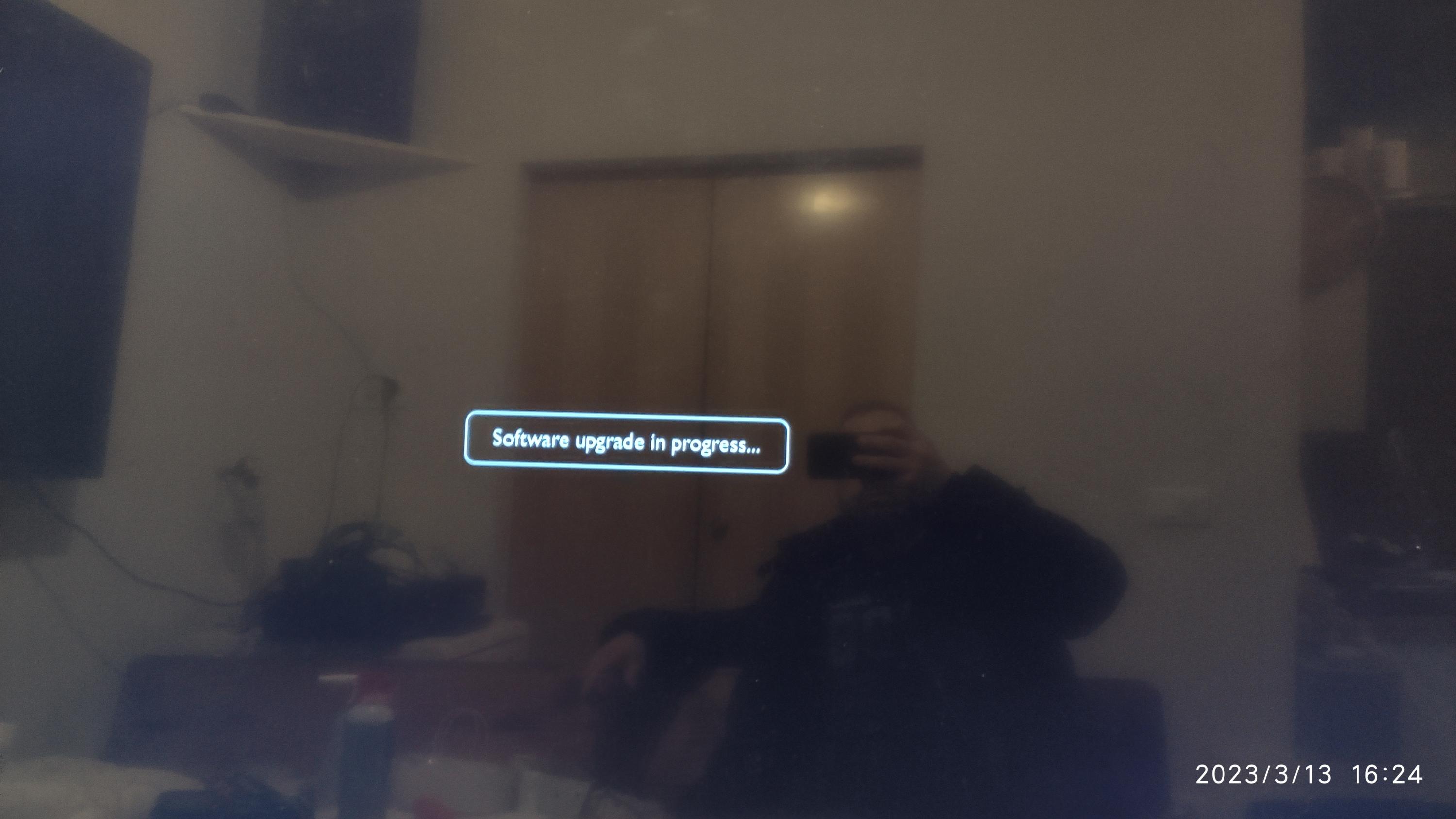

    Try the reset with the .pkg file that you can find here This upgrade loader resets the EMMC and installs it like new. After upgrading check if all options etc. are still good.

          Re: Philips 65PUS6262/12 Graphic Problem Help
          managed to do the software update that you told me. but to no avail... of course it's all the same

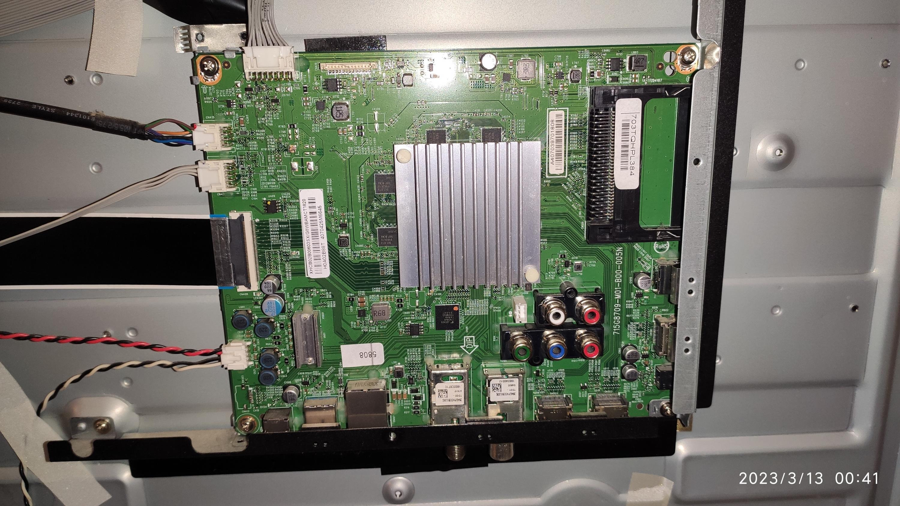

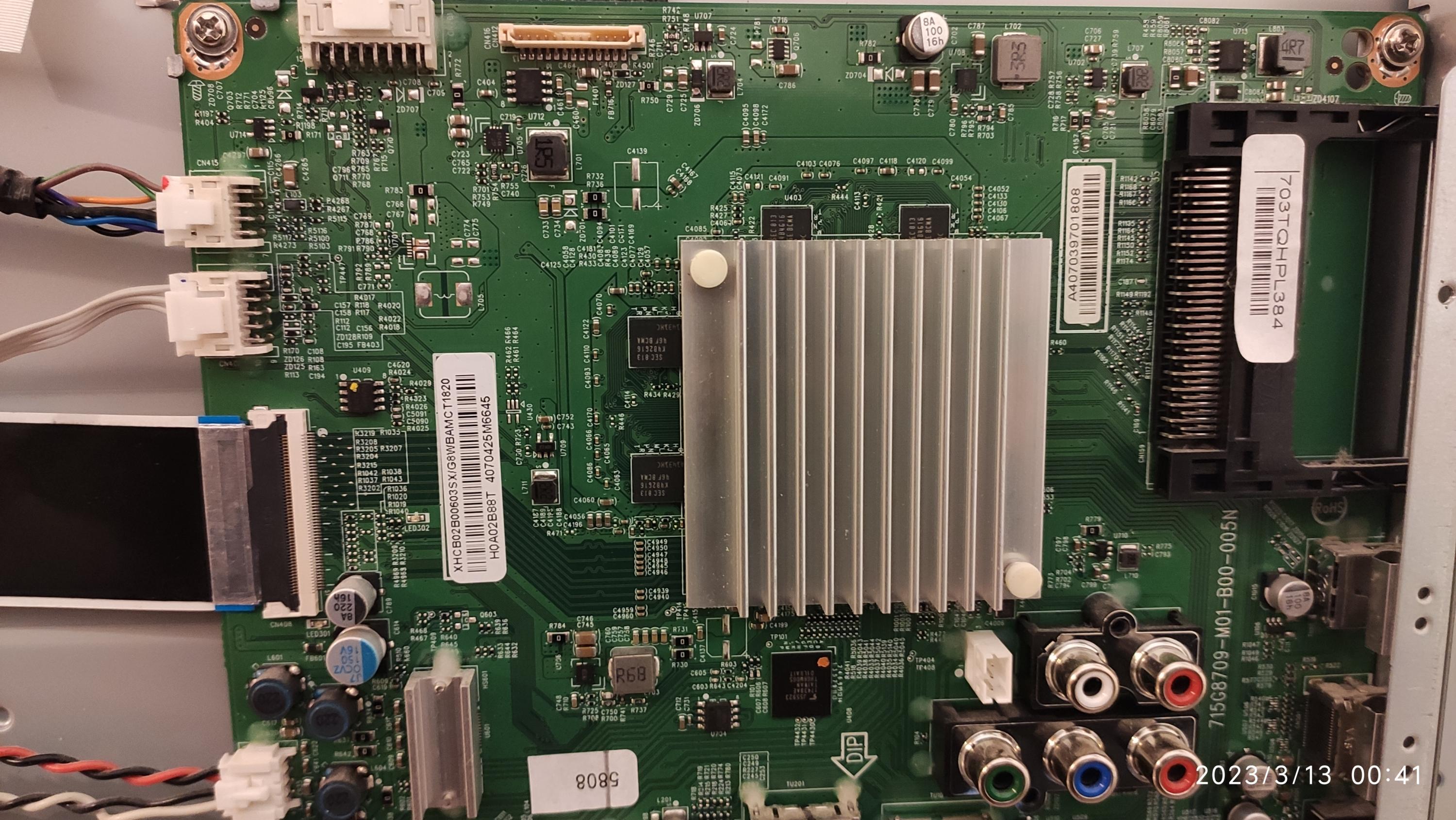

            My guess is a broken mainboard, a reset would be the cheapest solution. Little chance the t-con is the problem. Difficult to pinpoint , I have a tool for that but probably you don't.

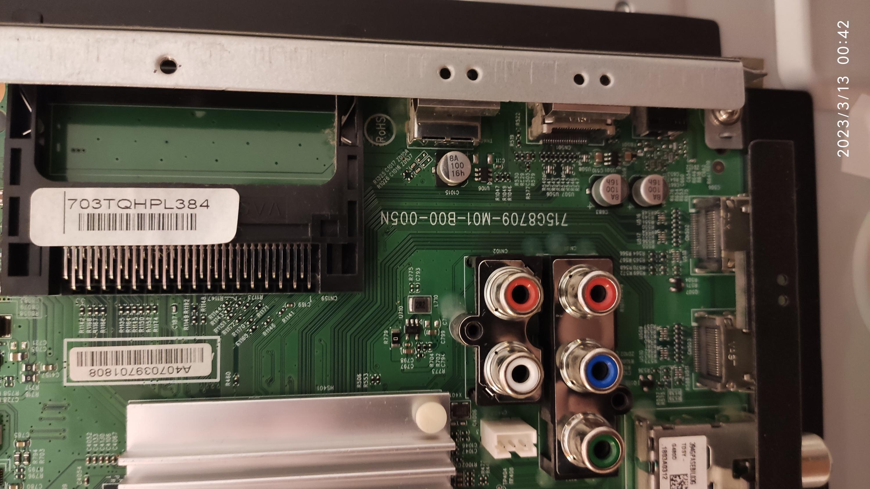

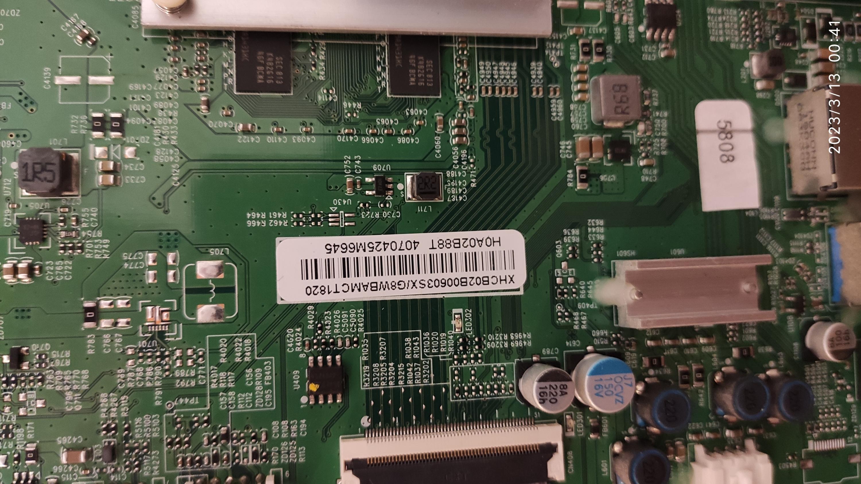

              what tool do i need?? I have a multimeter and I also have an ESR meter
              can you give me some advice on how to check if the motherboard is broken?
              Look picture. .. it is possibile to buy mainboard for model 55PUS6262/12 ?? It is compatibile?

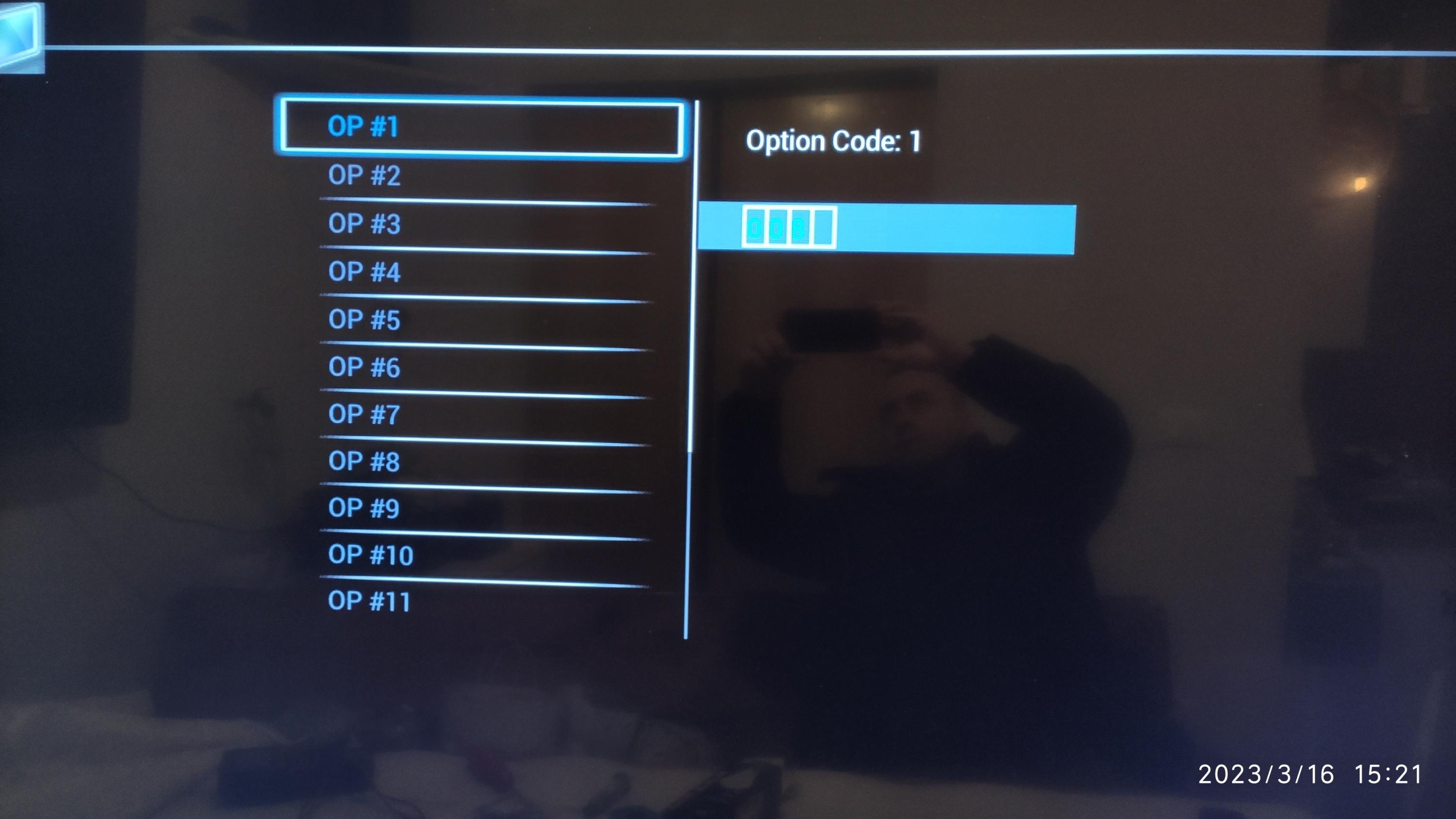

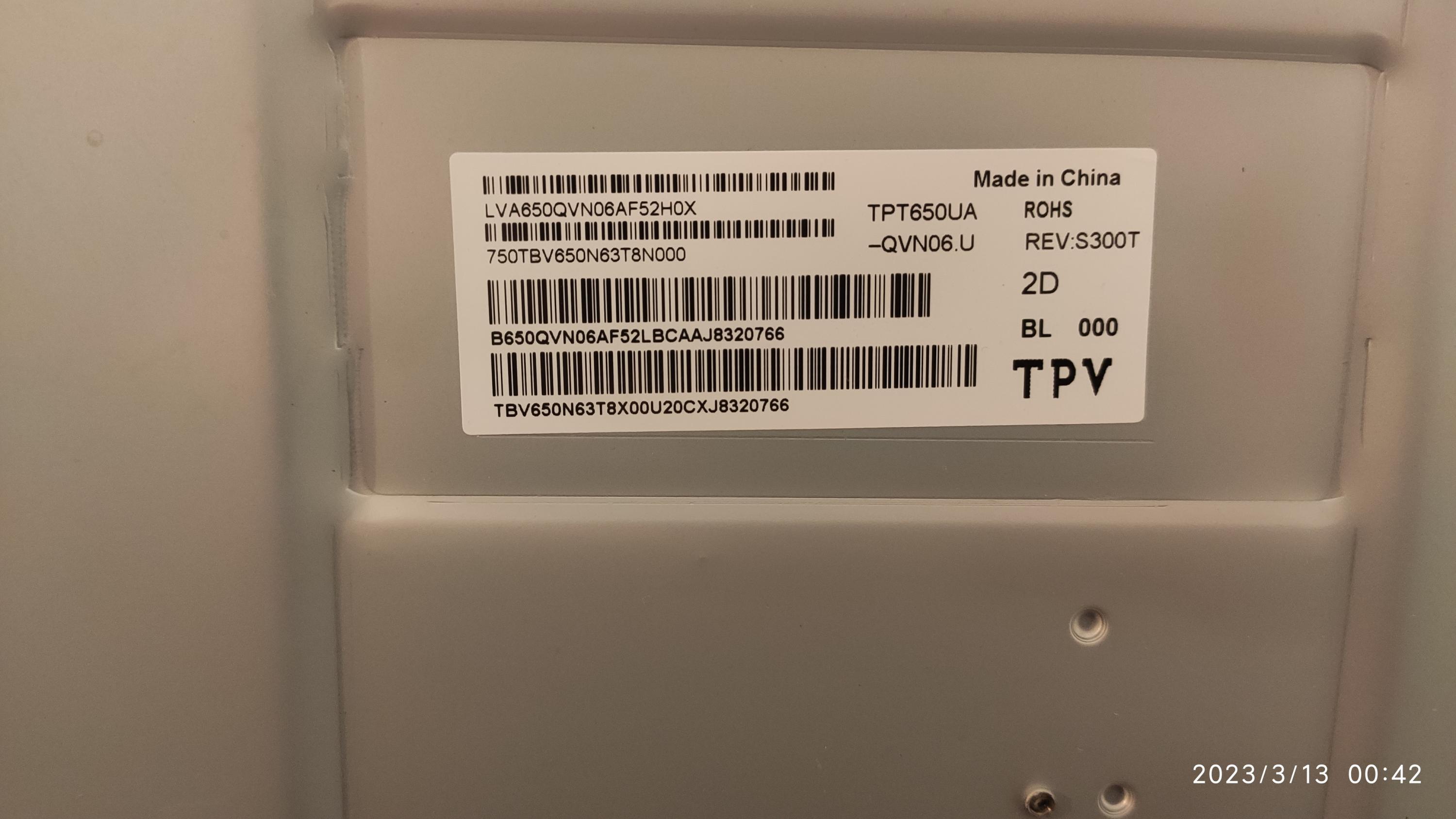

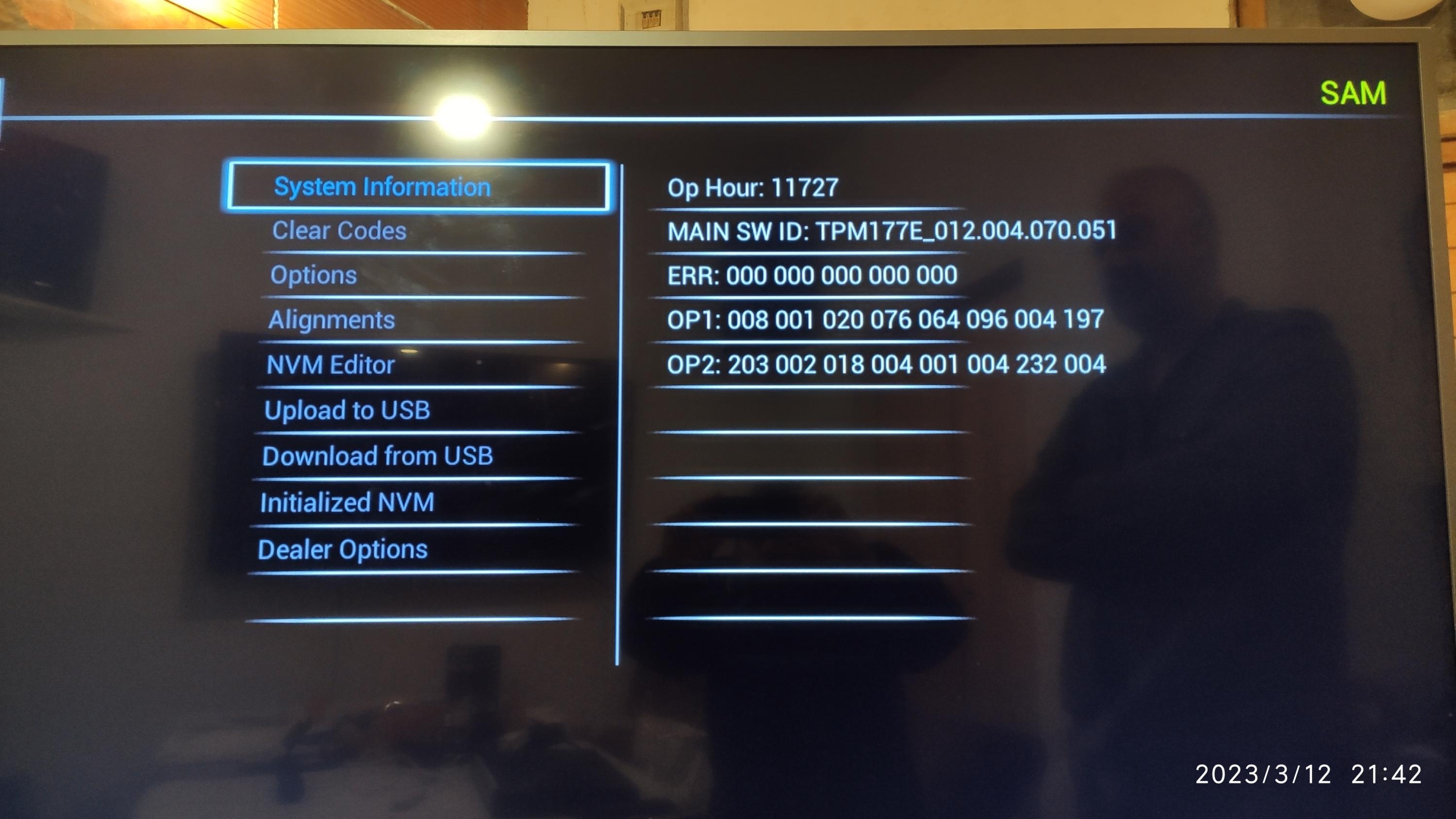

                  Try the following:
                  5.3 Set Option Code
                  Press the following key sequence on a standard RC transmitter: “062598” directly followed by MENU and “xxx”, where “xxx” is a 3 digit decimal value
                  of the panel type: see column “Set Option Code” in below tab. After resetting the Display Code, restart the set immediately.
                  The Option Code is a 3 digit found on the back plate STICKER of the TV
                  #Example : OPTION CODE 102
                  Good luck
                    Originally posted by alltvrepairs
                    Try the following:
                    5.3 Set Option Code
                    Good luck

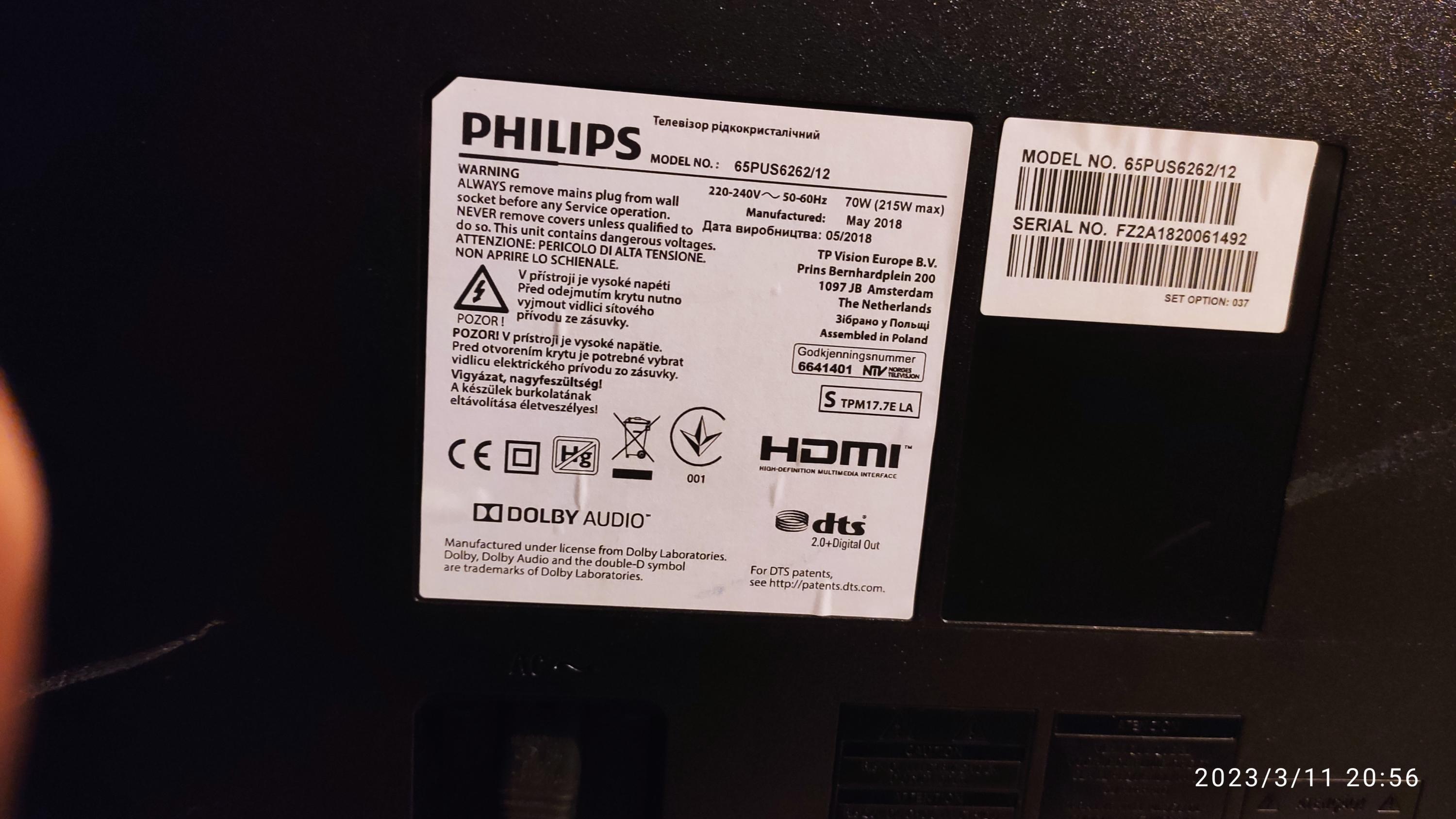

                    in my case which is the code ??
                    here is a picture.
                    • nomoresonys
                      • Jan 2013
                      • 12145
                      • U.S.
                      Looks like 037.
                        this is this menu.. hmm, I'm looking for where it says xxx
                        • alltvrepairs
                          • Jan 2014
                          • 219
                          • Malta
                          I would exit SAM .
                          Press the following key sequence on a standard RC transmitter: “062598” directly followed by MENU and “037”
                          • markolino
                            • Mar 2020
                            • 108
                            • Slovenia
                            Wherr imput????
                            • markolino
                              • Mar 2020
                              • 108
                              • Slovenia
                              aaa, here, I figured out how. the tv turns off after your combination.
                              but without success. I turn it back on and nothing
                              of course it remains the same
                              • markolino
                                • Mar 2020
                                • 108
                                • Slovenia
                                this topic can be closed.
                                I bought another main board and solved the problem
                                thank you for your help

                                  i would love to know if the board you bought for your 65 inch tv
                                  was replaced with board from 55inch model?
                                  ive been searching for 715G 8709 M0E B00 005N
                                  for my 65 inch :65pus6162/05
                                  i have seen same board number but from 55inch version for sale
                                  but thaught it was not compatible ,due to screen size
                                  im hoping perhaps it is

                                    no unfortunately for you I got the main board from the same TV model 65PUS6262/12
                                    but I think that it could also make plates from the 55 inch model as long as it has the same model code.
