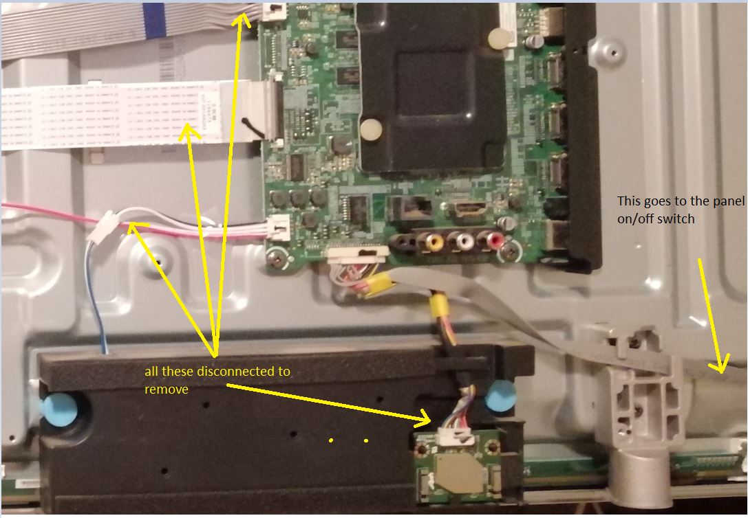

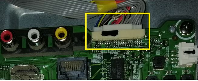

      Re: Hisense 50P6
      Thanks Diah,
      I am unfamiliar with how to open up that part.
      Here is a photo of it again, if you could please advise me of how that cover comes off>
      EDIT
      Sorry, I have remove all (bar one) of the screws and ribbons that connect to the MB, but I cannot seem to work out how to remove the lead inside the yellow square? It does not seem to want to pull straight out, even with force...is there a special way it releases please? Obviously I do not wish to damage it.
      Sorry...

        Re: Hisense 50P6
        it sound this socket had burned inside if it didn't plugged out.
        try to disconnect the wifi module socket at the module side, and unplug the speaker socket at MB and turn on the tv.. see if there are any different at screen. ( all other sockets LVDS should be in place ) and all boards screwed to chassis as original,
        • viewerau
          • May 2020
          • 305
          Re: Hisense 50P6
          ok...
          I reconnected everything back together as it was originally, turned on the panel, and it was back to how it was with the vertical stripes.
          I still cannot get that adaptor out, so I disconnected the the wifi board, undid the speaker cable, and also had to remove the on/off power switch to do so, all other cables and screws out...it is now loose on my bench.
          Now to work out how to remove the processor cover?
          Thanks for sticking with me.

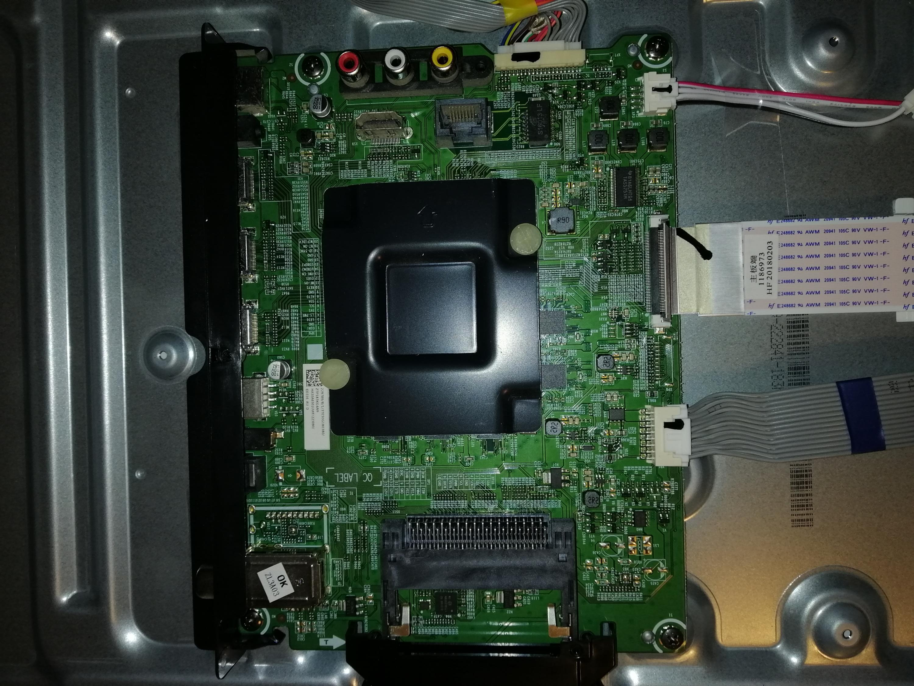

          • Diah
            • Feb 2013
            • 6357
            Re: Hisense 50P6

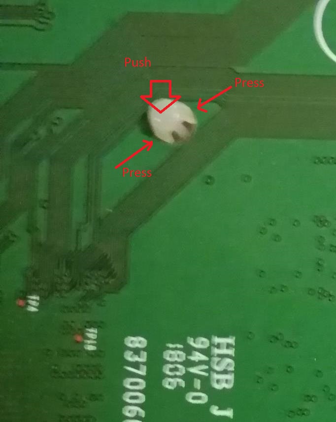

            screw out the MB from it place. and from downside you will be able to see 2 white clips which hold the heat sing
            the purpose of this remove i need to know which kind of cpu build in this set MTK !!
            if you feel ur self not sure.. try to find replacement MB
            • viewerau
              • May 2020
              • 305

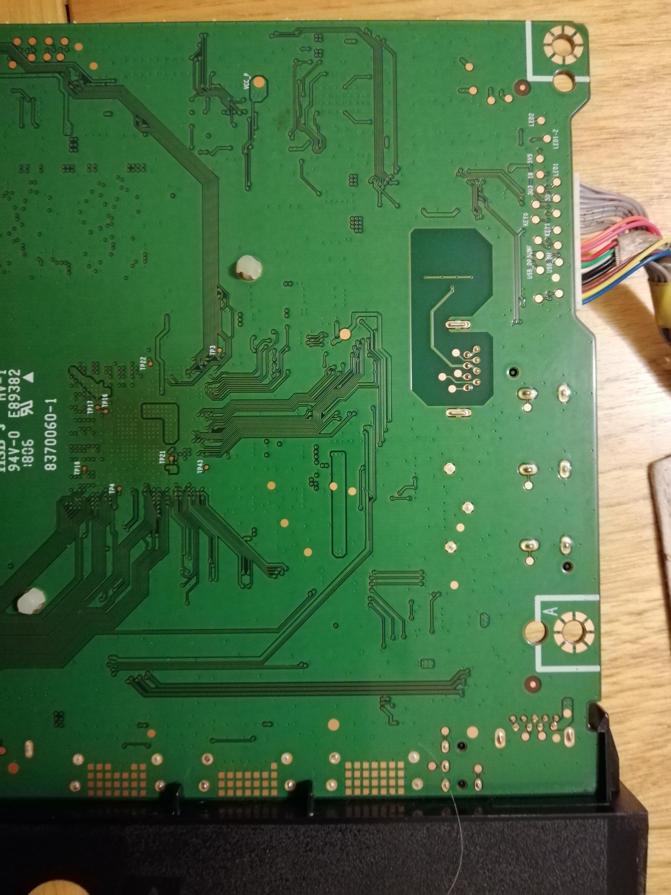

              Re: Hisense 50P6

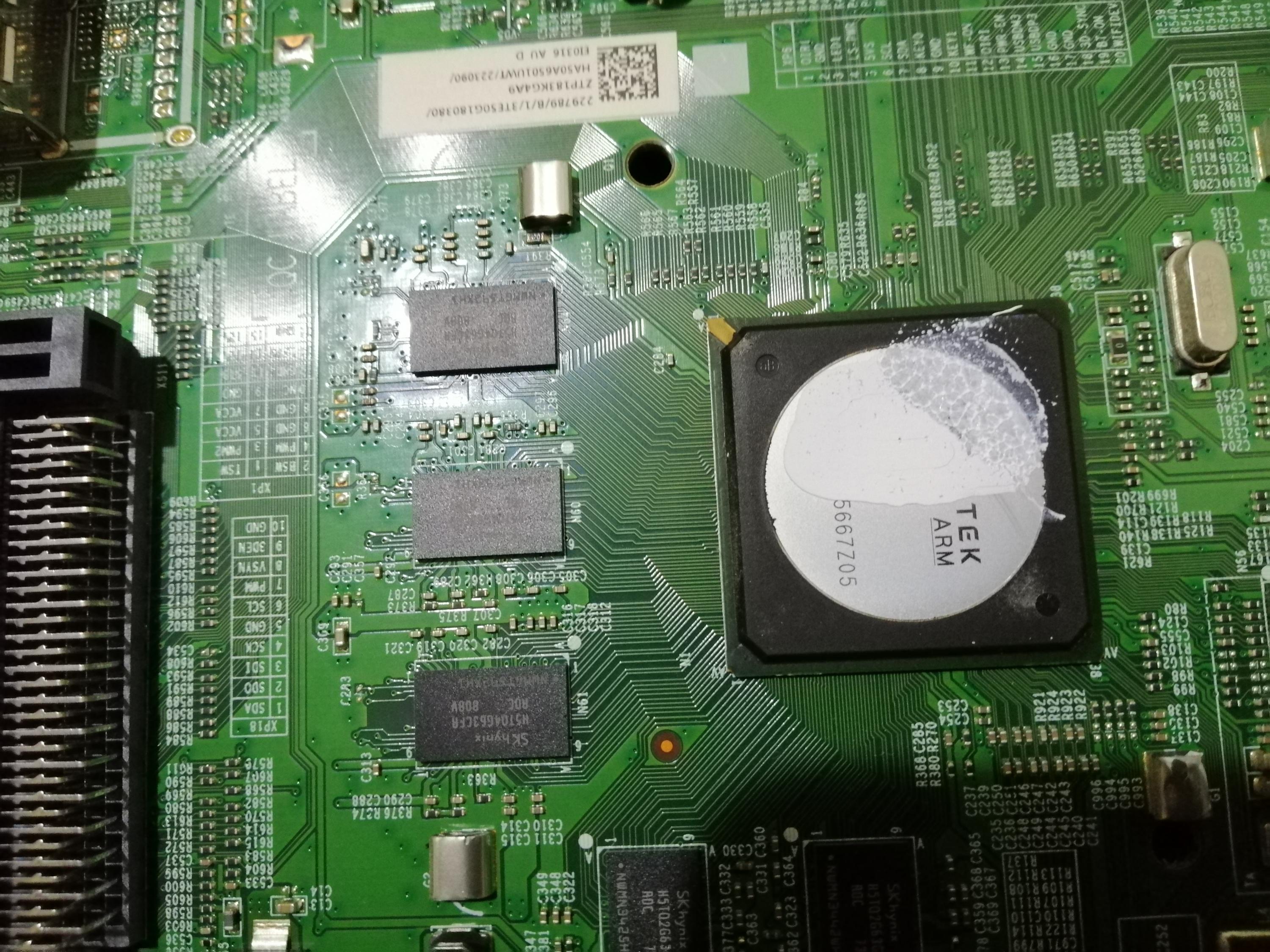

              Here are some closeups I tried to do with my phone camera.
              Signature:Seemingly hopeless tv fixer

                It's the little white thingies sticking out, just use a needle nose or small pliers to squeeze them for removal, look closely at them and you can tell which way to squeeze them.

                  Re: Hisense 50P6

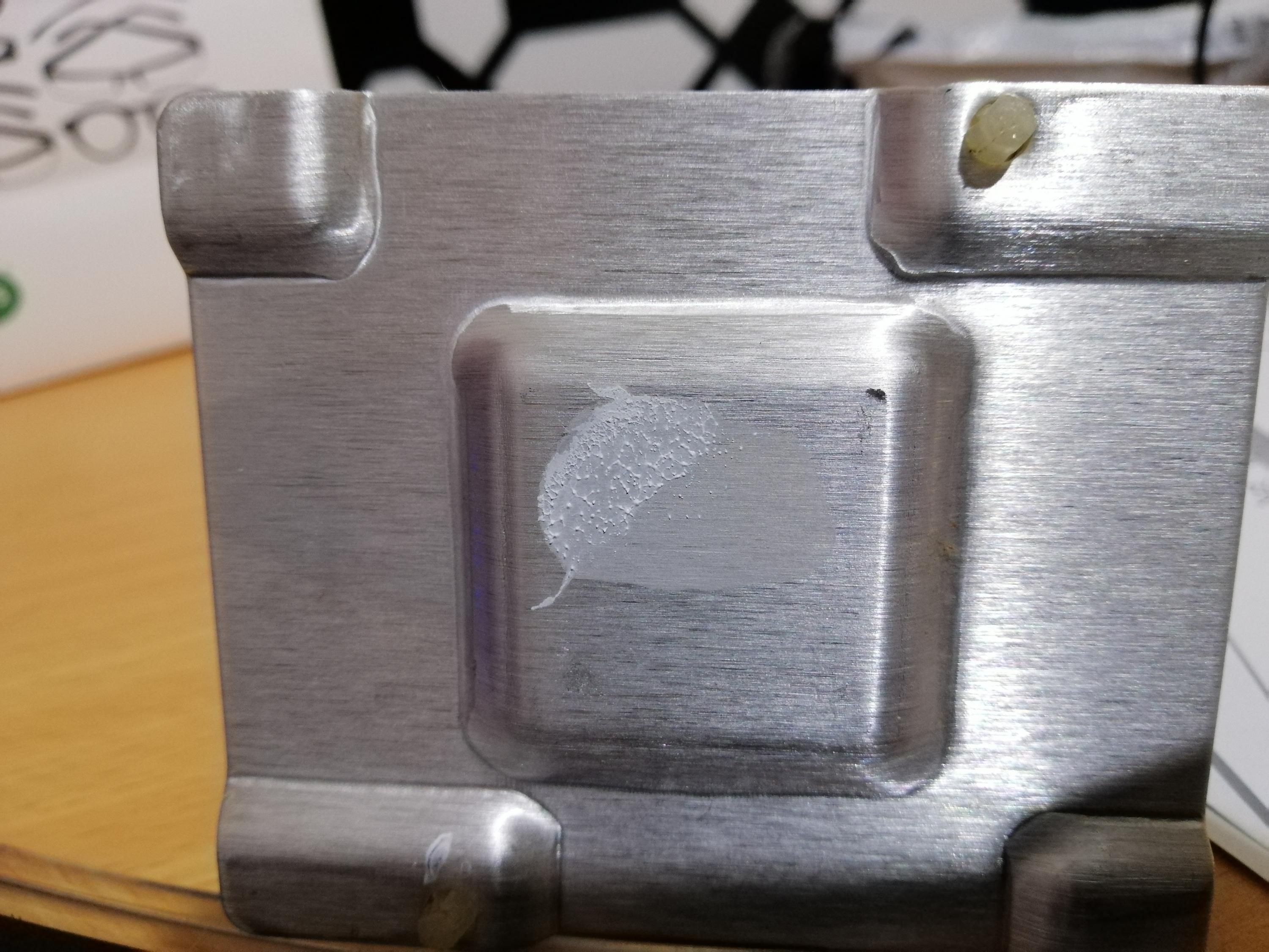

                  okay... the CPU area from downside had color change because of heating... its much now there BGA issue at CPU in case T-CON 12V correct at MB
                  press the clips from both side and push it down it will release from the heat sink do the same to other one and take out the heat sink and show the CPU label after you clean it.

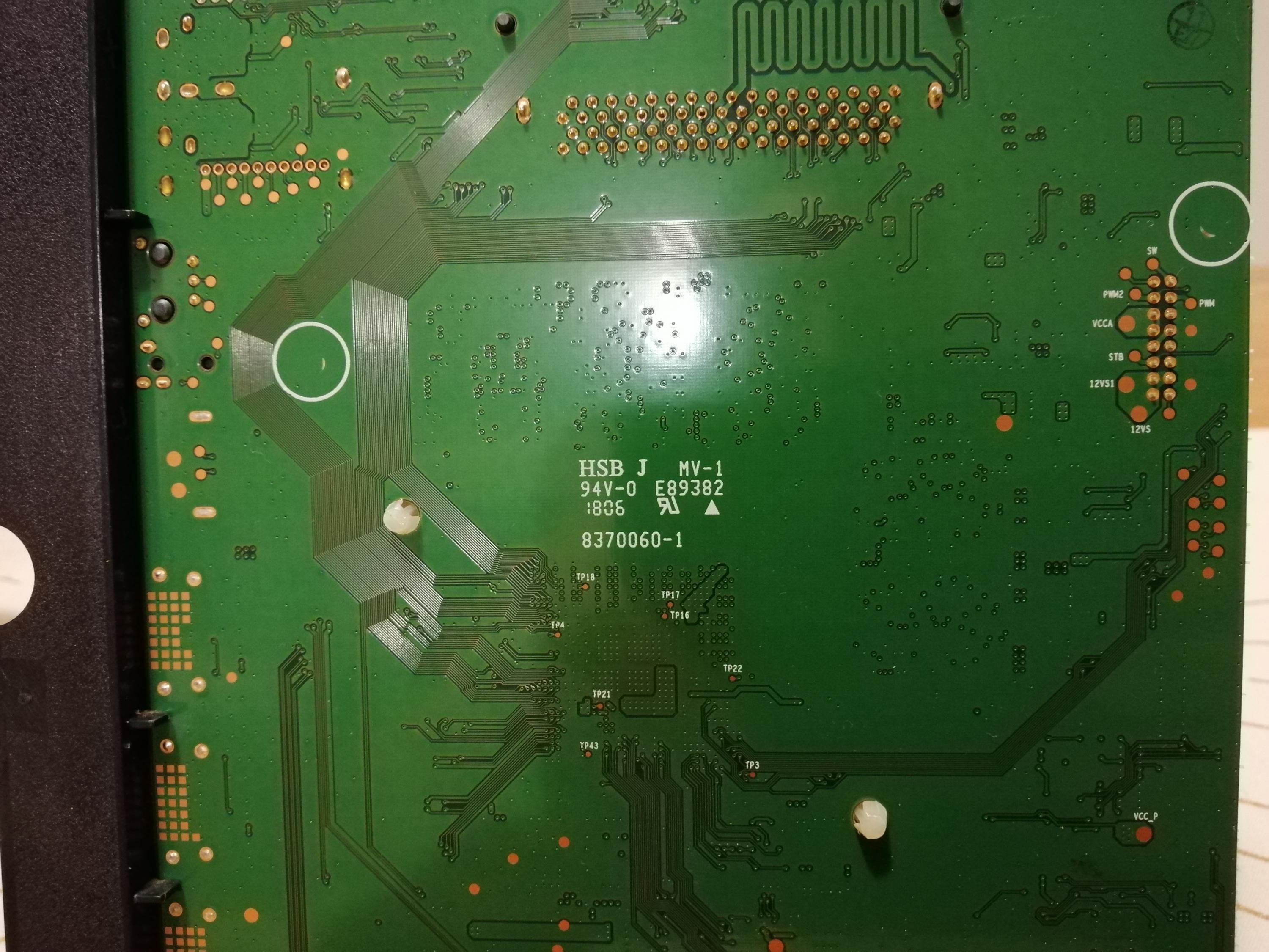

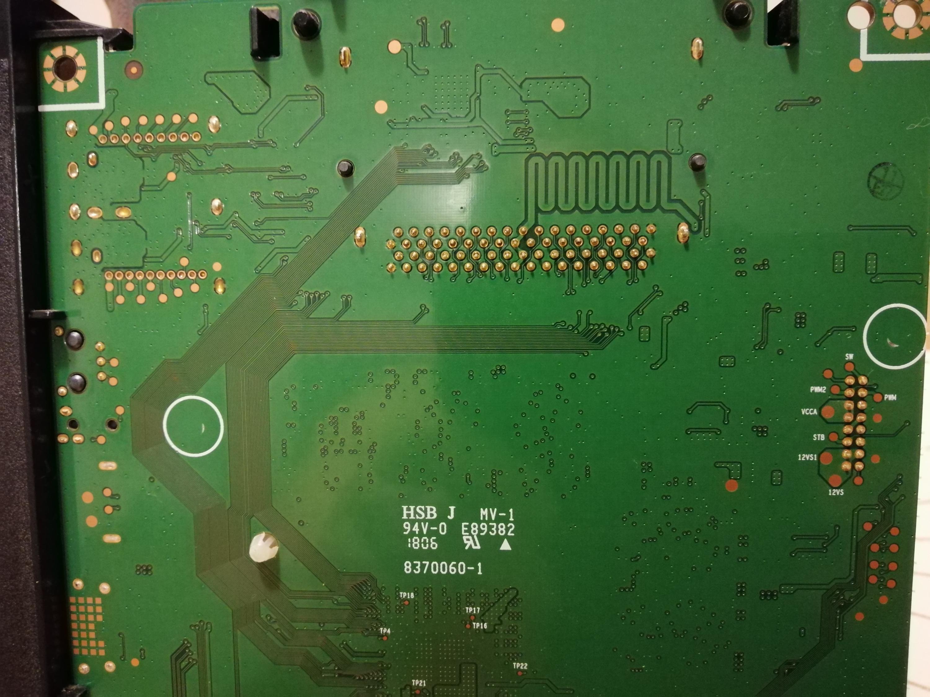

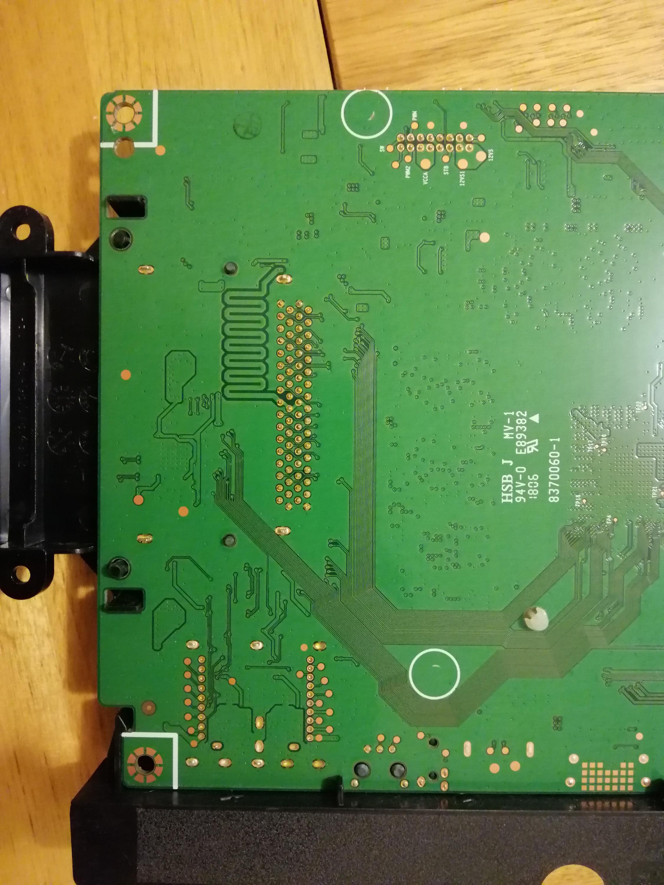

                  • viewerau
                    • May 2020
                    • 305
                    #29
                    Re: Hisense 50P6

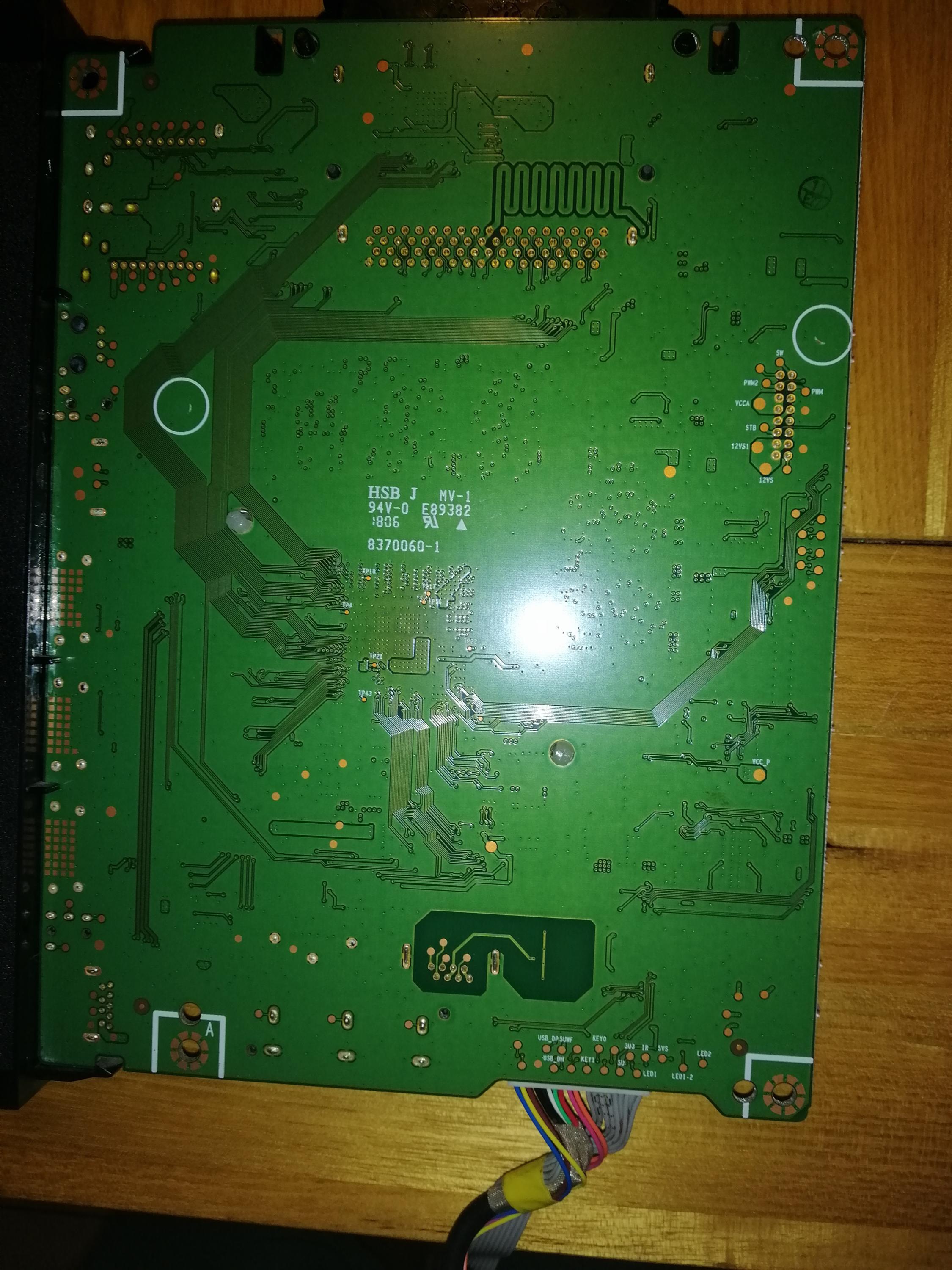

                    Thanks for your tutoring.

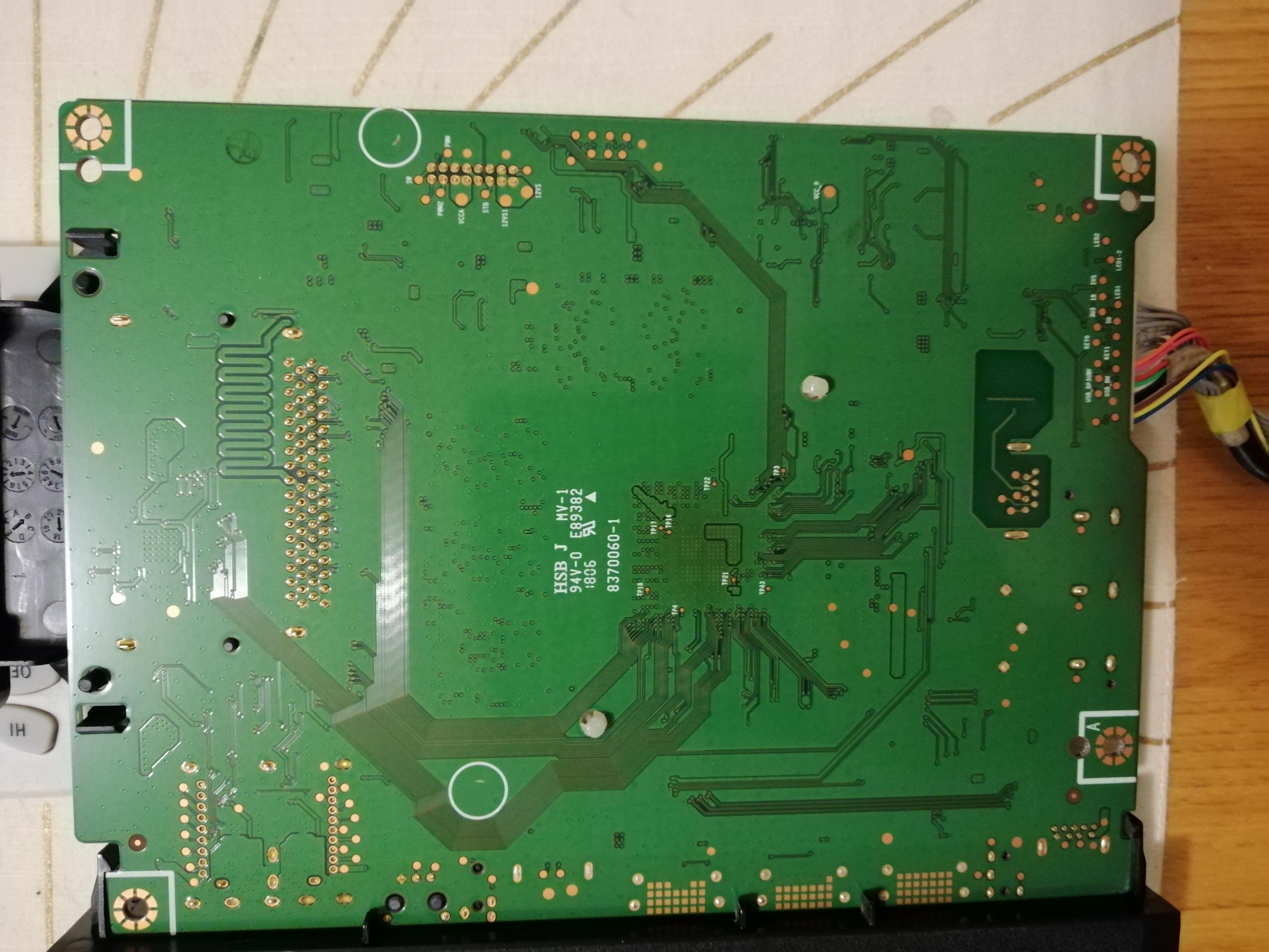

                    I was able to remove the processor cover.
                    I have attached some photos of the front and back again of the processor area, but have not cleaned it, as all I have here is household products, and I am unsure what to use in case I damage something?
                    From untrained eyes, I see little discoloration on the back of the board where the processor sits, nothing evident even with that paste stuff still on there, and no burn type heat mark on the heat sink side facing the processor?
                    Any ideas on what I may do next?
                    Appreciating your input immensely ...thank you
                    • Diah
                      • Feb 2013
                      • 6357
                      #30
                      Re: Hisense 50P6
                      questiones:
                      did you have sound when you turn on and the screen show the lines?
                      about cleaning the CPU use cloth and glass cleaner spray.. it will remove this white pasta. need to read the lable No of the Soc.

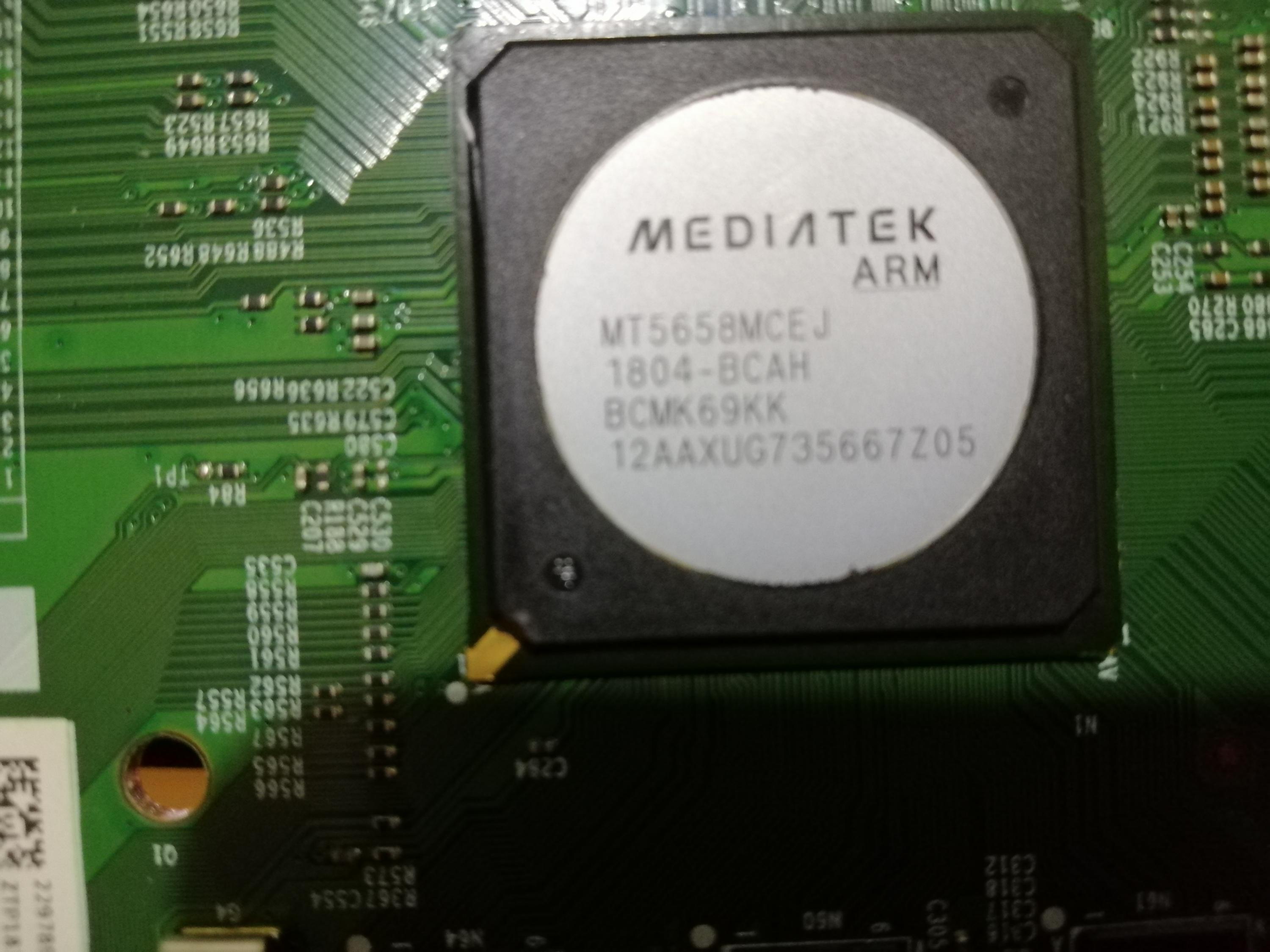

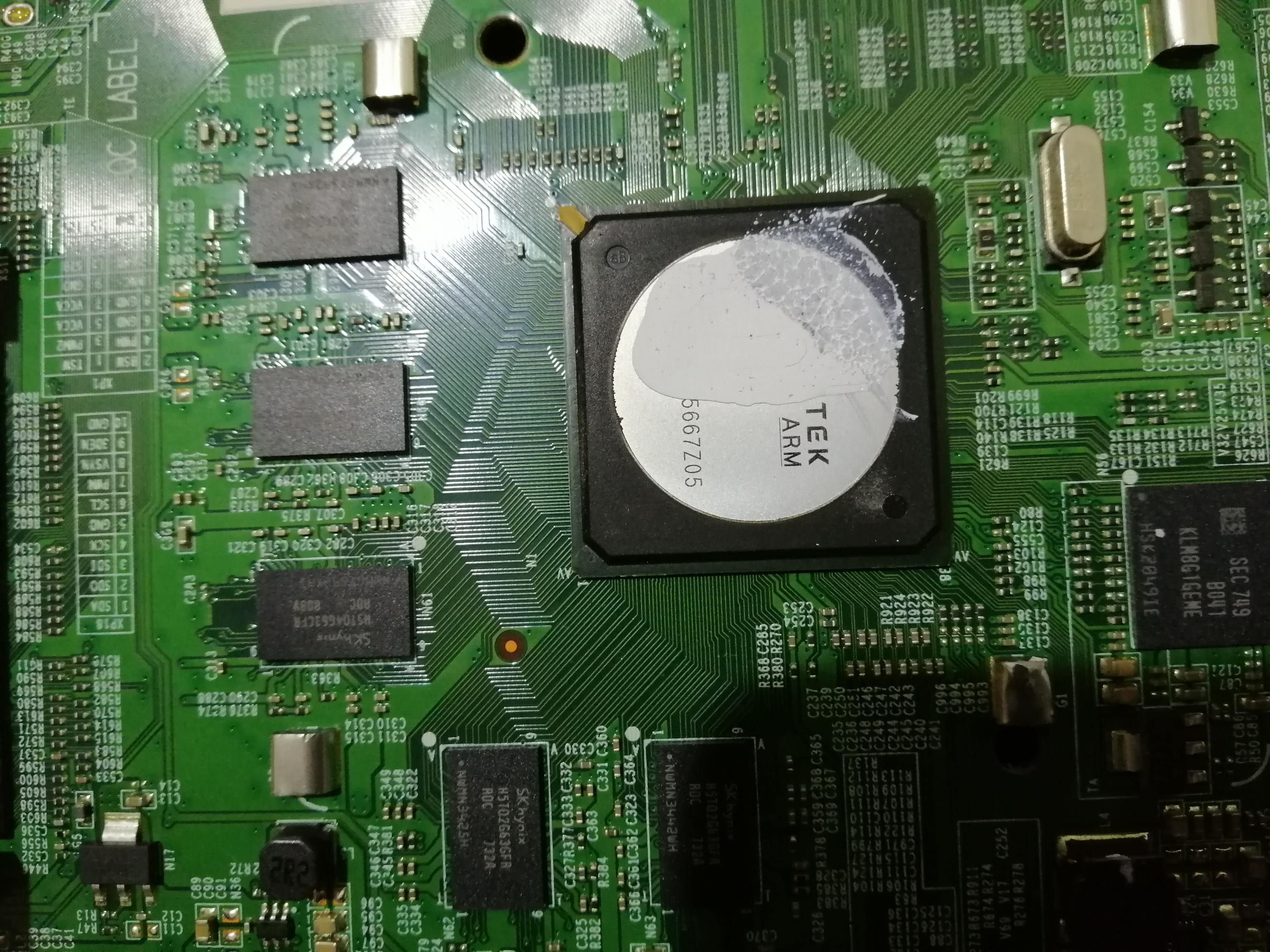

                      • viewerau
                        • May 2020
                        • 305

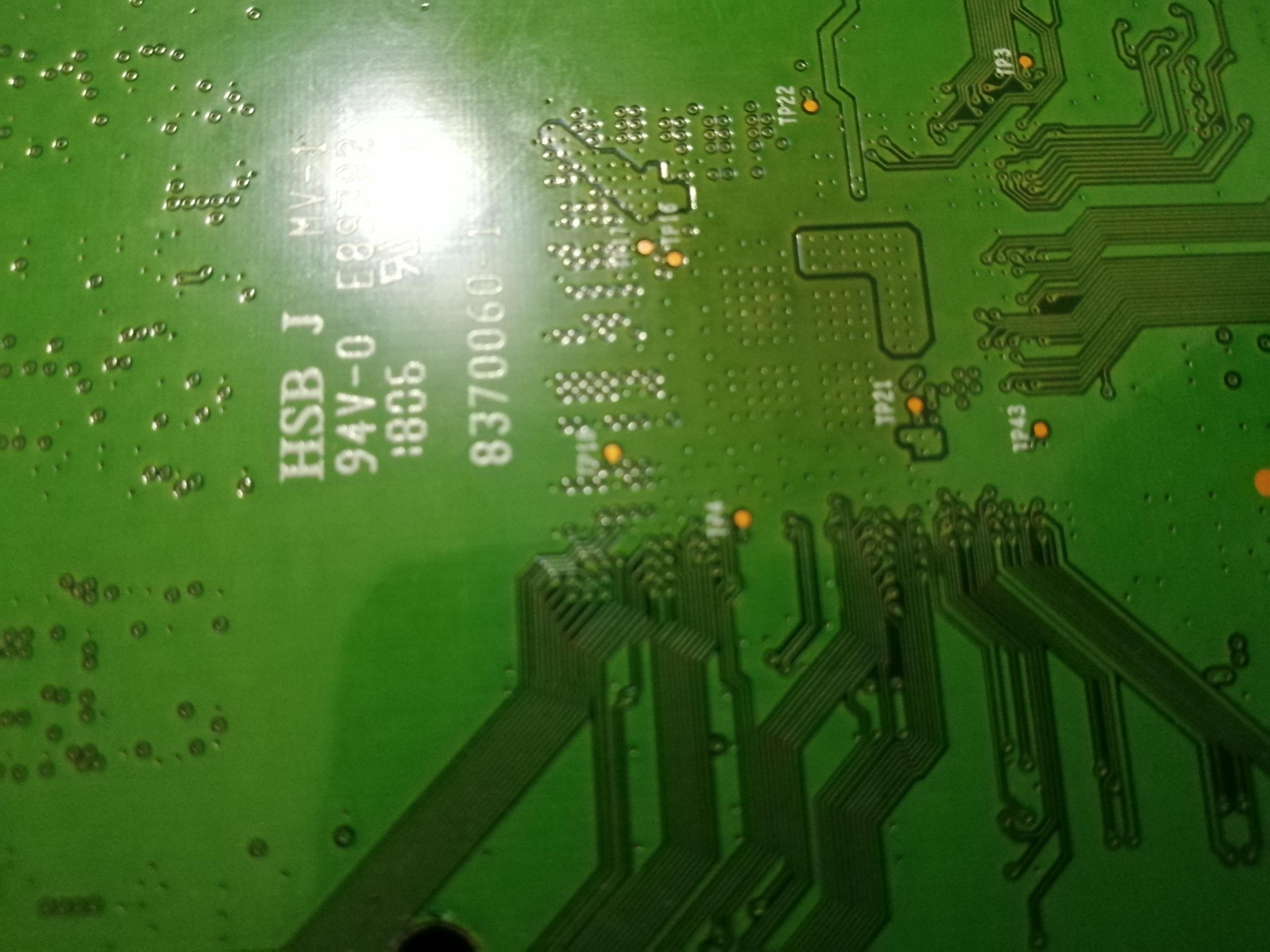

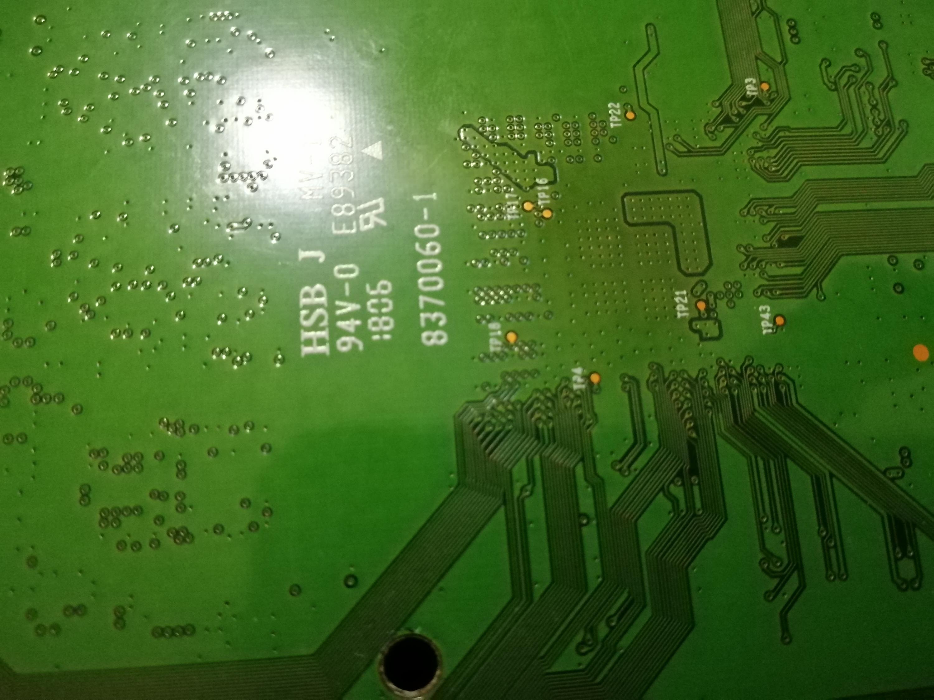

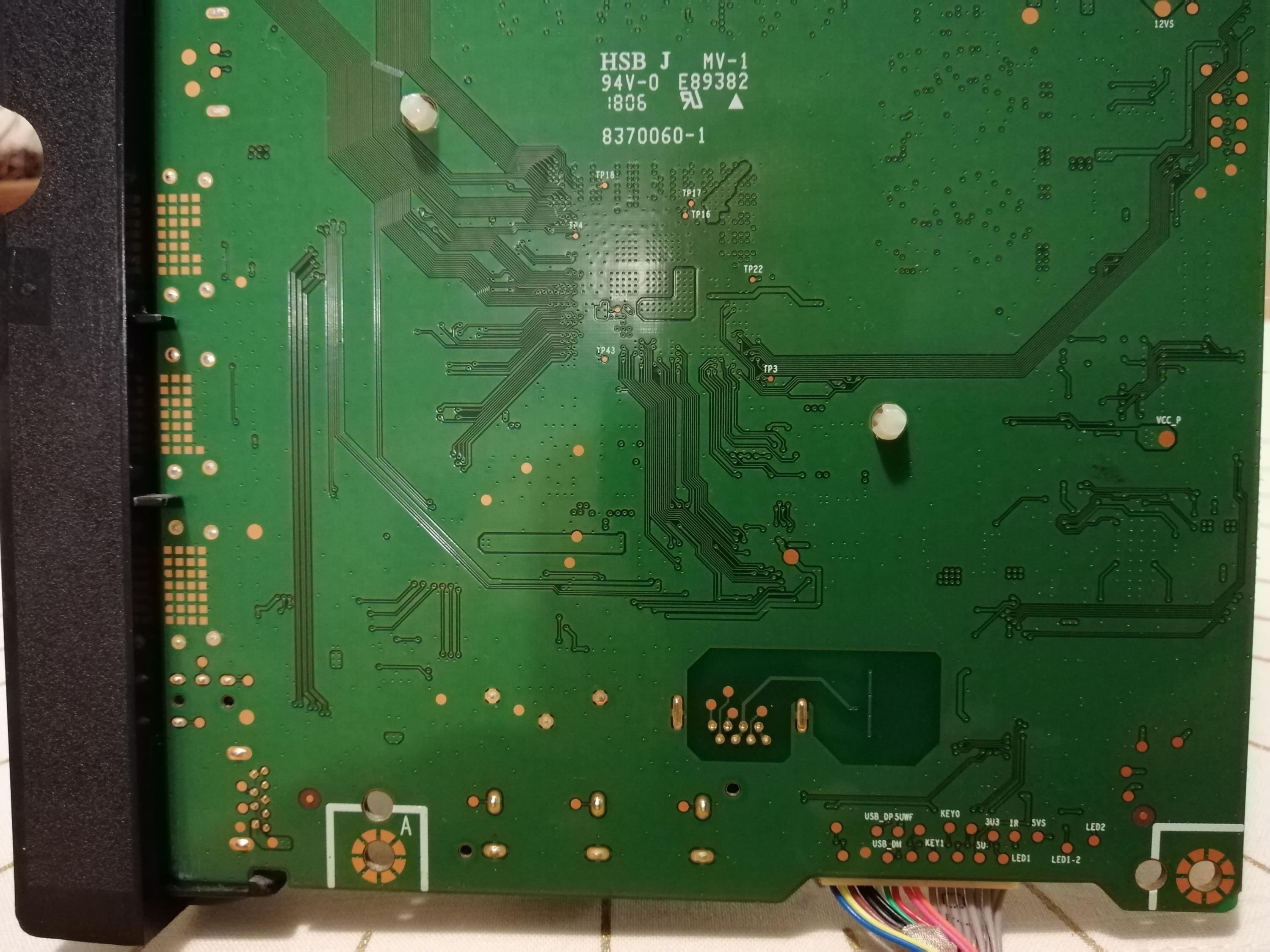

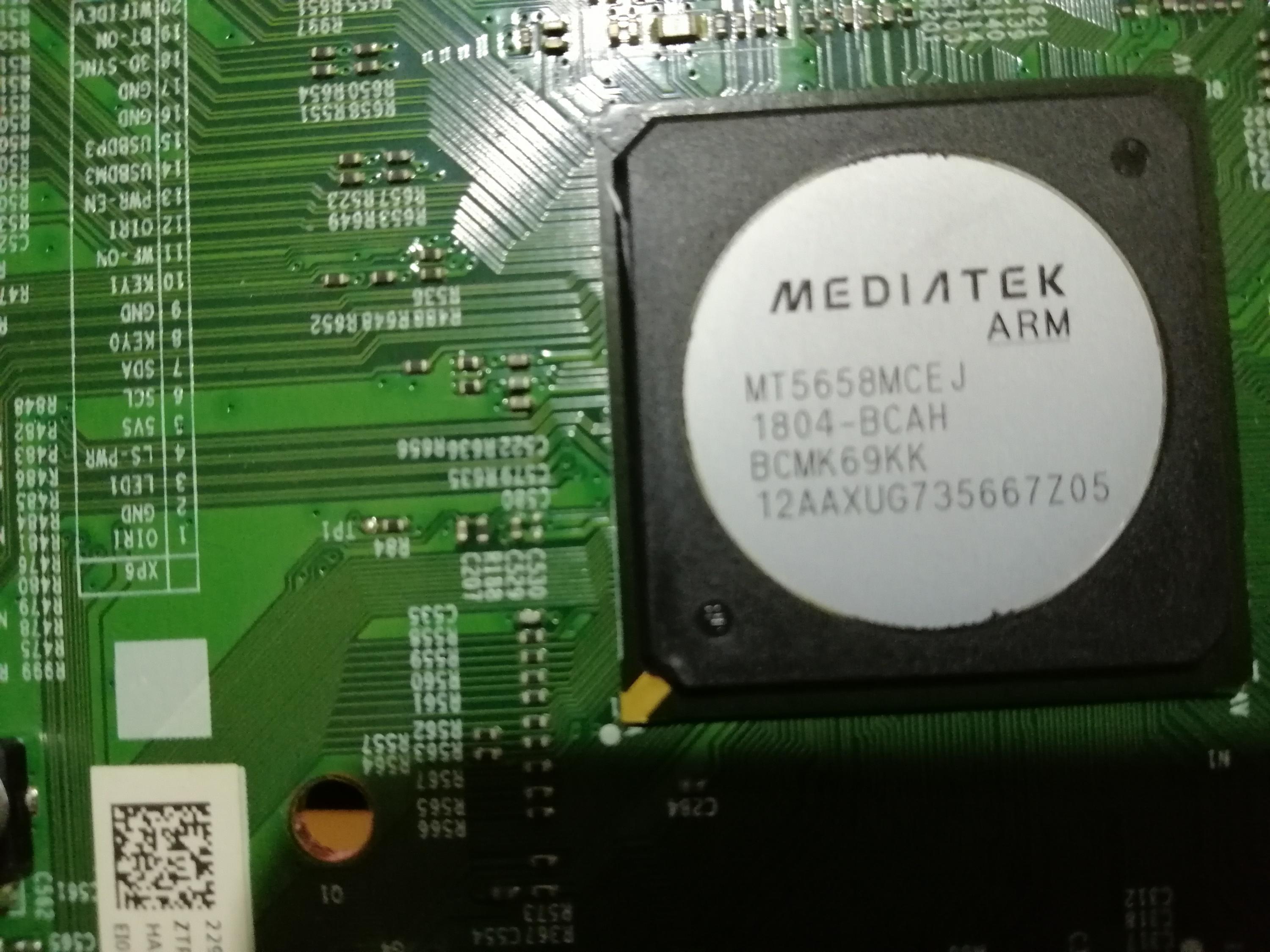

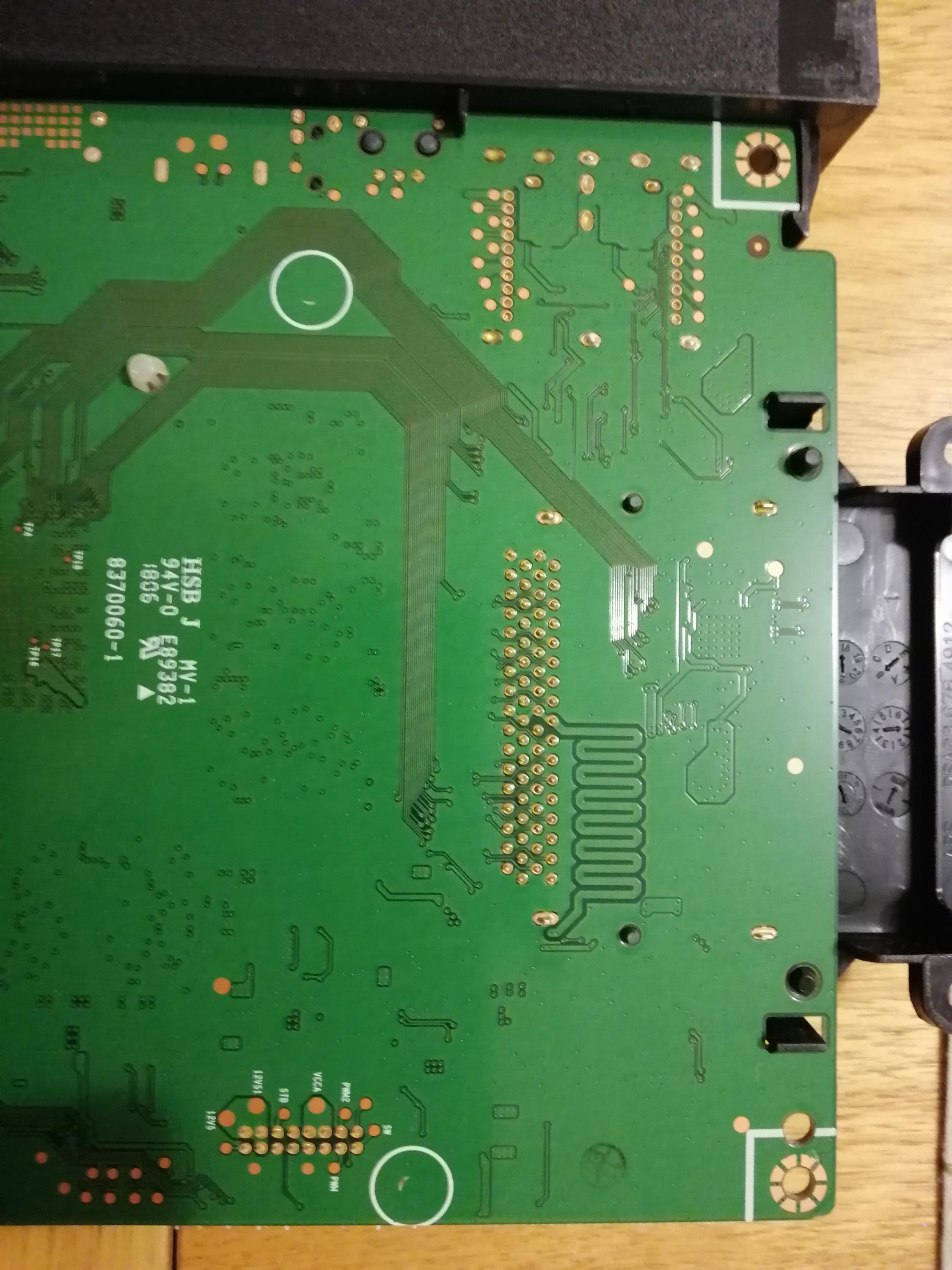

                        #31
                        Re: Hisense 50P6
                        Sound is present she said....I have not hooked it up to an hdmi source to check it myself.
                        New pictures attached

                        • Diah
                          • Feb 2013
                          • 6357
                          #32
                          Re: Hisense 50P6
                          so its MT5658, the section of GPU in this CPU now had defect at core or BGA ( soldering point under the Chip) this repair level you can not to terminate it and solve it... replace MB are only Option for you... but if you wand to try to use oven or hot air gun to heat this Soc there are chance of less than 50% will work again in case we have BGA issue. as this Soc hat allot of small soldering joint point under it..
                          if you want to try heating you must first disconnected the socket which still on it.. then.. heat the oven to max temperature after it reach the max put the MB on the plate and close the door over for 15 minute. after that just turn off the oven and open the door... never never remove the boards until it cool down. then try.
                          if you have hot air gun with 350° or more... put the boards on the table and find some piece heavy weight to put it on the Chip. and start heating it ( only the chip. ) don't let the air heat the parts around it.. use this heat for 5 minute and leave it cool down and try.
                          that's all what i can offer LOL
