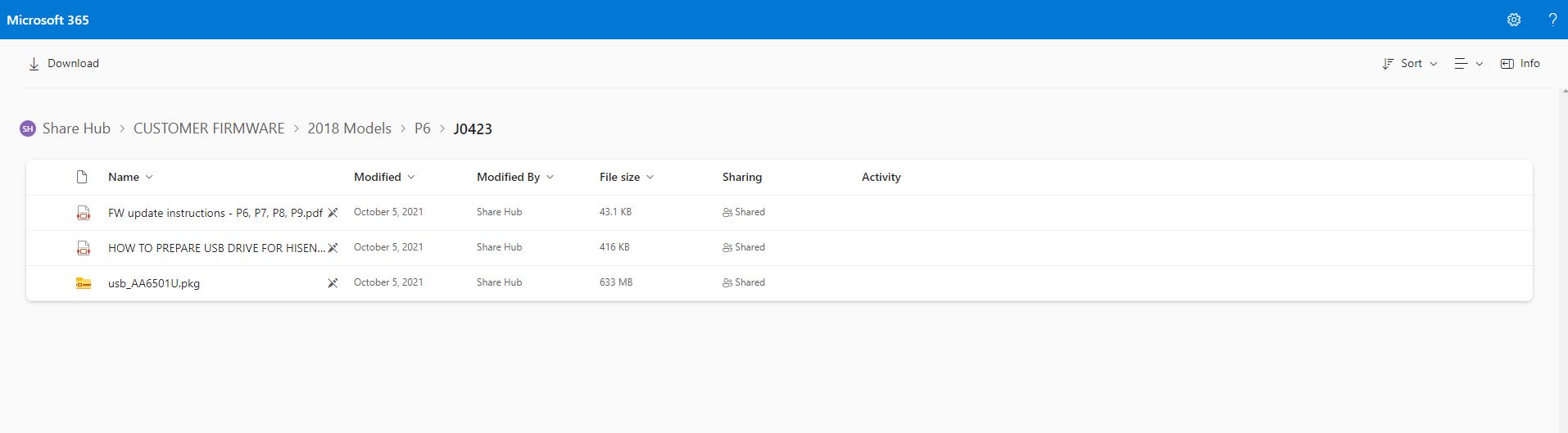

                • viewerau
                  • May 2020
                  • 305
                  #68
                  Re: Hisense 50P6

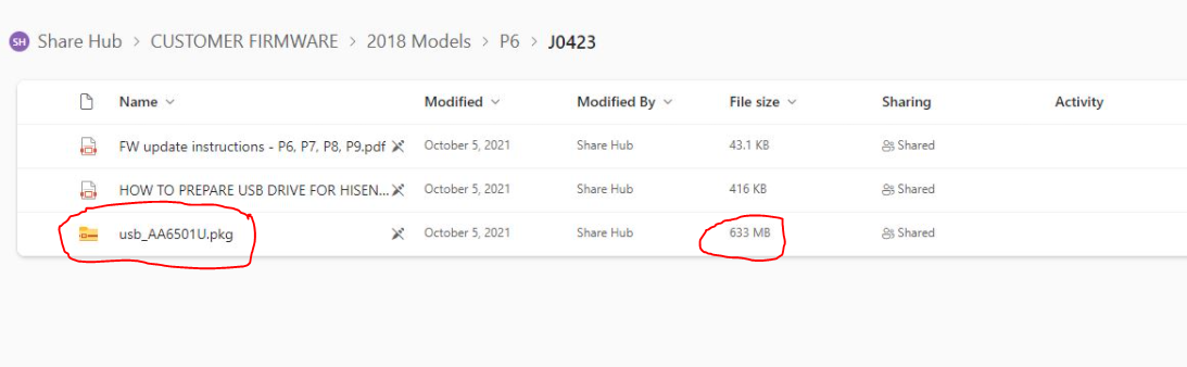

                  I uninstalled all my apps that do zips, rars etc, and then downloaded it, and it saved as the file.
                  Hopefully this looks right?
                  Signature:Seemingly hopeless tv fixer
                  • nomoresonys
                    • Jan 2013
                    • 12229
                    • U.S.
                    #69
                    Re: Hisense 50P6
                    Ok, so is that the first file after you extract? then you should be able to move that file to your usb drive, right?
                    • viewerau
                      • May 2020
                      • 305
                      #70
                      Re: Hisense 50P6
                      It is the third file from the Hisense link.
                      Putting onto usb now

                              • viewerau
                                • May 2020
                                • 305
                                #75
                                Re: Hisense 50P6
                                Originally posted by Diah
                                1- usb formatted as FAT32 MBR mode
                                2- the first file with format .pkg dont extract it. just copy it on the stick
                                3- you may need to rename the file upgrade_loader.pkg in case didnt start
                                4- no need 60 second. as son you press power on RC and keep press plug the tv in wall
                                5-insert the USB at USB Ver2 ( black socket at the side of the TV
                                Thanks Diah,
                                I am certain that this is what I have done.
                                I did not realise that you could not see the file, but it is as before, posted here again, and is file number 3
                                I did it all again
                                No change
                                I d/l it and it shows as usb_AA6501U.pkg
                                I transfer the file onto formatted FAT 32 stick
                                I plugged it to tv and it would not boot.
                                I removed usb, changed file name to
                                upgrade_loader.pkg
                                Reinsert to tv
                                All no go still
                                I do not know what/how to format is as FAT32 MBR mode
                                I look in google via search, and it says ....
                                "The first is to simply format the drive using the MBR format. This can be done in Windows by right-clicking on the drive in My Computer and selecting Format. In the Format dialog box, select the option to format the drive for MBR."
                                When I do this I only have the options
                                NTFS
                                FAT32 (default)
                                exFAT
                                In disk management it shows my usb as D 14.32GB FAT32 Healthy Primary Partition
                                It shows no errors.
                                Am I doing this right?
                                THANK YOU
                                EDIT...file ext only shows .pkg the once.
