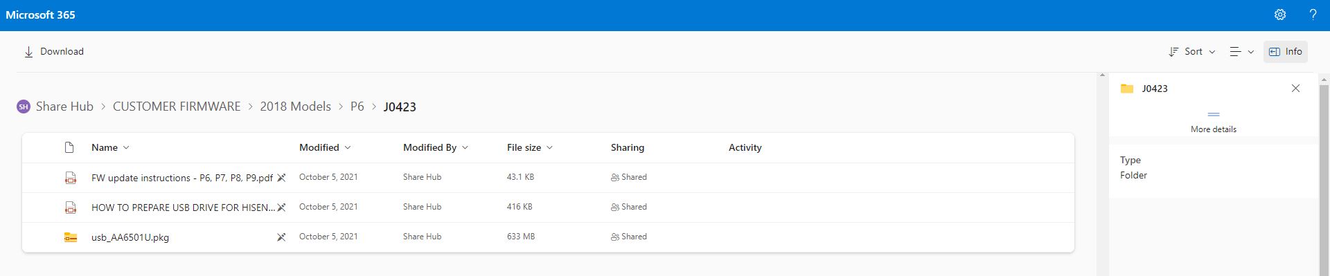

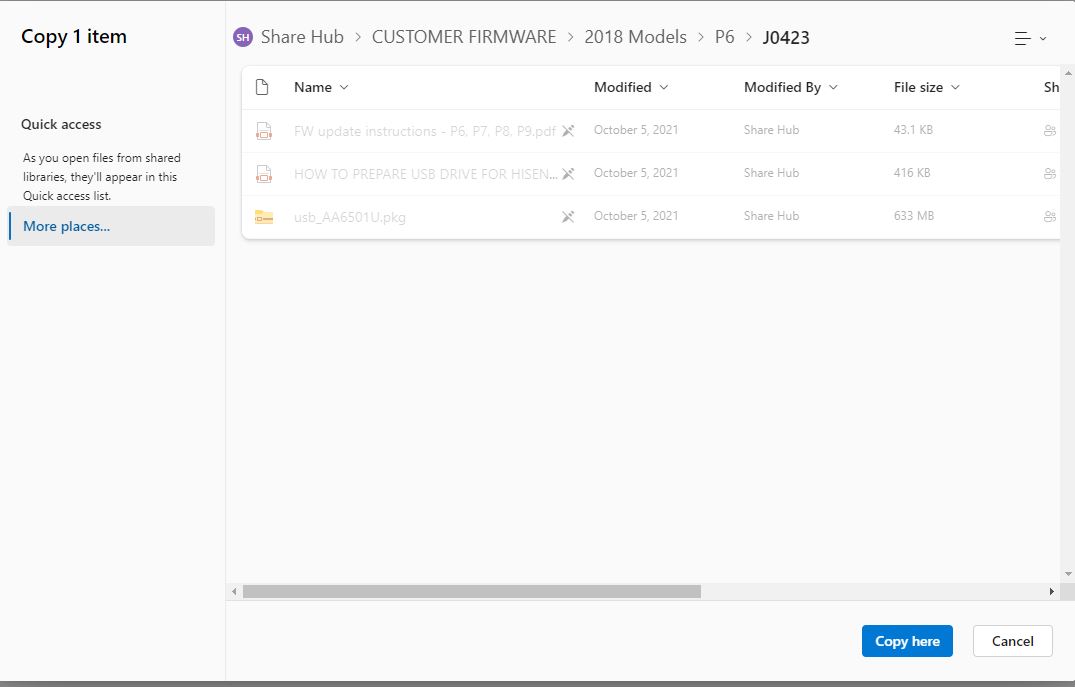

                                    • viewerau
                                      • May 2020
                                      • 305
                                      #58
                                      Re: Hisense 50P6
                                      Originally posted by lotas
                                      Wrong!
                                      It would be appreciated if you could tell me the right way?
                                      EDIT
                                      Thanks Diah
                                      Signature:Seemingly hopeless tv fixer
                                      • viewerau
                                        • May 2020
                                        • 305
                                        #59
                                        Re: Hisense 50P6
                                        When I right click the file,(my link) it will only allow these options
                                        Preview
                                        Download
                                        Copy to
                                        Details
                                        If I select Copy to...I can't seem to save it
                                        If I download it, it turns into this zip folder
                                        If I extract then, it just comes back with all those folders again.
                                        My apology for not understanding how to simply grab that one file
                                        HELP....
                                        • nomoresonys
                                          • Jan 2013
                                          • 12229
                                          • U.S.
                                          #60
                                          Re: Hisense 50P6
                                          How bout, left click hold, drag and drop, send to should also work.
