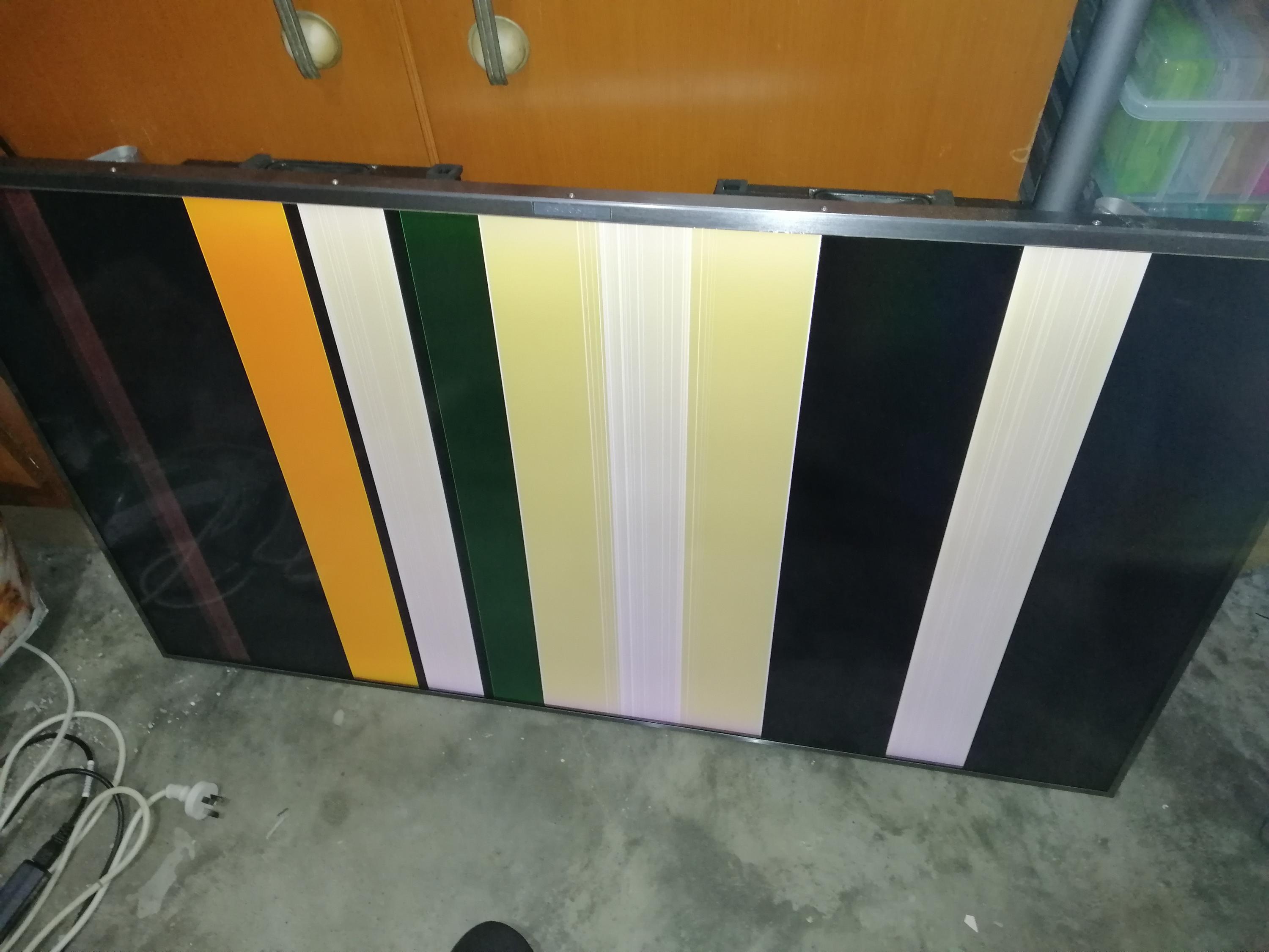

                      I am hoping for a little more guidance please.
                      I have been very fortunate, in that another reader in Australia, contacted me about this matter.
                      He advised his parents had one of these, but the TV stopped working a couple of months ago. It would turn on, the Hisense logo would appear briefly and then the screen would go black.
                      He offered to remove the p/s mainboard and t-con, and to post them to me, to see if one of the parts could get my one going....what a great offer!!
                      I thought I would post here again, without going like a bull at a gate, and seek advice before I start.
                      Would anyone care to suggest in which order I should try the interchange of boards, so that I can minimise any possibility of damage along the way?
                      At present, all the tv will answer to from it's original remote (since purchased) is power on/off, no other buttons doing anything. More in a moment
                      To recap, this is all the tv shows, and swapping of cables from t-con achieves nothing.
                      Today, in playing around again, I noted that whilst the tv was in standby (red light on), that if I pressed the remotes NETFLIX button, all the lines changed to mainly red, the same colour you see when you fire up netflix,.the same button also shuts it down....weird I know, but a slightly different reaction than previously seen.
                      All assistance appreciated...just awaiting the boards arriving.....thanks

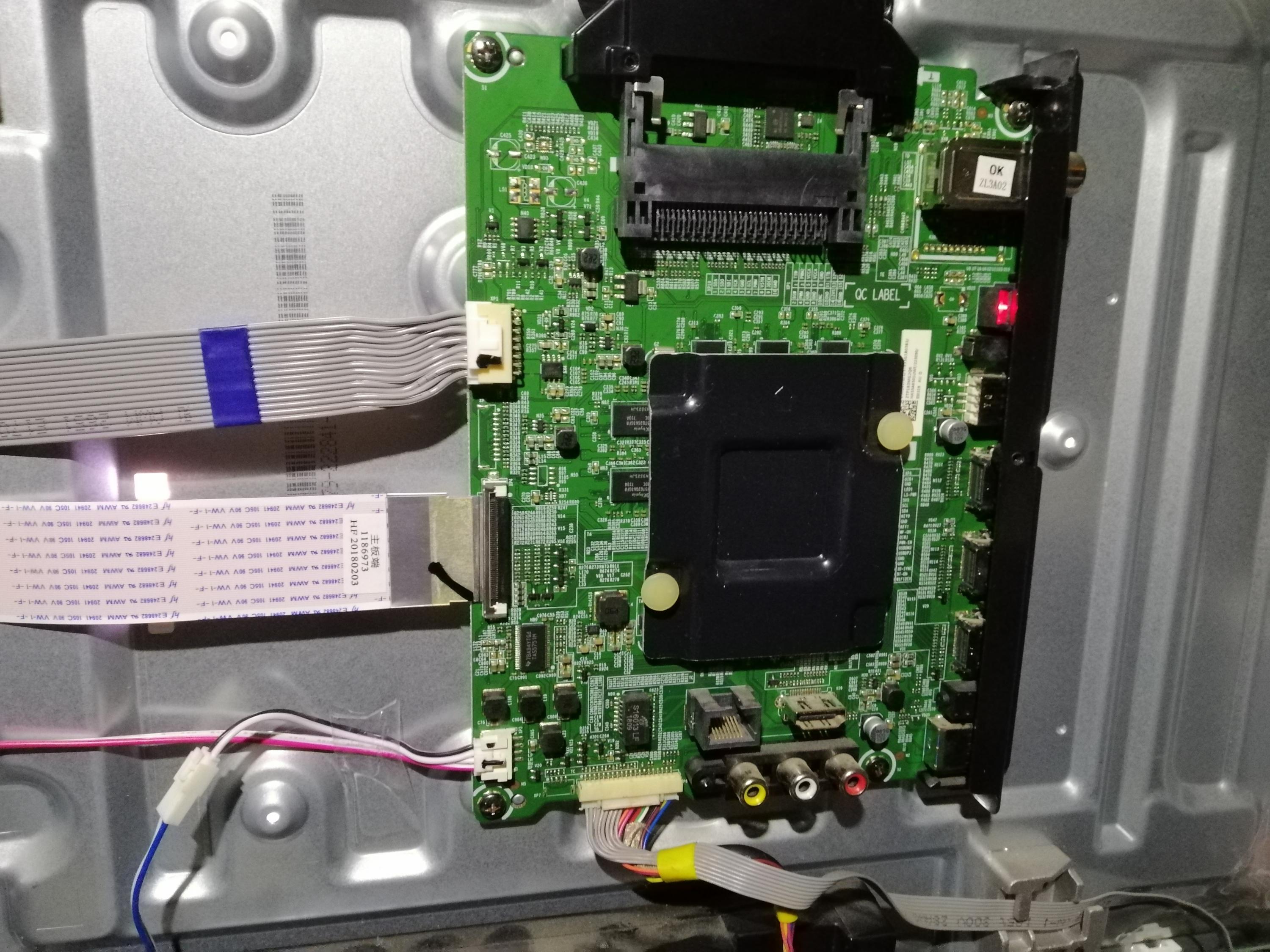

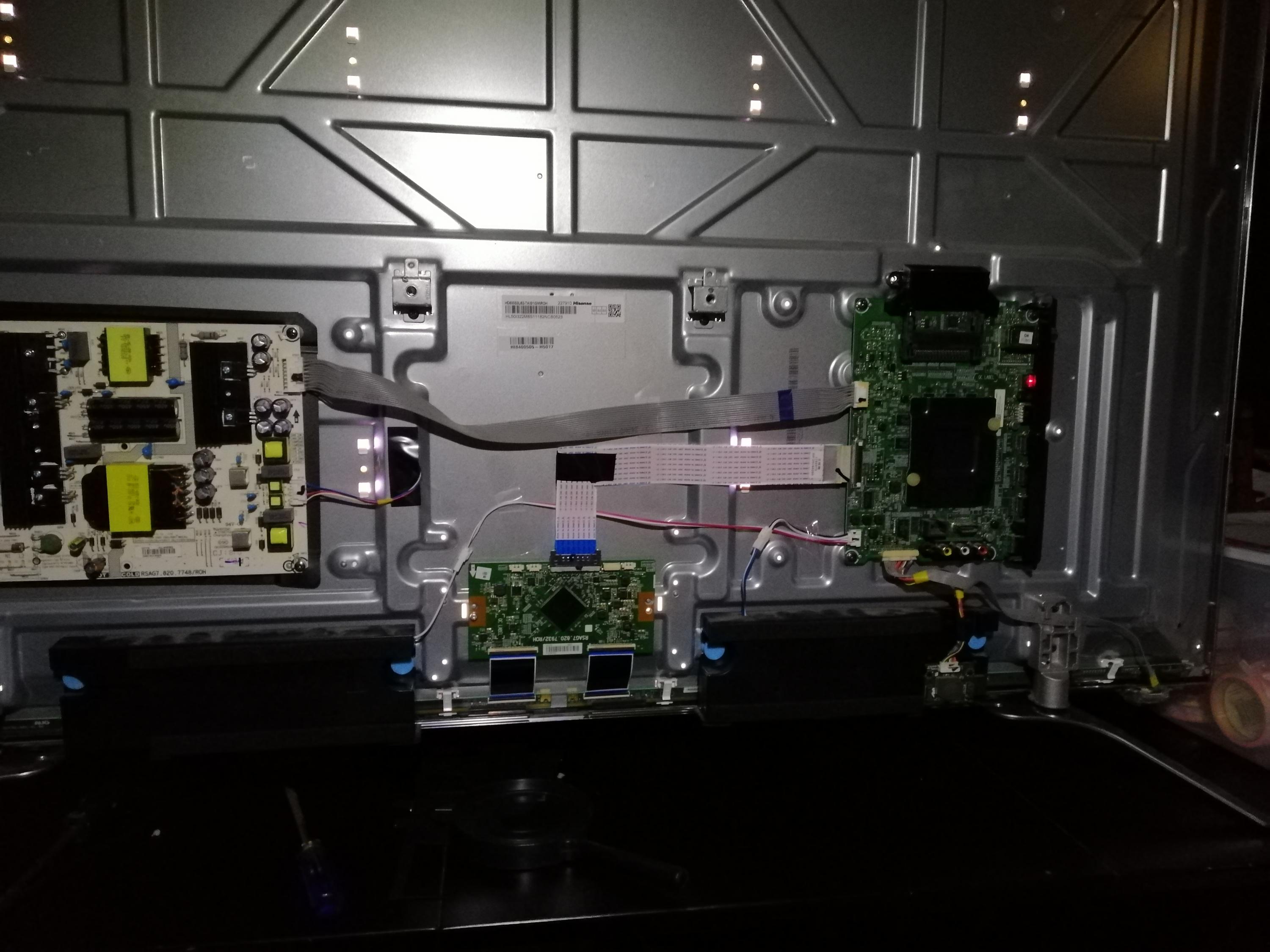

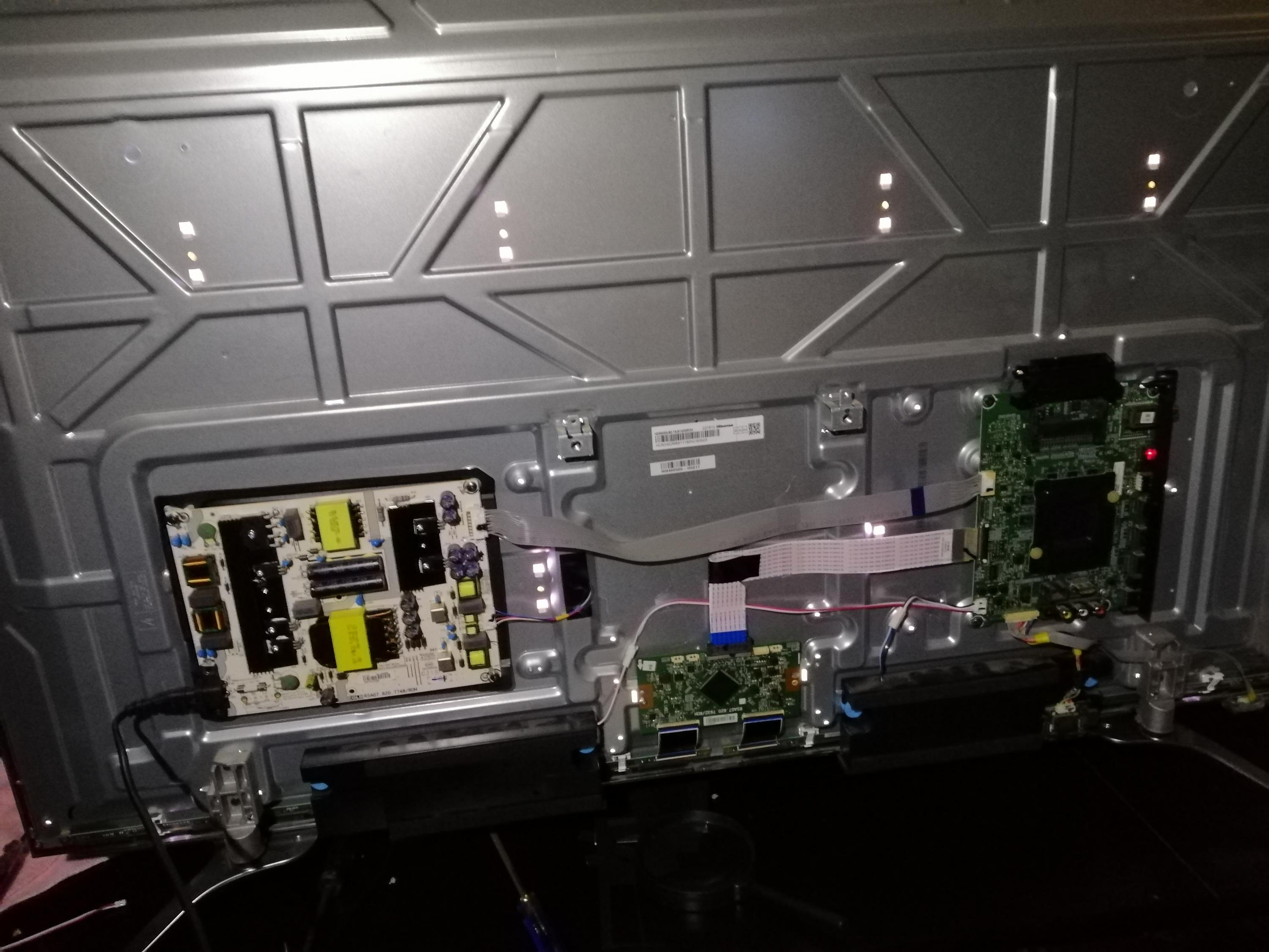

                                Well, the parts arrived from my donor tv
                                PS
                                Mainboard
                                T-Con
                                Disappointment prevails.
                                The steps I took.
                                1)
                                Removed the old mainboard
                                Refitted donor mainboard
                                RESULT
                                As before, backlights on, the usual vertical lines present across the screen

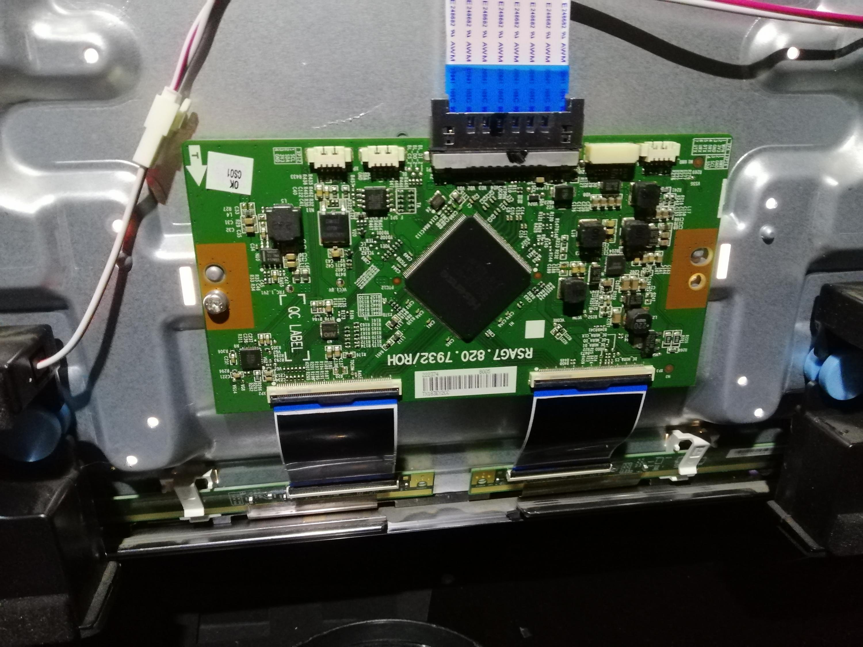

                                2)
                                Left donor mainboard in place
                                Removed old t-con board
                                Refitted donor t-con board
                                RESULT
                                Backlights on, no picture at all on screen, no lines
                                3)
                                I then tried via removing ribbons from the t-con, to see the results
                                a)Removed the ribbon from the t-con board only, that feeds the left of the screen, looking from the front
                                RESULT
                                As above, Backlights on, no picture at all on screen, no lines
                                b) I then reconnected that ribbon to the t-con board, and removed the ribbon that supplies the edge boards on the left side screen.
                                RESULT
                                4)
                                c)Reconnected things back up for the left side of screen, and removed the ribbon that connects to the t-con and supplies feed out from t-con to the right side of screen
                                RESULT
                                This put the lines up again, but the lines were on the left side, and backlights on
                                d) reconnected the ribbon that fixes to the t-con board, and removed the ribbon that leads to the right side edge boards
                                RESULT
                                Same as other..This put the lines up again, but the lines were on the left side, and backlights on
                                5)

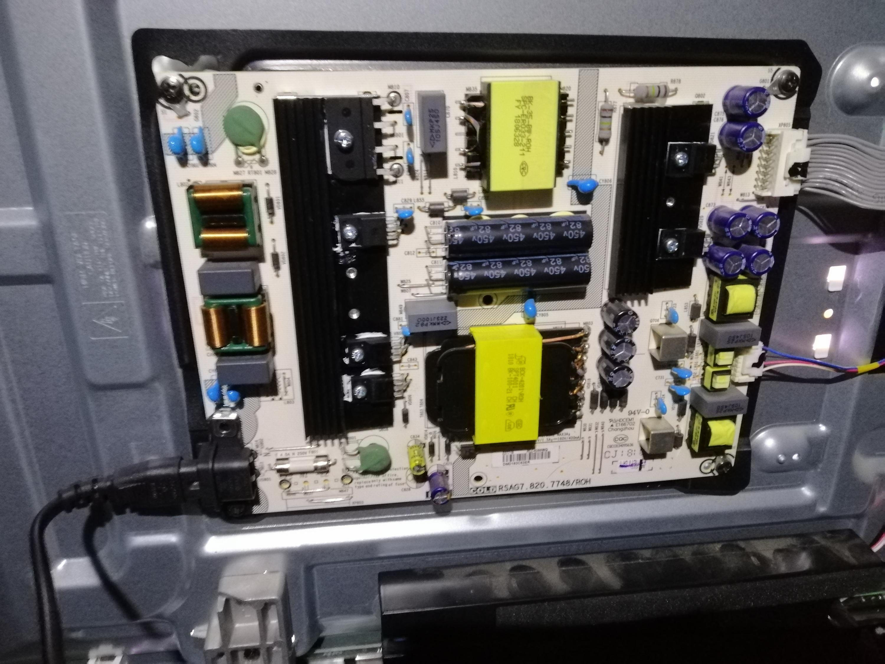

                                I left the donor mainboard and donor t-con all connected as they should be.
                                I removed the older power supply, and installed the donor power supply board, and connected them all up
                                RESULT
                                As it always was...lines everywhere, just the same as when the old boards were all in place.
                                What now please?
                                Signature:Seemingly hopeless tv fixer

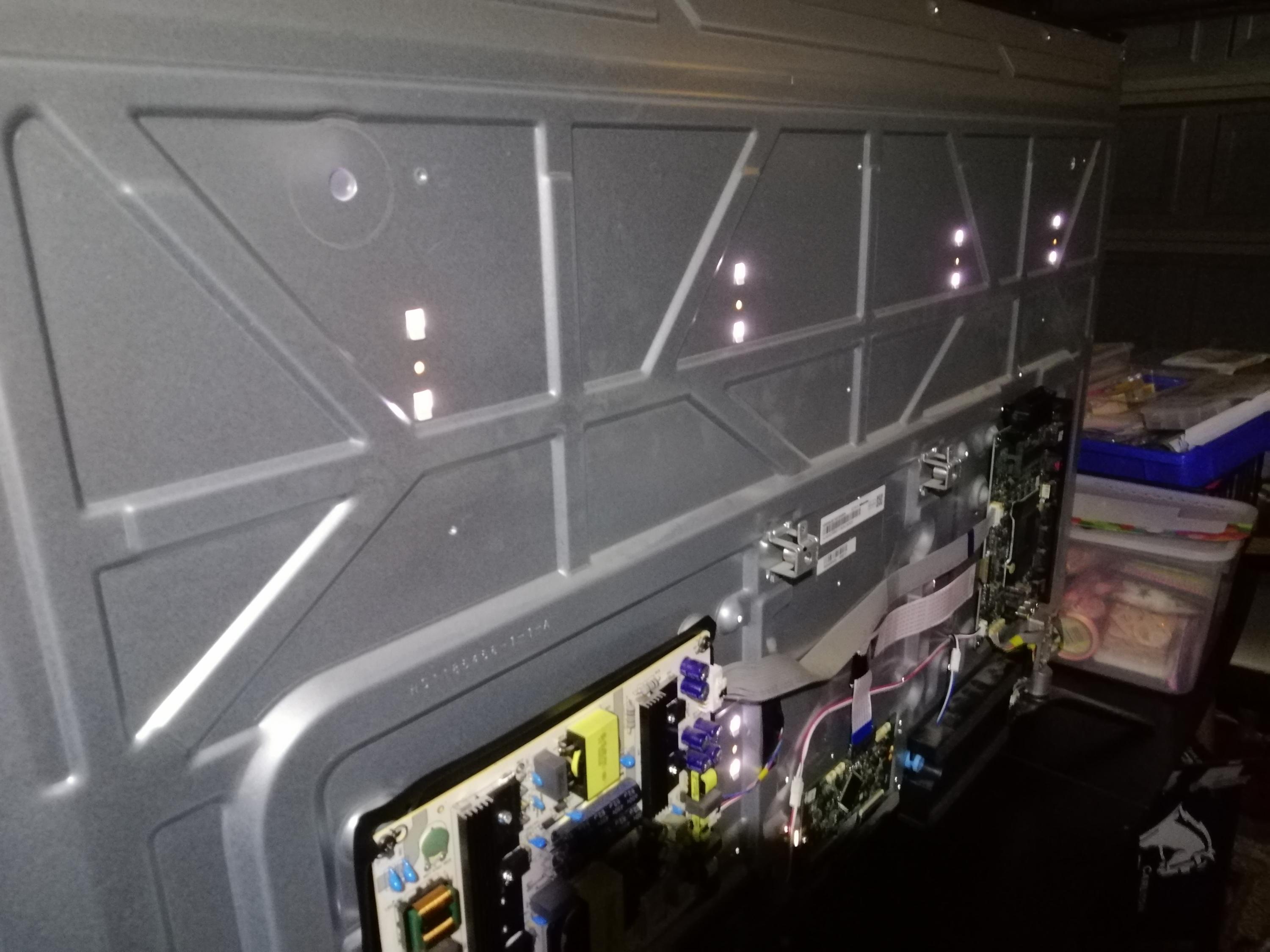

                                          #100
                                          Re: Hisense 50P6
                                          This test conducted with donor boards all in use.
                                          I asked if the BL turn on after you unplug the LVDS between main boards and T-CON... if yes then do the test I mentioned...
                                          Yes..the backlights turn on with the LVDS disconnected from T-con board
                                          if yes then do the test i mentioned...
                                          feed the F1 on T-CON 12V from power boards while the LVDS always disconnected from T-CON side... tell us what do u have on screen
                                          I ran a wire between 12v and the P
                                          The screen remained black, no lines, nothing....torch revealed nothing.
                                          All that was noted was a small spark as the wire connected giving power to the t-con
                                          Damage doing this
                                          The LVDS cable that secures to the T-con board, the little tabs you squeeze to remove the cable fell off, dunno how I get the cable out now....derrrrr.

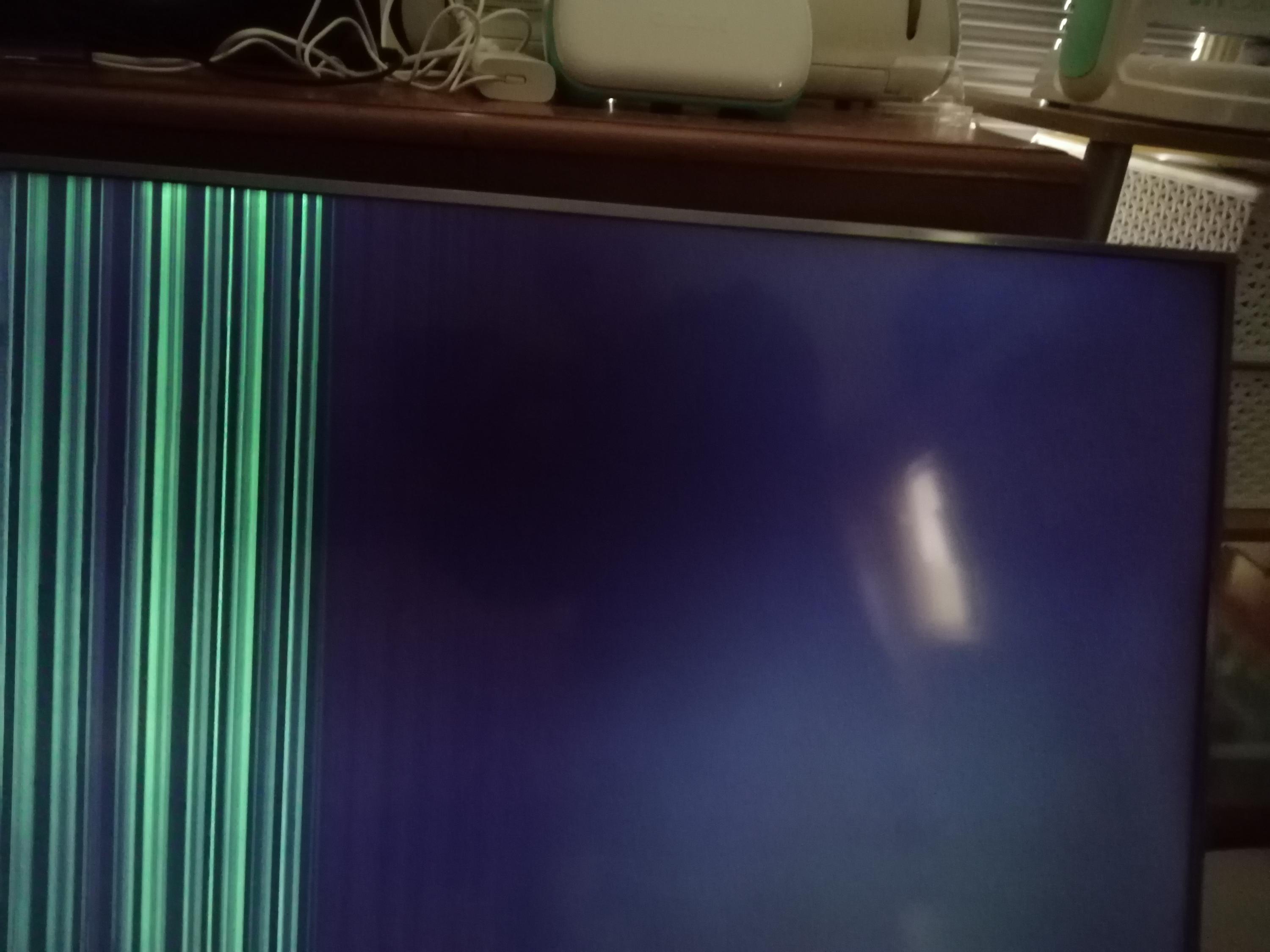

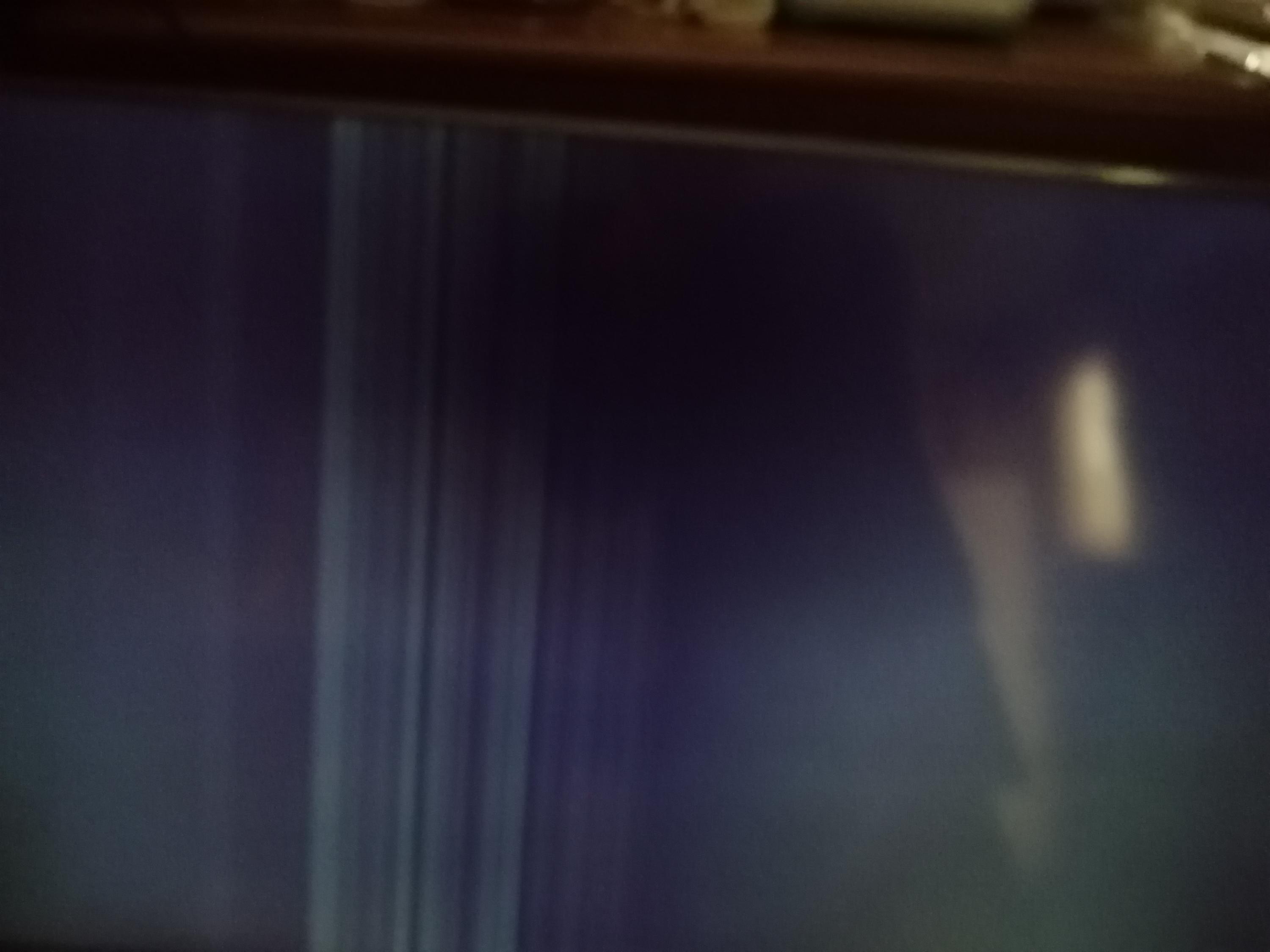

                                          I have attached a new set of pictures....
                                          The start up now goes into these green lines that pulsate, fade away, and then return bright again.
                                          A video of it
                                          Some pictures of the green lines, back of panel, and showing backlights burning strongly.
