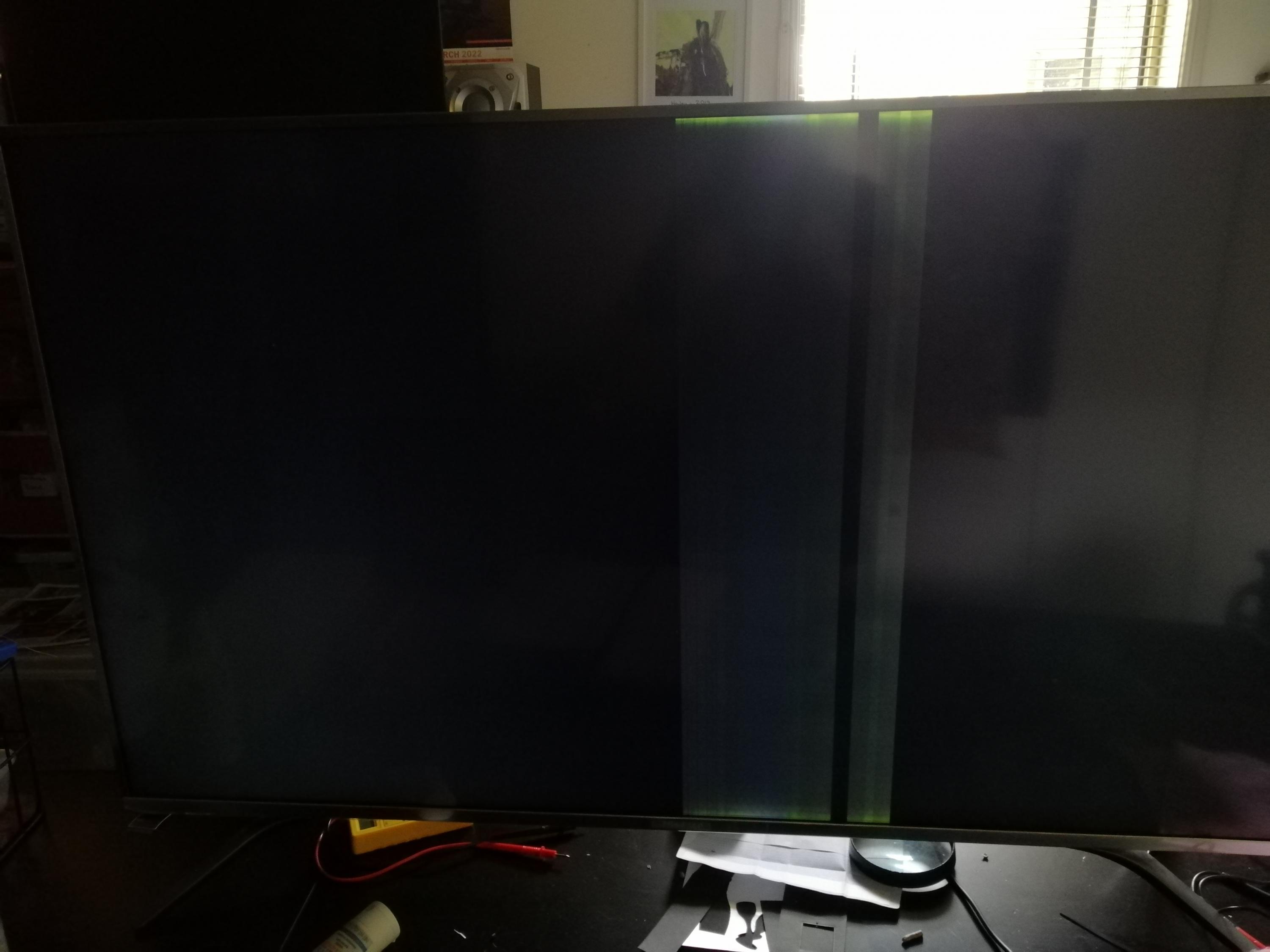

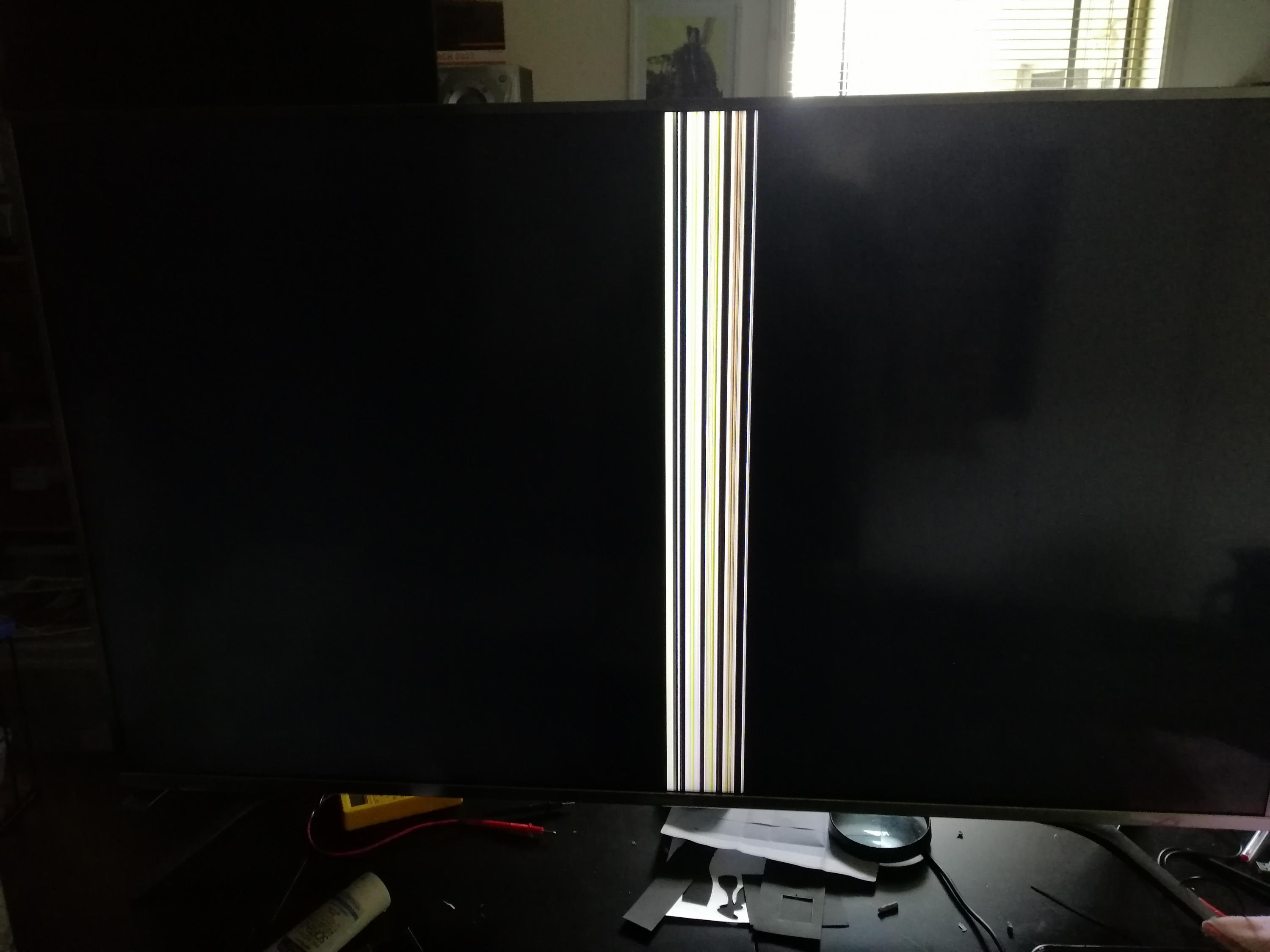

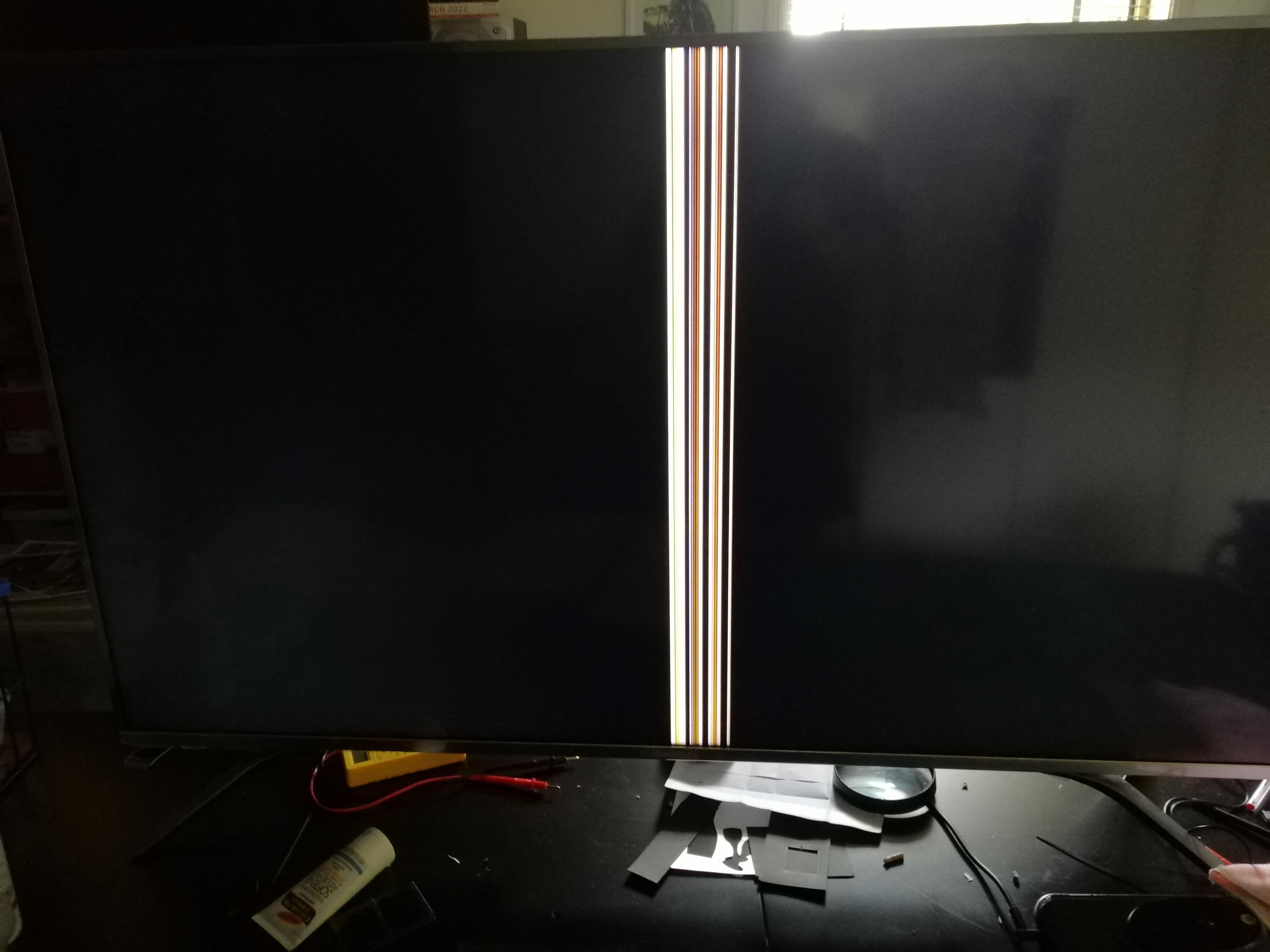

                OK...
                My new findings.
                With power disconnected...
                Fitted new strips to go between t-con and edge strips
                1)Obtained backlights only, no picture or stripes on tv
                I then turned off, and disconnected the strip between the tcon and the edge board that feed the right side when looking at the tv
                I connected the power
                1)No change, backlights only, no picture or stripes on tv
                I then powered off again, reattaching the right hand ribbon to the edge board, and unclipped the strip feeding the left hand of the tv.
                1)Obtained backlights again, then the picture changed to these images, cycling through all the time, in a slow fashion.
                In every instance, as the tv responded to the remote to turn it on, the red standby light flashes 17 times on start up.
                The pictures attached show what happened on the screen when the left hand ribbon was disconnected from the tcon board.
                Doing some other reading, many sites suggest I check the VGH/VDD/VGL levels on the tcon, with strips on and off to the edge boards, to try to ascertain whether their is a short on the panel from a low/missing VGL. Thus I have soured my tcon board looking for these test points, but cannot find them. Does this find like I should be trying this as well, but what happens when I can't find them on the tcon boaard?
                So different reactions to my initial tests, but am still at square one....STUCK.

                  17 flashes is normal, mine does that when working properly.
                  Your symptoms are similar [identical] to mine.
                  I scoured my t-con for errors [incorrect voltages - one was a negative voltage source, which was correct and near zero, two others with effectively zero voltage which was protection mode - the incorrect voltages on the t-con was a symptom of the blown diodes, NOT the actual cause of display issues], you can measure the voltages at each inductor but I suspect you're dealing with blown diodes also.
                  Check my thread again for the details.
                  Now do you have u-ribbons?
                  Meaning are there two separate boards on each side feeding the screen [4 in total].
                  If so you can try leaving BOTH t-con connectors installed and unplug the u-ribbons between the edge connection boards one at a time.
                  For me this was inconclusive as I didn't get an actual picture, BUT I did get the lines up the screen whereas I'd only had backlights only previously.
                  My diodes on the edge connection boards were on the end of the left and right outer end connection boards - you'll need a magnifying glass to see them, as although they've got 10 pins [connections] they are the size of a flea, literally.
                  Mine were both labelled D001, there may be more than one diode on your outer edge boards - check them all if there are.
                  Remember the centre pins [upper and lower] on the TVS protection diodes are ground and any of the other 8 pins which goes to ground is a short.
                  With one blown diode removed and the other outer edge board u-ribbon disconnected, I still didn't get a correct image, then once I'd removed the second blown diode all was well.
                  I was expecting to have to deal with other blown components, so that was pleasant surprise.
