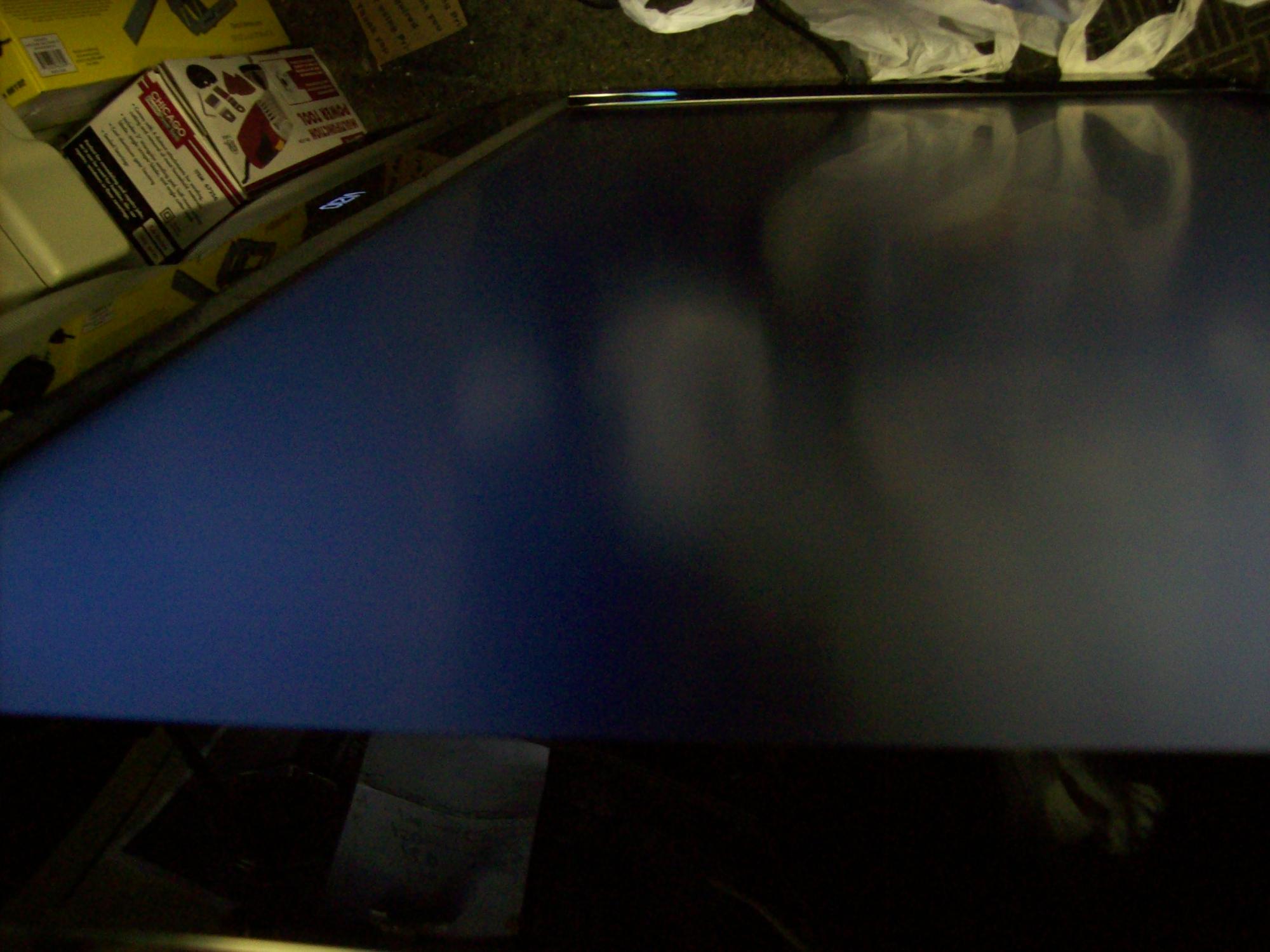

                I'm also working on a Visio and the model is VX42LHDTV10A and it also turns on and the Visio logo goes from amber to white, no backlight screen or sound, will not turn off with remote. I removed both the power supply and the mainbaord to inspect for burned parts and test the fuses, after I re-installed the boards the backlight failed to come on (it did before I removed the boards for testing). Last thing I did was check the power going into the main board and I get 3.1 volts on pin 1, three other pins get 5 volts but there is no 12 volts coming into the board. I downloaded the manual from a link on this site but it is for a L42HDTV10A so being not exactly the same model the J7 pinout shows 14 connections where my set only has 13. Can the mainboard cause the power supply to stop providing 12 volts is my question, and a couple of the 680uF caps on the power supply look a little different on the tops than the other ones. I went to digikey but I do not know exactly what replacement cap I should get. I sure would like to get this set working because my TV is very old and is starting to shows signs of dying. Thanks for any help on this project.

                    Re: Vizio VW42lHDTV10A no pix, no sound, won't turn off
                    Well I got my backlight to come on again, it was my fault as I had the connector plugged in but off by one pin (too early in the morning or late at night, I can never win), the good news is that now I'm getting good voltages to the mainboard and I can move on to troubleshooting using the manual which only has mainboard troubleshooting in it. After following the flowchart I found some chips that were out of spec and three that were not even on the board or disconnected. With the power switch on part U7 pin2 was 1.07 and should have been 1.8, part U10 pin2 was 2.66 and should be 1.8 but this pin 2 has me confused as it is not connected to the board. The flowchart does not say to check part U33 but after reading the posts I did anyway and got 2.11 volts on pin2. The manual lis for a model GV42L and lists U33 as IC SWITCH P15C3257QE QSOP 16pin LF but on my VX42L it is a AP1117E18LA SOT-223 which only has 4 pins. So I'm still looking for the correct manual before I order any parts. I make mistakes and I'm getting older but I try to fix my errors and double-check my work. Thanks for all the help and good luck with your repairs.

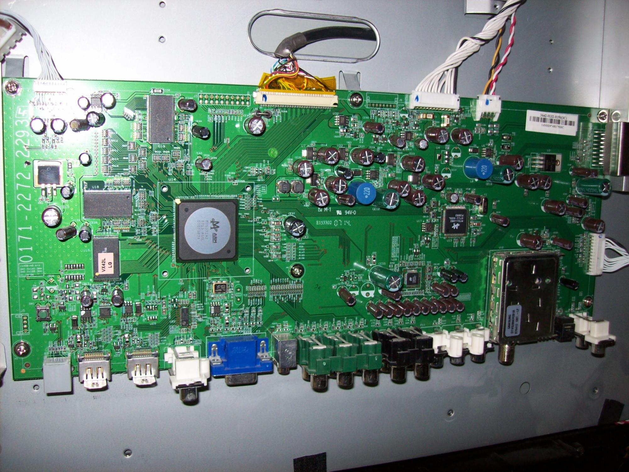

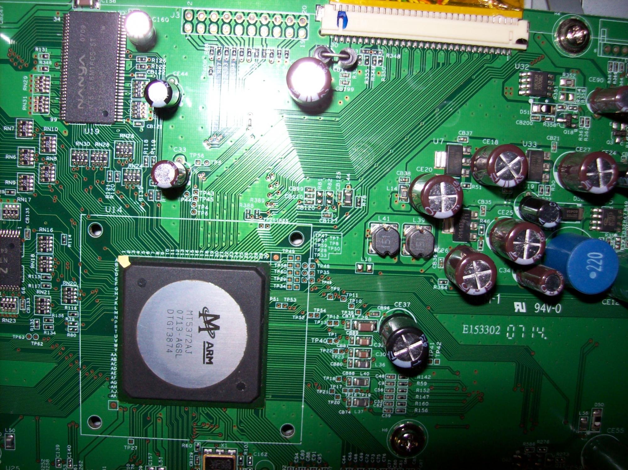

                          My set had no U4 LDO , and U5 was an 8 leg IC, so check my attached pic for comparison with yours, and you will also see 'missing' caps in same area of board.
                          My set had bad U7 and U33 both adjustable LDO's and I used digikey no 497-1229-1-ND which will also replace several AMC 1117 found in these.

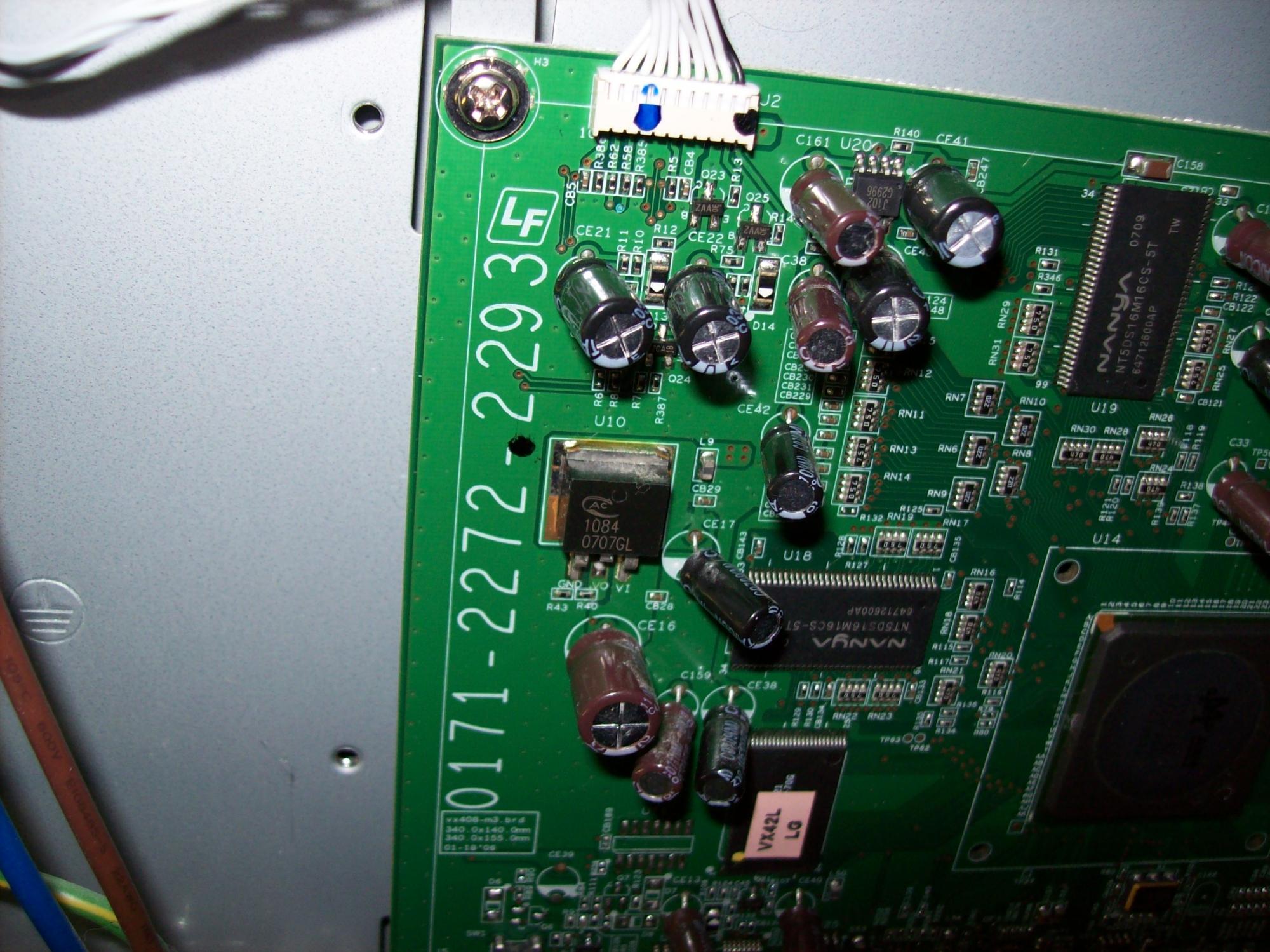

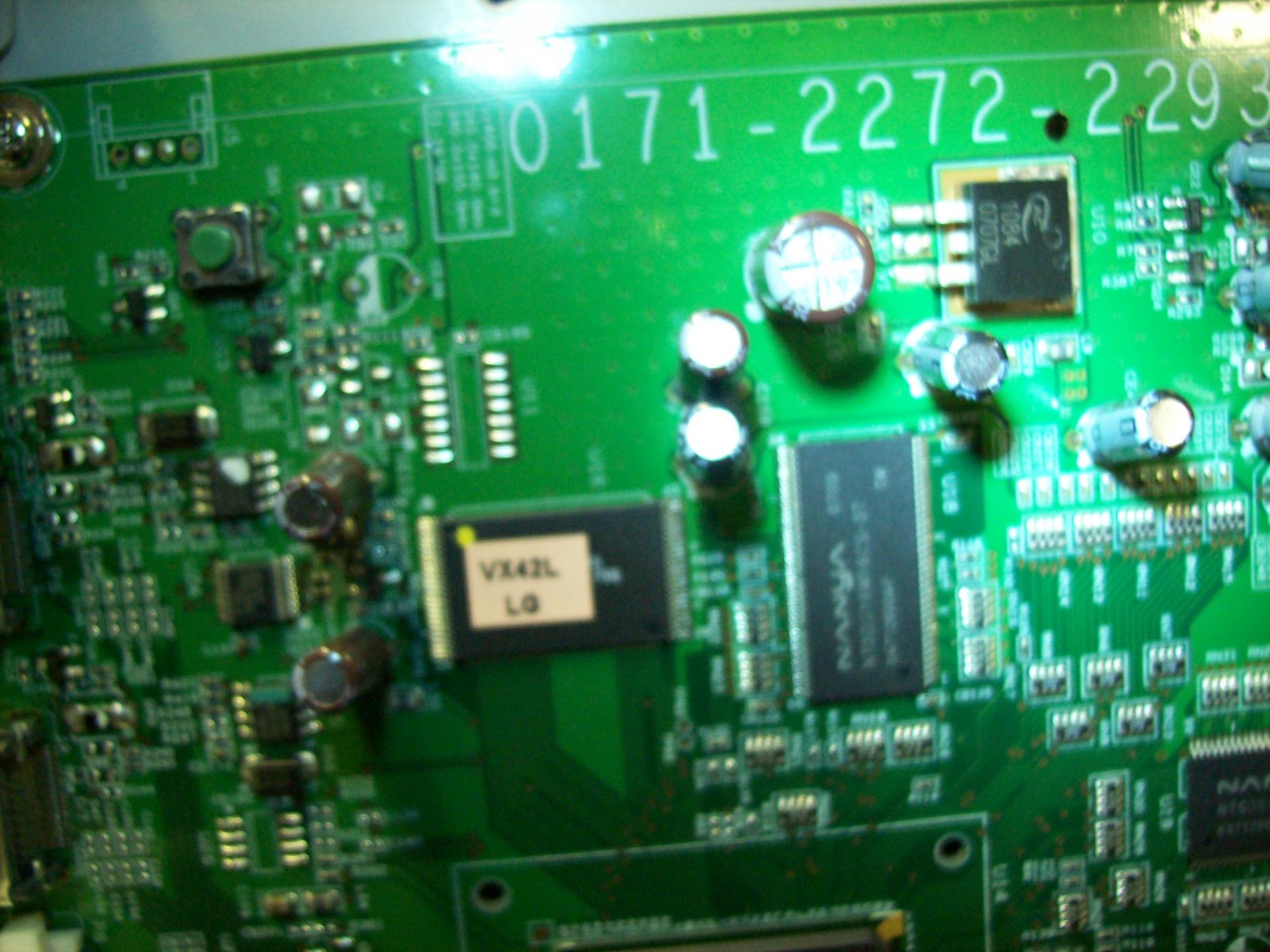

                                        I'm stuck on one chip Bill, it is U10. I took a much better photo of it so you can read the numbers. I looked on Digikey but there are many different voltages. I'm assuming the 07 stands for the output voltage but 0707GL does not make sense to have 7 volts out and in to me. Please take a look as I am on hold here with the order. http://search.digikey.com/scripts/Dk....dll?Selection
