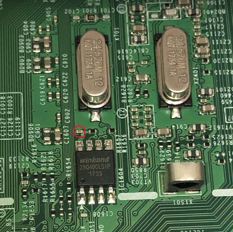

        Originally posted by Me_you_them
        Nothing to do....
        Standby led turns on and immediately off, sometimes led bars turns on and off imediately
        Was this dump native, original, status register (0x88, 0x42) written after recording the dump?
          Yes the dump was the original native one, status register done, i followed the instruction on the post #4

              #106
              What program did you use?
              NeoProgrammer V2.2.0.10 ?
              Did you program the chip through a clothespin or solder the chip through an adapter?​
              I've used NeoProgrammer V2.2.0.10 and I've desoldered the chip from the mainboard and soldered on the adapter to program it

                #107
                Maybe I found the problem...
                I noticed that the component indicated in the photo it's no longer there,​ probably has blown out during the desoldering of the chip.
                Is there any solution?
