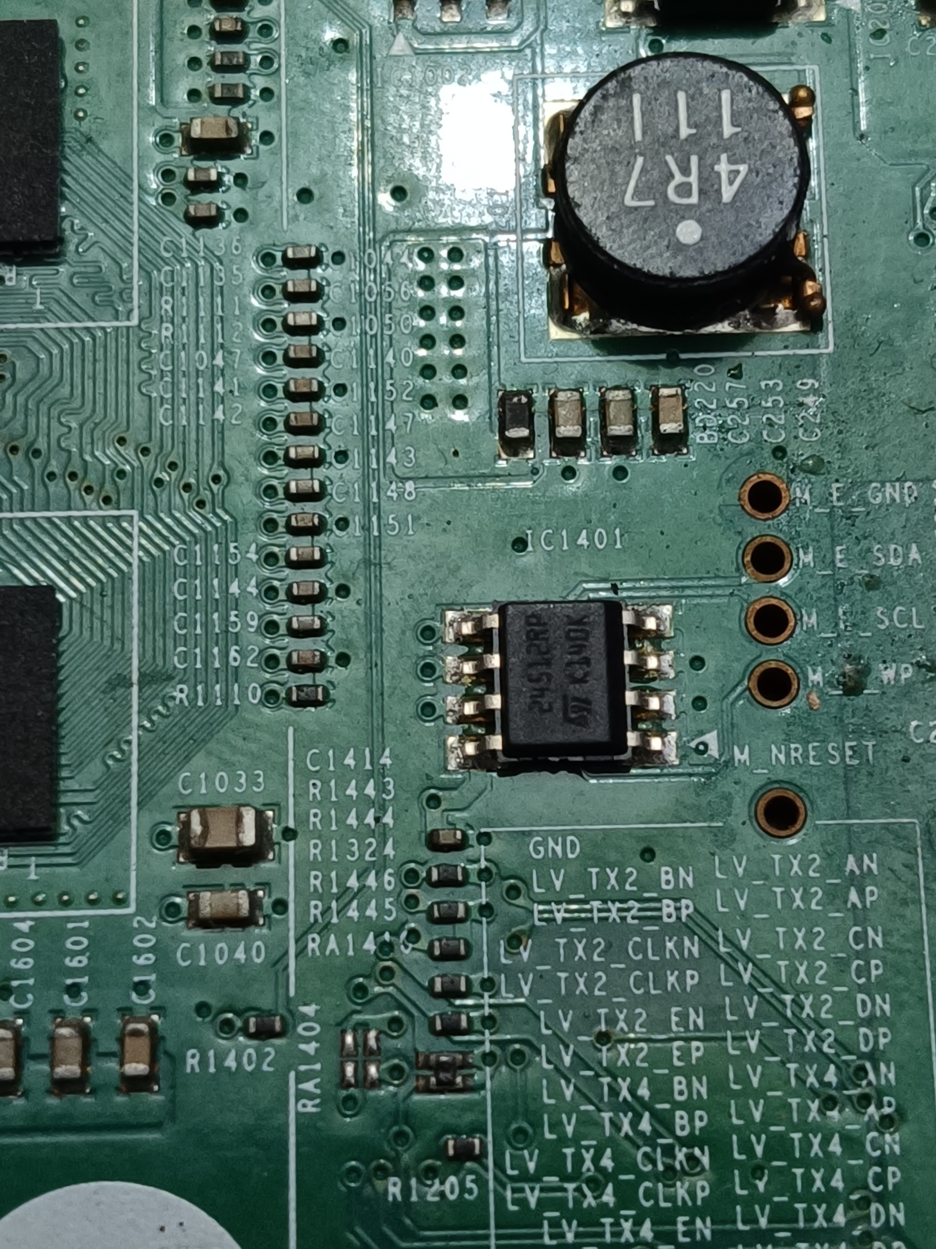

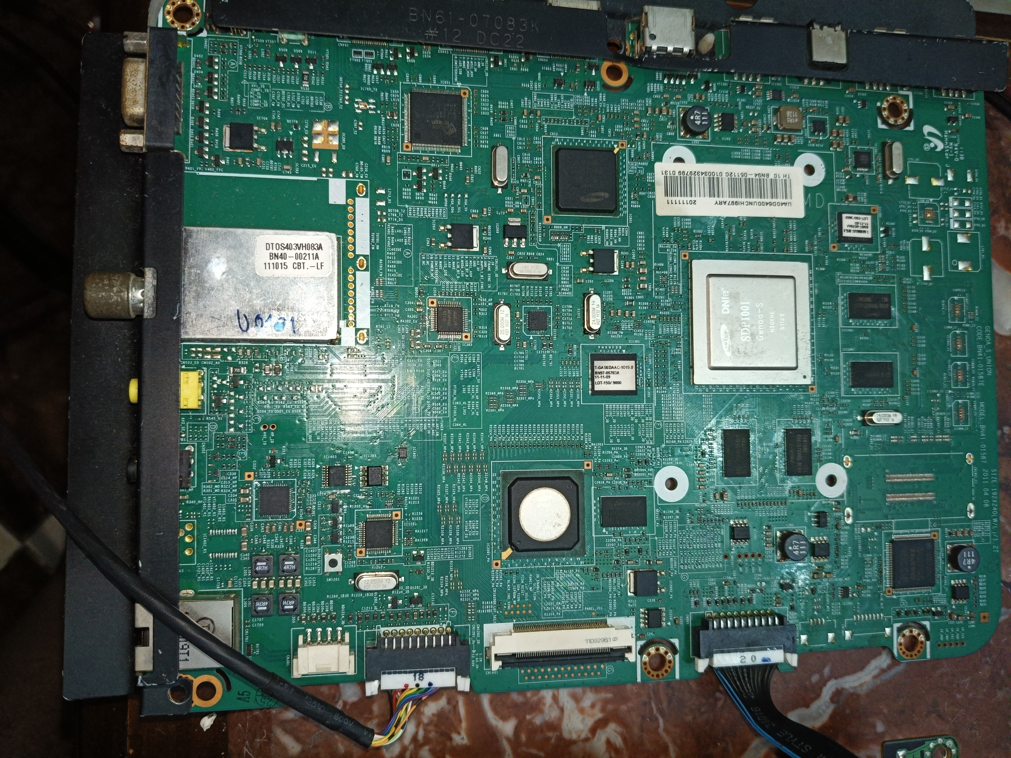

                                Hello
                                Please I need your help with this mb bn41-01587e
                                5vdc exist but standby led not light and no action with power button
                                IC 1401 should be reprogrammed or what?

                                  #96
                                  Dear Sir can you help me with dead main board ( BN41-01587) for Samsung ua40d6400un and power board (BN44-0427A)
                                  i uploaded the flash files from 24c02 (IC 1205) & 24c512 (IC 1401) ​
                                  A5 & 3.3 vdc are exist.
                                  thanks in advance.

                                    #97
                                    Where did you get the idea that the problem is in these firmwares, if there is no standby mode and the LED is not on, then a common problem in this chassis is IC204 (stabilizer from 5v to 3.3v) and micom Weltrend, check the resistance at 1.2 pin IC203 relative ground and is there 3.3v power on these pins​
                                    • Ashry
                                      • Aug 2024
                                      • 10
                                      • Egypt
                                      #98
                                      Thanks for your your support. i found that sub eeprom (24c02) is connected to this ic1203 so i thought this may be the problem.
                                      I measured the regulator and i/p 5.3 v & o/p 3.3 v so it is good, also the voltage at pin 1&2 3.3v and no short with ground. i tried to press the reset button but nothing happened
                                      how can i check ic1203 (61P805) is healthy ??
                                      does it need programing? if yes can it be done by CH341?

                                        #99
                                        What initially happened to the TV? In service mode, at the point you clicked on “Micom Update” and after that the TV stopped turning on?
                                        If yes, then the firmware has been erased in micom, you need to program it.
                                        And also, you have some strange dump 24C512, or it is so badly damaged or poorly read, try this one.
