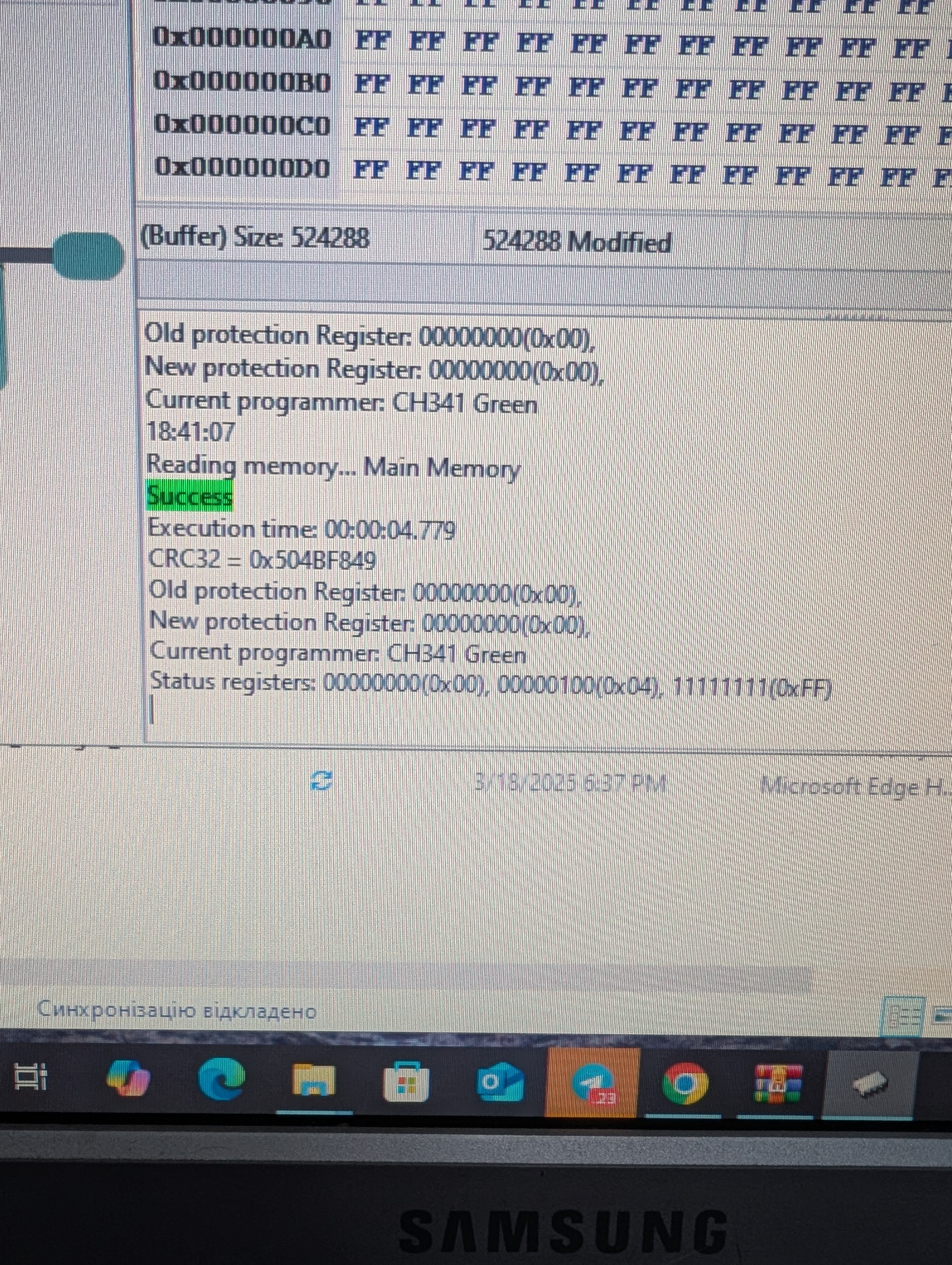

      Originally posted by lotas
      Then check what status register is set, maybe it has crashed (it should be 0x88, 0x42).

        #183
        Dear lotas ,
        After installation in the TV, the status changed to 0x46.

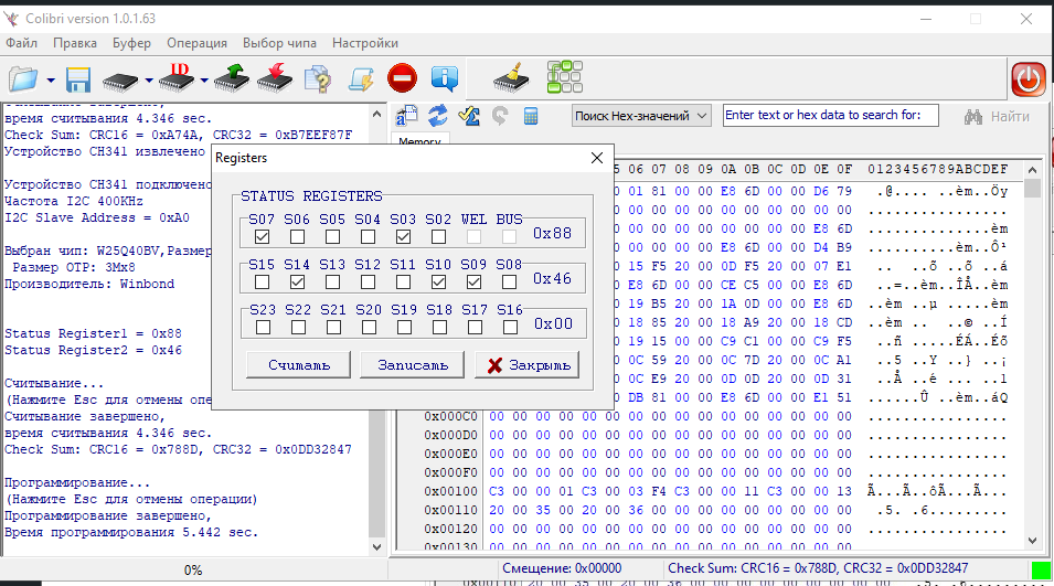

          #184
          There should be only (S3, S7, S9, S14).
          Try to record your native dump again via NeoProgrammer_2.2.0.10.
          In the program:
          1. Click "Detect Chip" and select W25Q40CL and "Select IC".
          2. Click "Unprotect".
          3. Click "Clear IC" and "Yes".
          4. Click "Open File" and select your corrected dump.
          5. Press "Program IC" and "Yes".
          6. Click "Verify IC".
          7. Press the down arrow to the right of "Unprotect" and select "SREG Edit", put a check mark on SRP0, BP1, CMP, QE (S3, S7, S9, S14) and press "Write" and "Yes"
          7. Close the program. Ready.​

            #185
            In the program:
            Dear lotas ,​
            I already have some default parameter set. That's why I can't set the register code 0x42.
