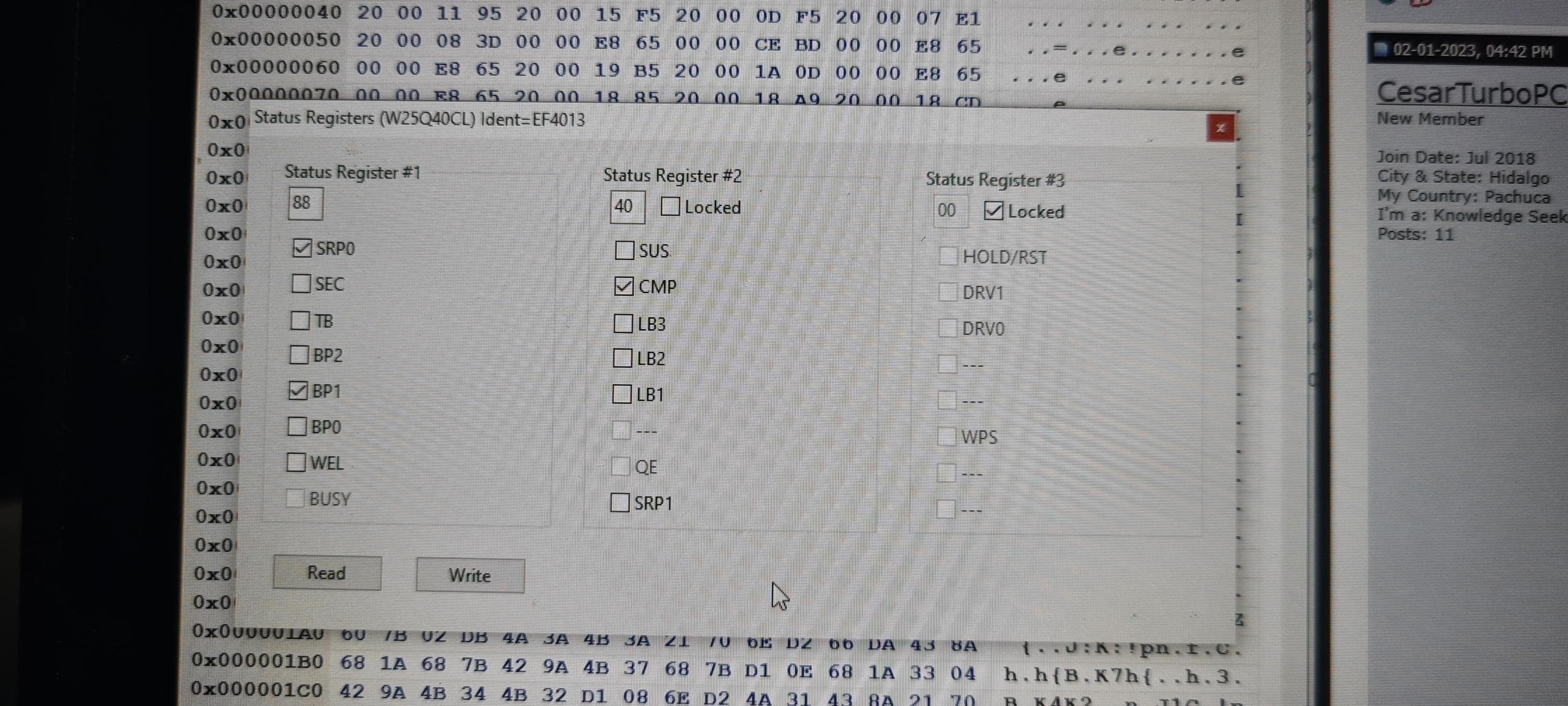

      • CesarTurboPC
        • Jul 2018
        • 11
        • Pachuca
        Re: Samsung UN55MU6103F IC1604 dump
        Thank you lotas, you are crack, it works correctly.
        I should mention that it must be programmed with the CH341.
        Programming instructions with the AsProgrammer program.
        In the program:
        1. Click "Detect Chip" and select W25Q40CL and "Select IC".
        2. Click "Unprotect".
        3. Click "Clear IC" and "Yes".
        4. Click "Open File" and select your corrected dump.
        5. Press "Program CI" and "Yes".
        6. Click "Verify IC".
        7. Press the down arrow to the right of "Unprotect" and select "SREG Edit", put a check mark on SRP0, BP1, CMP, QE and press "Write" and "Yes"
        7. Close the program. Ready.
                            Only in step 7 not everything is possible, could you please help me out?
                            I used the Asprogrammer 2.1.0.13_fix which you uploaded in another post.
                            Update:
                            With Asprogrammer I couldn't figure it out and the TV didn't work.
                            Then programmed with the software that came with the CH431A, there was no possibility to set the 0x88 0x42 status registers. But voila... the TV works again with your fix!!!
                            So many thanks Lotas you are amazing!

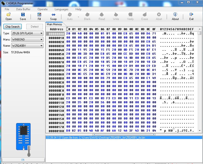

                                • Willail
                                  • Jan 2016
                                  • 29
                                  • France
                                  Originally posted by lotas
                                  Try.
                                  Hi LOTAS
                                  Thank you for the 25Q40BV fix but it doesn't work on my tv. No light on the standby led.
                                  I use the CH341A programmer (erase, blanck the chip and load, write and verify the dump). I put a picture of my software. Could you help me please?
                                    Originally posted by Willail
                                    Hi LOTAS
                                    So he (dump) again flew off when you first turned on the TV, did you set the register status (0x88, 0x42) after writing my dump?
                                    And why do you have W25Q40BV instead of W25Q40CL?
                                    Change the program itself for CH341A to "AsProgrammer_2.1.0.13_fix" or to "NeoProgrammer V2.2.0.10".
                                      I didn't set the register status (0x88, 0x42) after writing the dump because my sofware does't give me this option. When i click detect the chip, the programer solfware say that the chip is W25Q40BV. Do you know some links where i can find tutorial for programming this chip and the good software?
                                      Thanks a lot.
