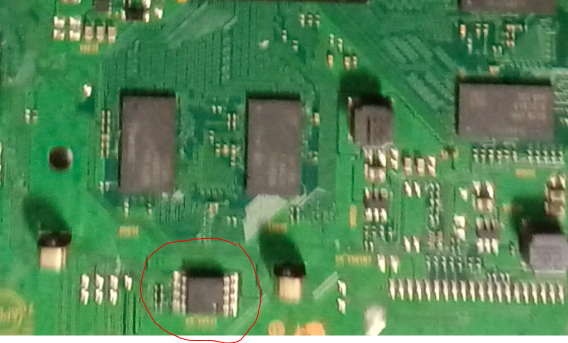

                          Hi I'm making another try but now I'm adding pictures please lotas help me
                          Hi I've read all the post in this thread trying to find something about UEXXTU but not a single one about it except EUXXMU basically my search lies in finding which IC chip corresponds to 25Q40 on my own board :BN94-16627N the patch and BN41-02751B-000 on PCB hopefully lotas can enlighten me
                          • lotas
                            • Jan 2016
                            • 4862
                            • Russia
                            #233
                            Well, is it possible to see anything in such quality photos? Something similar, or this one, or this one.

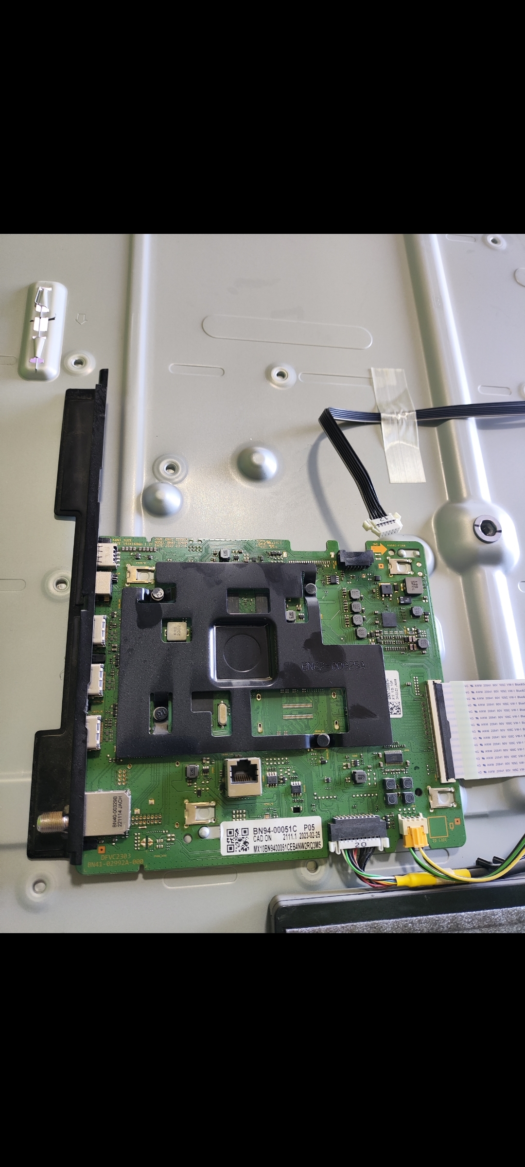

                              #234
                              Looking for eMMC dump for Samsung UN65AU7000F, mainboard BN94-00051C / BN41-02992A. TV is dead, no standby LED. Already confirmed PSU is working.

                                #235
                                Are these better?

                                  #236
                                  This Is my mainboard

                                    #237
                                    Are these better?
                                    What's better? Open your photos yourself and see how visible the markings are on the chips, replace the camera and take a photo with good focus!

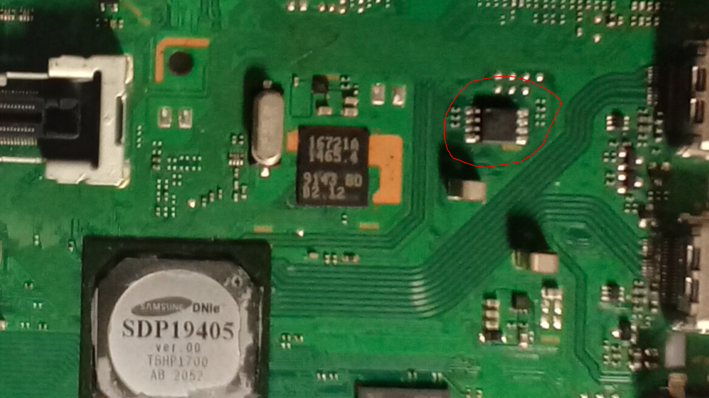

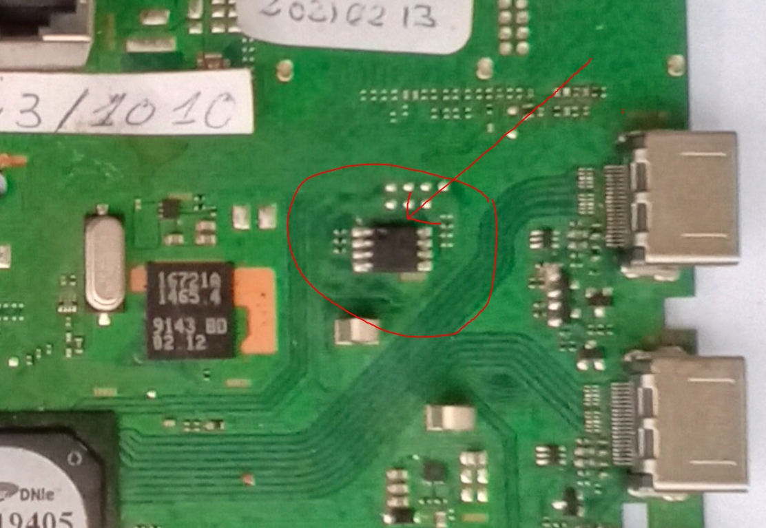

                                      #238
                                      hello again sorry i can't get better pictures with my bad equipment here you have the designation of the four ic
                                      1) 4801A SBL0316
                                      2)G4435SS 2049
                                      3)Q80C-104HIP X00R05 2036HIA
                                      4)Q40B-104HIP X901622 2028HLX
                                      • lotas
                                        • Jan 2016
                                        • 4862
                                        • Russia
                                        #239
                                        1) 4801A SBL0316
                                        2)G4435SS 2049
                                        What you are looking for (25Q40) from the list, then it corresponds to number 4 (Q40B-104HIP)

                                          #240
                                          Thank you so much
