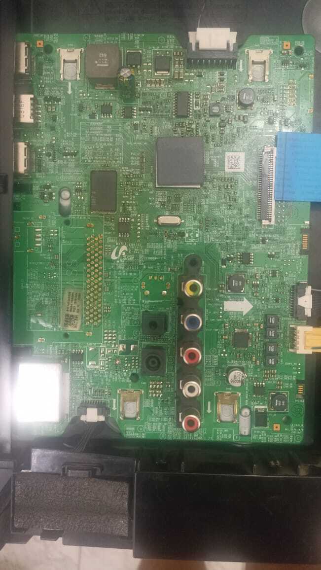

Hi , i have a samsung model ua32k5100 that has its memory image corrupted.
IC 805 W25Q40CL.
Board name BN94-10869Q.
i have tried several images the best ones are when tv comes with samsung logo for 1 second and then reboot and stays black.
original problem with my own image that tv wont turn on and all voltages are ok and the board is ok
can someone pls try to fix my original dump or give me one.
original dump attached .
Thanks a lot.Attached Filesif you find these attachements useful please consider making a small donation to the site

Anything could be wrong, for example, the firmware in the NAND or in the eeprom, is your backlight OK?Comment
yes, the samsung logo shows off for several seconds with backlight on then the logo goes off and backlight stays on for some seconds then the tv reboots. i cant find the eeprom ic. photo of the board attached.
thanks for your help.Attached Filesif you find these attachements useful please consider making a small donation to the site
It's hard to tell from this photo, but the eeprom should be 24c256.Comment
