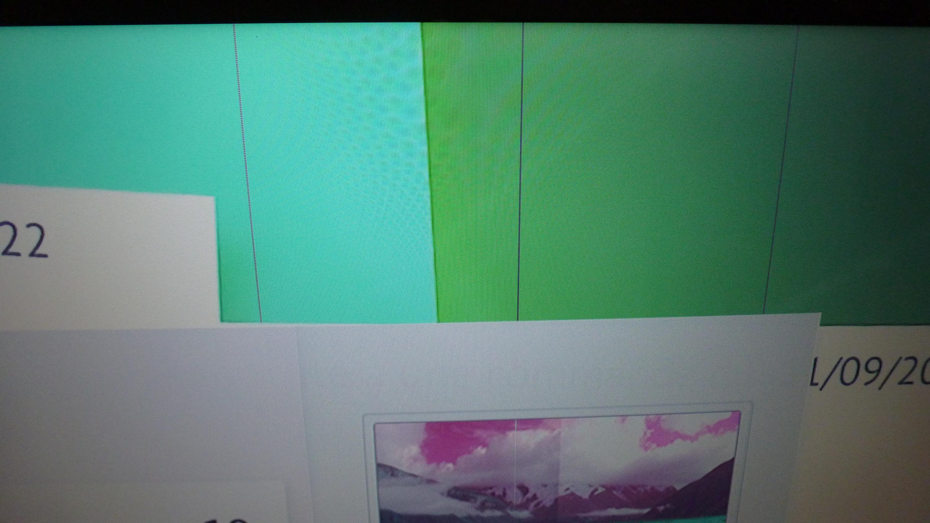

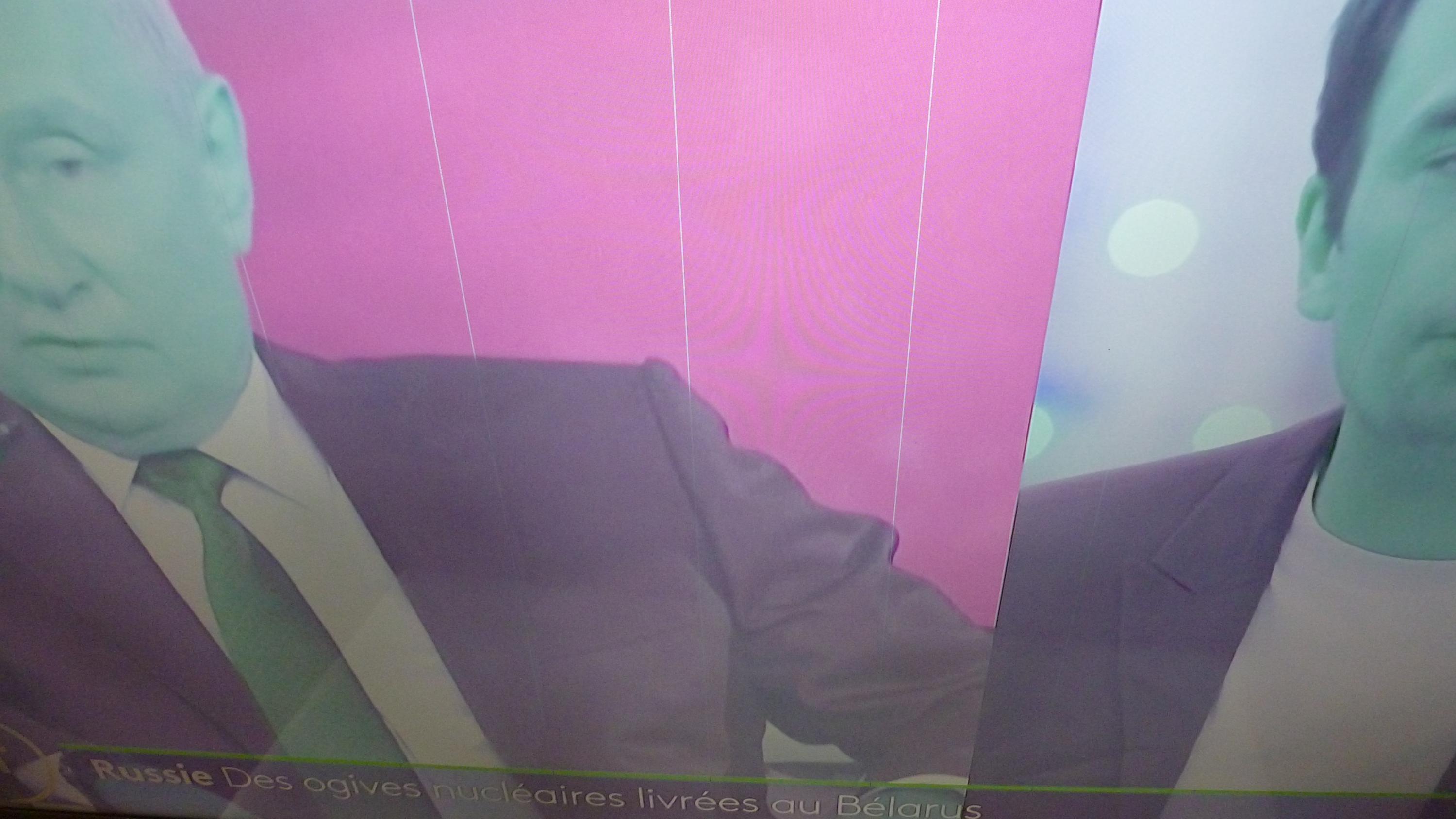

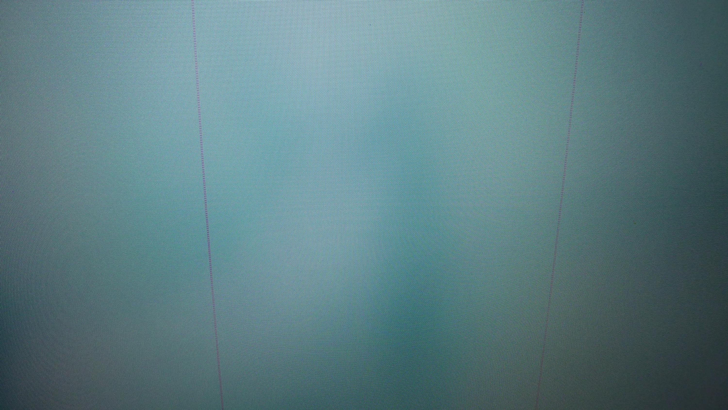

                          I found a motherboard but for another model UE55MU6645 TV.
                          Now the TV starts well and, having not reprogrammed the SPI 25Q80, I have vertical lines on the image and the colors are not beautiful.
                          If I understood correctly, now I have to copy the contents of SPI 25Q80 from the original motherboard to the new one?

                            Re: Samsung UE55MU6102K IC1604 dump needed - TV don't start
                            I put the original SPI 25Q80 (from mainboard UE55MU6105) on the new mainboard (from UE55MU6645) and now the image is perfect.
                            Problem solved
