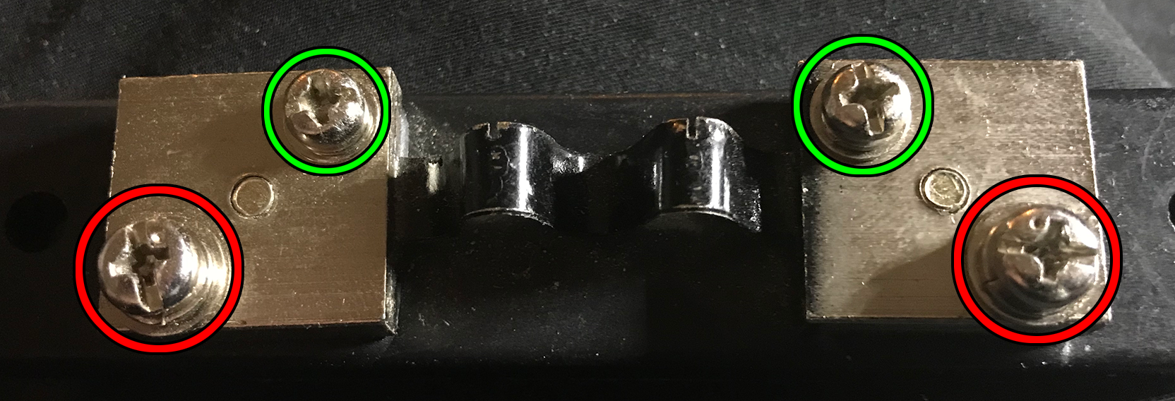

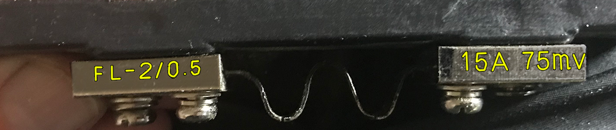

                  My meter will bust a fuse after 10 amps and those fuses aren't cheap.
                  OK, so I read it with this shunt resistor
                  And I read 44mV when it settled down ... initially it was over 50 but that didn't last more than half a second or so.
                  Not sure how to calculate the current based on what I have here...
                  I photoshopped the lettering on the shunt so its easier to see.
                  Also, the red circles are where the wire was connected and I took the reading at the green circles.
                  After doing some Googling, I think what I'm seeing here is that there is 8.8 Amps on the 12V side.
                  And if that is the case, then if I double the amps, that would be roughly 16 to 20 amps on 12 and about 10 to 15 amps on 5 ... wouldn't an ATX work in this situation if I got one rated for 1,000 Watts that could handle 25A on 12V and 15A on 5V as a minimum requirement?
