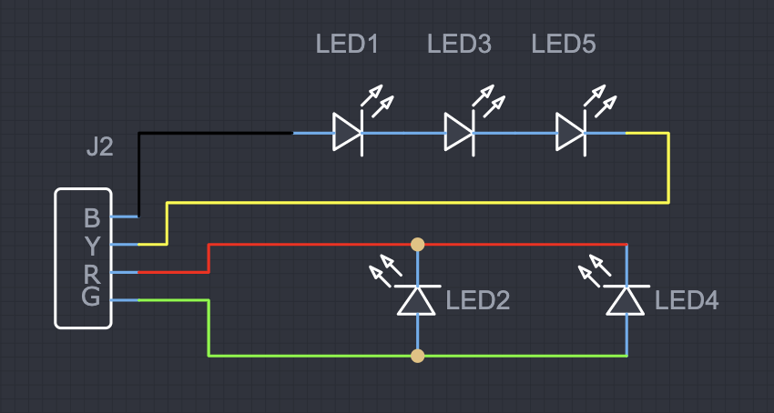

            So the plot thickens ... a little ...
            Here is the schematic of ONE of the 5 LED strips ... on the PCB, it says that it is 5 - 3 BLUE
            The 5 - 3 might mean that LED 5 is Blue and that there are three blues on the PCB because LEDs 1, 3, and 5 are BLUE and LEDs 2 and 4 are a white / yellowish color.
            They seem to power just fine with 3 volts at 100ma so 9 volts @ 100ma for the series LEDs and 3 volts at 200 ma for the parallel set worked perfectly.
            The other type of LED strip PCB is wired the exact same way, only difference are the colors.
            On the PCBs that say 5 - 3 C, in the odd numbered LEDs, 1 and 5 are that white / yellowish color with the center LED (3) being CYAN and the two parallel LEDs (2 and 4) are both blue so on those strips, we have
            White - Blue - Cyan - Blue - White
            And on the first PCB we have
            Blue - White - Blue - White - Blue
            Now, I only drove these at 3 volts. They could very well be 4.x volt LEDs at which point it would require 12 Volts to drive the series LEDs and the 5 volts could drive the parallel LEDs. They could be connecting the MOSFETs in pairs where each pair is dedicated to the entire set of 5 rows, one pair switches in the 12 volts for the series LEDs the other pair of MOSFETs would be driving all of the parallel paired LEDs using the 5 volt line from the PSUs.
            That makes the most sense to me anyways.
            The alternative could be that they are 3.2 volt LEDs and that the controller board never pushes the MOSFETs into full saturation.
            OK, now - I took out one of the LED driver boards and am going through it, but where the connectors to each LED strip are concerned, this is how they are all wired in relation to each other on the PCB they connect to.
            The Black and green on the edges of each connector are all wired together on all five connectors. But the Yellows and Reds are only connected together for three of the strips and the two offset strips have their Red and Yellow wires connected to each other.

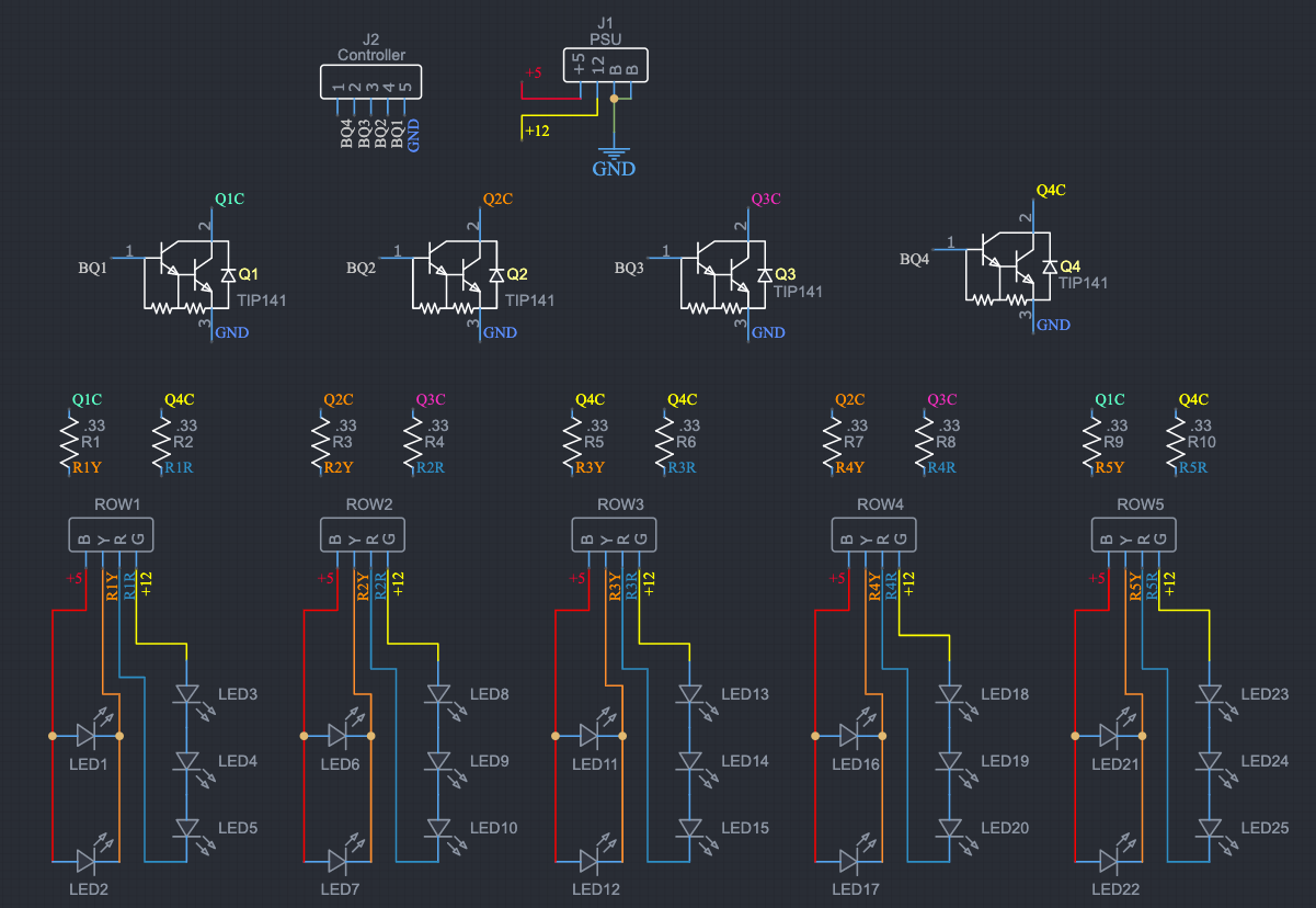

                  #108
                  Re: Fish Tank LED Power Supply Gets Hot then shuts down
                  Here is the LED Driver board schematic ... this shit is kinda WHACK if you ask me.

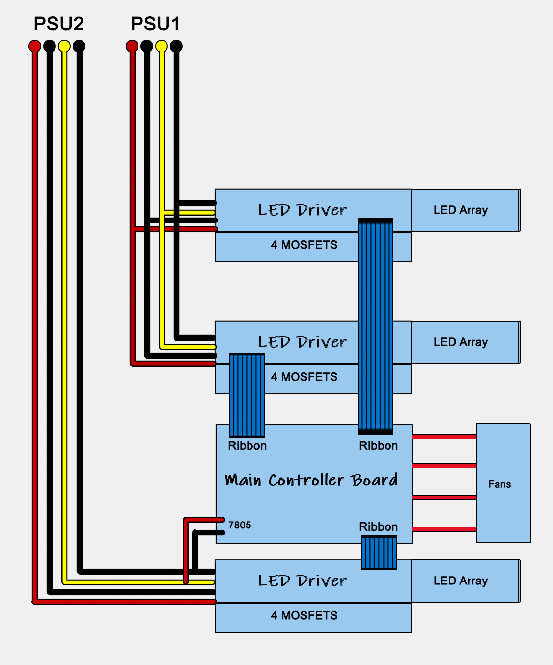

                    I was also wrong about the power feed from the PSU to the main controller board. The hotline going to the main controller board is +12, and the black wire is ground from the PSU.
                    What's been so confusing this whole time is that the cables they use to connect to the PSU are not the same color wires as the wires inside the PSU.
                    But this is how they actually map out, and the melted wires going to the main controller board are red and black, where Red is connected to the black wire which is +12 from the PSU and black is connected to the white wire, which is GND from the PSU:

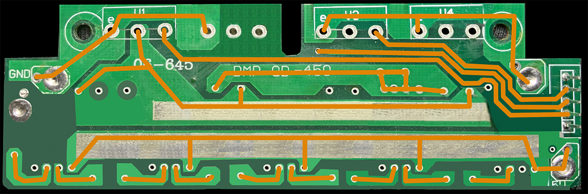

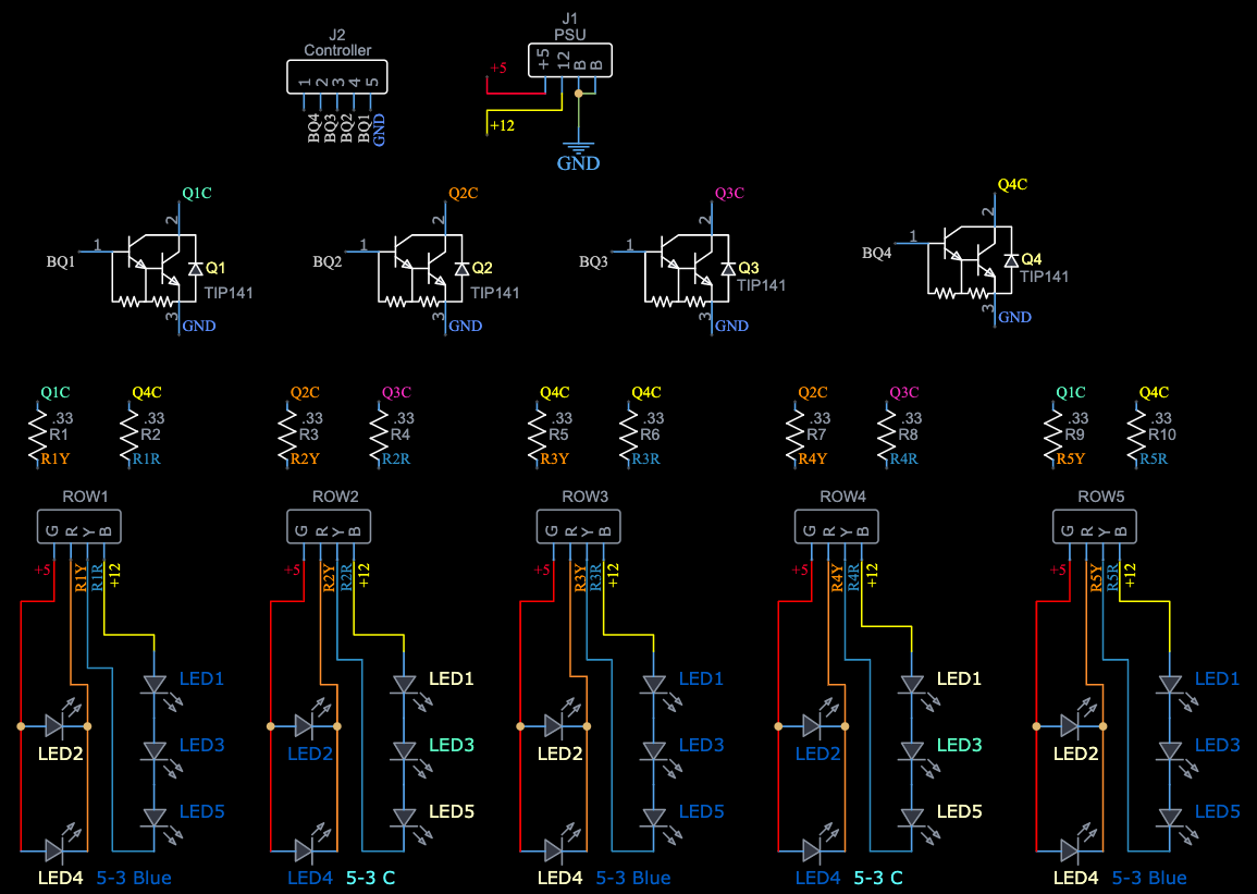

                      And for anyone interested ...
                      Here is the front side of the PCB with its traces connected with orange lines
                      And here is the back of the PCB in mirror image with its traces connected with yellow lines
                      Here is the front PCB image again with both front and back traces
                      And here is the PCB with all traces, resistors and labels
                      And here is the schematic with the LEDs properly labeled in their respective colors

                        • 31063
                        #111
                        load balanced between the 5v and 12v - not bad.

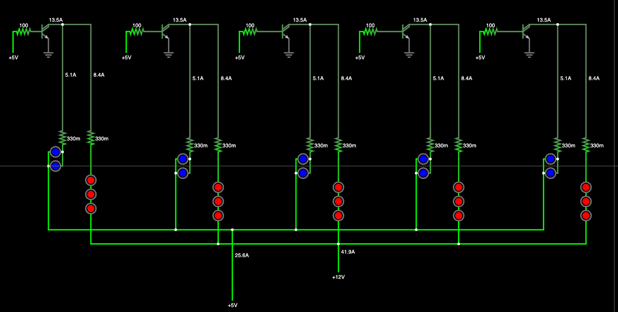

                              I'm not sure what you consider balanced, but based on the current draw that I used to light up a row of LEDs, here is the load that would be placed on each transistor
                              In fact, I threw the circuit into a simulator and though I know the values aren't accurate, the LEDs are all set the same and clearly you can see that Q4 is the redheaded step child in this family...
                                    So, given how this thing is actually wired up, does anyone see a problem with me wiring it for a single 1,000W PS vs two 500W PSUs as it is now?
                                    sigpic
                                      Seems to me this would have been a better design for this unit vs what it is now.
