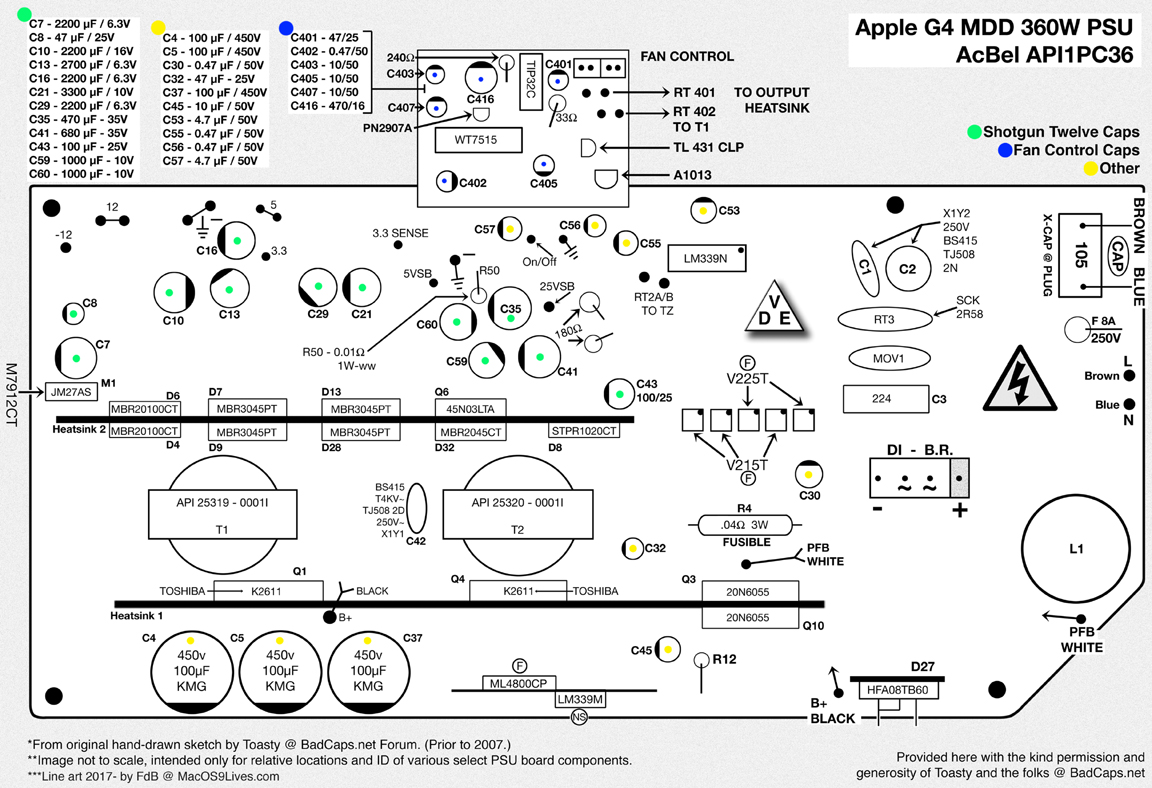

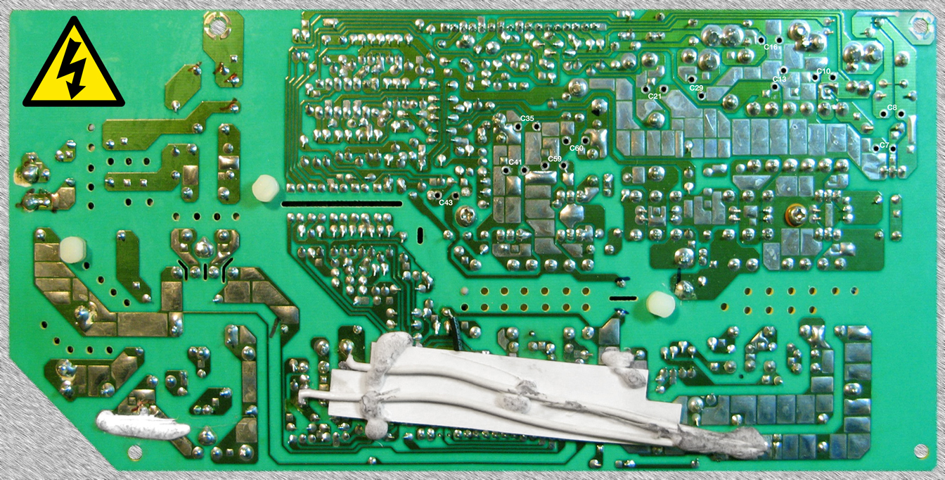

Power Mac G4 MDD "Mirror-Door" won't power up
    #101
    Re: Power Mac G4 MDD "Mirror-Door" won't power up
    You should check the IC that drives Q1 and Q2 since when MOSFETs shorted out they will take out the IC with it, it will damage the new MOSFETs if the Gate drive outputs of the IC stuck on.
    • haroldblum
      • Jan 2015
      • 8
      #102
      Originally posted by haroldblum
      Thanks for the info I will replace Q1 and Q2 also
      By the way would you happen to know where I can find these parts?
      ntc thermistor sck-048 4ohms 8amps
      I will try looking up the transistors after I figure out how to get the nut and bolt off of them to de-solder
      Also the fuse size was 240v 8amps can I use 120v 8amps
      Can I use a 5ohm 8amp for the thermistor?

        It looks like the filter cap fails open on these. From page 2 in this thread:
        Originally posted by Toasty
        IF the mains cap is a CapXon HP, it -MUST BE REPLACED-. There is a marked history of failures in this series of capacitor (even from a Ukraine electronics site via kc8adu) in which the cap either goes open or shorts then opens. It invariably causes the main switchers Q1 & Q2 to fail (STW20NM50FD) and the primary fuse (8A/250v, Slo-Blo, 5x20) to open (usually violently) as the blackened glass indicates. I recommend a replacement with a ceramic bodied fuse here (Schurter 0001.2513). Another failure can be the destruction of the inrush limiter TH2 (SCK-048).
        Check everything else budm and Agent24 mentioned as well.
              A good precaution, but after several dozen repairs, I've never found this to be bad. ML4824IP1 - It's on the daughterboard next to the main heatsink.
              https://www.fairchildsemi.com/produc.../ML4824-1.html
              On the opposite side of that board is the quad comparator KA339.
              https://www.fairchildsemi.com/produc...ors/KA339.html
              T

                #107
                Just check the resistance between VCC pin 13 and pin 12, Pin 13 and pin 11 to see if it shows low resistance.
                Then check GND pin 10 and 11, GND pin 10 and 12 to see if they are shorted to GND. Shorted to GND will not cause damages, just there will be no drives.
                  DigiKey has everything.
                  - UCC SMQ series cap, 390uF@450v - $5.25
                  - inrush current limiter, 4 ohm cold, current steady state 9.5A - $2.65
                  - ceramic fuse, 8A @ 250v, 5 x 20 - $0.36
                  - (2) MOSFETs, Q1 & Q2 - always replace as a pair - $5.25 ea.
                  Also, the caps that are hidden by the main heatsink as shown in:
                  https://www.badcaps.net/forum/showthread.php?t=10136
                  C135, 137 - 56uF@35v, 6.3x11 - HE, KY, FM (50v)
                  C141 - 47uF@25v, 5x11 - HE, FM
                  See also this thread: https://www.badcaps.net/forum/showthread.php?t=7165
                  Toast
                  You listed ceramic fuse, when I opened the ps there was a 250v 8A Glass fuse
                        Glad you got it working. Did you replace the mains cap?
                        I've now gone to replacing all 5 of the small caps in that startup area.
                        It's just not worth the aggravation to do it twice.
                        3 on the main board:
                        C135, C137 = 56uF @ 35v
                        C141 = 47uF@25v
                        2 on the PFC/PWM controller board:
                        C129 = 22uF@50v
                        C130 = 10uF@50v
                        Toast
