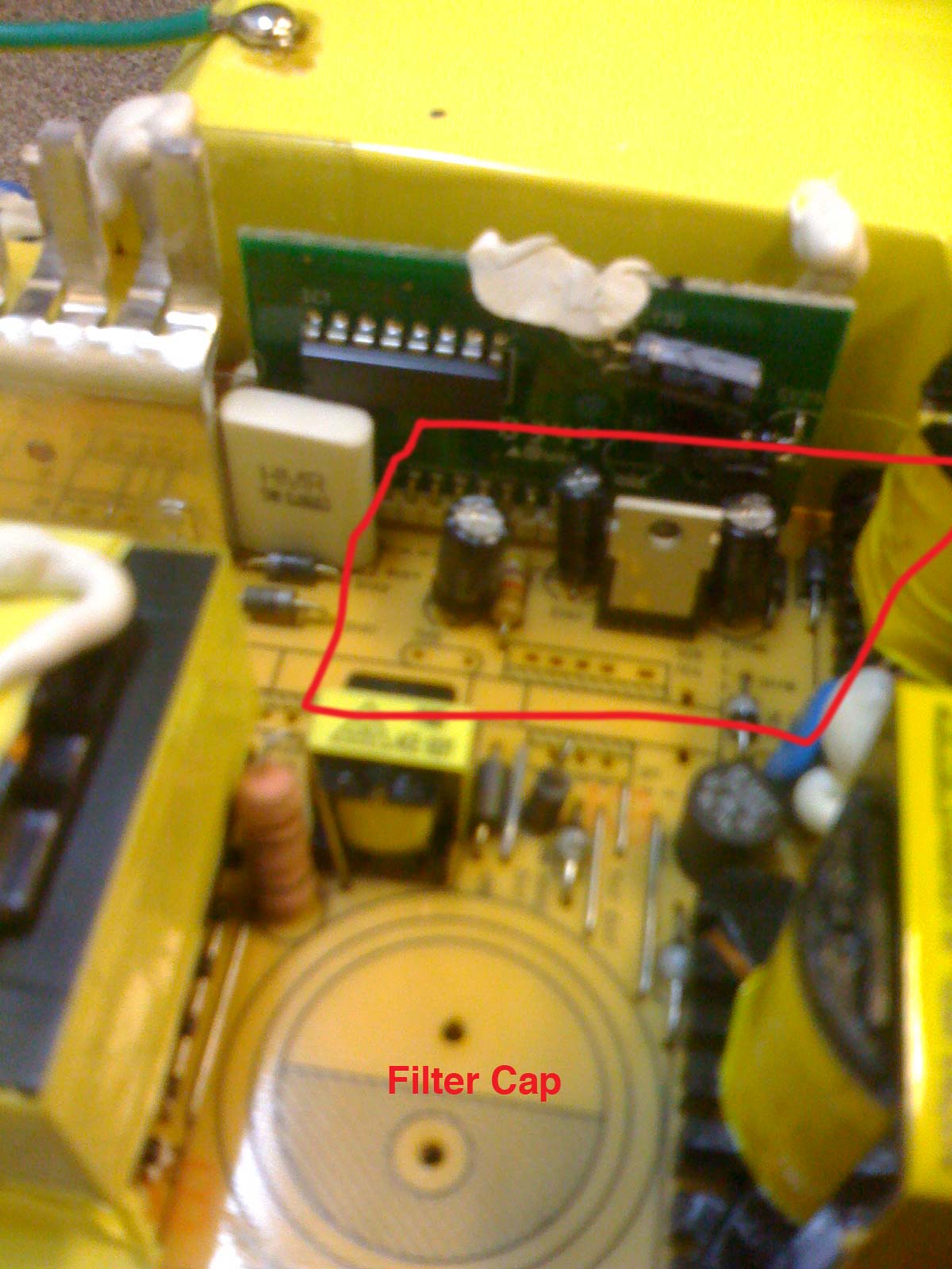

            Samsung's on no-start are a few small caps down behind the PWM board next to the center/larger heatsink with the primary switchers on it. The little board is mounted upright next to the heatsink and the caps to be replaced require you to remove the entire heatsink and components. MIND THE THERMISTOR!!! Desoldering station makes it a 5 minute job. Wick and iron, 10 minutes.
            Again, check the primary cap as you have on the other G4. If it's CapXon HP, replace it. These can go "weak" and not blow the fuse or switchers.

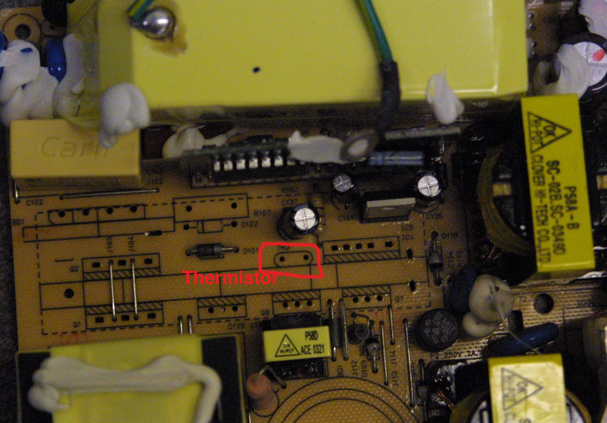

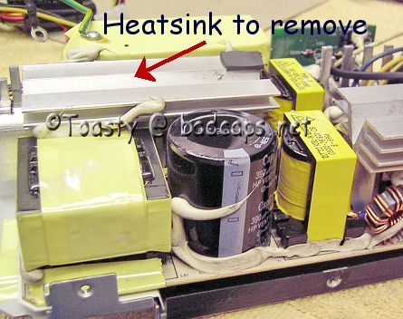

                                How the hell do you guys get those heatsinks out. There must be a way to pull the caps without taking it off. I can't see myself desoldering all that. what if you just unscrew the components and pull away the heatsink.
                                • Toasty
                                  • Jul 2007
                                  • 4171
                                  Re: Power Mac G4 MDD "Mirror-Door" won't power up
                                  You are welcome to try, liebchen.

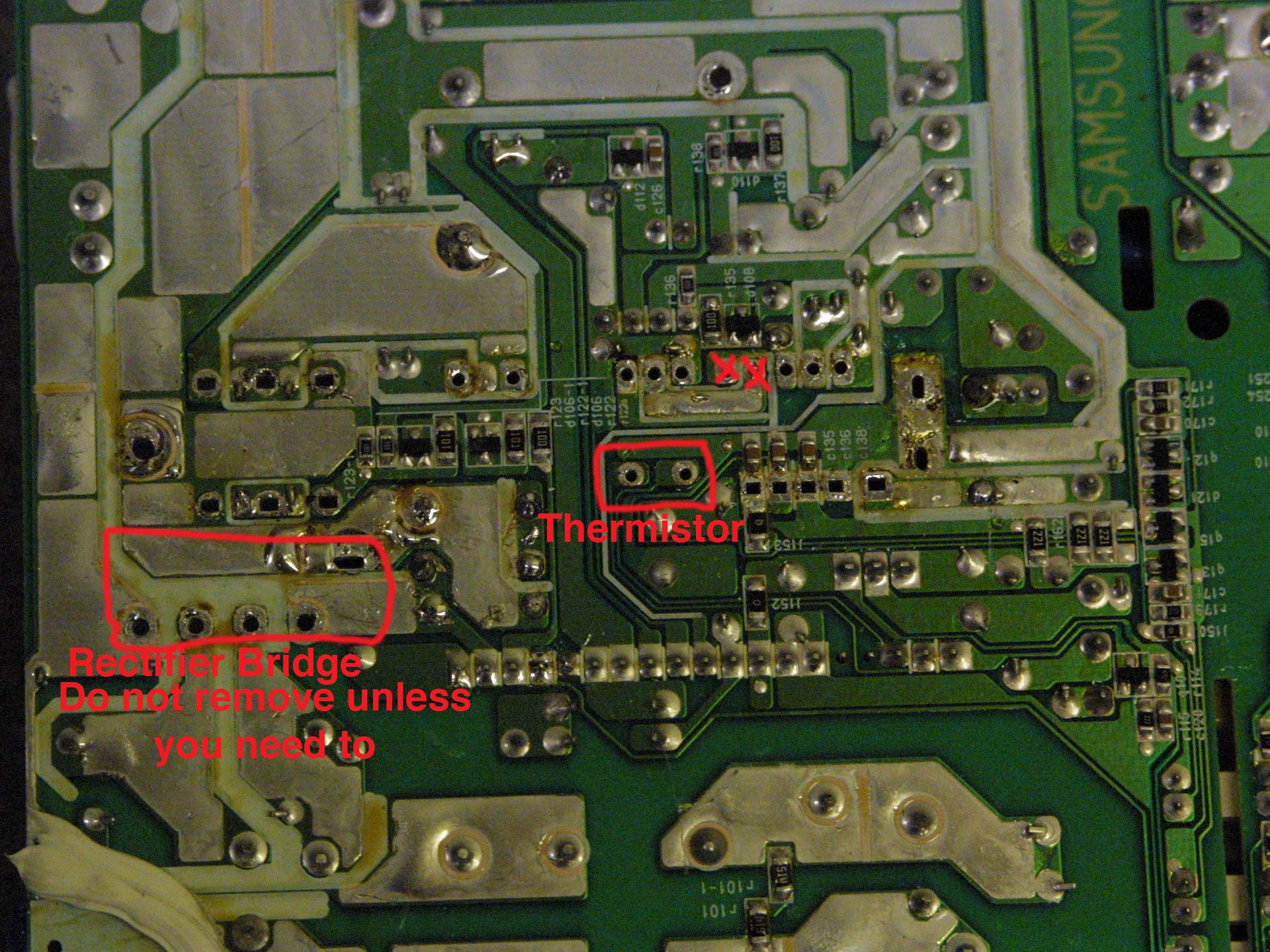

                                    You need a good desoldering iron. If you don't have one, it's a great investment. Without one, you might as well not even try. You want a vacuum one. A decent one (non-motor) is in the $50 range I think. The one I have was given to me as a gift. DON'T mess with the crappy bulb-type ones at radio shack. They're just above worthless.
                                    I'll post pictures of the board shortly that show which you need to desolder in order to get it out.
                                    The thermistor is a real b*tch. That is the only issue. So you must have everything desoldered fully and then SLOWLY work the heat sink up EVENLY.
                                    Also, here's an update. I replaced those three caps with new Panasonics and now the G4 powers up every time. THANKS TOASTY!!!!

                                      Excellent work! Thanks for posting the results & glad you got it fixed!
                                      Hint on the thermistor: Unsoldering it first relieves the tension on its legs. Make sure its wires are *completely free* in the holes. Then proceed to unsolder the rest of the components.

                                        Here are the photos as promised. Hopefully this will be helpful in the future.
