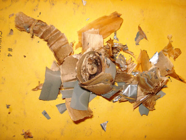

      FIRE!
      ah, fun! i hope nobody got hurt... pics?
      No, I wasn't hurt. Glad I wore sunglasses! When I saw the cap jump, I backed away and then it exploded in flames. It exploded so hard it ended up jammed into the heat sink next to it so I had to pull out enough guts to loosen it up. You can see the dent on the top where it was wedged. One pic is the guts I pulled out and the other pic is the shell that remains. I think the fire burned up most of the oil because the surrounding board was mostly covered with tissue and metal bits.
      I ordered replacements from Digi-key (thankfully we are both in MN) and I hope that will fix my tv.

                lauriloo; that's pretty cool
                What was the brand of the capacitor?
                • lauriloo
                  • Jun 2010
                  • 6
                  Re: Snap in Capacitors
                  The infamous Samwha brand that is plaguing lcd tvs.

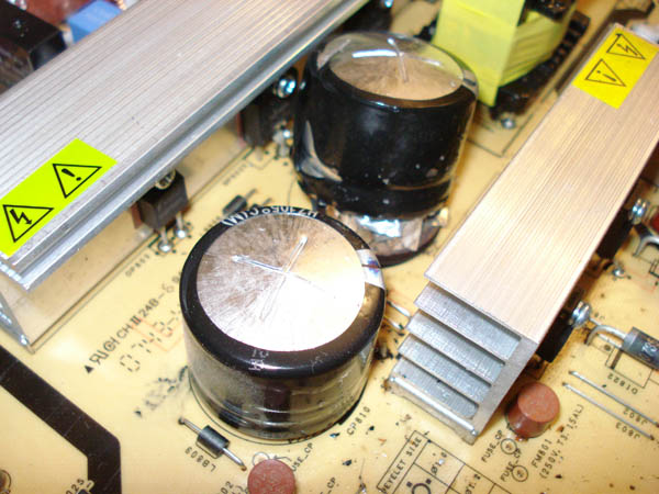

                  • seanc
                    • Nov 2008
                    • 1319
                    #29
                    Oh yes, the remaining bulging capacitor definitely = toast.
                    Glad you're OK - hopefully after replacement everything will be working fine
                    • lauriloo
                      • Jun 2010
                      • 6
                      #30
                      Replaced the caps myself (first time soldering a board!) and the two snap in fuses that were blown. The tv has been on for five hours so far, no hissing or issues whatsoever. yay!
                      • Sparkey55
                        • Jan 2010
                        • 1523
                        #31
                        WOW. After such a cap failure like that it would be a good idea to check the power diodes fuses and current limiting resistors BEFORE applying power for the first after a recap job.
