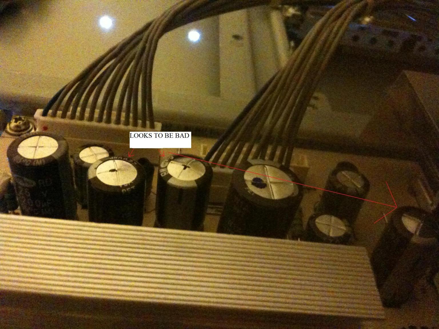

          Here is a picture of the capacitors. Are SAMWHA capacitors okay to buy and put back in or should I buy something different? Anywhere good to get them or just go on Ebay? Also, can anyone send a link of how it is best to solder. I soldered back when I was a Boy Scout but that was quite a while to go. Thanks again!

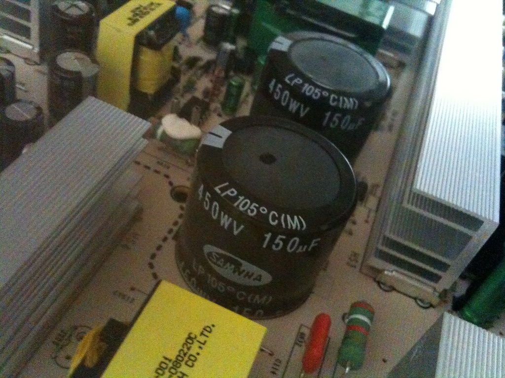

                    the 1st picture shows 450v 150uf x2, outputting 300uf. I believe parallel caps have a longer lifespan compared to a single cap. I see nothing wrong.
                    the second picture shows at least 3 bloated caps. This is the problem when they bloat; they lose capacitance and gets high resistance. Then they make the semiconductors take in more current than usual.

                      The caps in the second picture are most likely to be your problem. replace them first.

                        Agreed but the noises are coming from the two big capacitors.

                          Replace the smaller capacitors first, if the tops of the big capacitors feel flat, leave them alone for now.
                          In this photo:https://www.badcaps.net/forum/attach...chmentid=16217 it looks like there is one in the top left hand corner which is actually open.
                          You could test the big caps with an ESR/capacitance meter.

                                Discharging is simple. First measure, then, if theres significant voltage on it, use a power resistor like 10kOhm 10W (with old multimeter test leads connected to it) to discharge safely, then re-check for voltage.
                                For your actual problem, replace all of the smaller capacitors, Samwha is known to be trash, and on your pics several of them are faulty, and these that are not yet burst open, will fail soon.
                                I would use United Chemicon KY or LXY, Nichicon PW, Rubycon YXF or ZL, Panasonic FC,FK or FM series as replacement.
                                If you want to do a good job and the device is worth it, replace the larger Samwha capacitors too, with 105° long-life parts from Panasonic, Rubycon, Nichicon, Chemicon, BC Components or Epcos.

                                    In the top left corner of the first photo, a(nother) vented cap is visible (not sure if it's in the second photo as well). If that's buzzing, could it be close enough to those snap-ins to make it seem like they're making sounds?

                                      The placement is pretty different, but maybe the vented caps are causing the sound to come from the larger caps because they have to work harder maybe. I bought plenty of each and will most likely replace all with rubycon caps in order get rid of the samwha caps. Thank you.
