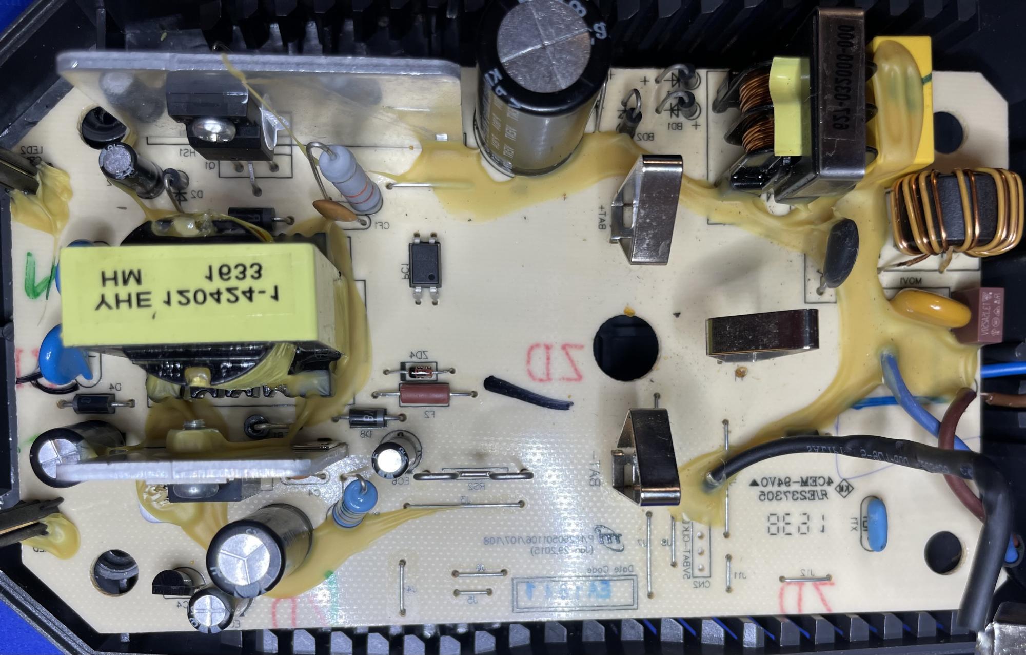

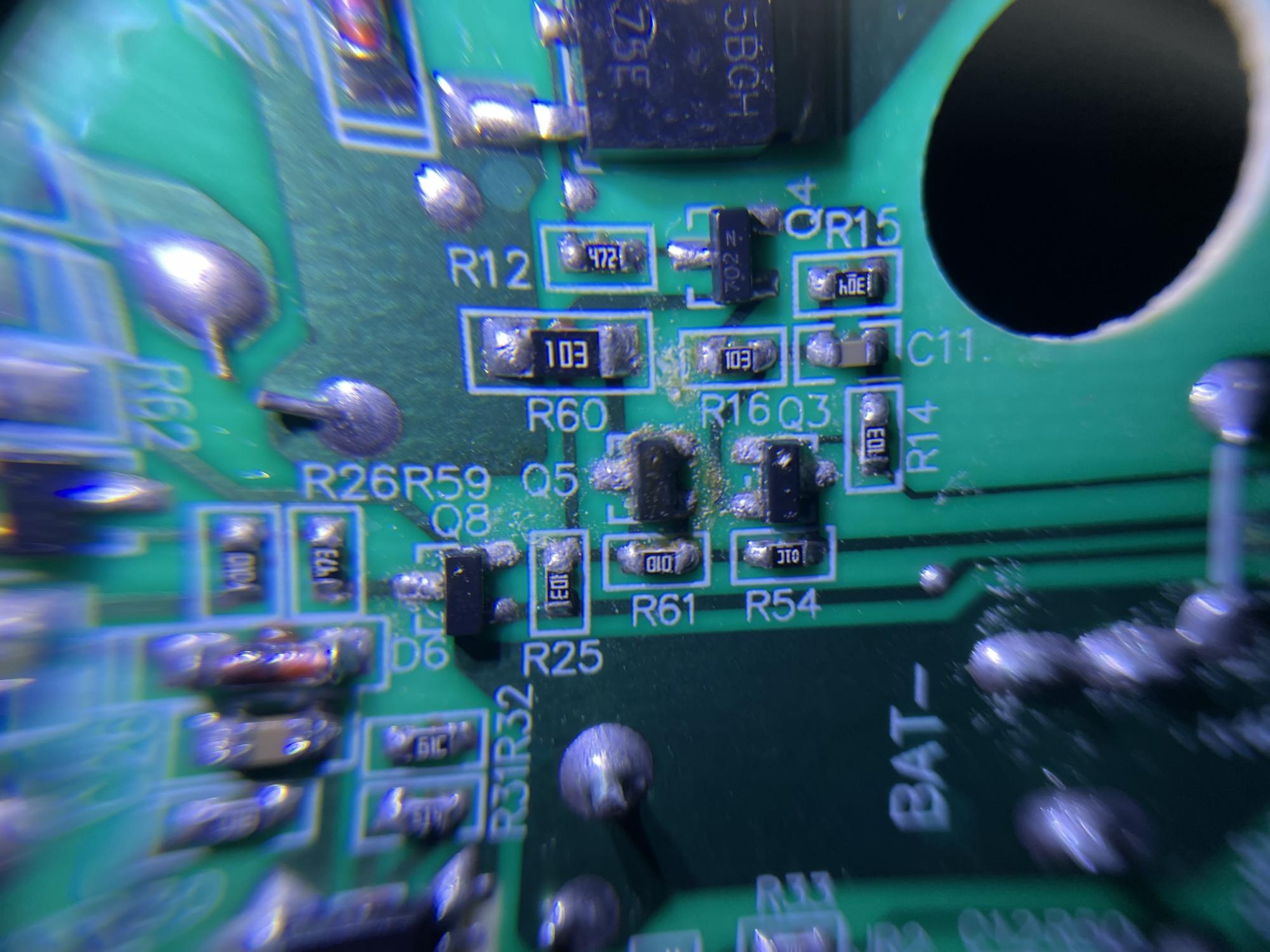

    I have this EU-version of Ryobi charger which doesn't show any lights when plugged in, but the green led blinks after disconnecting it from the wall socket.
    I started troubleshooting by reading this thread https://www.badcaps.net/forum/showth...ighlight=ryobi but I guess it is for an older model.
    I found couple of SOT-23 mosfets/transistors which look pretty bad (Q5, Q3). Cannot see any markings on them, does anyone know what they are and could these be the reason why the charger doesn't work? Similar components can be found on the PCB with markings 1AM and 702…
    No voltage on BAT+/BAT-, but main cap has 330ish volts and 50V 470uF cap on the secondary side has 30V after unplugging so at least something is getting from primary side to secondary side?
    I'll clean the board tomorrow with IPA and start measuring diodes, resistors, caps etc but can someone give me some guidance what to measure and what to look for?
    Thanks!

    Re: Ryobi 18v BCL14181H MY2015 charger dead
    start by resoldering the main transformer and r9
    they have bad joints
      Is the fuse (red body) F2 (right next to ZD4) OK?
      It is an always on power supply that is why you are getting 30V on the cold side.
        Thanks guys, I'll check the joints. Fuses are ok, forgot to mention it..
          The markings on Q3 and Q5 are now visible, both are 1AM. And they look ok.
          While resoldering I managed to burn one of the pads on the EC2 near R9… now it has a very dodgy looking repair, but it works. Maybe my ThermoPasty flux gel wasn't the correct option and that's why the pad got burned, don't know.

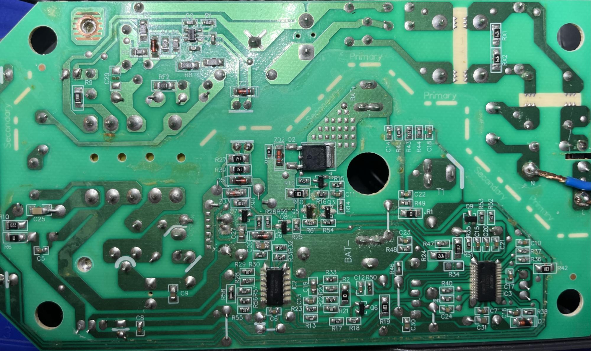

                    Do you have any voltage across the filter cap in the secondary? On the bottom view there is a chip cap marked C9 which is also across that cap.
                    You won't have any voltage across the battery terminals unless a good battery is connected.
                      Thanks for your reply.
                      Before I noticed your message, I measured the board live and noticed pulsating voltage on EC2 near D2, it was 9-13ish volts. And on the working charger there's steady 19.9 volts. Something to do with defective IC1 or what else could make it pulse like that?
                      C9 had 7.41v if I remember correctly, and on a working board it was 15.4v. I guess that filter cap had the same 7.41v.
                        There is a small electrolytic beside D2 in the primary, I would replace it. And another small one in the secondary marked ECP?
                        It seems like the power supply is in burst mode, A low vcc to the primary switching ic could cause this.
                        Check and post the voltage ACROSS the elec. cap. next to D2, this should tell us what the state of the ic is in.
                            The primary pwm controller will shut down at 10v on the VDD (VCC) pin, I would replace EC2 first and see what happens.
                                At last I had a chance to get back to this!
                                Spare parts had arrived as well so I replaced some parts, including IC1, Q1 and EC2.
                                After plugging in green and red LEDs blinks, so I didn't fix it yet. Measured EC2 and it's still 10-14ish volts...
                                Next step replacing the small EC6 in the secondary?
