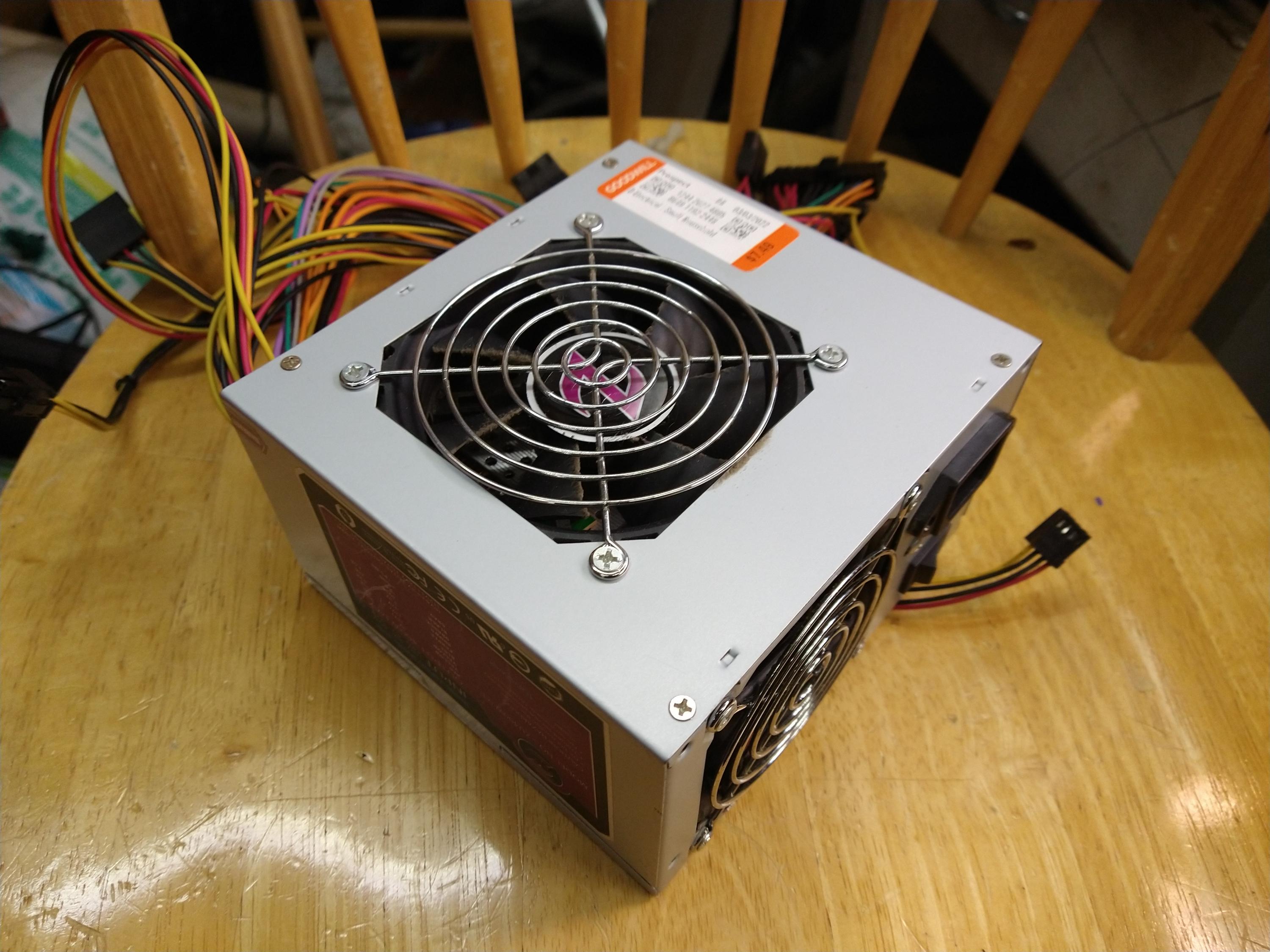

    From the build qulaity pictorial. One of the worst ATX PSU's I have seen in a while.
    I love how they dated the warranty from the time of manufacure (not the time of purchase). FAIL.
    Photo:

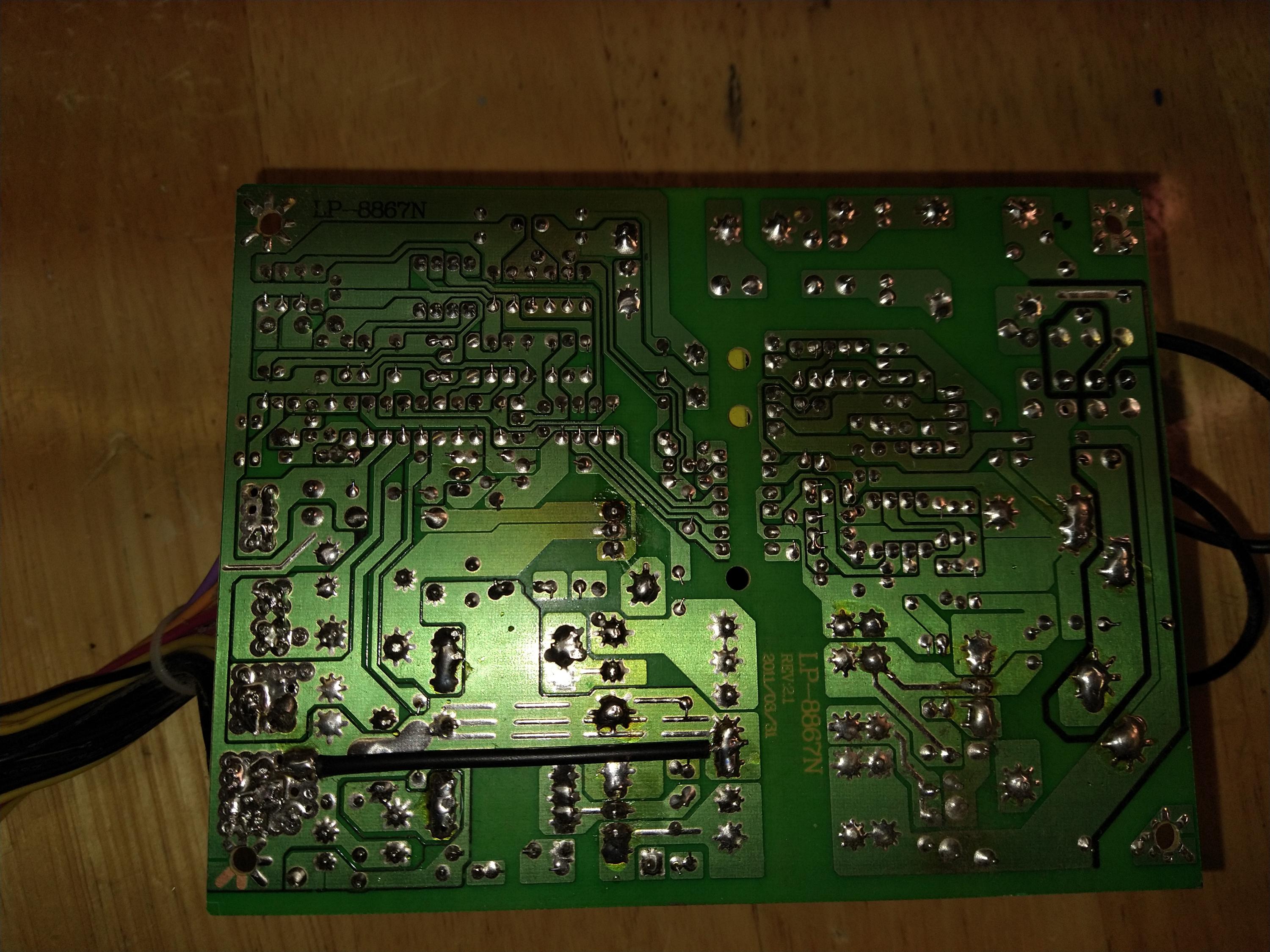

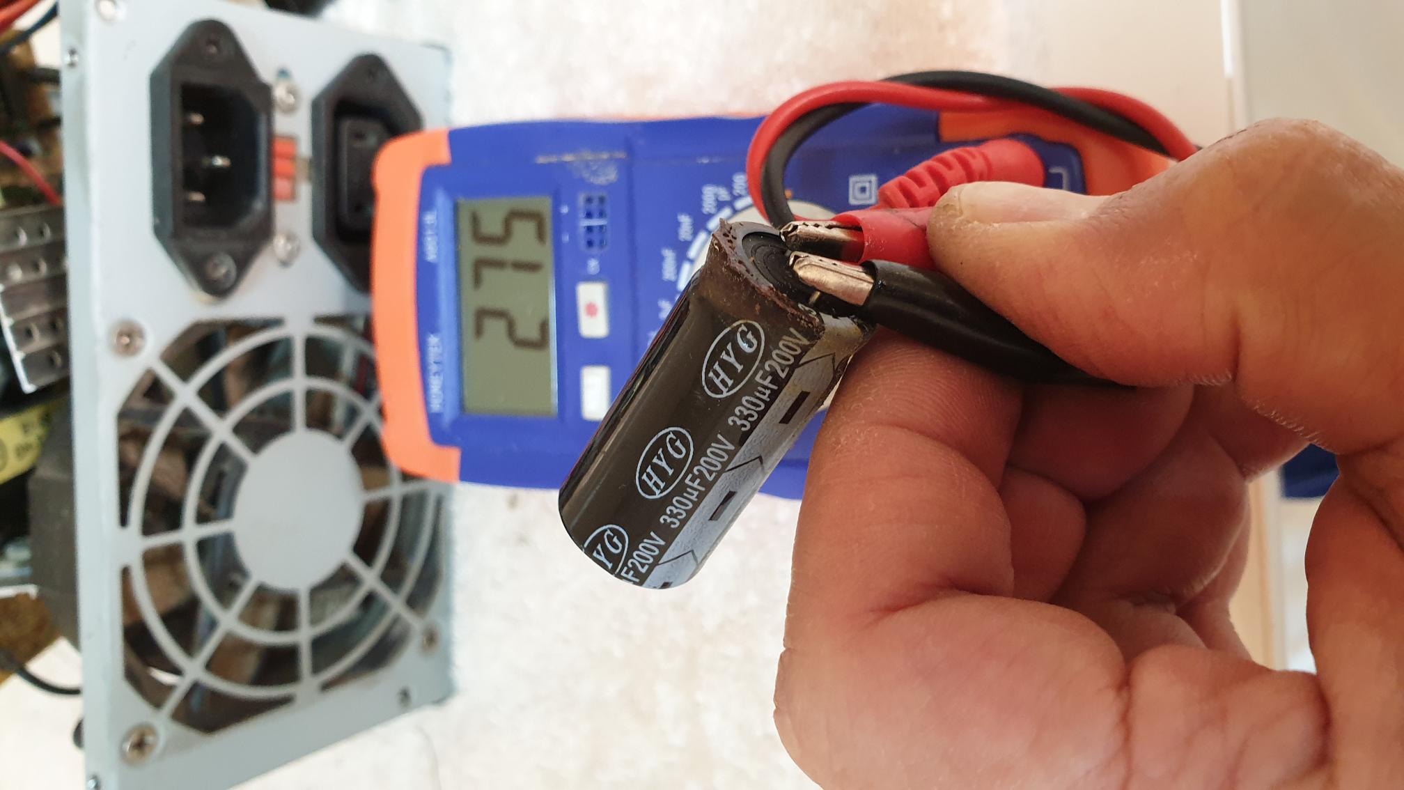

    My friend has an old PC with quadcore intel and was working fine and being used by his son for online schooling.
    Yesterday, it suddenly failed without warning, no power at all even manually shorting from the 24pins (green and black).
    I checked and opened the PSU because there was no output at all. Surprised the fuse was still intact after tested it. Tested the primary diodes and all are good.
    It has very similar lay-out of the PCB for this generic and cheap PSU and even using similar rectifier diodes and arrangement of other electronic parts.
    I already confirmed the cheap PSU is the culprit because i tried another PSU and the PC works fine.
    What could be the problem if fuse is still intact? Does it mean the primary winding is good and i should concentrate more on secondary? I want to learn how to fix this PSU and not because it is cheaply made but because i am seeking further knowledge.
    I will try to open it up again tonight and see if i can find something on the board

      I would trash it and replace it with a cheap FSP or Delta unit, especially since it's a quad core Intel. Those are hungry when it comes to power.

        Yeah already replaced with antec 350 and working good. i just want to learn how to fix this kind of prob and was thinking this is a good start to troubleshoot.
        i have nothing to lose and everything to gain.
        I would like to add, there is minimal hissing sound somewhere when plugged to the mains but i cannot pinpoint it. also voltage can be detected in primary but nothing in secondary. I am suspecting the mosfets and i need to remove them and test. i also found a semi-cold solder for one diode 1N5822 and tested it and found to be okay and resoldered it well.

          You can actually see the problem in that picture: you have bad caps (or at least one on the left side, close to the yellow and orange wires.) Chances are, the other ones are bad too. Full recap will likely get the PSU going... but really not worth it on a unit like this. If you have some other junk broken electronics you can scavenge capacitors (and other parts from), or a local shop that sells cheap Chinese crap caps for cheap, that should work too, just to test out your repair knowledge.
          And if you do fix the PSU... DON'T connect it to a computer anymore. It's a really low-end unit with high ripple/noise output and will probably damage parts over time. You can use it to power LEDs, motors, and other non-sensitive items on your workbench, though.
          Lastly: that PSU looks like a Deer/Allied/L&C unit, so it can actually be turned into something... less garbage. But you will need to fill in a lot of the missing parts (output PI coils, input common-mode chokes, input X2-caps, input Y2-caps) and upgrade the cheap parts in there (2x 2200 uF caps for each output rail, 2x 470 uF 200V input caps minimum, and etc.)
            Thanks for the valuable inputs, and for safety. I am just trying to learn the basic of fixing psu's. This photo is for reference only and not the actual photo of the PSU i am trying to repair. The actual psu has been reliably working for more than 10 years and suddenly gave up. Impressive!!! yeah given it is cheaply made.
            On the other hand, I have confirmed that the 2 main caps 330uF/200V are faulty. Initially i only get 120V from the primary and supposed to have 220-240V. This prompted me to check the main caps. One has 0 uF and the other 275uF so way beyond the spec. I will try to replace them and see what happens. I have checked all diodes by removing them and also all major resistors/ small caps by removing them individually and all are good except a few that need new ones.
            If this thing works then i learn something.

              Those are quite expensive, so your desire to learn trying to fix this psu will cost you a lot. In my opinion you should start collecting broken devices and parts inluding psus (ATX or not doesn't matter) and before you even know you will have everything you need to be able to play and experiment and maybe even build/fix something that will be of value to you after.
              If you were in Greece I could give you many junk psus to play/use for parts.
              You could try to get them from people giving away broken stuff for free or dirt cheap or from recycle bins (of electronics), if this is allowed where you live.
              Did you check the fuse of the psu to see if it's blown? I would also check recification diodes, and primary main transistors. Might be blown from the open primary cap

                Yes, already checked them all before and all are good. Yesterday I replaced the 2 main caps with Rubycon 330uF 250V ( was expensive and i am not expecting the cost from local parts store) and also 1 transistor due to open caps as you mentioned. And now it was working, couldnt believe it.
                I wouldnt mind as long as i learn.
                thank you all for the tips.

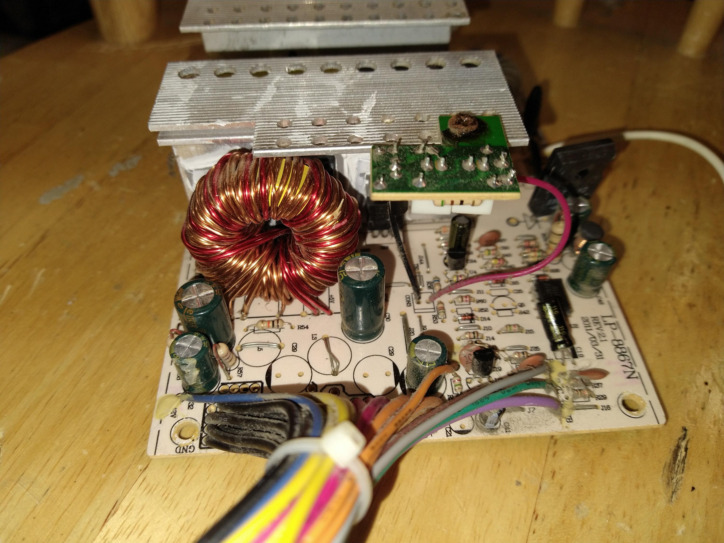

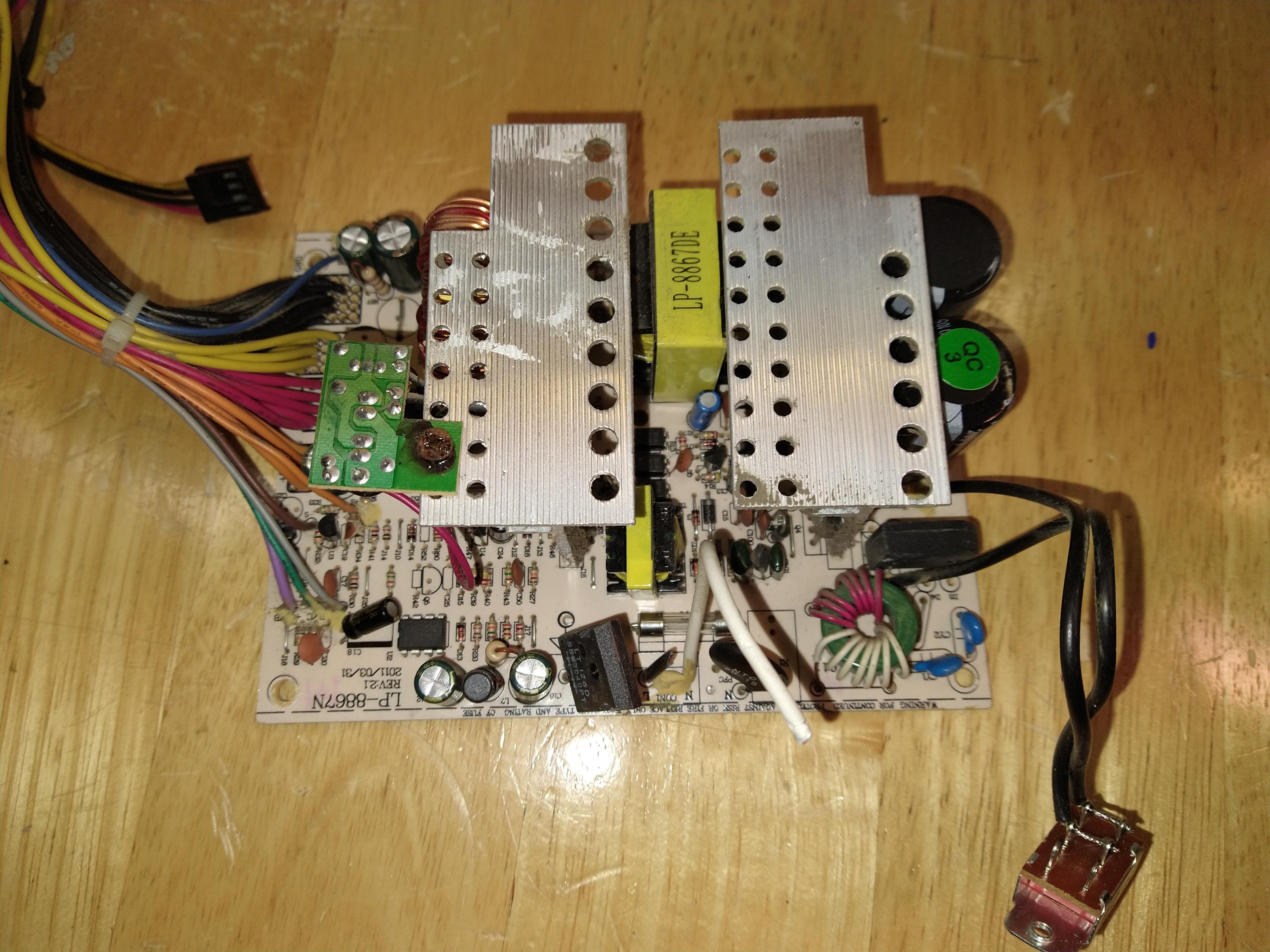

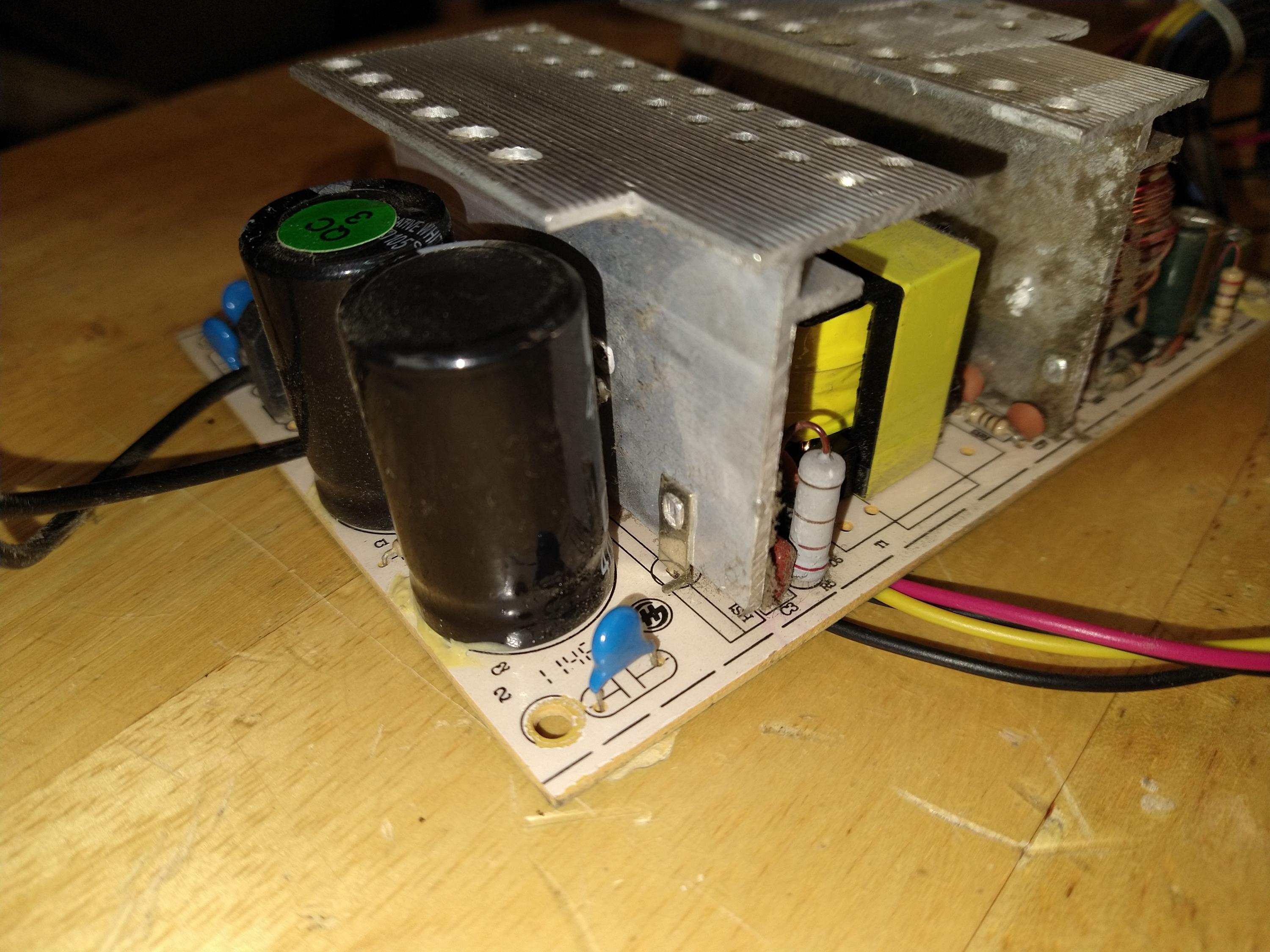

                  I can't believe it but this power supply completely fried!!
                  https://www.badcaps.net/forum/showpo...postcount=1618
                  The main output toroid core turned white and the wire is pitch black. It even fried a 12.5mm Chemicon KY and a Samxon RS!
                  Above the Ky cap:
                  Here's the story: It was made in August 2005, recapped in October 2013 and immediately installed afterwards. It ran 24/7 and was powering the following:
                  Pentium 4 641 (3.40GHz, D0 version = 65W TDP), which had the 15A rated 12V rail all to itself
                  x4 DDR1 RAM
                  Radeon HD 4350
                  x1 DVD drive
                  x2 PCI cards (WiFi and Sound card)
                  x1 3.5" HDD
                  x2 fans
                  It ran with this setup for about 60,000 hours before it failed. When you attempted to turn it on, you'd get a twitch on the PSU fan and about 3 seconds of spinning on the CPU fan.
                  It was used to stream football/TV so the P4 was pushed pretty hard. It was online, so super inefficient on the CPU compared to local x264 files. I believe maybe the toroid just wasn't enough for this PSU? The silicon was very strong for the ratings.

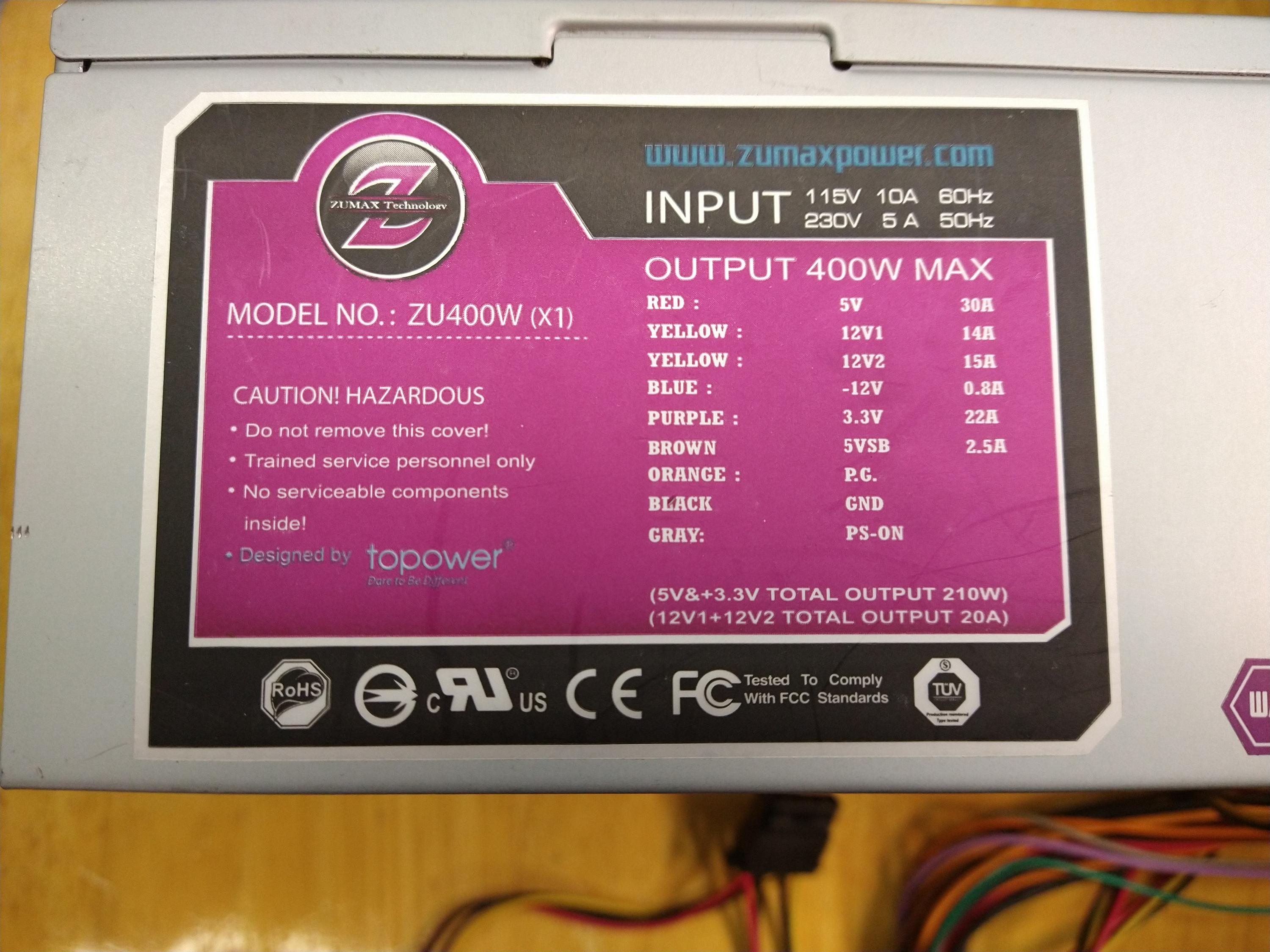

                  Label:
                  Silicon:
                  5V: Two 30A TO-247 schottky
                  12V1 (Non CPU): Two 10A ultra fast
                  12V2 (CPU): Two 20A schottky
                  3.3V: 40A TO-247 schottky
                  What do you think happened? I have a hard time believing that the load killed it, especially with a Cedar Mill P4 and super low power GPU. What I did also notice was a partially stripped wire on an extra cable touching the chassis. I imagine that this would have just tripped the protection and shut it down, not fry it?? What are your thoughts? This is very sad because this was a nice PSU and I don't really have the extra time to find a toroid for it.

                      I agree, I don't think the load should have killed it. Cedar Mills are still Pentium 4 CPUs, but relatively more tame in terms of TDP. If yours is indeed the 65W TDP version and not the 86W version (specs of the two can be found here), then that CPU peaks at almost 80W on absolute max power (generally synthetic benchmarks only.) With a heavy online load, it's probably using somewhere around its rated TDP or maybe a little more... so let's say 70-75W.
                      Looking at the pictures of the PSU again, I see the output toroid has a yellow core, suggesting Micrometals -26 type core, which is good for up to 50 KHz designs and also slightly less efficient compared to the green core with blue paint on one side (Micrometals -52.) What I also see is that your output toroid is about as tall as the UCC KY 16V, 3300 uF cap, and that's a 35 mm tall cap (the UCC KY is sitting flush to the PCB, I presume, whereas the output toroid isn't... hence why it looks a little taller, but it probably isn't.) This leads me to believe the output toroid is a T130-26 part... which should indeed be perfectly capable for the 350 Watt rating on the label. In fact, T130-26 could handle designs up to 450-500 Watts... maybe even 550 Watts. It's a pretty chunky core after all.
                      That said, I don't think I can quite identify what the issue is here. Seems like multiple things. It could be...
                      1) The output toroid's core overheated due to inadequate ventilation / airflow from the fan or the fan controller, as Per suggested. More precisely, I can see the following possible scenarios:
                      -- 1a) Thermistor is improperly placed to keep the PSU cool under high load. I notice from this picture that the thermistor for the fan controller is connected to the heatsink, but very far away from the components that generate the heat - i.e. the 12V rail rectifiers and the output toroid itself.
                      -- 1b) Fan controller is not designed properly - i.e. it doesn't ramp up the fan speed enough for the heat from the PSU.
                      -- 1c) The output toroid could be in a "hot spot", given that this PSU uses an overhead 120 mm fan and the secondary heatsink covers the output toroid almost completely. (On that note, this is one reason I tend to still prefer the old PSU designs with cross-airflow from an 80 mm exhaust fan and airy front vents.)
                      In regards to all of the above for item 1), I think 1a) and 1b) can be ruled out if you ever checked how the PSU ran under load in a PC - i.e. was the whole case of the PSU hot? If not, then that leaves 1c) as the more probable cause here.
                      2) There was a flaw with the output toroid. Things such as micro-cracks in the core material or marginal insulation on the windings, can show up as a latent failure. In the case of micro-cracks, the core/inductor will work at first, but excessive heat may form around the area with the micro-cracks. Over time, the micro-cracks can grow (due to heating in those parts), causing more heat and inefficiency, and thus total failure from overheating at some point. In the case of windings with marginal insulation - regular vibration from components inside the computer (fans, HDDs, optical drives, and etc.) as well as one-time "step" vibrations (walking in the room where the PC is, bumping the PC by accident, and etc.) could have caused a short-circuit to develop somewhere... and it only takes one shorted turn. Case in point: the Corsair CX750M I posted in this thread:

                                  So here is a PSU i just found at Goodwill today, A few things about it caught my attention, which is why i'm posting it so soon after getting it (and why i may have picked it up in the first place).
                                  Anyway, Here is a case overview:
                                  Looks pretty standard, we have a 80mm fan on the front and a 90mm fan on the top, you can also see the goodwill price tag, with how much i paid for this thing (and in a moment, we will find out if it was worth it (spoilers if you read the thread name)).
                                  Label:
                                  So at first, this looked like just a normal aftermarket PSU label to me, but as i looked at it longer, more and more things stood out to me, first, i was looking at the rated current of each rail, and noticed that the overall 12v1 and 12v2 rail currents was lower than the 5v rails rated current, which is odd since this is a fairly modern PSU. But it gets worse, as at the bottom of the label it says "12v1 and 12v2 total output 20A" which puts the total maximum 12v rails output at 240w, which is still a bit higher than the total 5v + 3.3v rail current, but not as high as other modern PSUs. It also says this unit was designed by Topower. While i don't know a lot about Topower, i'm willing to somewhat bet that they had no say in this PSU design. And lastly, the wire color list on the label is incorrect for all the rails except 5v, 12v1 and 2, -12v, and ground, which is one of the funnier ones to me.
                                  And now time to see what's inside, with a board overview:
ID:	2085180 Click image for larger version
                                  Wow, don't know what to say, other than its not looking good so far. I like the fact that the felt the need to bodge a wire in parallel with the ground trace, as clearly, this thing would be so powerful that it would melt that trace without that bodge. You can also see a few hotspots on the PCB, mainly around the 5VSB/Aux power supply parts of the PSU.
                                  Primary side:
ID:	2085184 Click image for larger version
                                  Okay, so for input filtering, we have a sloppy looking common mode choke, and two 2.2nf 2Kv ceramic capacitors where a pair of Y-class capacitors should be, but other than that, there is basically no input filtering or PFC.
                                  The rectifier is a KBL406G (4A, 600v), and we have a mismatch pair of 470uf 200v capacitors (Jay'long and Chang, both test at roughly 340uf).
                                  The main switcher is a K3569, controlled by a 3842B (looks like they're trying to spoil us by giving us something other than the usual dual forward design ). The 5VSB/Aux switcher is a C5027S, in a typical 2 transistor setup. The main transformer is 34mm wide by 29mm tall, which seems a bit small to me.
                                  Secondary side:
                                  The filtering for each real is as follows; (and every capacitor is a Cheng LOWESR cap unless stated otherwise)
                                  5VSB: SBL3040PT rectifier (30A! 40V. With one leg cut off!), 2x 470uf 16v with a PI coil between them.
                                  12V: MBR20100CT rectifier (20A, 100V), 1500uf 25v with no PI coil.
                                  5V: SBL1640CT rectifier (16A, 40V), 2200uf with no PI coil.
                                  3.3V (Which is derived from the 5v rail): 40N03P Mosfet, 470uf 10v with no PI coil.
                                  -12V: FR203(?) (Obstructed part number), 470uf 16v with no PI coil.
                                  One thing to note, it appears only one leg of each rectifier is hooked up, which i think effectively halves their current capability. The supervisor chip is a LP7510.

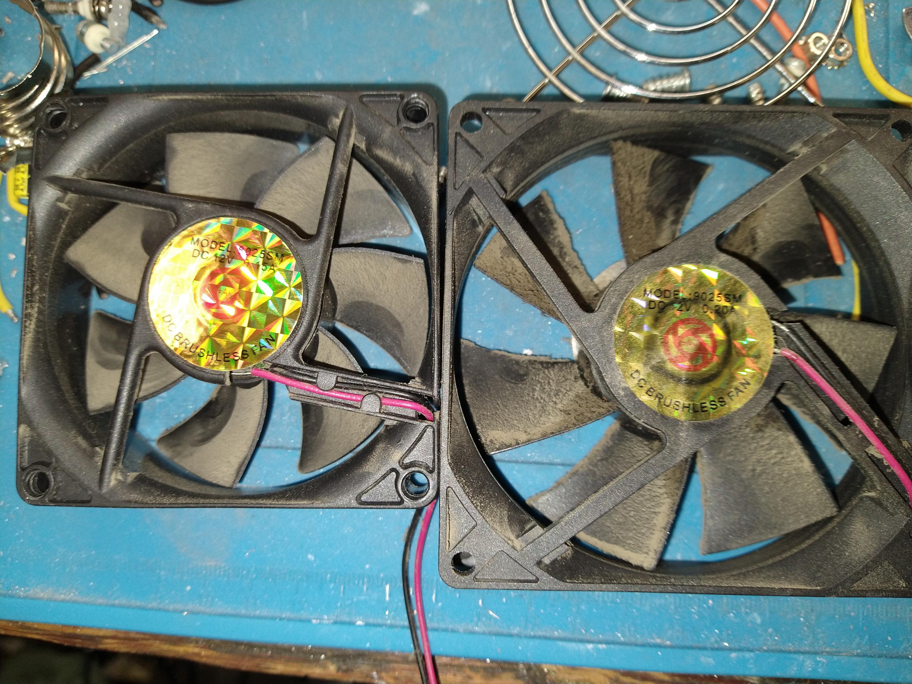

                                  Now interestingly enough, the main 24pin connector has mostly 18AWG wire running to it (and i did check it to see if it was legit 18AWG, and it appears to be so(they're really spoiling us with this one)) with 22AWG wires for the green (PSON), gray (PG), brown (S-, tied to GND), blue (-12V), and one orange (S+, tied to 3.3V) wires. The other cables appear to be 20 or 22AWG wire, but it's hard to tell because they lack any markings.
                                  And now, the fans:
                                  Ahh yes, my favorite fan manufacturer, Fan, known for their high quality fans.
                                  Anyway, that's it for this PSU, i'm not sure what to do with it, since it seems like it could be modded and even beefed up a bit, but i guess that depends on what others think the best course of action is for this thing. This PSU was also made around early to mid 2011.

                                    That label is the biggest lie I've ever read.
                                    "Made by TOPOWER" my ass, that transfomer model and the whole PCB are Powmax/Powsun's work.

                                      Those input lytics, as labelled, would be OK for 250W; with their tested value, more like 200W. The heatsinks miiiiiight be OK for 250W if the fans run fast enough. If the topology is a forward converter, that also probably wouldn't handle much more than 250W-300W.
                                      That output inductor looks to be a decent size, but those output caps ... may be decent for 200W, but without the ferrite inductors for suppressing spike noise, not very clean.
                                      All in all, taking a cue from Dan81 much above 235W-250W continuous ourput power and something's going POW! pretty quickly.

                                          1st: that input "common-mode" choke - WTF is that?! This "thing" has, what, 6-7 turns per side and with regular wire? - LAME!
                                          2nd: ceramic caps dipped in shiny blue paint to look like Y2-class caps - more lame!
                                          3rd: mismatched brands of primary caps?! Which -competent- PSU manufacturer DOES THIS? Seriously, it's like the "production house" literally grabbed whatever part they could find laying around. Actually, I wouldn't be surprised if these are recycled parts, given the mismatch. But hey, I'll give them credit - at least the capacitance is matched.
                                          4th... and I have to concur with Dan81 here: I don't think this PSU was made or designed by Topower. The label is indeed likely a BIG lie. The "LP" markings on the transformers and the PCB suggest Leadman Power - a.k.a. Powmax / Sun Pro. This is hands-down my least favorite PSU manufacturer... or most favorite worst manufacturer, I don't know anymore. If it was a Topower unit, those usually have "top..." or "ever-power" text on the transformers.
                                          4.5: the heatsink style is another clue - I don't recall older Topower units using this "T-style" of heatsinks. Powmax / Leadman / Sun Pro, on the other hand, I do. At least with this unit you didn't get the cheapest crap heatsinks, though, unlike this Sun Pro KY-480ATX.
                                          You got that right!
                                          Yeah, it's probably an ERL/EE/EI-33 size with the yellow tape on the sides off. And you're right, it's definitely too small for 400W - well, at least with this type of single-transistor forward converter design. Actually, even 150W might be asking a bit too much. That 2SK3569 MOSFET in TO-220FP won't be good for too much power.
                                          Yeah, Powmax / Leadman has used this design quite a bit too. A -good- single-transistor forward design like this can manage 300-350 Watts with decent efficiency. But Powmax's hasn't been noted for that. Look up threads for "LP-6100", "LP-6100c", or "LP-6100d" and you will see. I have the last one (LP-6100d). Even though it looks built quite well, I've read in the past that Powmax's designs can't really hand too much power. Now, of course, I could be wrong about this unit, since it seems like a much more current version from 2011 (based on the PCB's markings)... but I wouldn't count on it.
                                          Seems like you're enjoying this PSU's build "shenanigans" just like we are.
                                          Yup, this PSU was clearly designed by "professionals". Don't try this at home (Yes, don't try using this PSU at home is probably what should be meant. )
                                          Don't you worry. That 2sc5027s BJT is heatsinked well! The warm 5VSB circuit shall keep all of the caps nice and cozy when the computer is in soft-off mode, so that their ESR is always at optimal levels.
                                          No, they (Powmax / Leadman) actually got that part right... as if by a miracle.
                                          In a forward-converter design in continuous mode (the main PS of this PSU, not the 5VSB), one side of the output rectifiers is always connected to ground. This is done so that after the "forward" power pulse (switch device on the primary side turning On and Off, sending a "spike" of power through the main transformer and one leg on each rectifier) goes into the output inductor, the output inductor then will want to "maintain" the current going through it. And to do that, it's only path of sourcing current is through the diode in each rectifier connected between ground and the winding on the inductor. This is called free-wheeling. Think of this concept - particularly the output inductor - like the rear wheel on a bike: you push on the pedals and you transfer a pulse of power to the rear wheels with each push. But you don't necessarily need to spin the pedals with constant force/power between each push - the rear sprocket bearing allows the rear wheel to spin freely without making the pedals/chain rotate... hence "free-wheeling". In forwards-converter designs, it's kind of similar to that analogy.
                                          Certainly the most "creative" name out there, isn't it.
                                          Probably something like this went along...
                                          Marketing department: Hey boss, we came up with these name's for our company's fans, but we can't quite decide yet. What do you think of them?
                                          Boss (thinking in his/her head): Does the company really need a marketing department? Nah...
                                          Boss: Your service of your department are no longer needed. You can all go home now.
                                          Marketing department: But boss, what about the product's name? You can't just--
                                          Boss: Fan. Our product will just bare the name 'fan'. No go home.
