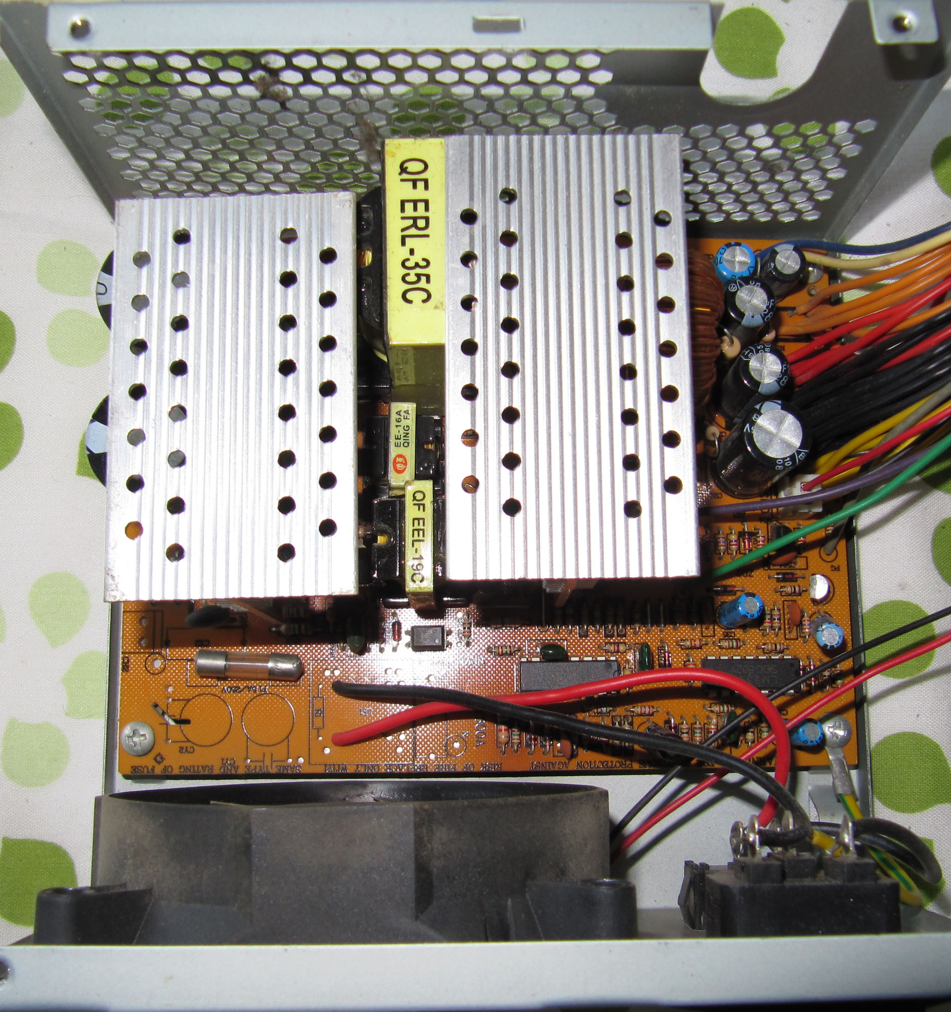

I have got one more T&P-nonsense psu
T&P-DHK 420ATX
I 've posted again this model (check link posted by momaka above) but internally they are completely different units.
There is some serious overheating on the PCB and the heatsinks are the T shaped ones.
The output filtering is terrible, only 1 cap per rail.
And the input filtering is totally missing. Wait, there is an NTC thermistor there.
I couldn't find info for the NPN switching transistors, they are 2X 1035
STPS10L45CT 3.3V
pbyr3045wt 5V
F16C20CT 12V
terrible choice of components
why use 30A rectifier for 5V ? This is not 2000.
And, as shown in pics attached, the super group regulation toroid coil strikes again.
