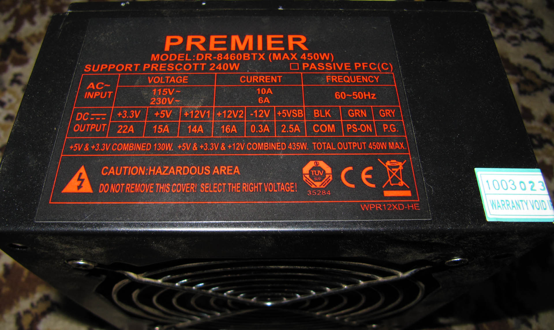

              Re: the gutless, bloated, and fried power supply hall of shame
              Premier DR-8460BTX
              SB3045ST @ 5V
              SB1060CT @ 12V
              S10C45C @ 3.3V
              2x 13007 transistors
              33 sized transformer
              2x 330uF 200V ANODIA caps
              2N65 for 5vsb
              4 diode treatment for AC rectification
              Incomplete EMI input filter
              Tiny heatsinks
              1x1000uF for every important output
              Not a single coil for ripple filtering
              Tiny toroid coils
              Tiny parts everywhere
              But it works and none of the caps are bulging... The fan is moving at full speed. This thing was buried in dust and tobacco residue...
                Originally posted by goodpsusearch
                Premier DR-8460BTX
                SB3045ST @ 5V
                SB1060CT @ 12V
                S10C45C @ 3.3V
                ... And yet the label says the "dual" 12V rail can handle 14 + 16 Amps . Where the fuck do they see that at with a 10 Amp rectifier?
                At least they put a nice big label with bright red letters. Probably to warn users: "Warning! This PSU is dangerous!".
                2N65 for 5vsb
                Tiny heatsinks
                Typical Deer/L&C.
                Don't forget those big, low-resistance dummy load resistors on the output. I see the one for the 5V rail is 20 Ohms. Should keep the output caps nice and toasty.
                Tiny toroid coils
                Woah DUDE, chill. Let's just go surfing! No, DUDE, not surfing the internet. I meant surfing those huge AWESOME ripple tidal waves from the PSU output. Yeah, now wouldn't that be TOTALLY RAD DUDE?
                /goofy_surfer_voice
                But it works...
                Typical Deer/L&C. x2
                I guess they are dependable PSUs - that is, you can always depend on them to kill your hardware.
                The case looks nice, though. Could be used to house the guts from another PSU if needed.
