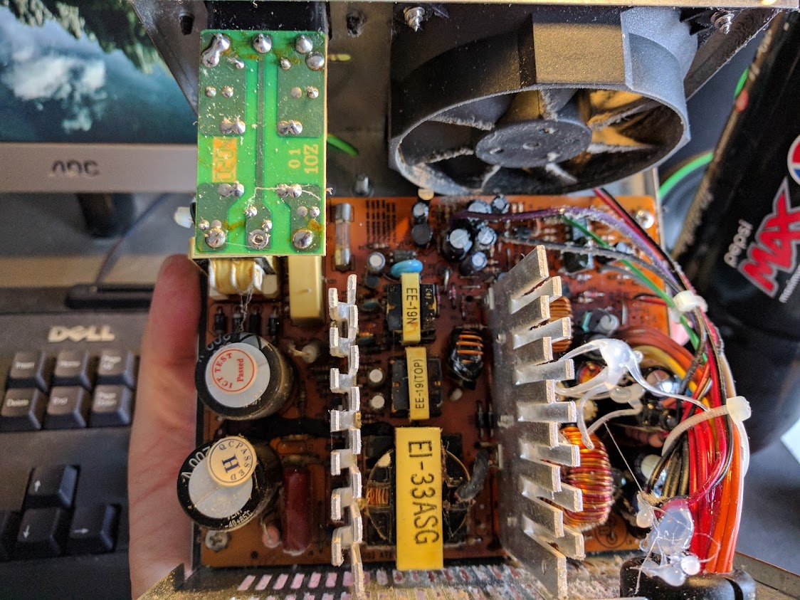

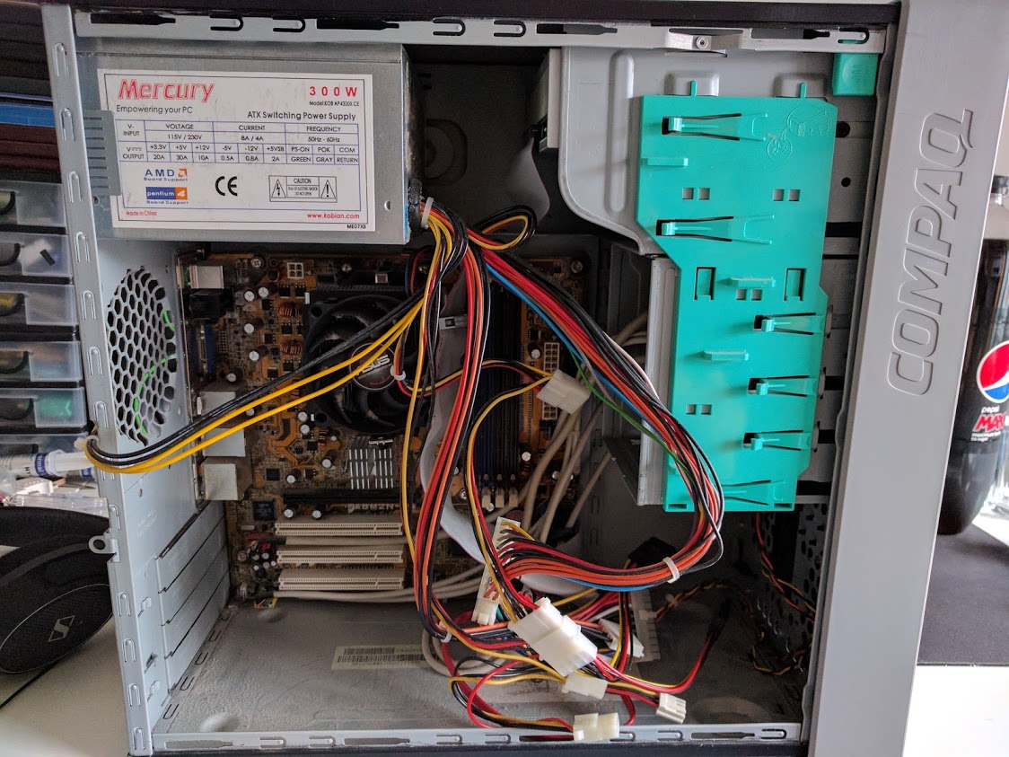

      Found this little beauty in a Compaq Presario A64.
      Must have been a thoughtless replacement at some point for the original!
      Fan was very stiff so I guess it ran hot and somewhat overloaded for some time in order to cook more or less every cap in the unit!

        That might actually be worth a fix.
        What did they smoke to label a ERL35 transformer EI-33ASG?

          I think I saw a March, 2001 date code on one of the caps. There's a good chance to original PSU was from Delta, and if it lasted for 15 years, it did pretty good. At any rate, while I wouldn't use that thing for the full rated 300W when brand new, restored it would probably be good for 200W-250W. The two potential limiting factors would be the 2A +5VSB and, more importantly, the 10A rating for the +12V output.

            The PSU predates the Compaq by some years without a doubt.
            I figured the person I acquired the machine off did a quick fix and swapped the PSU out for one from a older machine.
            Usually I am up for repairing such things but the weak 12V rail really means its rather useless for me in this system.
            Machine however is now sporting a 300W FSP unit and it working perefctly

              As far as my experience goes, I used recapped Deers similar to the Mercury above (except the diodes-on-bracket were replaced with actual rectifiers) to power Northwood based PCs. (in fact,one of the PCs I gave runs a P4 2.8 Northwood with a FX5200,a MSI 845E Max mobo and a 120GB WDC HDD)

                Oh Deer!
                It's one of their "2003"/"2005" chip-of-the-year BTX designs (BTX for Deer/L&C typically signifies the primary is located on the same side as the receptacle plug and the secondary is same side as the fan... not the other way around like with other "normal" PSUs).
                That said, with a better rectifier on the 12V rail and bigger output caps, this thing could probably provide up to 14 Amps on the 12V rail, which should be enough to power a Pentium 4 / Core 2 Duo / low power Core i3 or i5 system with on-board or low-power GPU and single HDD. I'm not sure if it's worth the hassle fixing it, though.

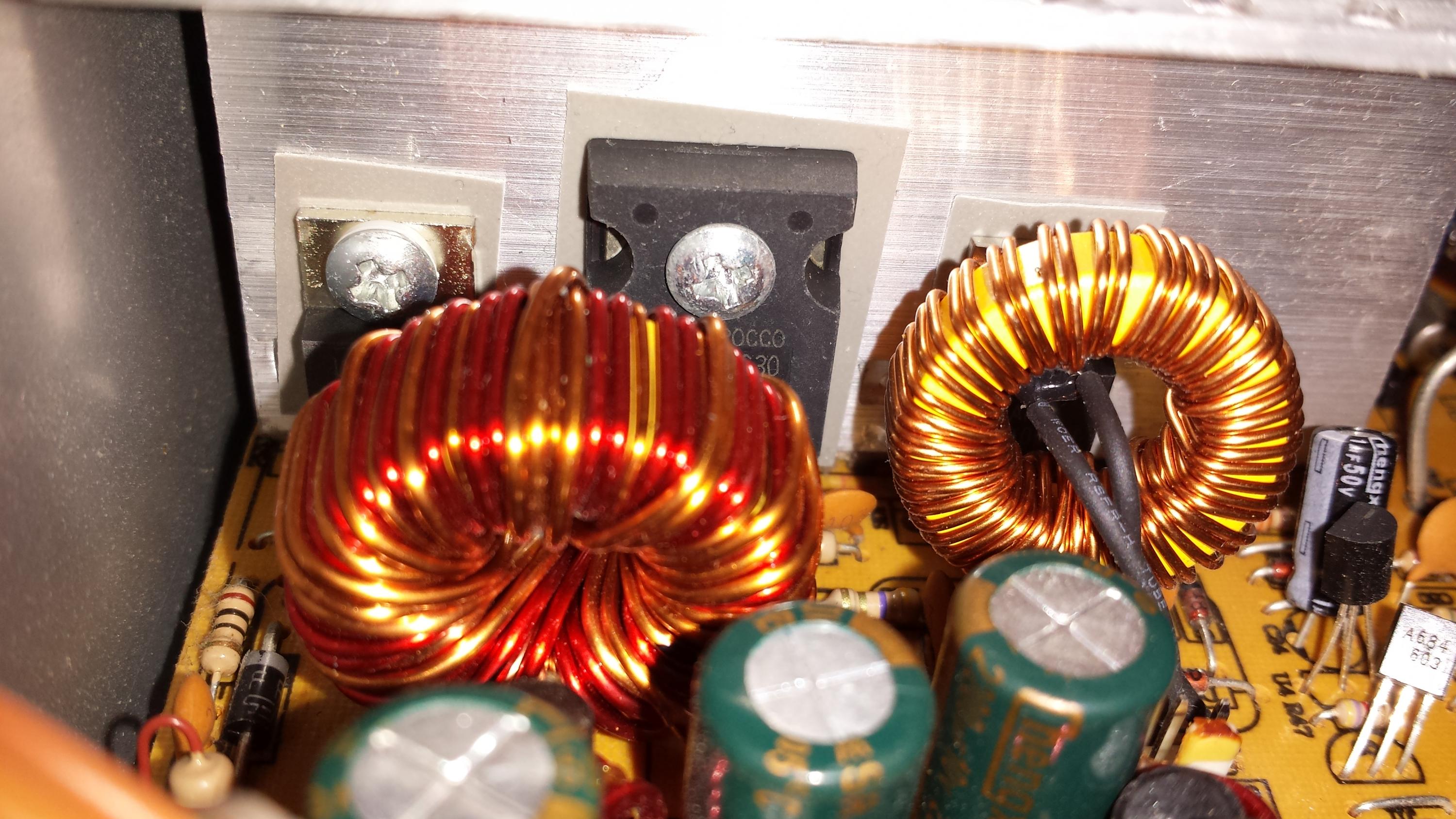

                  The worst trash I could find, this PSU i was installed on a pc, the owner of the pc complained that it did not start all the time, and it squeaked, and it did not work stable the pc.
                  Subject: 3G0 "450W"
                  primary
                  ate 7n60
                  c5027s
                  2 cap jay'long 200v 470 microfarads
                  ic ka3842
                  diode bridge diferent size LOL
                  x2 sep 1n5
                  x2 sep rl2
                  secondary
                  diode lt 338
                  switch st stps30 45cw 30A (The only thing of decent brand xD) but the transformer that accompanies ... this would cause havoc. does not meet what promises in its label.
                  apd sbr1040ct
                  4x chengx 10v 2200 microfarads
                  2x chengx 16v 470 microfarads for 5vsb
                  At least it has one good thing, it has 2 thermistors
                  The transformer is super tiny!

                    It's sad how that can be passed off as a 450W PSU. [I'm guessing 100W maybe.]
                    I like the brand of the input capacitors. [jay'long]
                                  Actually, unless it's counterfeit, that KA3842 is either Samsung or Fairchild (Fairchild bought some of Samsung's linear IC products around that time).
                                  Those input caps (ignoring the non-brand brand) and the size of those heatsinks would put the realistic output power at around 250W maximum.

                                      Re: the gutless, bloated, and fried power supply hall of shame
                                      That transformer is just... Wow!
                                      PeteS in CA: Good guess, here is a user that tested it.
                                      The primary exploded at 277w
                                      http://www.jonnyguru.com/forums/showthread.php?t=6714
                                      EDIT: Here it is with a 250w rating even
                                      http://www.powsun.itxpower.net/pcpower_8867.htm

                                        Thanks for this information, make it clear that it is the worst psu I have ever seen.
                                        I even put it at less level than deer xD.
                                        If the psu of the forum of jonnyguru exploded with 277, I do not want to imagine my PSU, since with a pentium 4 of 65w of consume gave error to start, I do not want to imagine asking for load of 277 watts, there it explodes in my face.
