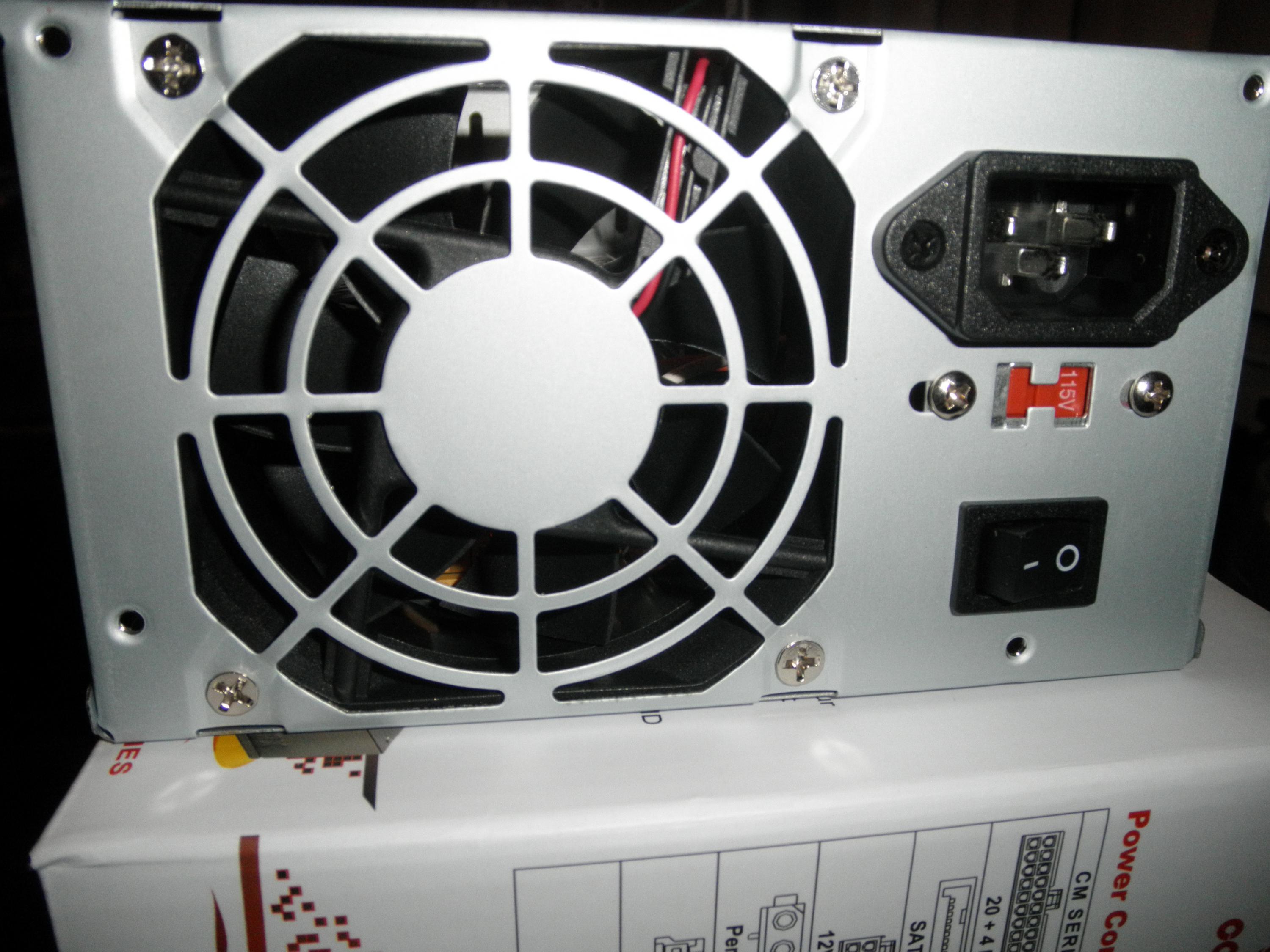

            Originally posted by momaka
            It may only be a 200 Watt power supply, but if it really can do 14 Amps on the 12 V rail, that is plenty for something like a Core 2 Duo, low-end C2Q, or any other CPU under 95 Watts TDP and 150 Watts max. Just check what rectifier that PSU has. If it's a STF topology with a 20 A rectifier for the 12 V rail, it will do 14 A no problem.
            Hi Momaka great to see you again here unfortunately im not very good at reading datasheets for transistors etc, i can read some caps ones but not this i can't make heads or tails of it here is the rundown of chips
            Input filtering
            4 y caps
            2 x caps
            2 coils
            1 mov
            8AMP Vishay GBU8J Brid.Rec. non-heatsinked
            in the input side (alert)
            p4nk607fp x2
            IC36AK
            output *9000
            STPS2045CT
            CSC2486
            welltrend chip
            and all wires are 20 awg but considering the low wattage ill let it pass
            so any advice

              Originally posted by coreAngel
              so any advice
              It's got full input filtering and an 8 A bridge rectifier, so they *likely* didn't skimp on the secondary too much either.
              The two "p4nk607fp" are likely STP4NK60ZFP MOSFETs (one for APFC and one for main switch?)
              "IC36AK" is probably an ICE3A -series off-line SMPS current mode PWM-FET. Depending on which model it is, it can be either for the 5 VSB or for the main supply (these chips can supposedly deliver up to 240 Watts ).
              "STPS2045CT" is exactly that - a 20 A, 45 V schottky rectifier. Could be on either 3.3V, 5V, or 12V rails.
              "CSC2486" might be a 2SC2486 MOSFET. But with only 12 A peak current and 120 V_ceo ratings, I'm not sure what the purpose of this would be in a PSU.
              The 20 AWG wires shouldn't be too much of a problem if they are short and since this is only a 200 Watt unit. The Delta Electronics PSU that came with my Gateway GT5656 PC is rated for 300 Watts and still uses nothing but 20 AWG wires.
              So all in all, I think it is an okay PSU for its rating.

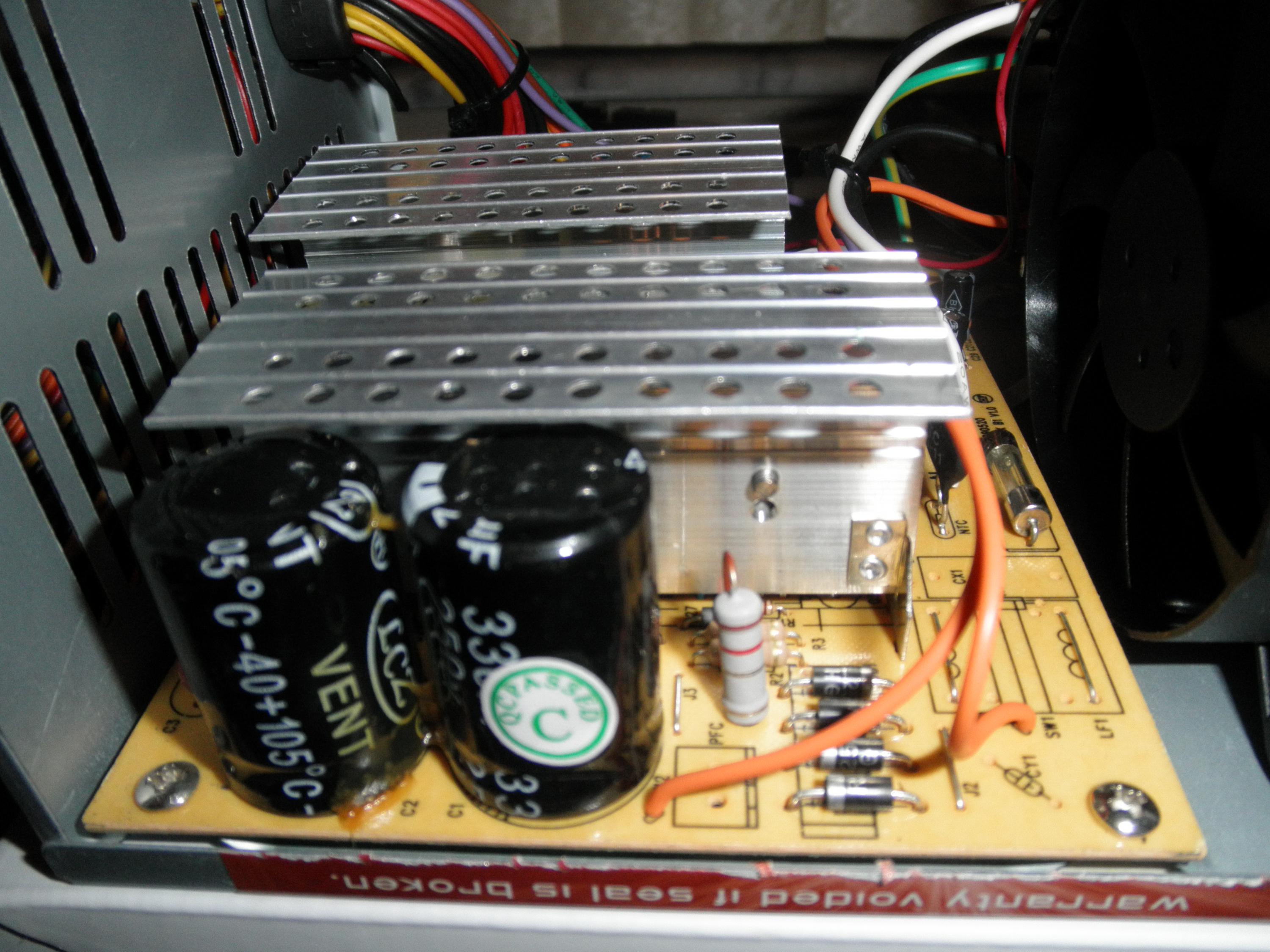

                It was suggested i add this crap of a PSU here i posted somewhere else here goes:
                Hello everyone, boy do i have a treat for you guys and gals too today. I went to the computer store liquidation sale and managed to snag a Diablotek PSU that was sitting in their storeroom for almost 4 years. I snagged it for 2 dollars.I won't pay more for this kind of crap.
                It's a Diablotek 350 watt psu with 2 fans and it reminded me of a same brand psu i had in the past (more on that later) it says in the box 350 watts
                NOOOO Input Filters at all( so that was that hum around my house was when i plugged it in)
                4 Diode Treatment
                LCZ main craps
                BH craps the rest
                Bao DI Crap Fan
                It has all ST and Fairchild chips ( i can't believe these brands are in there)
                Now about why this reminded me about a previous PSU, i used to frequent this store back in 2001 when i had my first pc an Emachines etower 667ir ,I wanted to upgrade memory ,cd drives etc, and i decided i needed a better power supply (2003) yeah boy was i a noob , i purchased a diablotek 350 watt micro atx psu since it was so small, i thought this was great ( i wish i had joined this site long ago) maybe it's better quality? i only used the power supply for a total of three months then decided to build a new pc.
                I tossed the PC in the closet and forgot about it, more than a year ago doing cleanup i decided to take a look at that PSU it had the same layout but had G luxon all caps and none were bulged, it had a sort of full input filtering minus a x cap and looked beefy enough to me at the time maybe i was wrong what really caught my eye was at the corner of the PSU board it said : "ENGSMPL" and thought of nothing else at the time so i guessed it wasn't a final version? how did it end up in my hands? but i didn't need the computer as its motherboard went bad. and turned it over to a recycler , which i wish i never did, so diablotek maybe good in the past , wtf now....

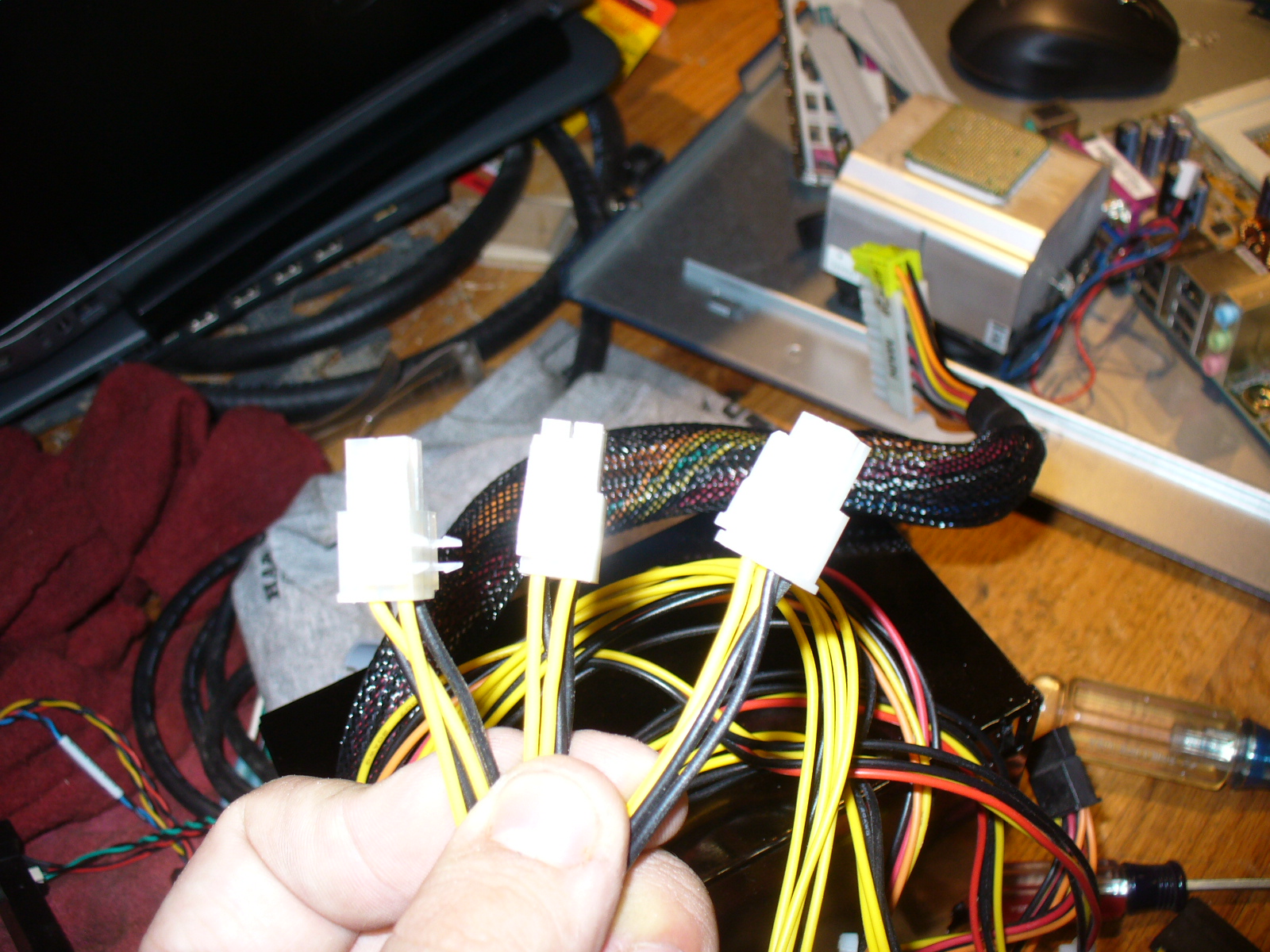

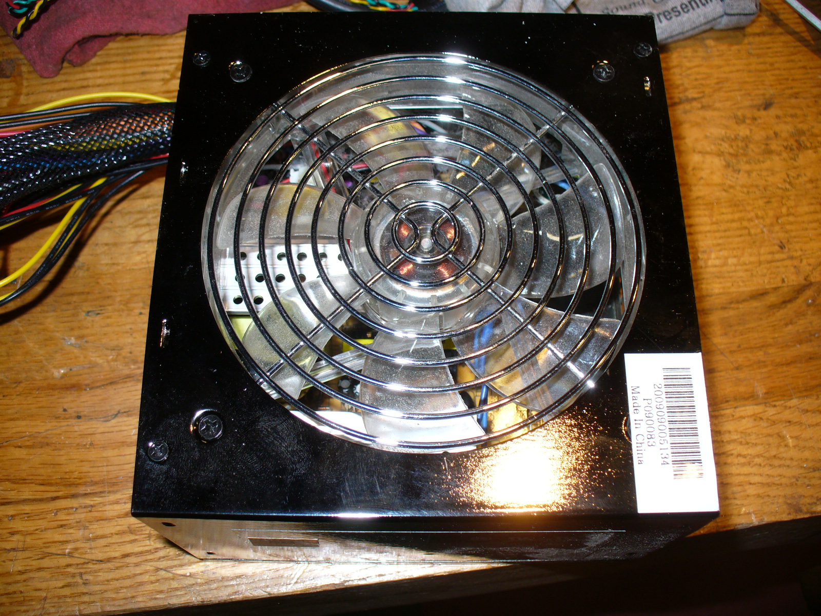

                  I think I have a candidate for the worst power supply (relative to "rated" wattage). Ok, maybe not as bad as an A-Power or Echo Star (or powmax), but it's pretty crap in every aspect.
                  We have a dead Okia 550W unit, seems to be a 5VSB issue.
                  First, the sticker and external overview:
                  Look at that thin wire... it feels as cheap as it looks.
                  Found some casing damage, which looks factory (the warranty sticker was intact):
                  That is thin metal indeed. The 12V connectors are fouled up too:
                  They gave a 4 pin and a split 4/8pin? Why??? ... I guess they gave a second plug in case the thin wire fries on the first... but wait, it's a 5V heavy old design! Now I'm really confused...

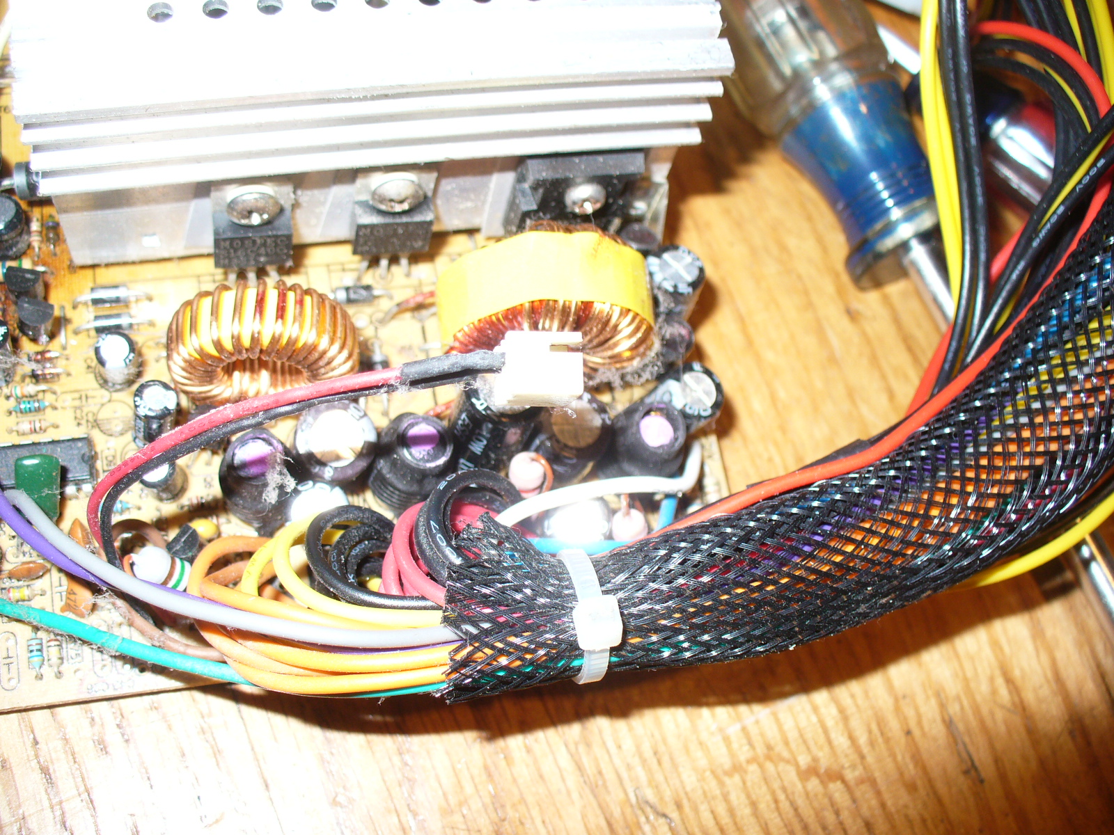

                  Anyway, a look at the primary, those with weak stomachs need to look away now
                  First, nothing is soldered straight. Tilted left, tilted right, it resembles a novice solderer's first project, not a production product. Also, the primary is very stripped out; the two choke locations are jumpered away, the X caps are gone, and the Y caps are swapped for cheesy looking ceramics. Oh, and the primary caps are an accident waiting to happen. Looking at this alternate angle...
                  ... one can see why the one cap was butting the heatsink (Short hazard?). These are not the usual rivited tab primary caps quality units use, these are leaded wannabes that one of which wasn't trimmed. The assembler must have left it 1/2" off the board, realized it wouldn't fit, and twisted it down rather than re-heat the joints and push the cap the rest of the way down. Then again, they cut corners everywhere else; it already was a circle.
                  Speaking of tilted components... look at this shot of the gutless primary:
                  Even the jumper links on the choke silkscreens are tilted! This even makes powmax look good!

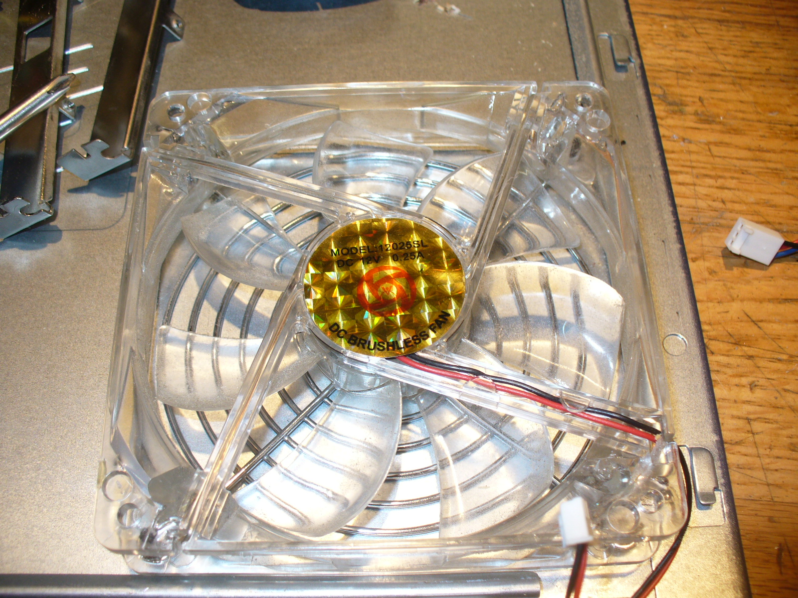

                  Before I jump to the silicon and the secondary, here's the fan that was installed:
                  No brand, just bling. I assume those are blue LEDs. Felt like a not-yet-seized sleeve bearing. :trashacan:

                  ... PI coils! After all the junk they cheaped out on, they actually put in coils. The caps are still tiny, though.

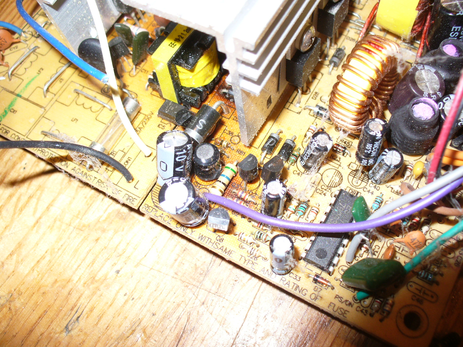

                  Here's the fried 5VSB:
                  Looks like a 2 transistor job, complete with failed cap. Didn't kill any motherboards, though. Wouldn't spin up, though. 5VSB was completely dead.
                  Not that the other joints were that good to begin with.
                                20 AWG, I am guessing. Yeah, pretty dissapointing to see that. But then again, the 300 Watt Delta DPS-300AB-15B that came with my Gateway GT5656 also uses 20 AWG wire on all connectors. I'm not happy about it, but I guess it works?
                                Maybe one of them is intended as an 8-pin PCI-E power connector for a graphics card?
                                Reminds me of my Raidmax RX-380K (Sun Pro KY-480ATX), also posted here. It was the same thing with that one. At least you get a large 120 mm LED fan.
                                No, don't trash it!
                                Even cheap fans can last a very long time if the sleeve bearings are properly cleaned and lubricated. I have a few cheap fans that I fixed a while back, and they actually managed to last longer than a Delta ball bearing fan I fixed around the same time.
                                  What was wrong with the double ball bearing Delta fan? Were the ball races worn? Did it need to be greased? And I noticed ratdude's gutless unit employs the dreaded conductive glue which is already blackening from the heat. I really hate that stuff.
                                      Bearings are getting old and loose. Need to be oiled (again). They are sealed, so I can't grease them. Once they warm up, the fan gets very noisy and barely runs.
