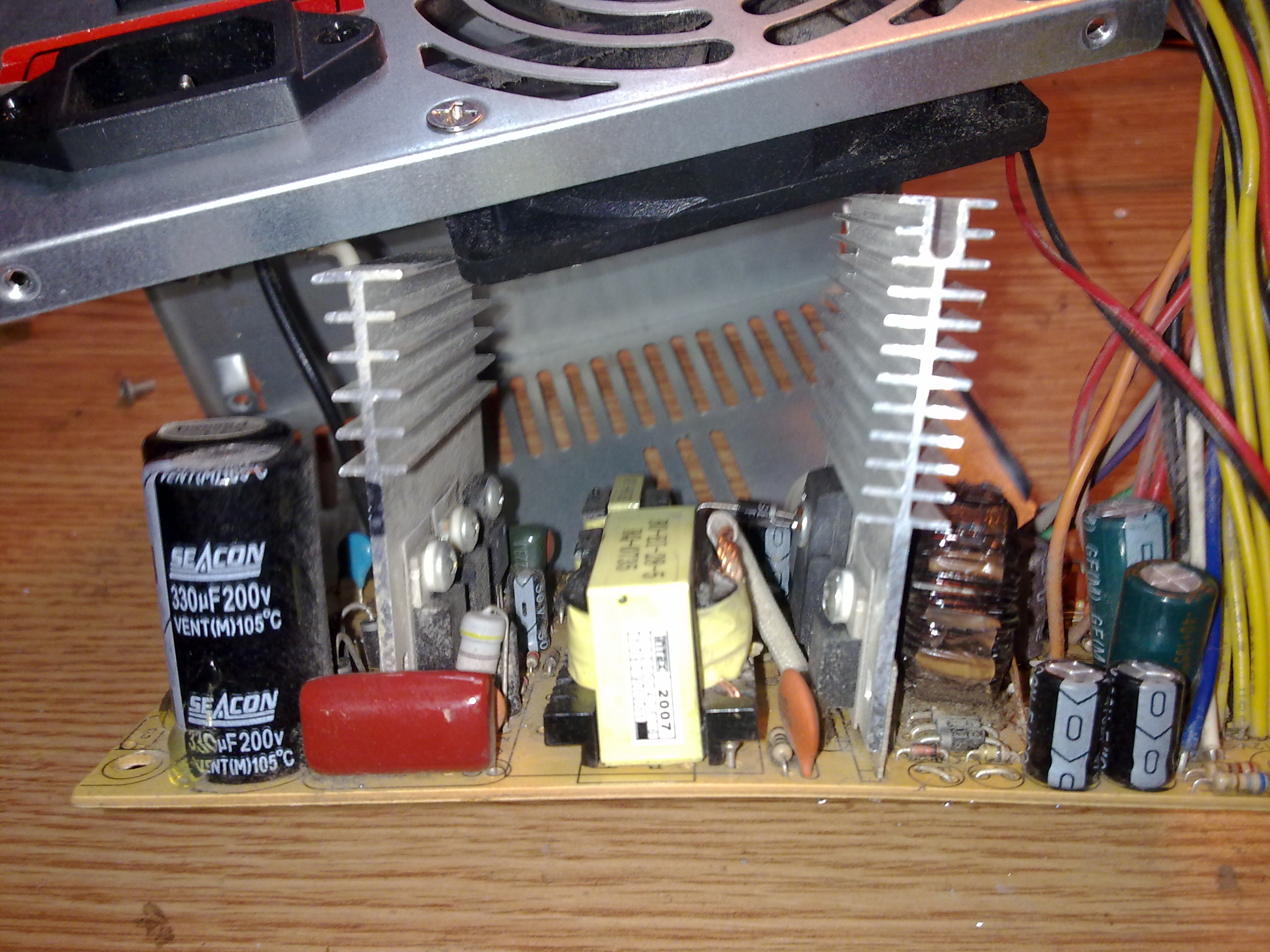

                          #912
                          Re: the gutless, bloated, and fried power supply hall of shame
                          They don't get much more gutless than this... Wonder what's up with the caps tho, as the warranty seal wasn't broken.
                          A working TV? How boring!
                          • mariushm
                            • May 2011
                            • 3799
                            #913
                            On the upside, quite a lot of space between primary and secondary, lots of space between high voltage traces, room for additional filtering on primary side, big heatsinks, no two diodes treatment for 12v....
                            Shame the main transformer is so weak.
                            Why did it die, can't figure it out (that inductor is obvious but what made it burn) ?

                              #914
                              Most likely somebody pulling too much from it?

                                #915
                                Partially seized fan. The caps didn't have time to cook fortunately. 5vsb was fine, so i replaced the output inductor and it fired right up. Went back in the computer, coz well, owner was cheap.
                                Powered a 1.6GHz Celeron 420, 1GB RAM, Geforce 7200 and a single hard drive, so not much load on it. But it was still a pathetic PSU. 12A fast recovery on 12v, linear regulator with MOSFET for 3.3v (hey, at least it supplies clean power), and the diode on the 5v had its part number scraped off. Most likely 30A judging by its size. Seen worse, but still pathetic... The diode on the 5vsb is a joke tho, that looks like a 2 amp job at most. At least they left its leads long so it has a chance to catch some cool air.

                                  #916
                                  Those output inductors are rather stressed in these cheep POSes, more so than even in "StupidPowers." Linkworlds were like this- good sized transformer, but the too-small output inductor would "smell" below rated output. The 12V windings were too small upon examination. Too much load on +12 for too long would easily result in shorted turns. And cooked cores and blown switchers.
                                  What else is new? At least you got to fix it and save the computer. As you know, some people are content to run their stuff on raw AC, as supplied by a Deer!
                                  Aww... From the days when 5VSB was still an afterthought.
                                  What were hiding with all that grinding?? I mean, they could've actually made it "challenging," by grinding that PWM IC.

                                    #917
                                    I imagine that "Zhila" cap (the 4.7uF 50V one) next to that resistor and 13007 isn't long for this world, assuming you didn't replace it.
                                    That is indeed a horrible PSU, but the system it was in is probably <100W at all times, so I bet even ripple is in spec. Nice save though
                                    Did you re-oil that fan or put a different one in there?

                                      #918
                                      I was gonna say, There's more to it than just the fan. Take the Delta GPS-300AP I posted here on page 7 for example. The fan on that one was completely stuck, the PCB was badly darkened and just about every single cap was vented. However, the toroid coils are still fine. It's in my parents PC now with the original main toroid coil.
