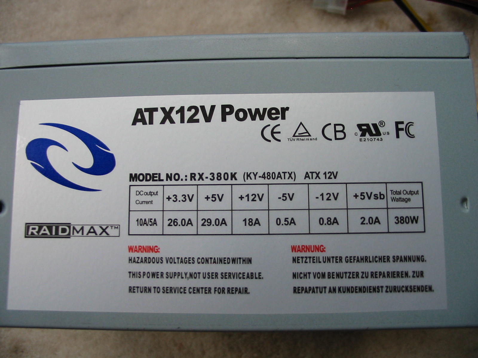

 (not a single safety agency or UL number in sight)

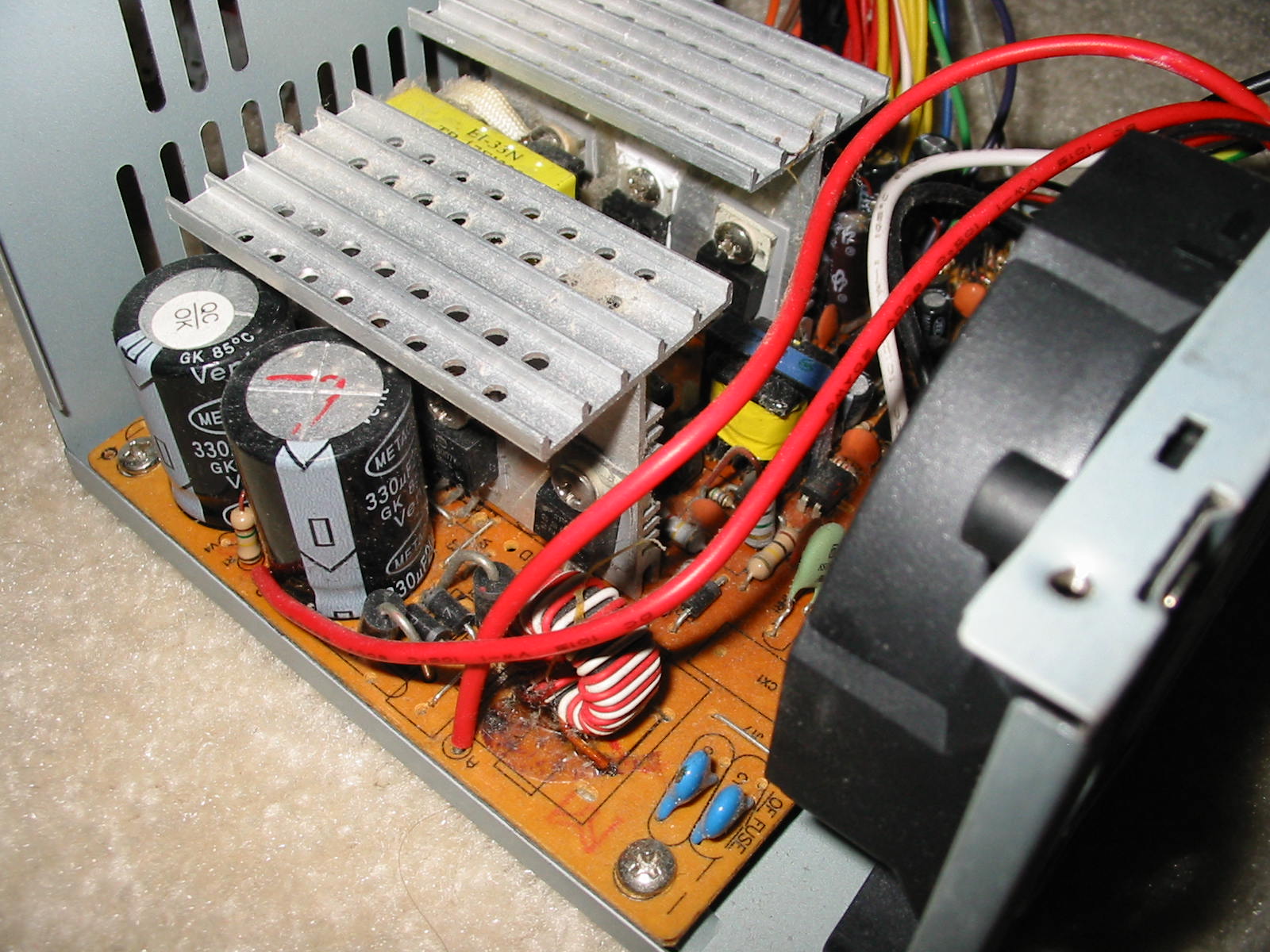

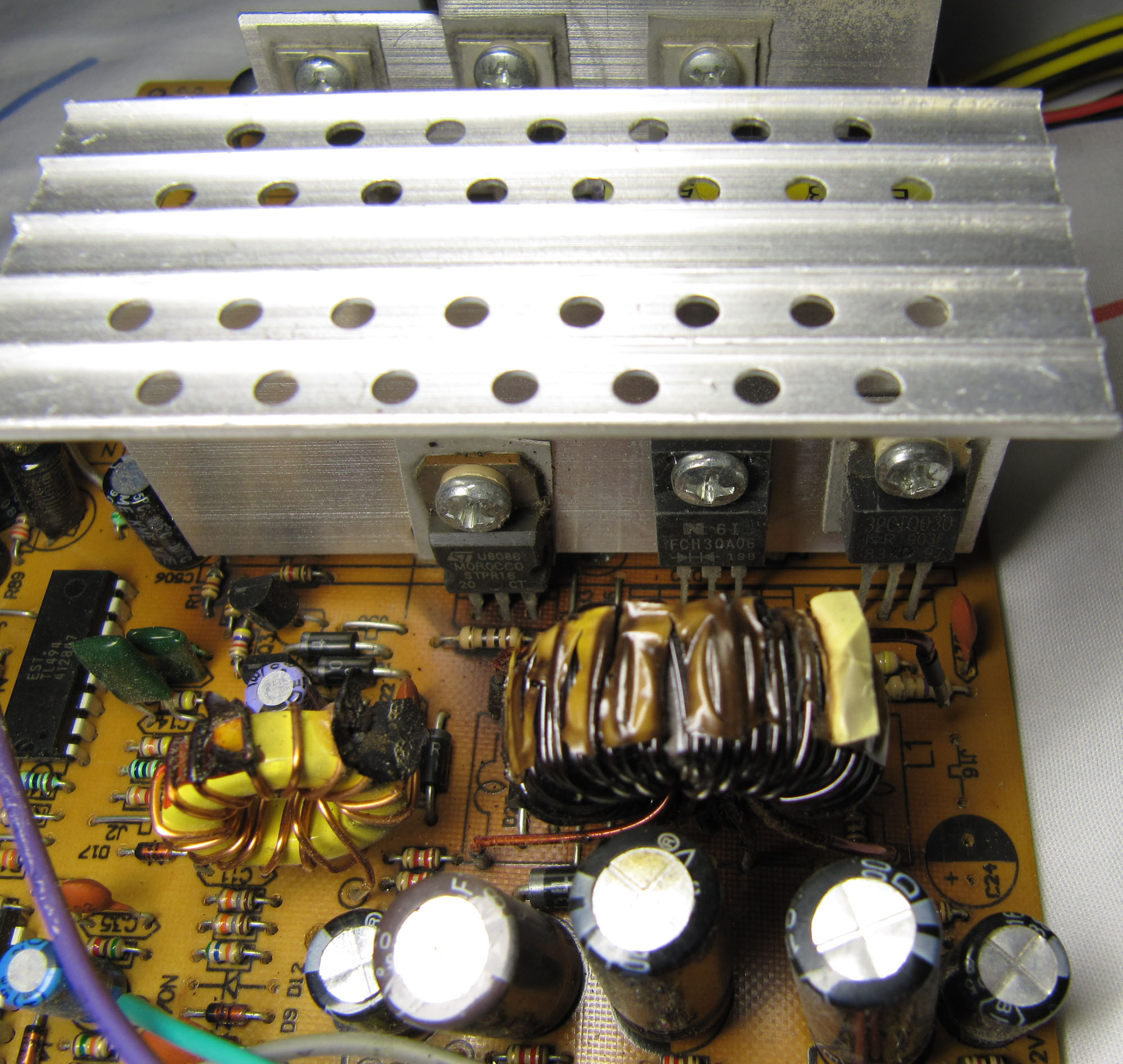

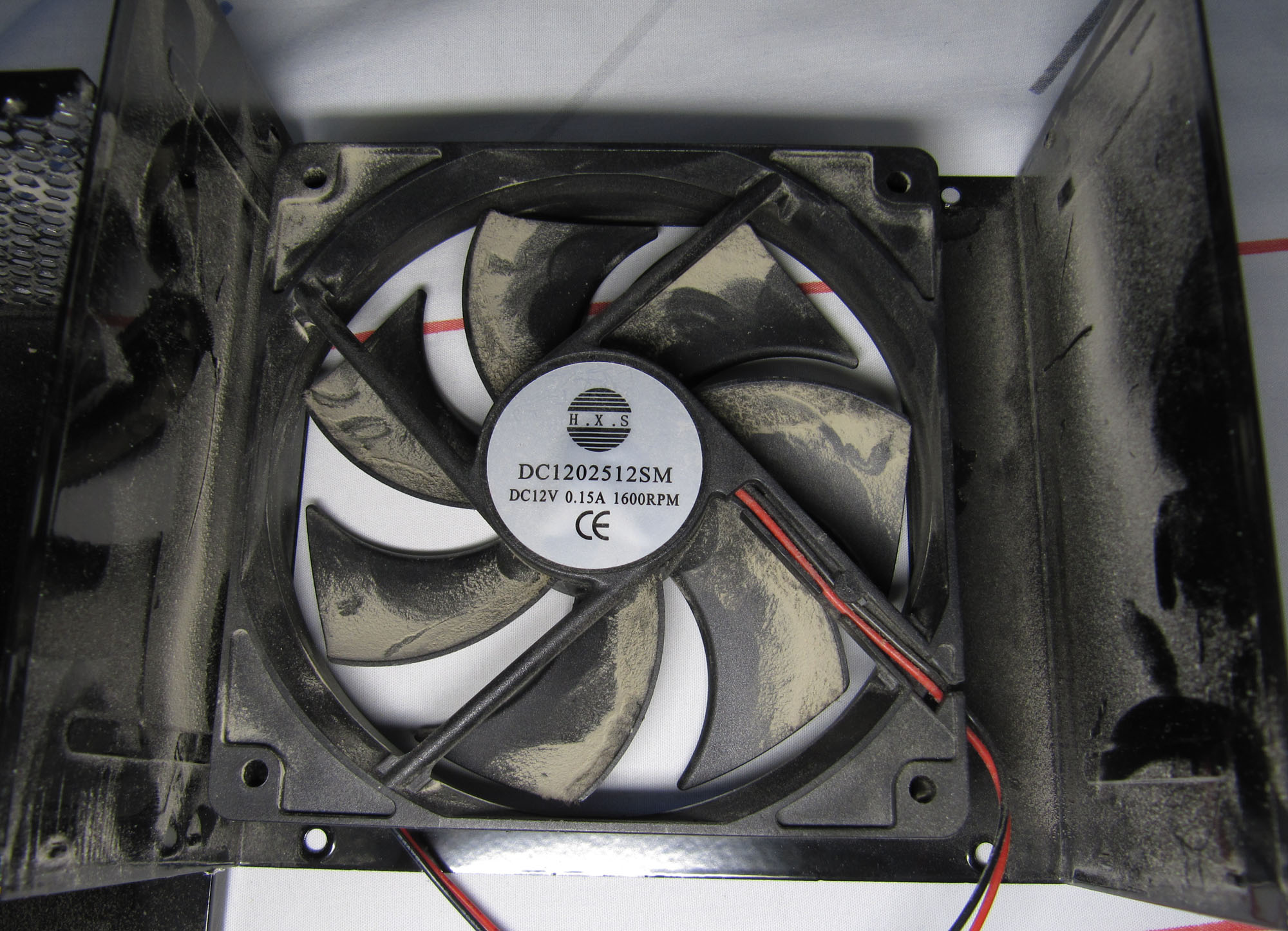

 (not a single safety agency or UL number in sight) . It may not be very clear from the pictures, but the PCB has some serious "burn-in", and this was not caused by a stuck fan since the fan is spinning fine (although, I should note that the fan was quite dry... looks like it never saw lubrication from the factory). Speaking of which, the fan is a Te Bao Metallic Plastic model M802512M rated for 12V and 0.14A. IIRC, this PSU was powering a mediocre Athlon XP 1600+ system with a GeForce 5200FX video card and 1 HDD, so nothing too heavy.
 . It may not be very clear from the pictures, but the PCB has some serious "burn-in", and this was not caused by a stuck fan since the fan is spinning fine (although, I should note that the fan was quite dry... looks like it never saw lubrication from the factory). Speaking of which, the fan is a Te Bao Metallic Plastic model M802512M rated for 12V and 0.14A. IIRC, this PSU was powering a mediocre Athlon XP 1600+ system with a GeForce 5200FX video card and 1 HDD, so nothing too heavy. . It doesn't have a critical capacitor, though.

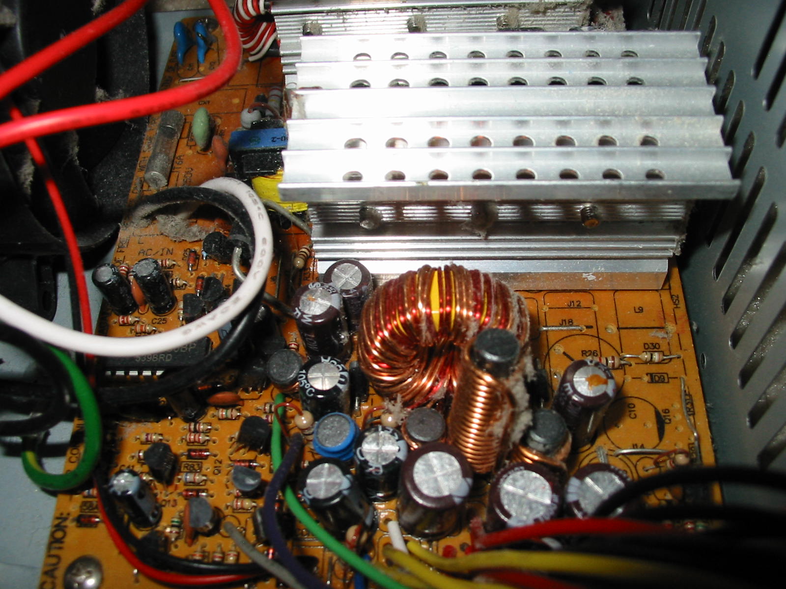

 . Guess if it can (barely) keep ripple at bay without PI coils and just two small craps per rail, my concoction should fare better with real larger jap caps and ghetto-modded PI coils.
