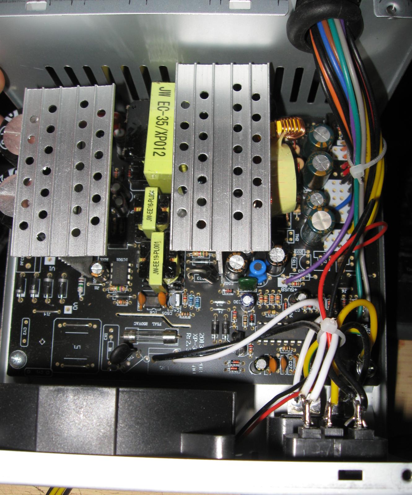

          Re: the gutless, bloated, and fried power supply hall of shame

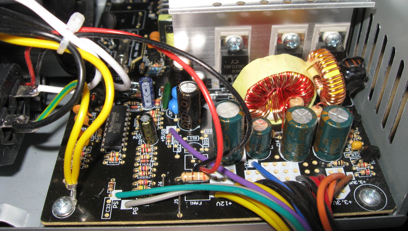

          here's the power supply that died in my father's computer - see this thread if you don't know what I'm talking about : https://www.badcaps.net/forum/showthread.php?t=33718
          Claims 450w , 3.3v @ 24a , 5v @ 35a , 12v @ 16a .. uses 16a diodes on secondary for all rails.
          Primary capacitors claim to be 330uF - I don't care enough to measure them, I'm sure they're probably 220uF. 13007 transistors in theory could give it 250-300 watts but no way with that main transformer.
          Power supply still 5v standby but when i try to power it on, there's a fain fizz (barely audible) and it doesn't turn on. Assume over voltage protection or some diode shorted.. not sure if I even want to spend time to fix it.
          Shame about the nice black pcb with nice silkscreen.
          Not much else to say... see the pictures below:
            That thing's so wimpy that 200W might be pushing your luck, and I'm not sure what the worst weak point is. The AC I/P rectifiers are probably rated for 1A. Even if they really are 330uF, those I/P lytics are nowhere near what they should be for 450W. The heatsinks are somewhere between painfully thin and anorexic. Even the number of output wires on the high current outputs looks worrisome.
            But at least you didn't have lots of beefy components and wires to obstruct getting good pictures! And you don't have to worry about unsafe X and Y caps.
              I actually checked those diodes after taking the shots. I think it says RL257 on those and in that case they're rated for 2.5 A each:
              https://cdn.badcaps-static.com/pdfs/...db8e46f8b2.pdf
              It could be that the manufacturer is overly optimistic or... yeah, datasheet shows them rated at 2.5 A for up to 75c .. at 100c they can only do 1.5 amps.
              It's sad these things are sold in my country and people like my father without electronics knowledge fall for these (and often in small towns with just one IT store you don't have alternatives). He simply went with the whole computer to the store and asked them to change the power supply after previous one failed.
              This power supply was 50 RON, which is about 15.4$ and that includes our country's 24% VAT.
              So the distributor probably brings them into the country for around 9-10$ each...

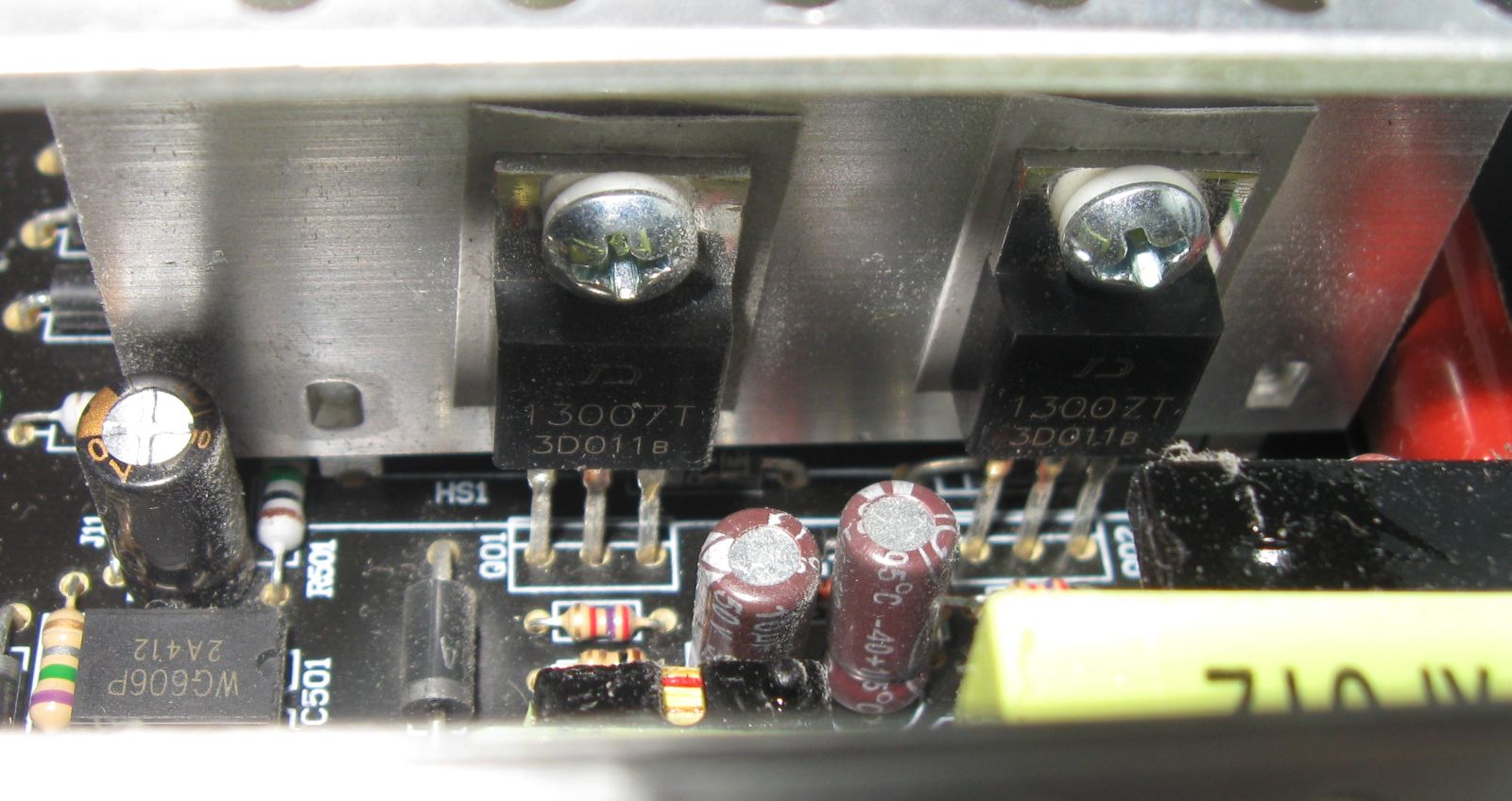

              later edit: what's interesting is that this power supply as weak as it is, it uses that WG606P which apparently is a TNY267 clone. I was expecting the standard two transistor job for 5vSB or something cheap, but there's even a basic pi filter on 5v sb.
                Originally posted by mariushm
                ... not sure if I even want to spend time to fix it ...
                Not much worth it IMHO. Even if you upgrade everything else, output filtering lacks PI coils and there is only one cap per rail . There are no empty parking slots to improve that.
                In Clube do Hardware's 'Produtos Bomba' section (a heaven for the gutless wonder scholar ) every turd with that "output filtering configuration" shows hopeless levels of ripple:
                  Nah, I just misjudged the rectifiers from the picture. At 2.5A they're less under-sized than I thought, but still probably not good - with reasonable derating - for more than 400W. Not having PFC, the peak currents those things conduct at the peaks of each half cycle must be pretty high (looks like it can handle on the order of 12A repetitive peaks).
                      Cannot do with two-transistor forward! Rememer EUs legislatioin, as far as I remember, Romania part of ESSR so it has to comply. For quite some time they demand less than 1 W stand-by drain (with no load) so even cheapest craps since had to do with those PWM-with-integrated-transistor.
                      FSP Group uses 2 transistor still, but they are able to do it so it does not burn power for nothing and even has some nice efficiency under load.

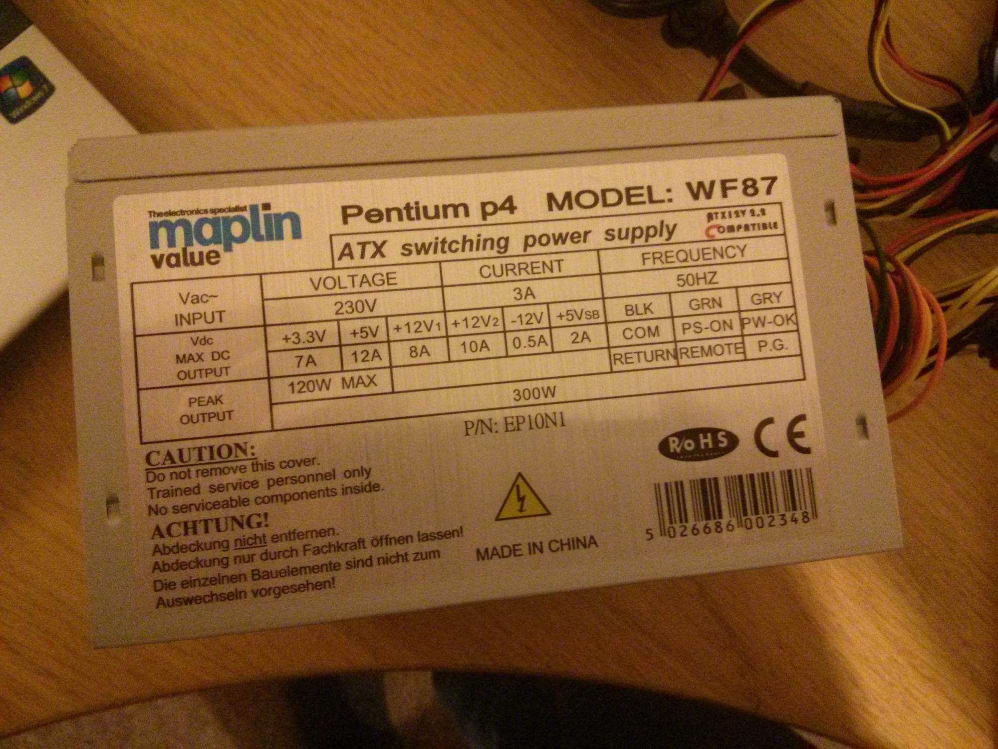

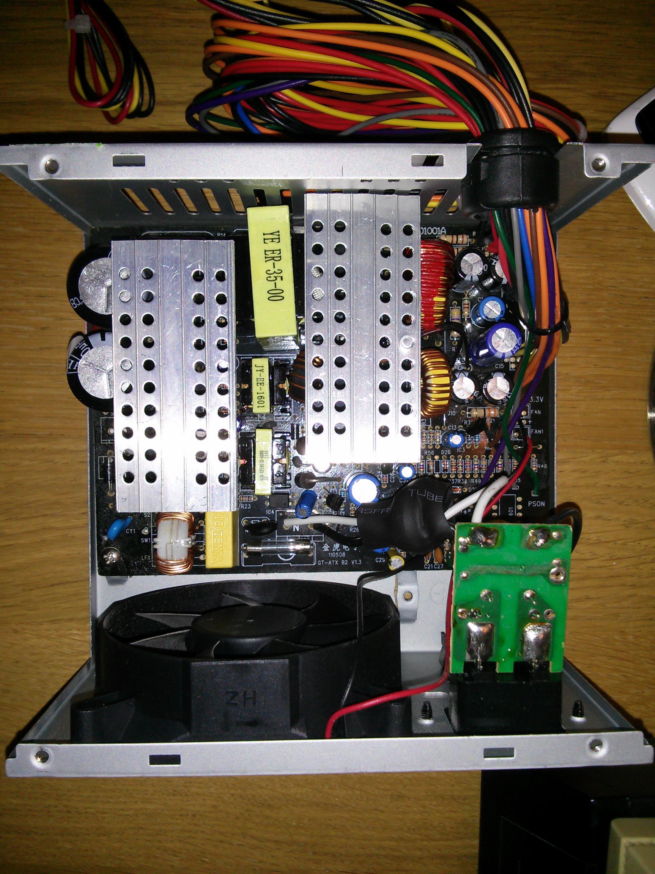

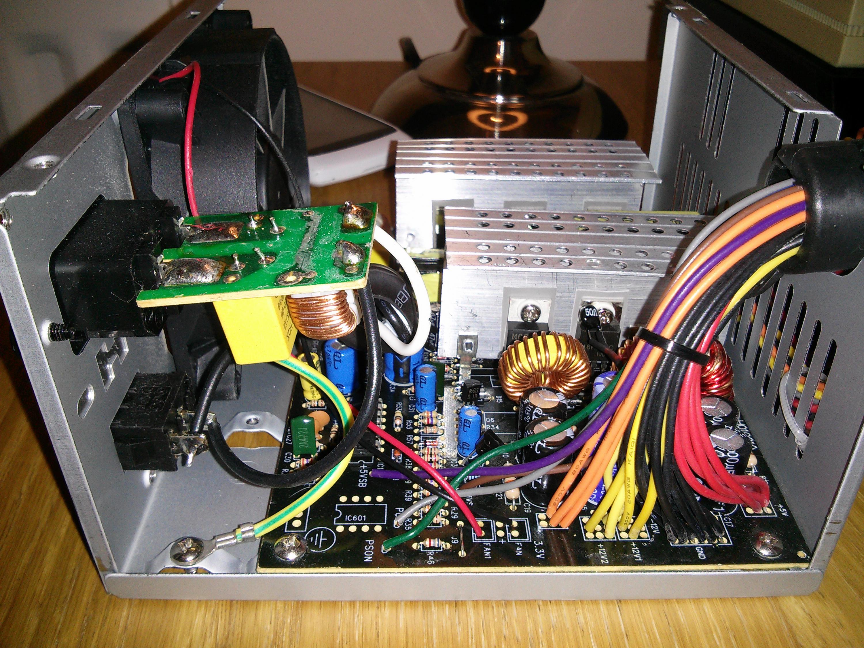

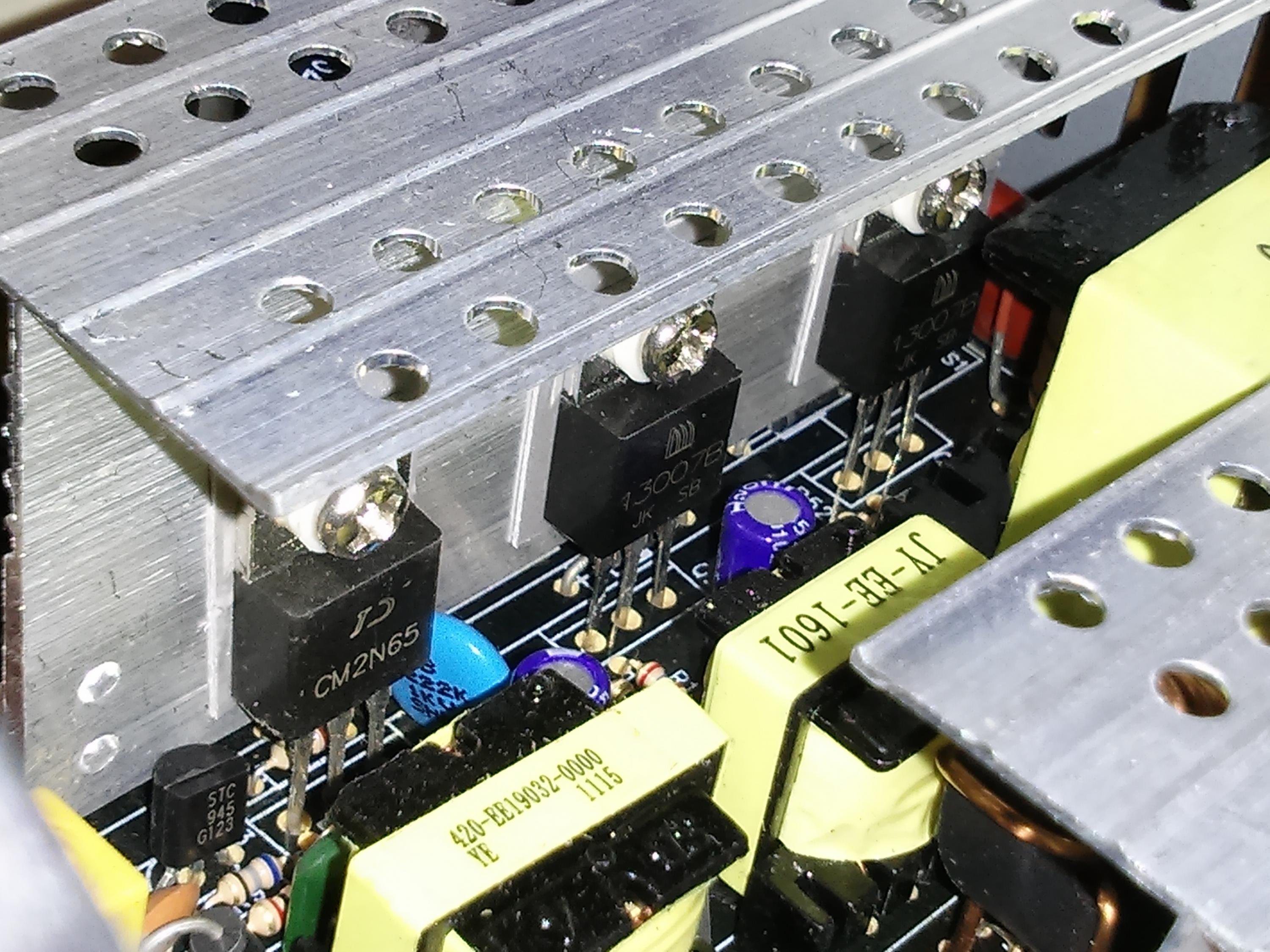

                            From the UK:
                              That looks like a rebranded Coolmax unit, or at least the same OEM. Maybe 200W with the ripple in spec. What brand is the fan that it uses?
                                Other than the 300W and +12V current ratings and the rather empty looking secondary side, that isn't too awful. It even has EMI filtering with what looks like agency-rated parts. 200W seems pretty realistic.
                                  Sorry P4, don't have the PSU around and can't check the fan.
                                  Yep the input filtering is passable but the output is a crime, not a PI coil on sight and just one small 1000uF cap on +12V, that's guaranteed boatloads of ripple.
                                    Looks like a GoldenTiger. Most Coolmax's are Longyi, they are both very similar, usually only told apart by the part number. GoldenTiger = GT, Longyi = LY.
                                      Arguable.
                                      Those heat sinks are paper-thin. I'd rate it around 100 Watts max continuous if you want to keep parts from overheating in there. With those output filters like that, the ripple will be out of spec on at least one rail even at over 50W.
                                      Realistically, I would rate it.... trash
                                      It uses some interesting red glue, though. Beats older Bestecs in that regard.
                                      By the way, isn't this very similar to the PSU that just died in mariushm's father's PC? post $864 above
                                        Golden Tiger like to use that red glue. I recon it could probably do 250W in spec, or maybe a little less if the fan stays real quiet. Even with those thin heat sinks, I've successfully pulled that from a few PSUs before. I've even manged 300W from one or two. It actually looks similar to a Bliss "350W" which will be in the 2013 el cheapo roundup. That one didn't blow up until I asked for 350W.
                                          But for how long is the question?
                                          A few seconds to a few minutes isn't satisactory for me. If you ran it on the load tester for a day, then I say that's acceptable.
                                          Also, how much heat is the PSU kicking out at that power level and how hot are the heat sinks? I bet you the output caps will bake quickly if the PSU is ran at that much power over an extended period of time. And I'm almost certain you can't get even a 100W out of the PSU without one of the rails getting out-of-spec ripple.
