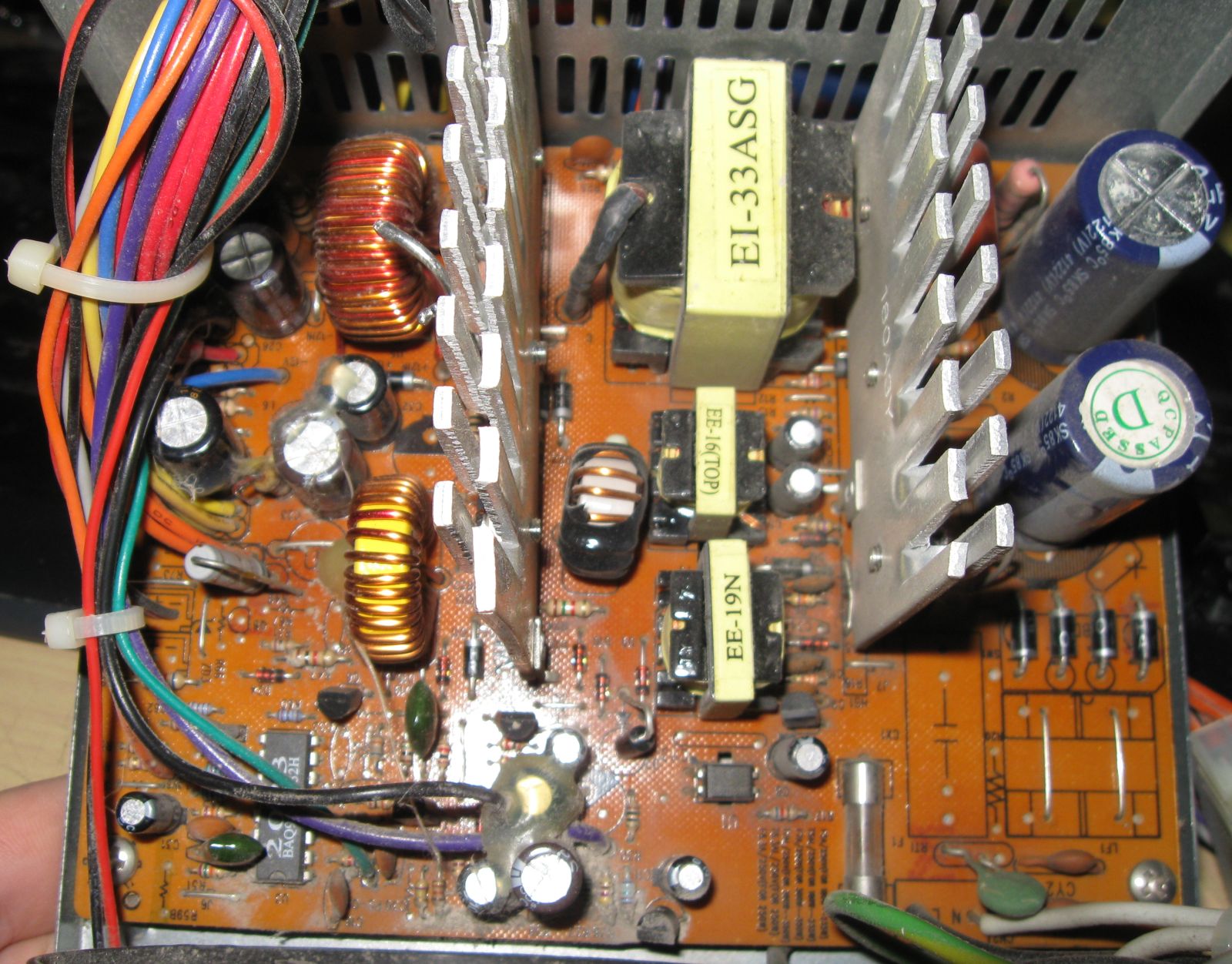

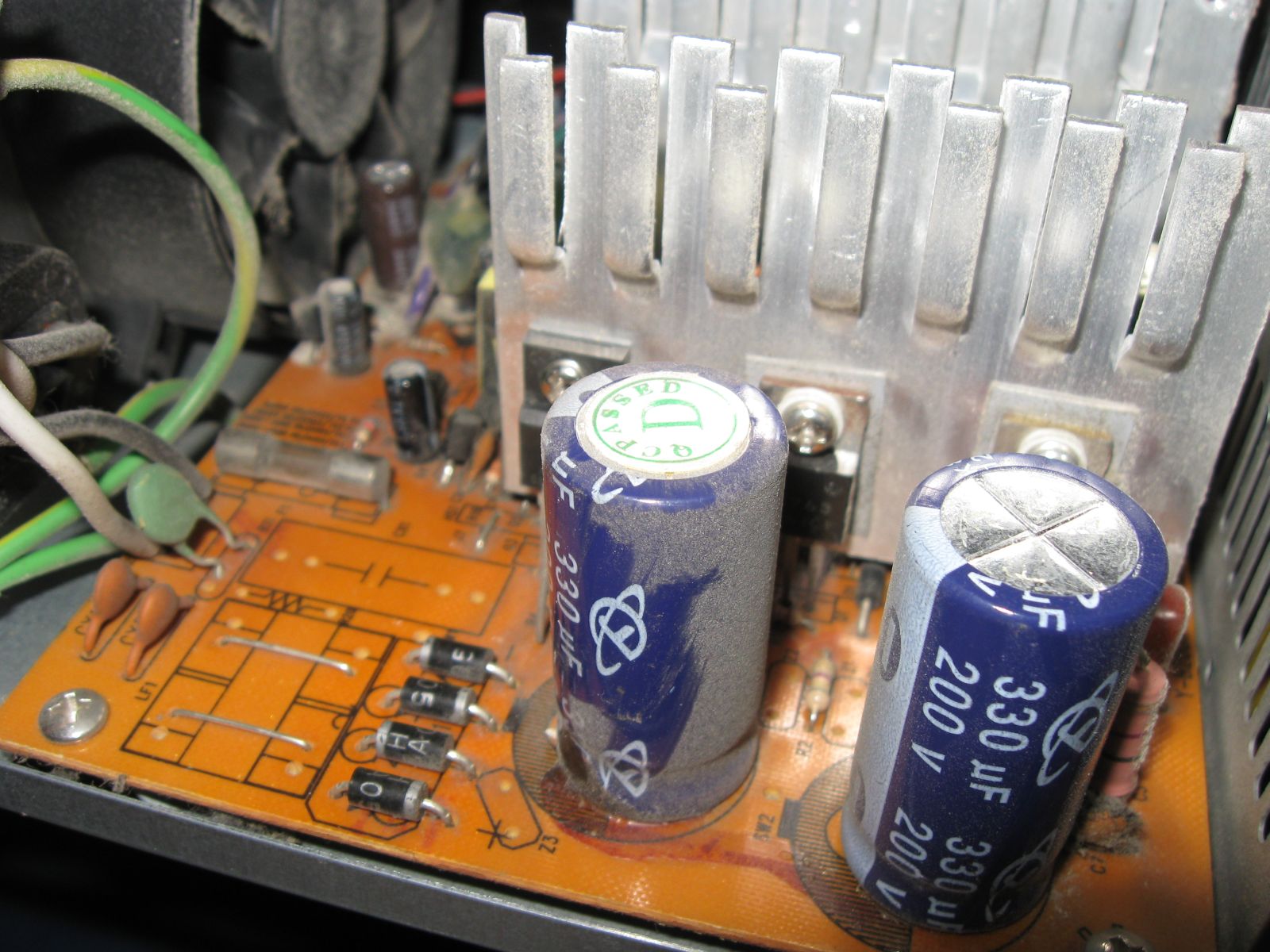

                  And here's the shitty power supply that the power supply above is gonna replace.
                  This one in theory still works but I'm a bit concerned about the 12.5v output. After opening it up, I realize it's actually worse than the above power supply.
                  Just some Y caps that I doubt they're safety rated on the primary side,
                  puny rectifier diodes good for probably 1A each,
                  330uf/200v YC brand capacitors that in reality are 216 uF each (and about 0.15 ohm esr not that it matters here)
                  didn't bother to write down the mosfet/transistors on primary, i though they can be read from pictures... can't be bothered to open it again
                  ei-33 (in theory) transformer
                  SBL1640CT (16a/40v max) schottky on 5v, SBL1040CT (10a, 40v) or 3.3v, two big diode treatment on 12v (who knows, maybe 4-6 amps? )
                  Some YC caps on secondary side, some Su'scon (probably on 5v and 3.3v) , I think maybe a G-Luxon on 12v? 470uf/16 on -5v , 1000uf/16 otherwise as far as i can see
                  no secondary side inductors in sight, just a couple of minimum load resistors (3.3v and -5v?)
                  Weak, really weak...

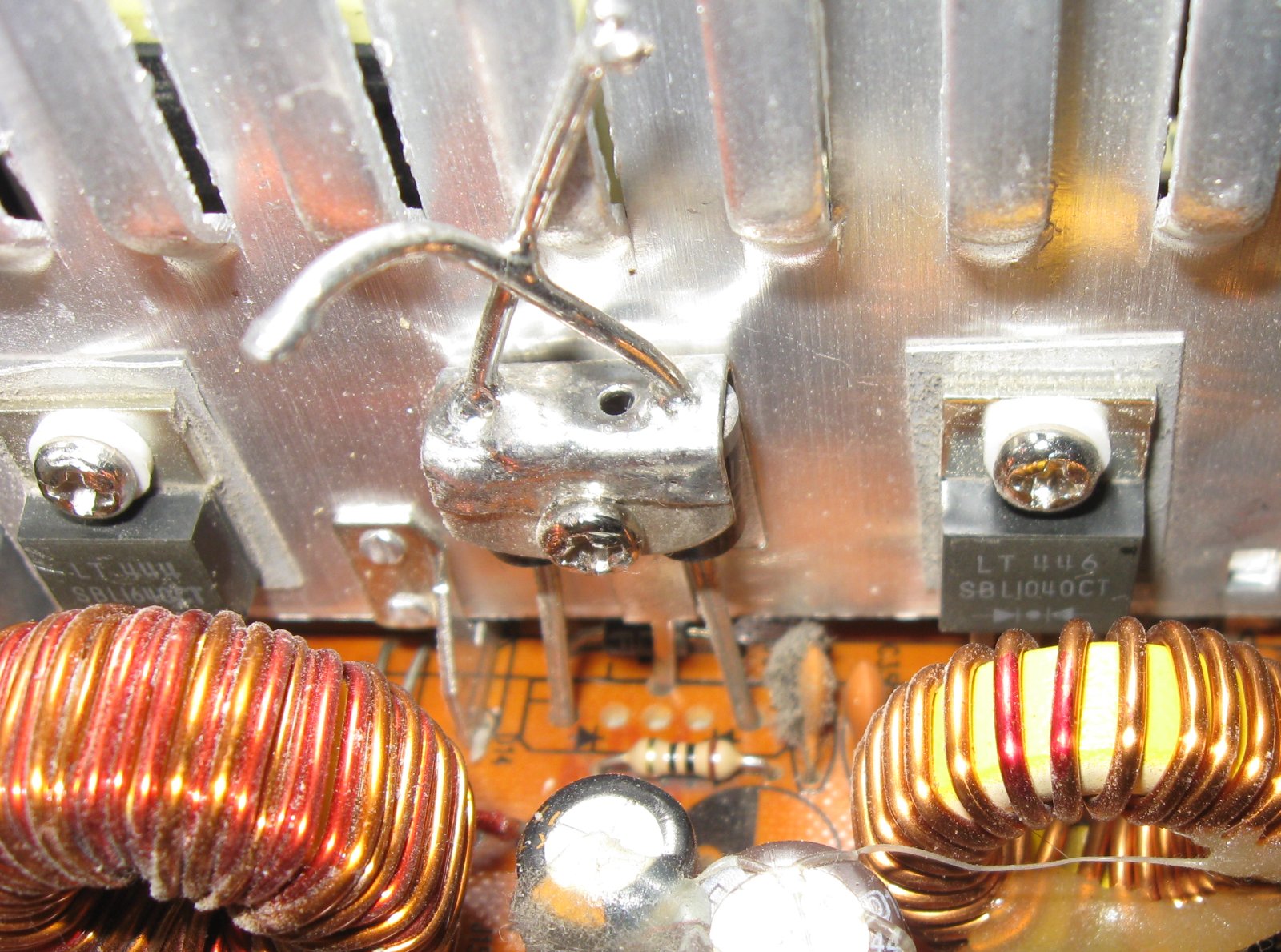

                      Another typical L&C. That thing looks like it would struggle to power a clock radio.
                      I still have an L&C diode bracket (poor man's MOSFET) modern art piece in my diode/transistor collection.

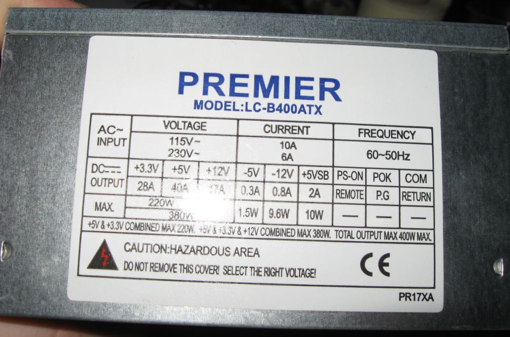

                            'REAL POWER: 250W'
                            • rogfanther
                              • Jul 2006
                              • 458
                              • Brazil
                              #834
                              Re: the gutless, bloated, and fried power supply hall of shame
                              Probably the real "real" is around 175-200W ...

                                'REAL POWER: 250W'
                                Yeah, I think they meant UNreal power.
                                And next to where it says "500W" on the sticker, it should say, gamers's overclocked supper power!
