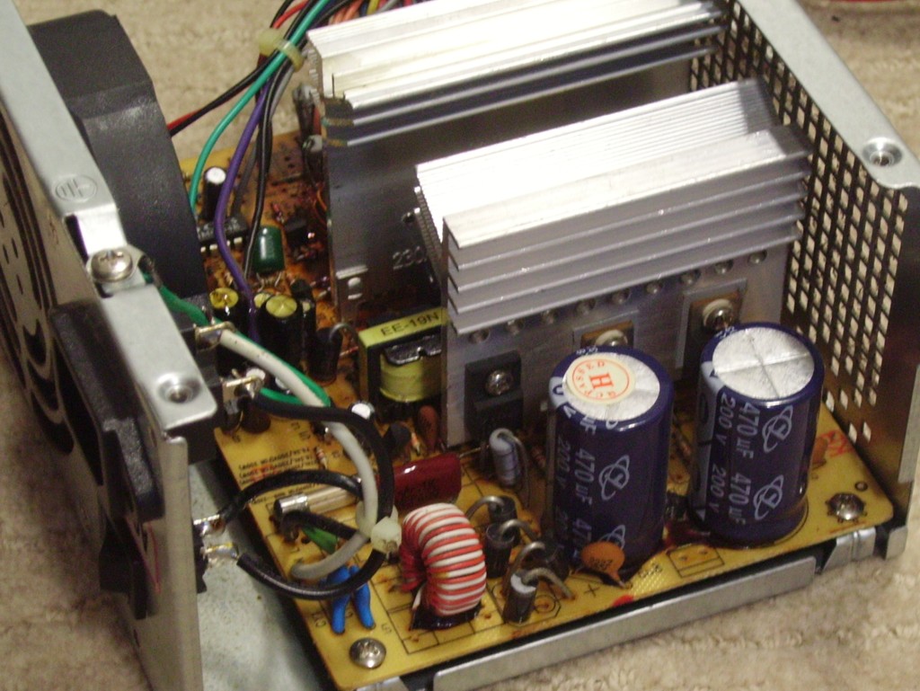

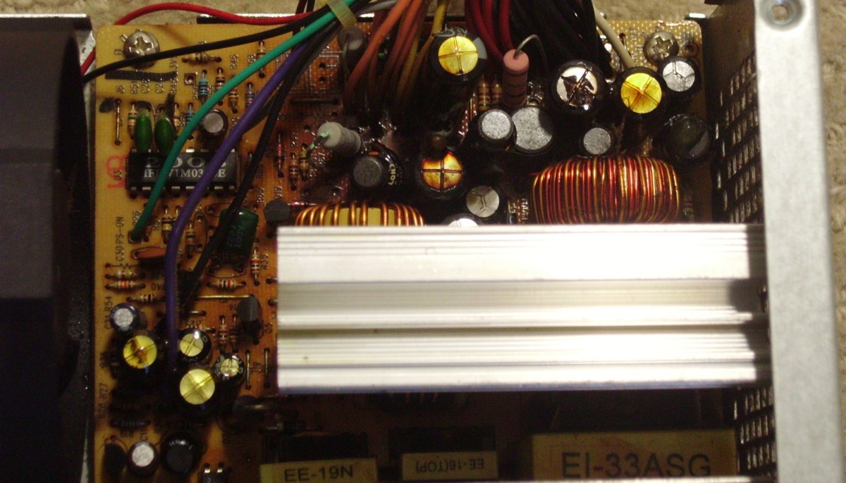

            I just got a dead "TT" branded PSU from a repair, where there are massive burn marks near the wires on the secondary side, Caps are all bloated and it took the motherboard out. Pics coming soon.

              Just realised all the glue on the caps, but they're going to need more to stop them leaking.

                It's an L&C...
                • c_hegge
                  • Sep 2009
                  • 5219
                  #48
                  Re: the gutless, bloated, and fried power supply hall of shame
                  Originally posted by goodpsusearch
                  It's an L&C...
                  L&C=Deer=

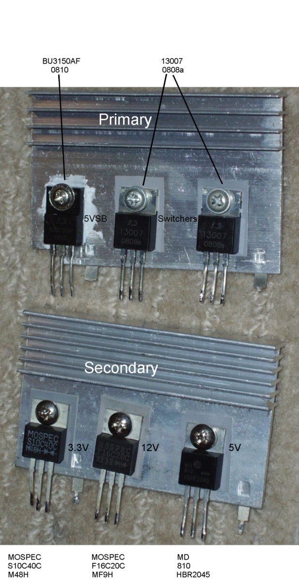

                    Its got some potential with those heatsinks.

                      That seems to be just like my "Super Talent" power supply that I posted about a while ago somewhere on this forum. After a full recap, upgrade of the secondary rectifiers, and upgrade of the primary filtering and bridge rectifier, it works great.

                        That's some nasty heat damage near the secondary caps...

                          its the opposite of a linkworld i just gutted, great filtering and wire, good rectifiers, etc. but he caps were bad and the heatsinks were TINY! good for parts only.
