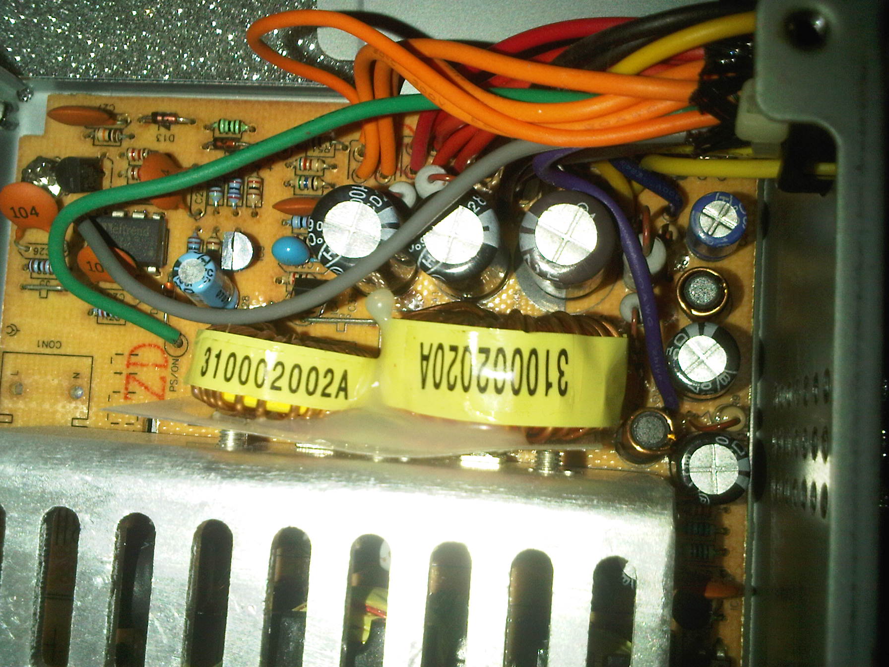

      Attached are pics of a CEO-250P MATX power supply. Thoughts would be welcome. It seems to be lacking vital input filtering components?

        Well, it seems to be built slightly better than most wonders claiming to be 350+ W Pi coils seem to be missing which may be a problem as for ripple being in specs. Could be solved by increasing capacitance to absolute limits (~3300 uF for D10), for this power (250 W).
        Transformer is OK, rectifying diodes could be as long as they are at least 2 A rated. What is rated capacitance of those big caps on primary? What transistors are there and what rectifiers on secondary?

          That is a cute little PSU there! Recap, add some EMI filtering, and it will be pretty decent!

            Heatsinks look adequate, O/P inductors look reasonable. The I/P rectifiers look the same size as 1N400x series, which are 1A rated parts. Hope they're better than that! wouldn't operate that thing in the same room as a TV or AM radio! If you have decent switch transistors (probably BJTs) and O/P rectifiers, it might be worth kludging in some I/P filtering to reduce interference with other nearby electronic devices.

              It looks like there isn't room on the board for adequate filtering on the outputs.

                I wouldn't trust it in a P4 computer with only 8A on the 12V

                  To add EMI filtering, can I just add X capacitors from random (junk) power supplies? I will take a closer look at the ratings of some of the components later.

                    Sure, we all do that. Just use those safety-aproved X caps, not ordinary ceramics. The same for Y caps.
