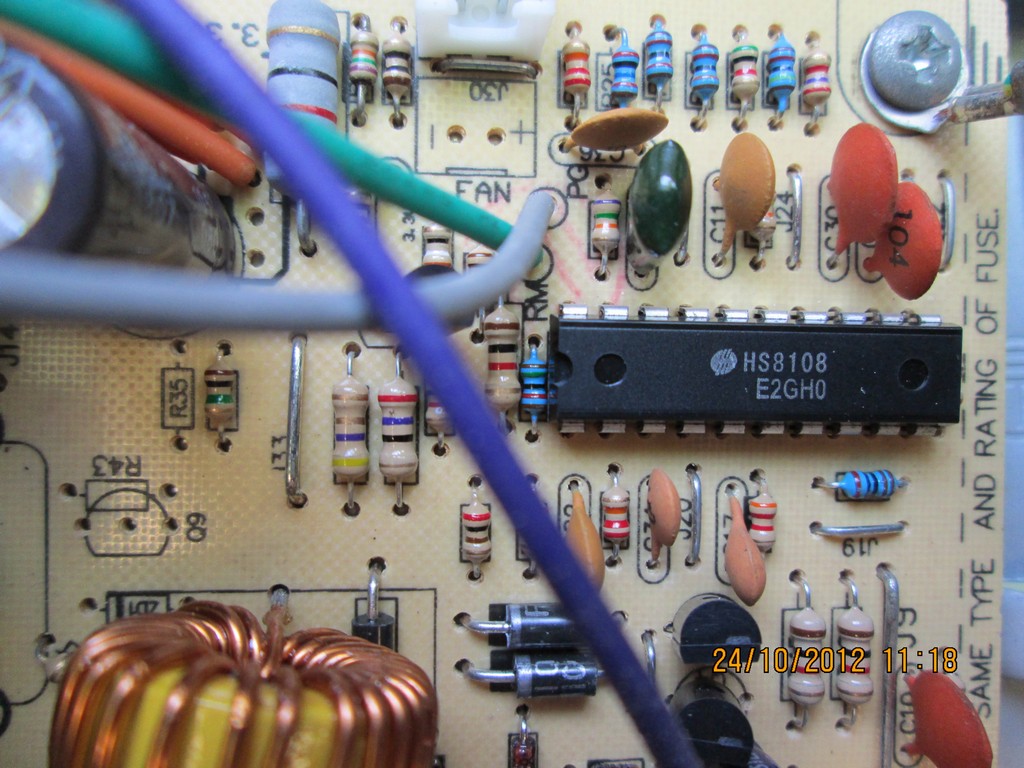

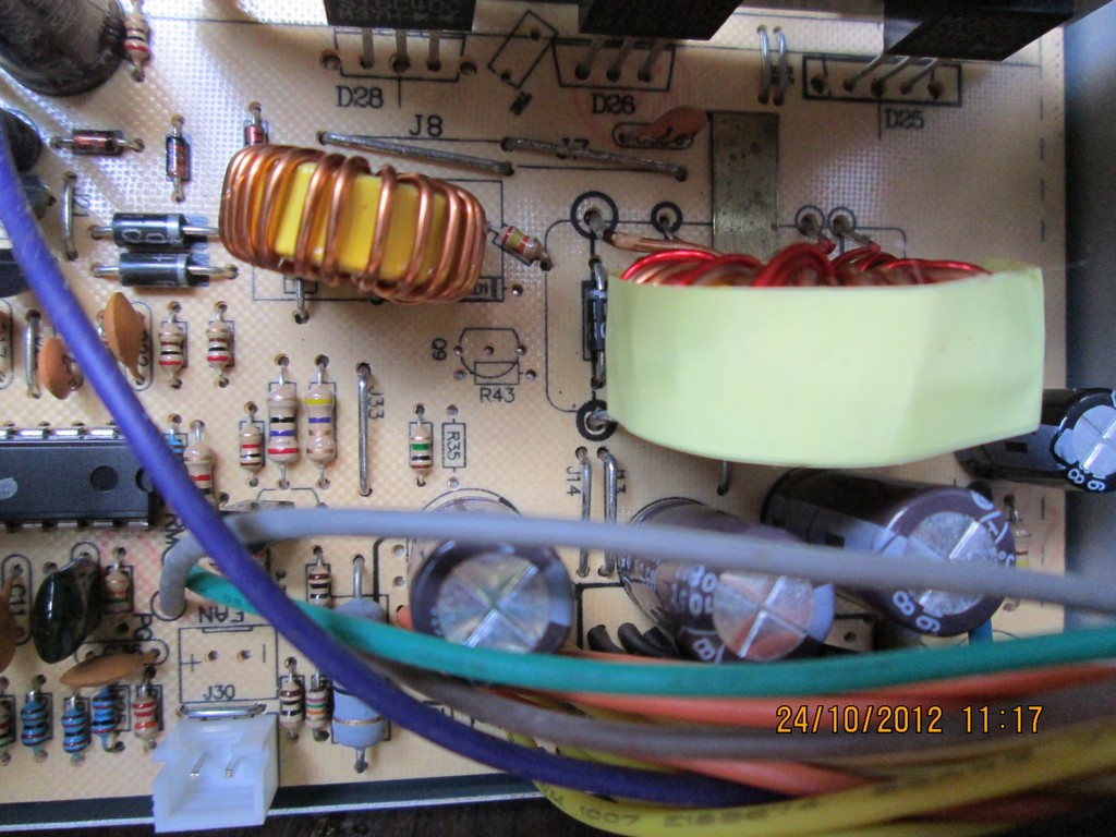

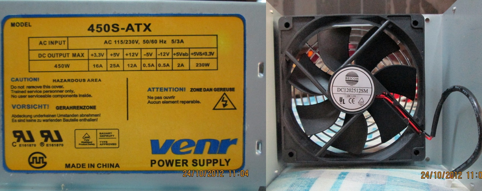

                                      VENR (fake ?) 450S-ATX
                                      No EMI filter. Primary caps : Fhy 330uF - 200V x2 85C
                                      Two transistors 5VSB: C945, D13003
                                      Main switcher: D13007 x2. Very small main tranformer.
                                      Secondary:
                                      Rectifiers: S16C40C x2, F12C20C. No pi filters.
                                      DC filter caps: 1000uF - 16V x3 , 470uF - 16V, 1000uF - 16V (5VSB), all BH 105C.
                                      PWM controller : HS8108.

                                        #379
                                        Re: the gutless, bloated, and fried power supply hall of shame
                                        That thing is silkscreened to have PFC? That looks like a new age Leadman/Linkworld

                                          #380
                                          This PSU has no PFC, just jumbered. I don't know who is real manufacturer. This is their logo.
