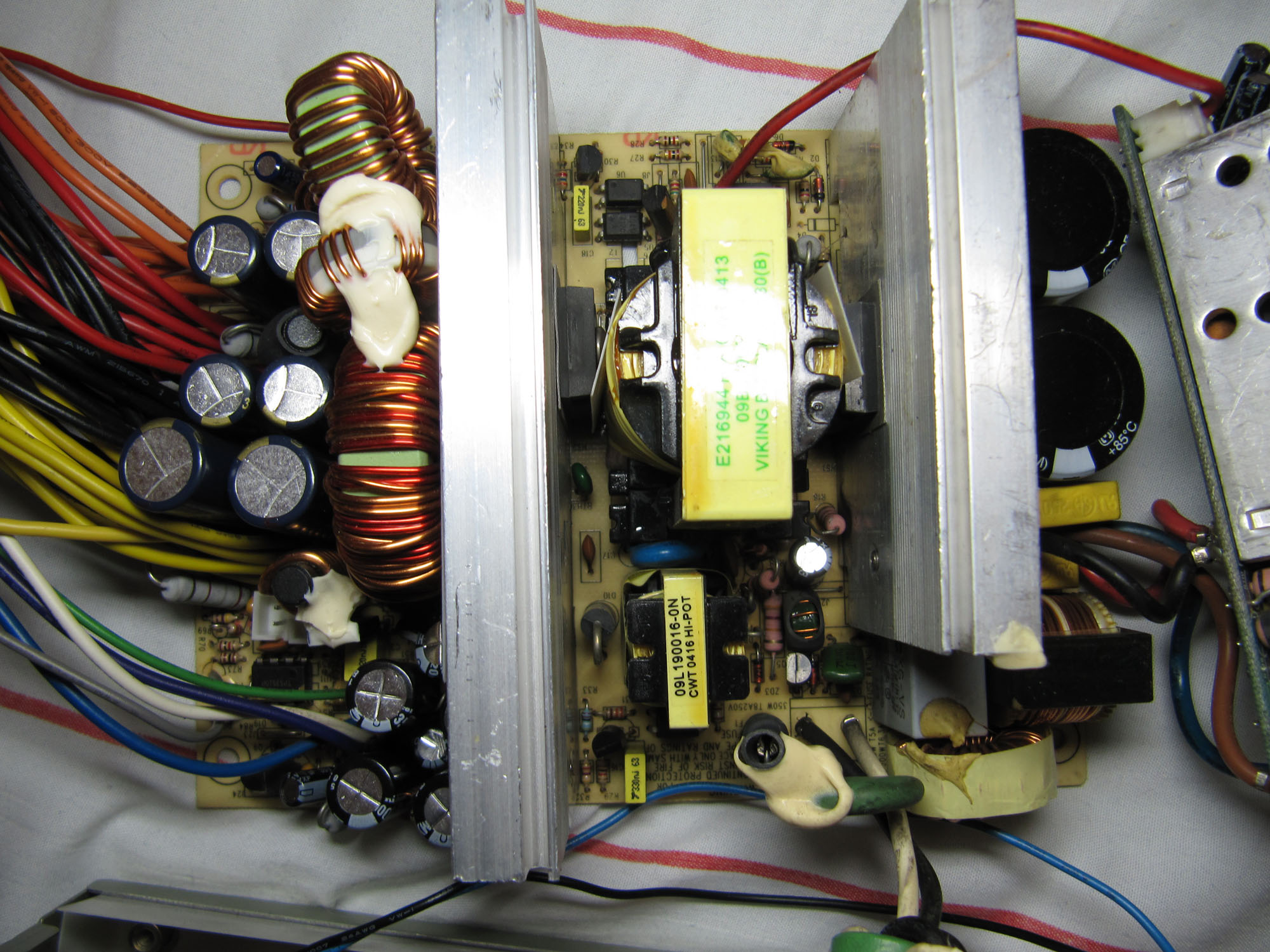

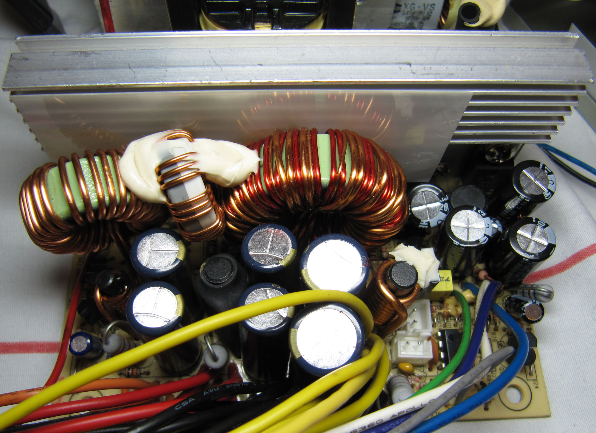

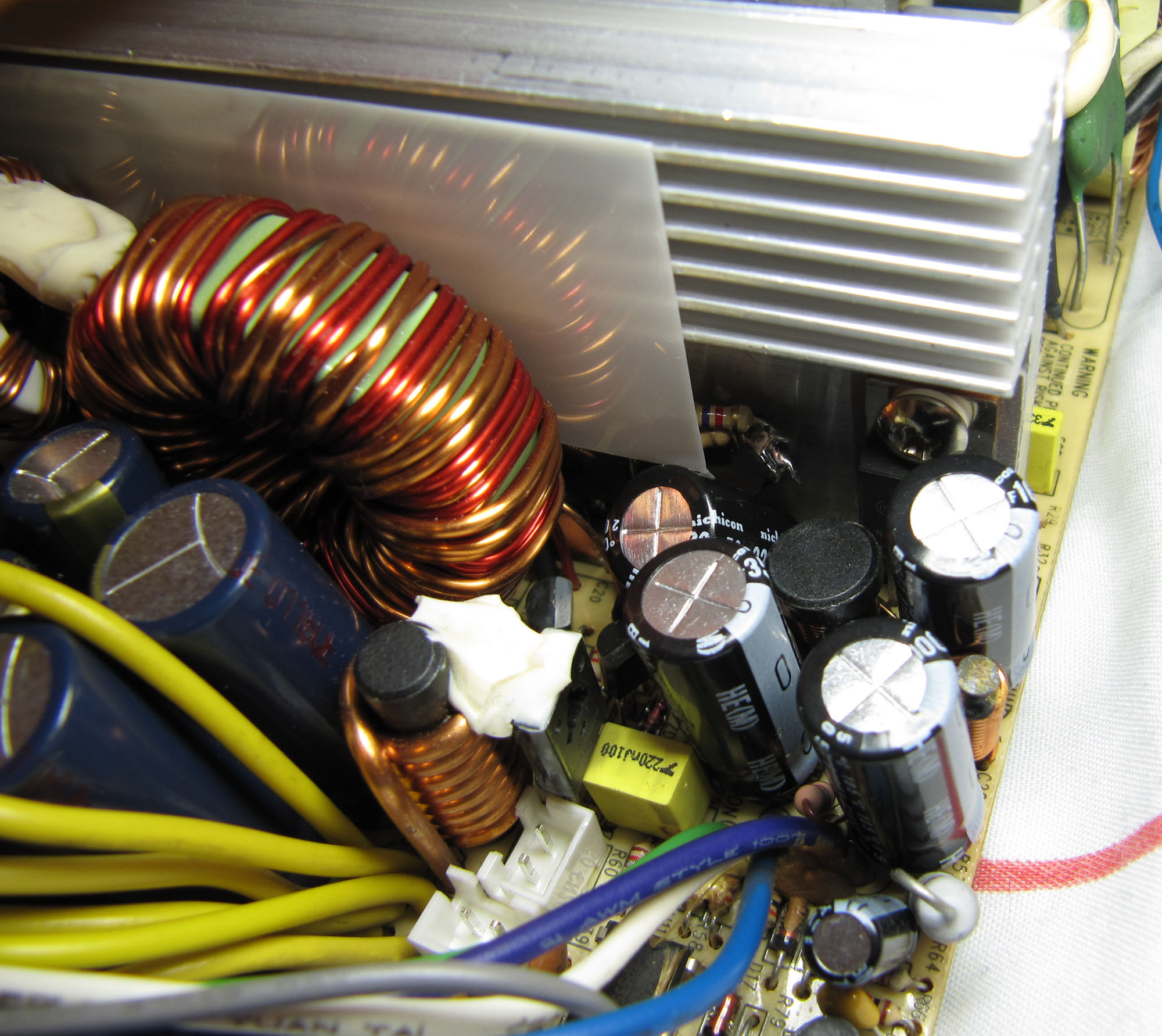

      I fully recapped that power supply!
      2χ470uF Fuhjyyu main caps got replaced with 2x560uF 200V Panasonic
      12V pi filter: 2x2200uF 16V Fuhjyyu TNR + TΜR --> 2x3300uF 16V Panasonic FK 12.5mm
      5V: 1x3300uF Fuhjyyu TNR + 1x4700uF 10V Fuhjyyu TMR --> 2x3300uF 6.3V Panasonic FK 10mm
      3.3V: 2χ3300uF Fuhjyyu TNR + TΜR --> 2x3300uF 6.3V Panasonic FK 10mm
      I added an extra 4 pin connector to the existing 20pin ATX connector.
      I added 5.6kohm and 4.7kohm (=~2.5kohm) in parallel with RTH2 so that it wont cook itself.
      Some of the caps I used were of larger diameter that the original Fuhjyyu, but I managed to squeeze them in.

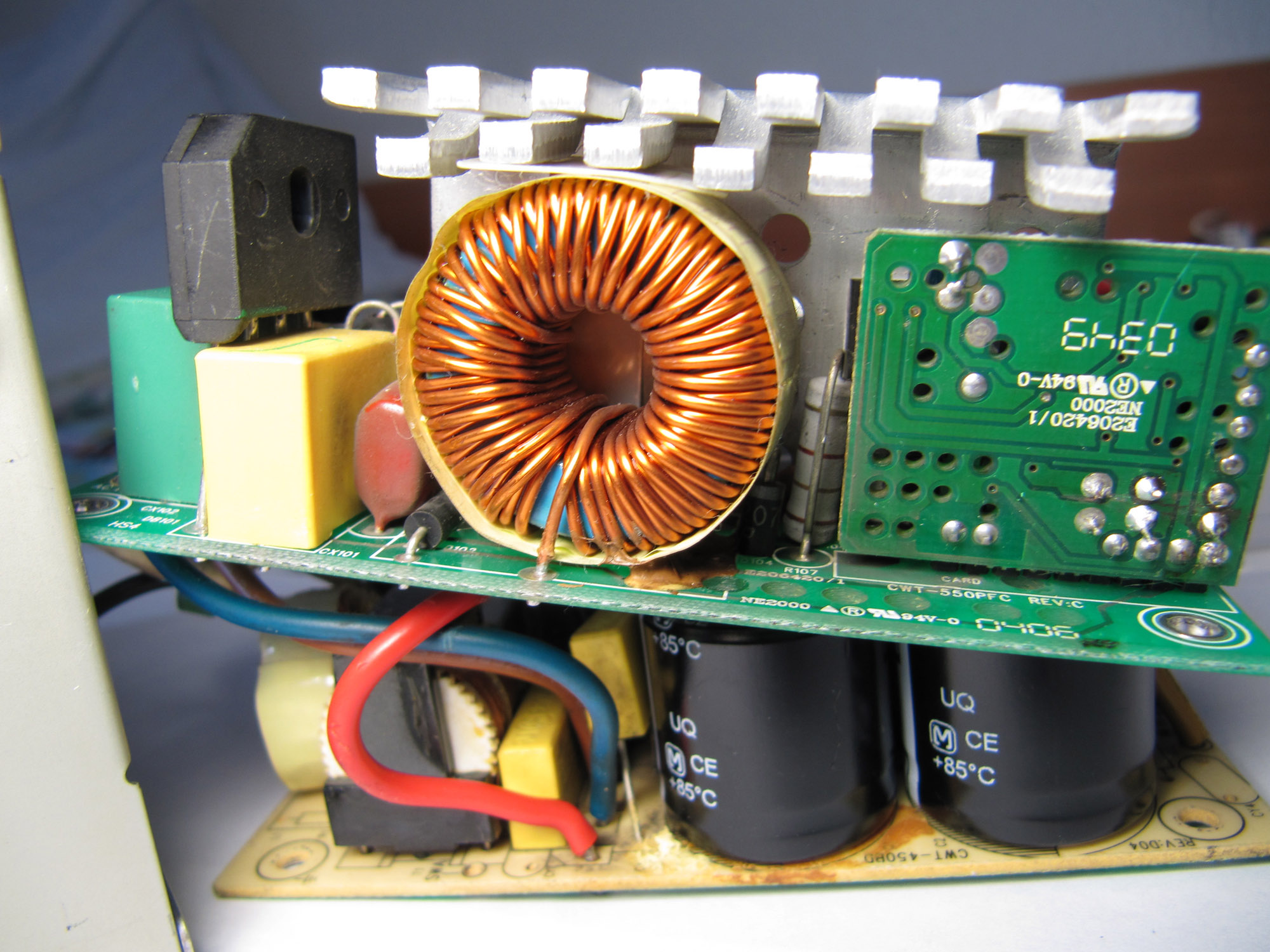

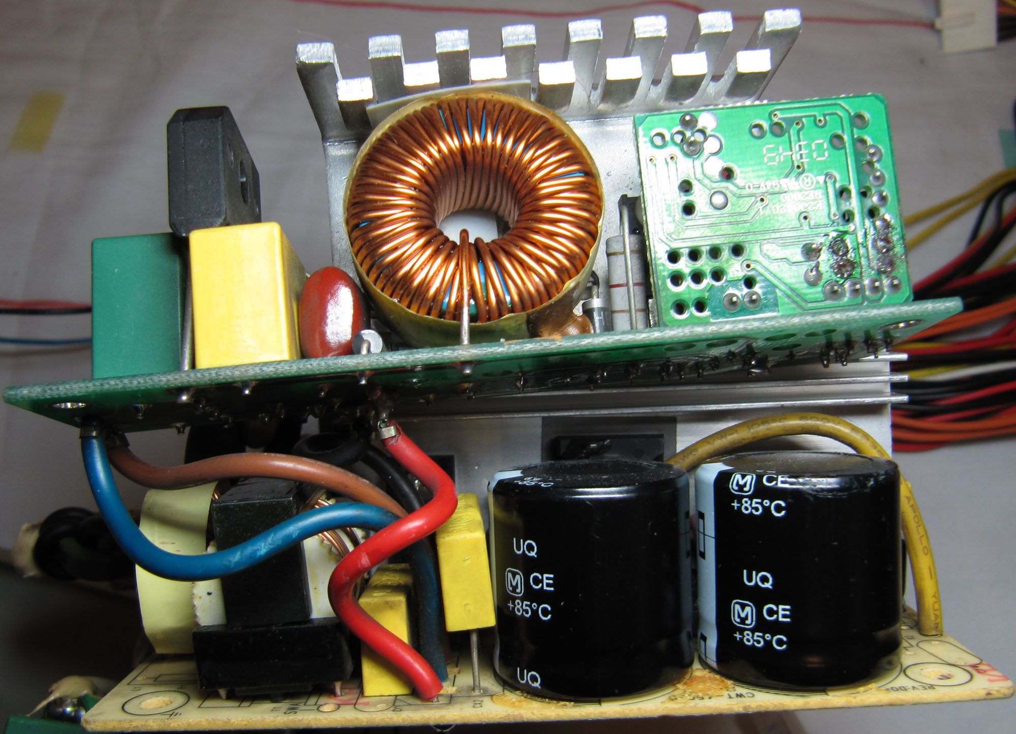

              The Antec Smart Power psu I repaired and recapped back then, has been sitting in the attic all those years doing nothing.
              I took it from there today to test a computer and when connecting it to AC there was a loud bang and right after some smoke and burnt silicon smell caming out of the power supply. The circuit breaker of the room tripped.
              It appears that the Active PFC mosfet is shorted. Until now I thought that the reason of this thing happening is the Fuhjyyu primary capacitors going bad. But this is not the case here. This power supply was fully recapped. The replacement primary caps are Panasonic and I tested them and they are in specs. Nothing else seems wrong.
              So, what do you think? Is it a badly designed APFC add on board? Should I remove the active pfc completely and run the psu without it? Or should I replace the 2SK2996 that shorted with K10A60D that I have in stock?

                So, what do you think?... Should I remove the active pfc completely and run the psu without it?
                Yes, get rid of the APFC. You live in a country with 230 VAC, so efficiency is not a problem for you. If anything, your efficiency will improve.The PF figures will look worse, but no one really cares, except maybe the power company. But for a small load like this (as compated to a stove or a heater, for example), it really doesn't matter at all.

                  Well, since I had the replacement mosfets available here and out of scientific curiosity, I replaced the shorted mosfet with K10A60D and plugged the psu to the mains with a lamp in series.
                  5vsb worked without any problem. Then I disconnected the mains right after I shorted green with ground and the fans spinned for a second. I din't let the psu run ON with the lamp in series cause from my experience that apfc doesn't like the lamp in series trick.
                  Then I connected the psu directly to AC mains. 5VSB worked without any incident. Then I shorted green and ground and plugged it to mains... the mosfet shorted again and the circuit breaker tripped. So, there is definitely something wrong that makes the APFC Mosfet break. I hope it's something in the APFC board, but I can't say for sure until I replace it with a bridge rectifier and test the power supply again.
                  I am very curious about the reason that all these APFCs die. Could it be bad desing? There are incidents where the APFC coil gets hot. I attach a photo with APFC boards from Antec Smart Power psus sold in EU. On 1 of them the toroid coil material is burnt.
                  @momaka the worst about removing permanently the APFC board is that the primary caps (originally 2x470uF 200V Fuhjyyu recapped with Panasonic 560uF 200V) need to be replaced with 820uF or 1000uF or else, due to lower voltage across the primary caps the power supply will not be able to output more than 350W...
                      But if you are not going to use it in a machine that draws more than 350W from it, you might as well leave it as is.

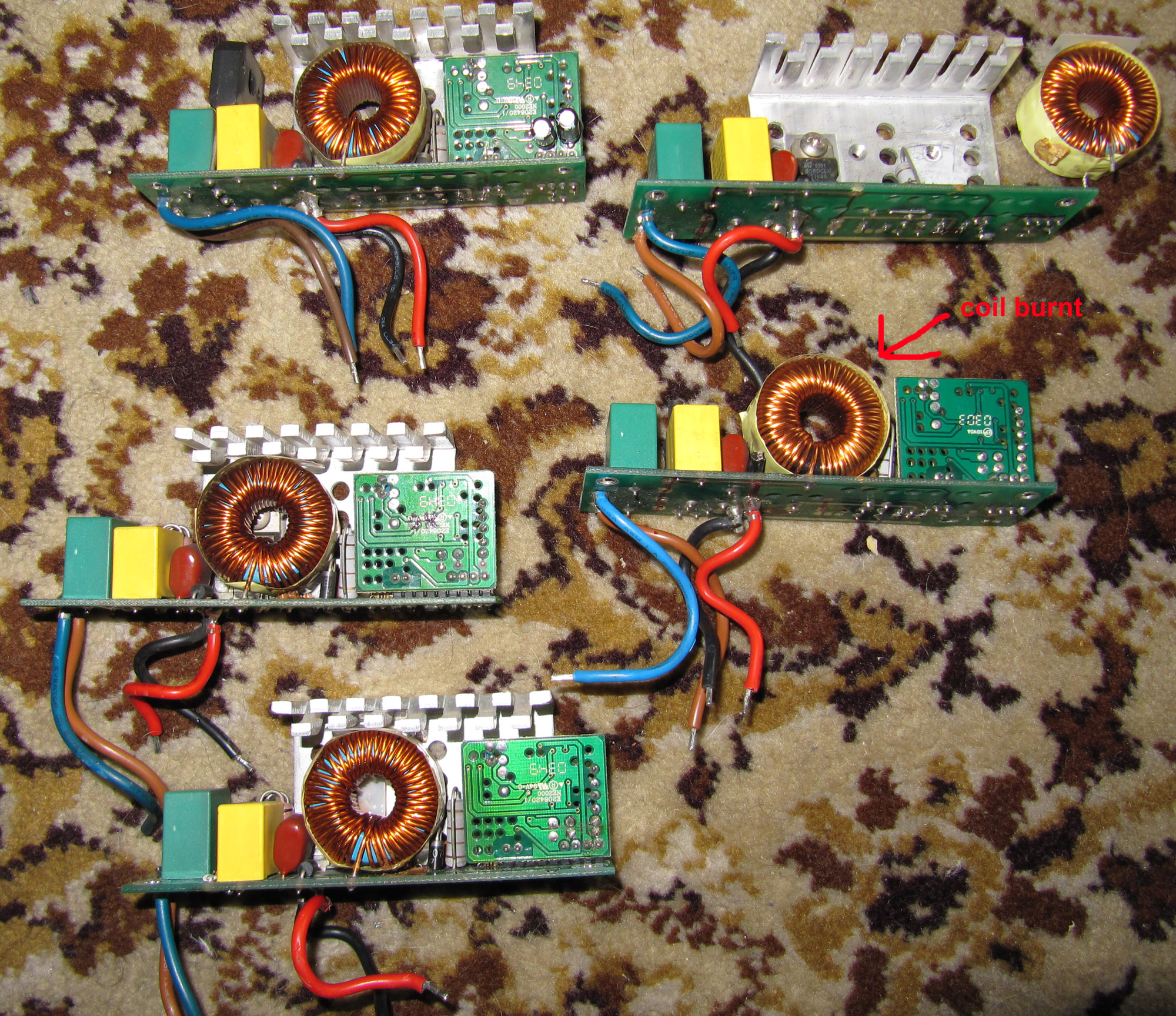

                                Guys, I have two identical Antec Smartpower 450W psus, one has still APFC add on board and works without a prob
                                and the other has its PFC mosfet blowing repeatedly, so I removed the add on board and replaced with bridge rectifier. The input filtering is present and good for a 450W psu. Now I need to put bigger input caps, 1000uF would be nice.
                                But what worries me is that the same thing might happen suddenly to the other, still working, APFC board. It would make me feel more confident if I knew what is the reason of all those failures... Could it be the coil? Or some resistor? I tested them and didn't find something failed or open.

                                    intermittant shorted turns in the coil.
                                    run too hot and subject to vibration.
                                    had one i could hook to a ringer and tap to see this.
