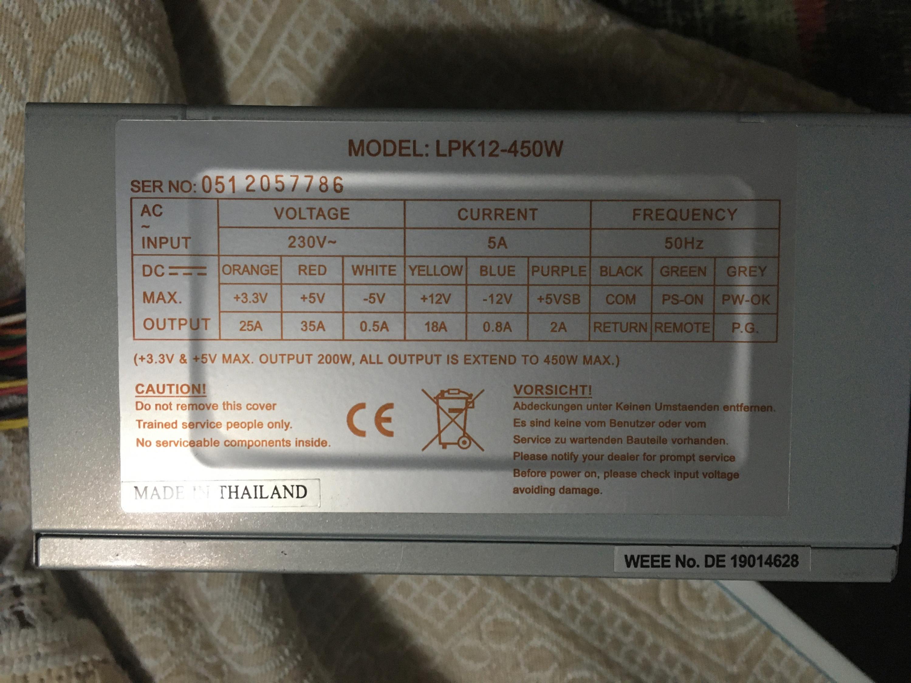

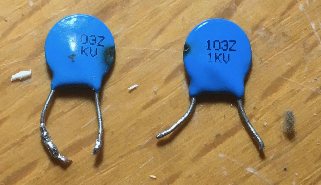

    This power supply is from my nephew.
    This power supply was short-circuited, as soon as he connected the power cord, the electrical panel of the house would shut down.
    I tested it in my house and it seemed to work well, the electrical panel of the house did not turn off. The mismatches of 5VSB, +12, -12, +5 +3.3 were all normal. I was not sure what the problem was ... until I got an electric shock from touching the metal case of the power supply.
    It seems that there was a current drain to the earth.
    My house is older and there are no grounded electricity outlets, which is why the electrical panel was not going down in my house.

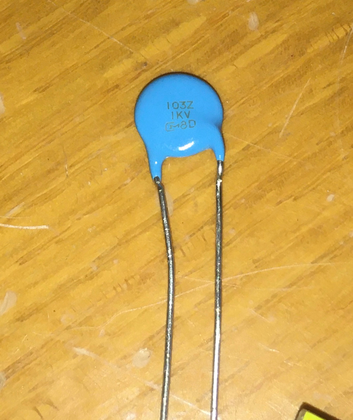

    I opened the power supply and found that the Class-Y capacitors had a small burn mark.
    These capacitors are designated 103Z 1KV.

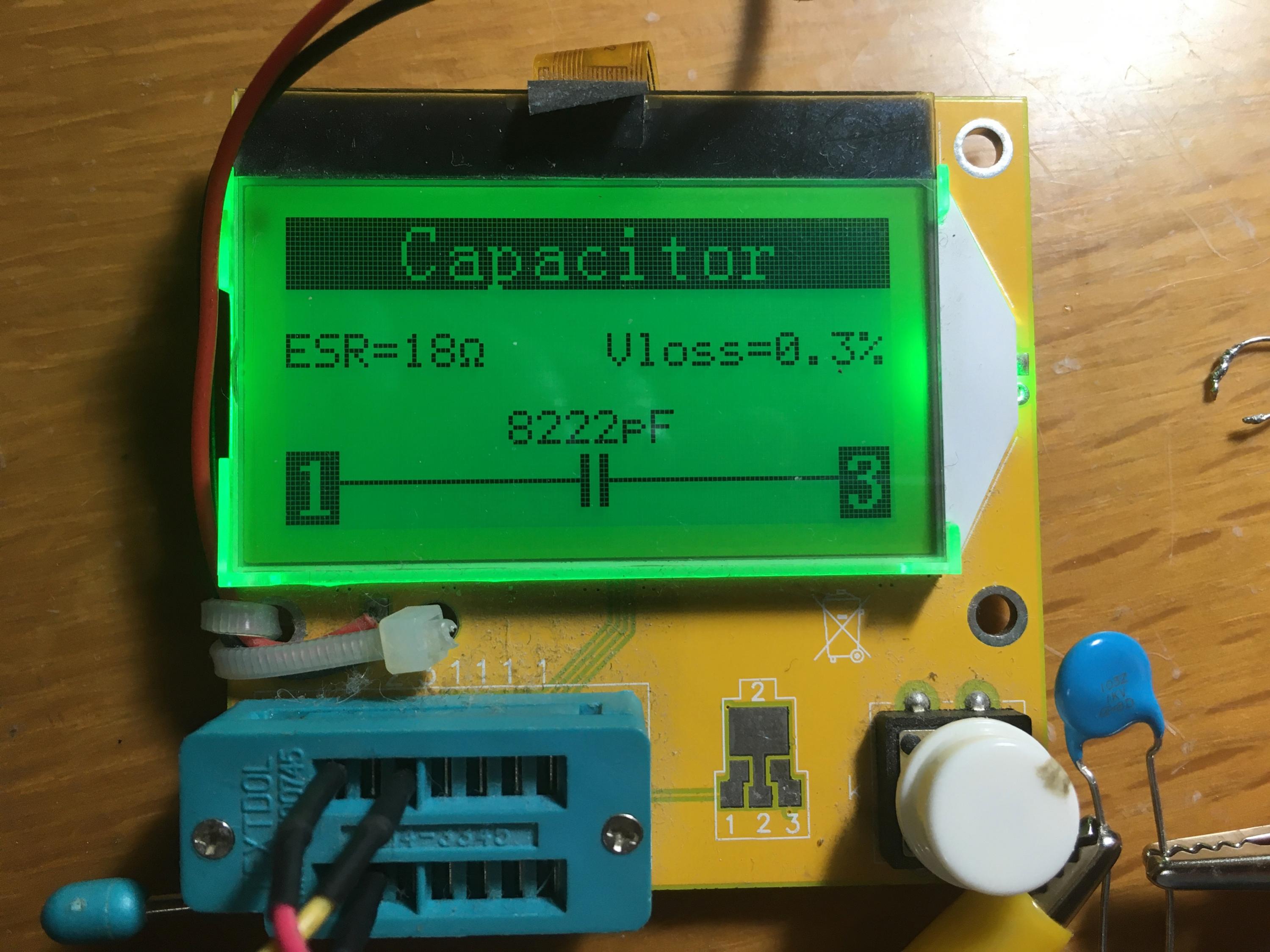

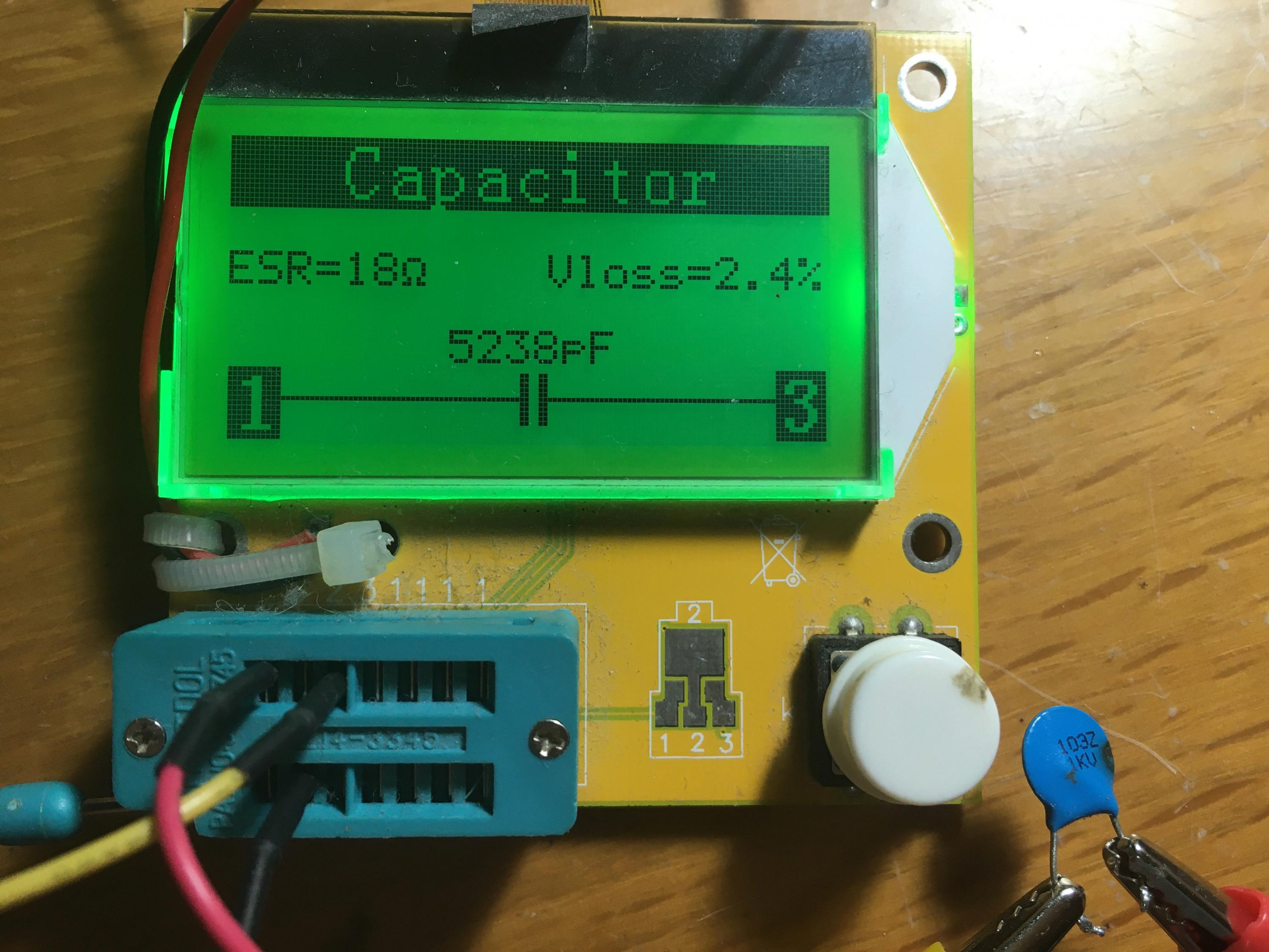

    I tested both, one of them seems to be fine although it has less capacitance compared to a new one. 5237pF instead of 8222pF

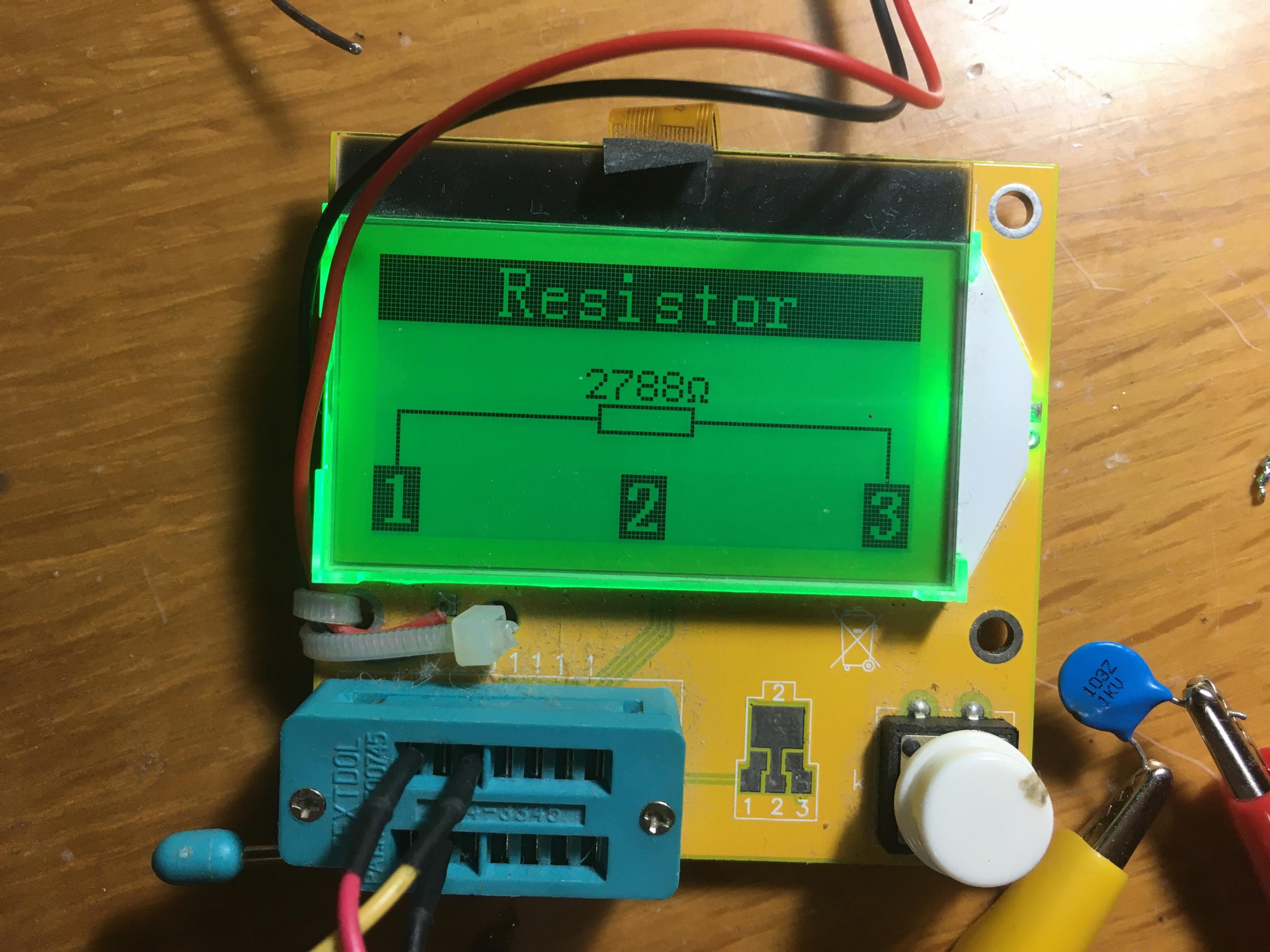

    The other was detected as a 2788 Ω resistor instead of a capacitor in my tester.
    I changed both.

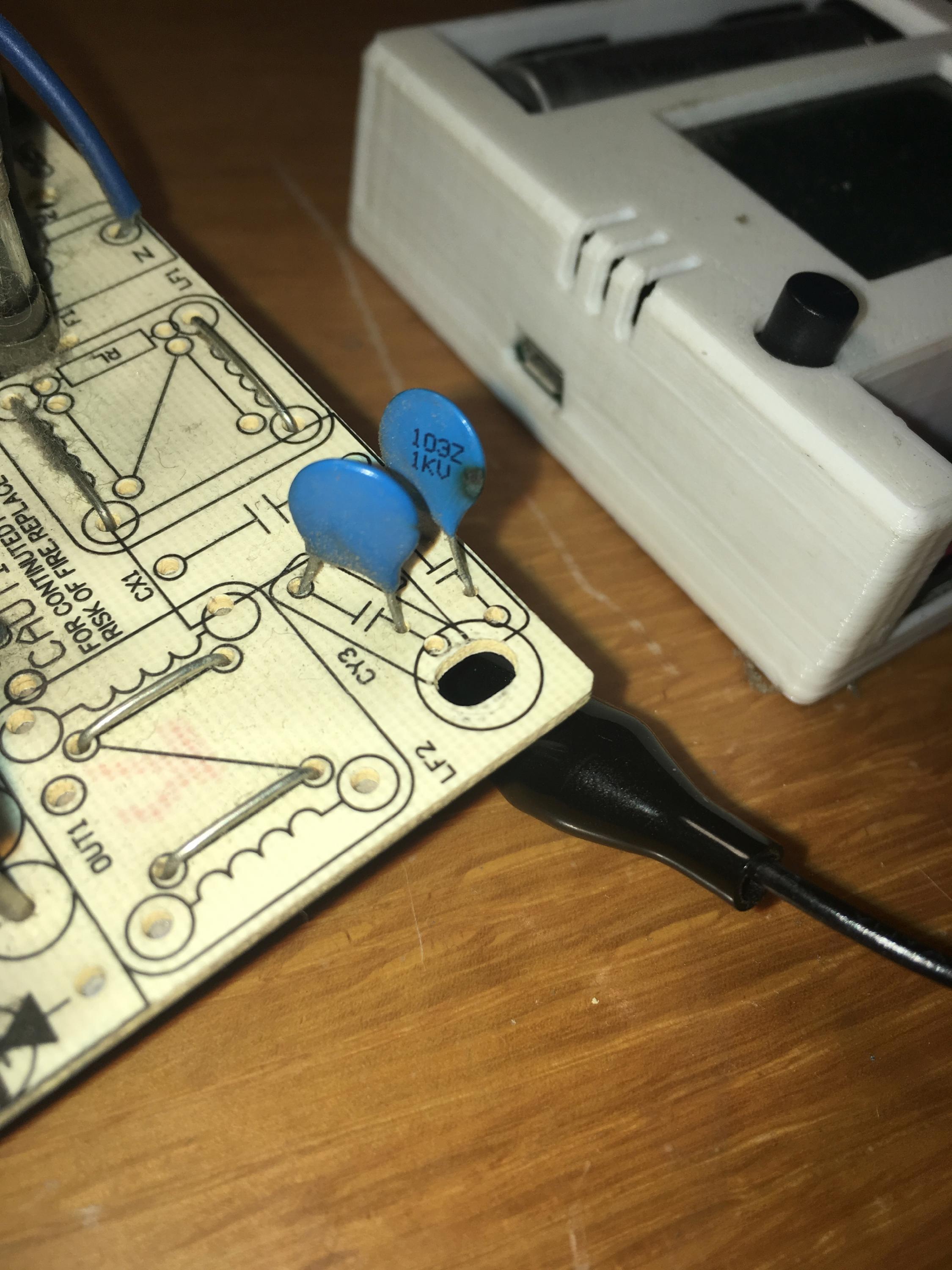

    This is a measurement of a new 103Z 1KV capacitor
    The power supply is now working properly. There is no more current drain to the earth.

    In the first photo it looks like it has a burnt spot on one side of it
      Yeah, they both had burnt spots

          This is why both Y and X capacitors needs to be safety rated:
          They are not allowed to have a failure mode that presents them as a short, only open...
          A genuine Y capacitor will have a large number of agency approval stamps.

            The one's I got to replace don't have any of that.
            They look like this:
            I will try to find and buy some with the approval stamps. Thanks for the info.
            They are not full short, just one of them was detected as a 2788 Ω resistor instead of a capacitor.

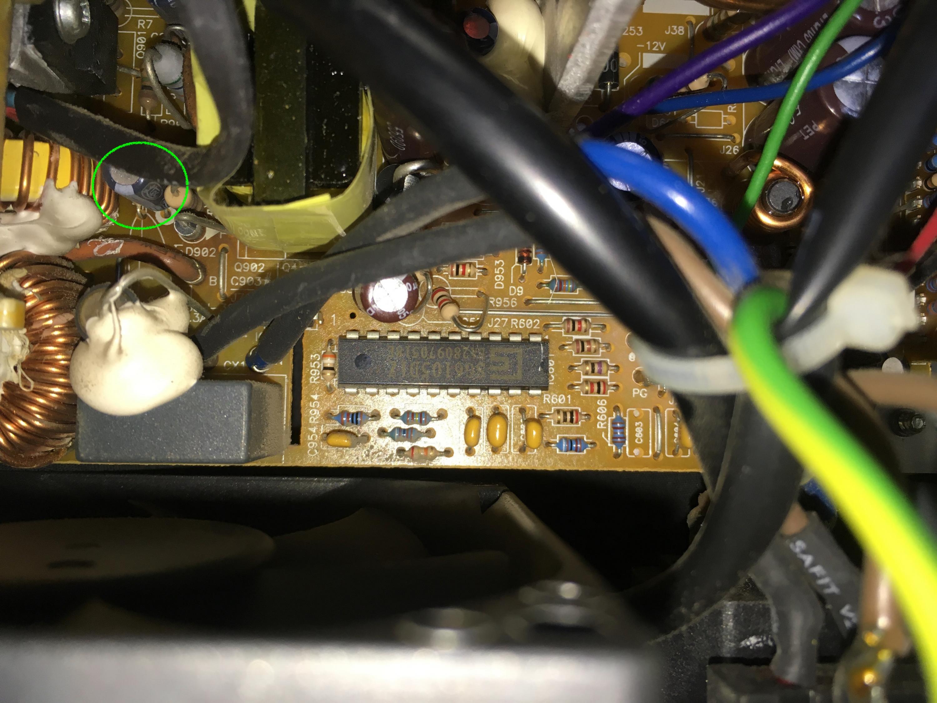

            Here's the photo of the power supply with the shorted safety capacitors:
              Re: LPK12-450W safety capacitor shorted
              How is the cap connected in the circuit?
              Those cap may be snubber cap not the safety cap.

                I don't know what a snubber cap is, they're connected like this, live and neutral to the ground.
                  OK, so they are supposed use the proper type of caps in that location but they did not.

                    The caps you replaced are .01uF, 1KVDC parts, not suited for used as Y Caps. For safety sake I strongly recommend/urge you to use safety agency rated Y caps. Further, I think .01uF Y caps would violate leakage current safety regulations. Probably the highest value you could use would be 4700pF.
                    Manufacturers of cheap junky power supplies often use generic DC caps instead of safety agency rated parts. I noticed that besides these unsafe cheap parts that the spaces where there should be common mode inductors there are jumper wires, another cheap-junk substitution.

                        About the caps, those were what I had here to test and if it stopped leaking current to earth while I get the identical or better ones with the agency approval stamps and capacitance. But they don't look so easy to find at the places I usually buy caps.
                        The original reads around 5336pF and have no agency approval stamps.
