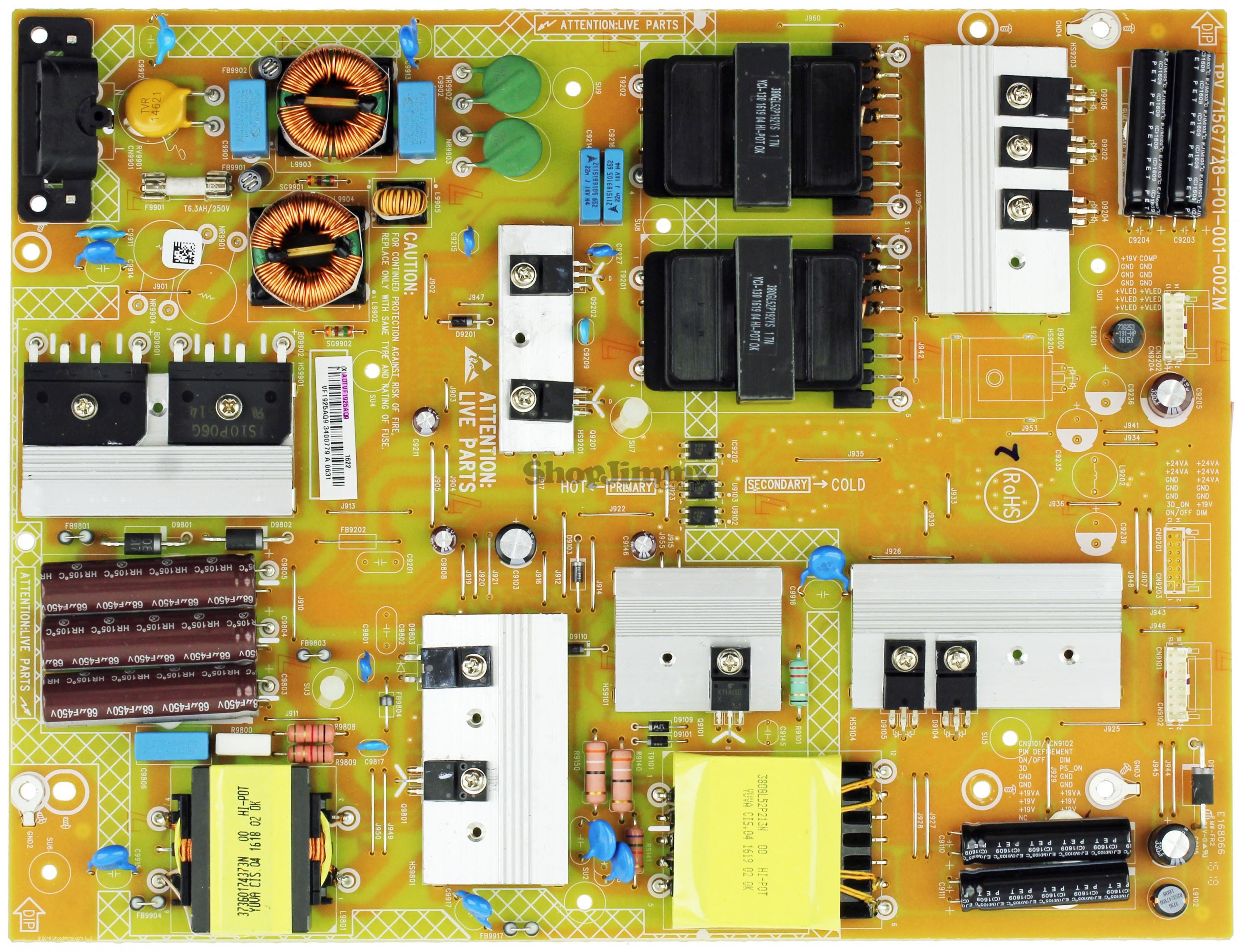

    Hello!
    New guy here, my name is George and I am currently stationed overseas in Germany. I have a Vizio TV (M50-D1) and I saw that on the back it is only rated for 120v but I was told by a few people here that sometimes they do that to cut costs even though it is capable of dual voltage.
    I tried contacting Vizio, they told me to contact vizparts, and they never replied. I contacted shopjimmy and they pointed me to you guys. Any education on how to know for future reference would be greatly appreciated!
    This is the board
    https://www.shopjimmy.com/vizio-adtv...ply-board.htm#

    look at the caps, top left corner.
    What are they rated for?
    Its possible that its 120VAC Only because they saved on the X and Y-Caps and used only 250VAC rated ones or even lower.
    For 230VAC you'd want 400VAC ones usually.

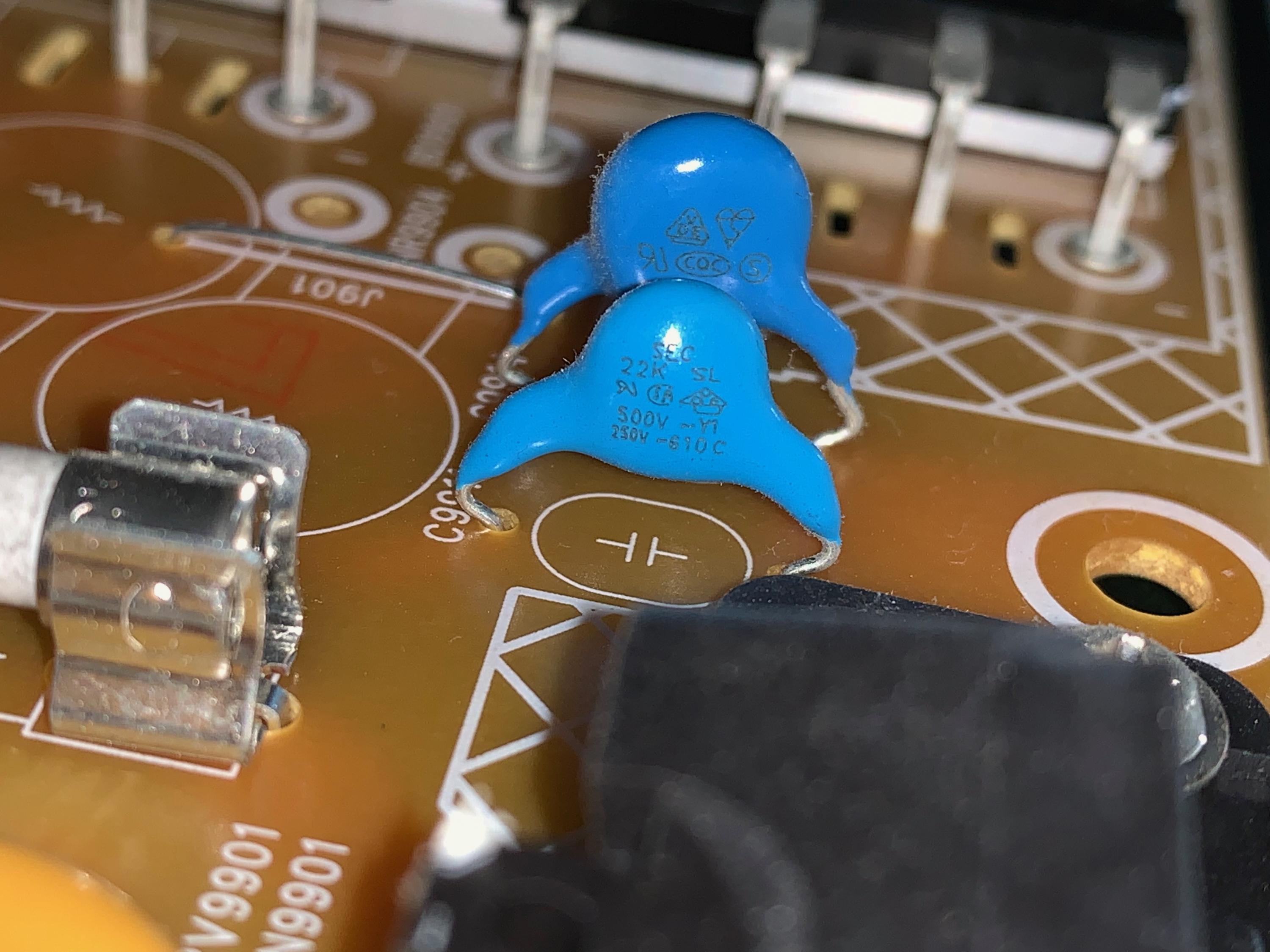

                      ok I looked at the blue ones, and this is what was on them It looks like they are good up to 500v?

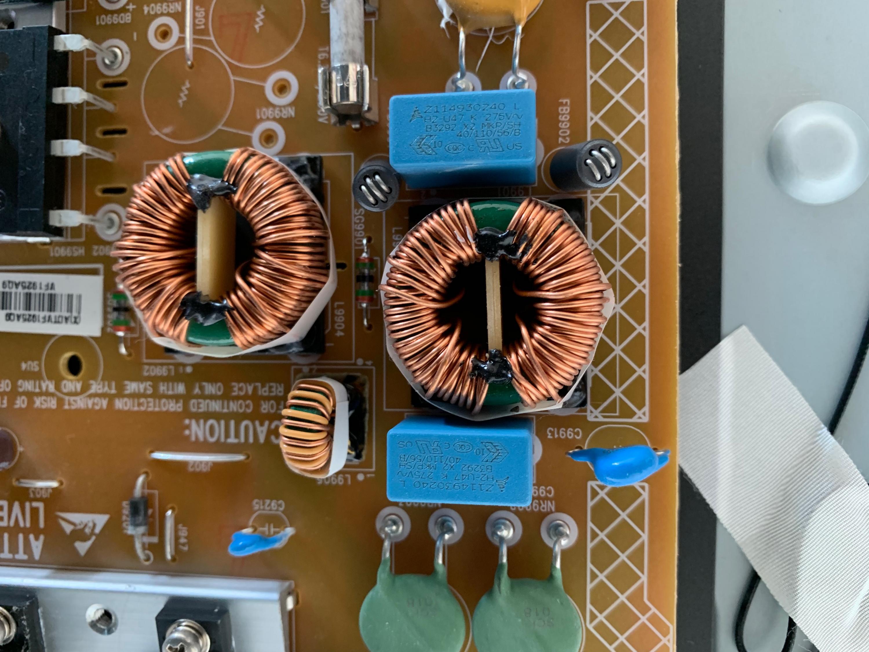

                        Re: Vizio M50-D1 power supply dual voltage?
                        here are the 9901,9902

                                This board has APFC with 450V primary capacitors so most probably its boosting the voltage to 380V. Very strange its not labeled as universal input.
                                        I can't fathom a way in which it would not be universal input.
                                        Because of the rating of the electrolytic capacitors at 450v you can be 100% sure it uses APFC boosting.
                                        Because those capacitors are allot more expensive vs what would be required if they did not boost, then it would only be necessary with 200v rated parts at a fraction of the price.
                                        The board is cheap anyway so fire it up at 230v and see what happens, but without having the LCD connected to it.
                                        The board is cheaper than a autotransformer on shopjimmy anyway
