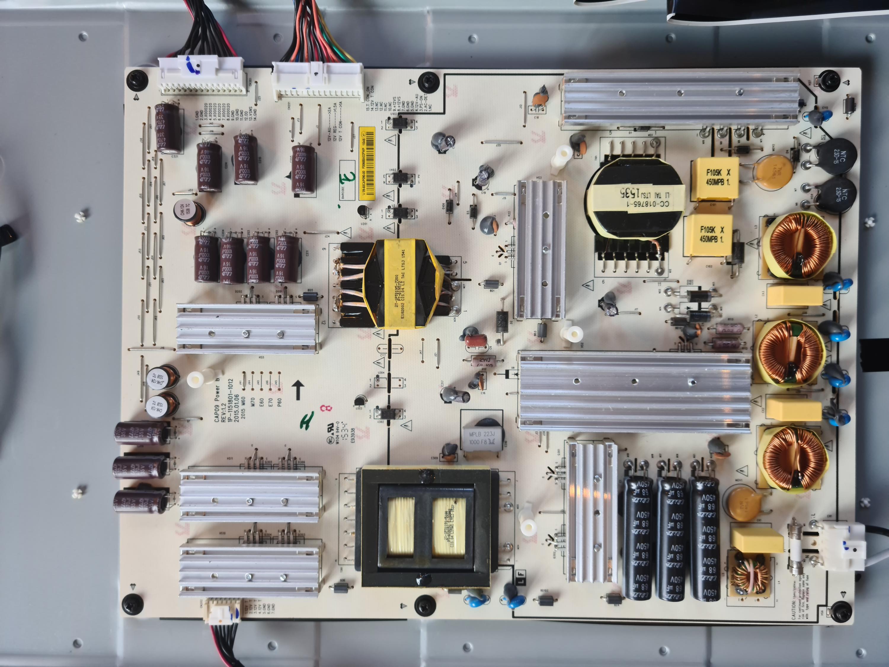

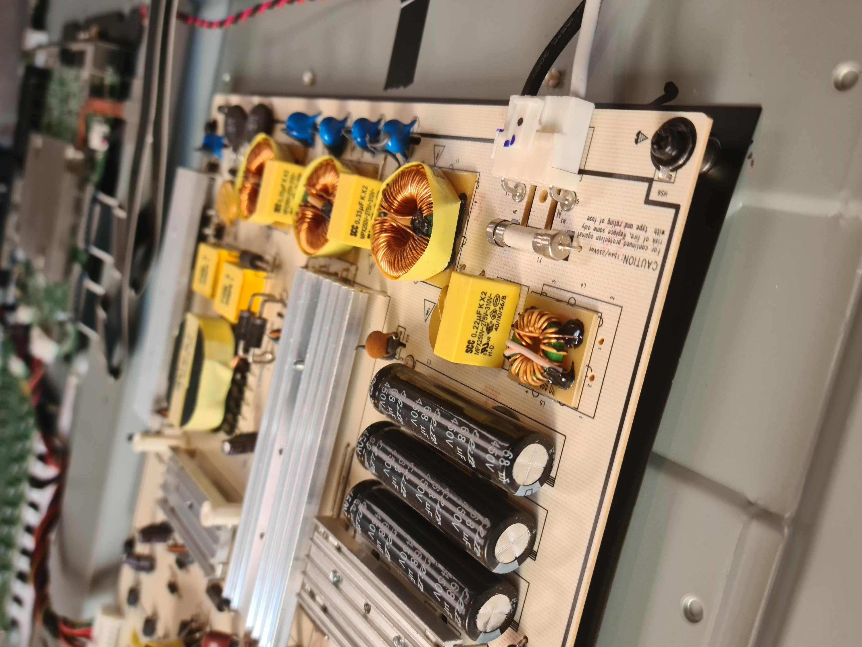

        GeorgeGadgets... Did you use a transformer or plug in with just an adapter? I'm in the same boat... Opened up the tv backing, and the board on my little vizio was clear about 110v - 240v rating, but my big vizio power board doesn't specifically list any input ranges.
        To the gurus... Image of power board is attached. Is this 220V compatible?

          Re: Vizio M50-D1 power supply dual voltage?
          Is there a sticker with the input voltage rating on the back of the tv?
            it looks like it would take it - atleast from the caps and movs
