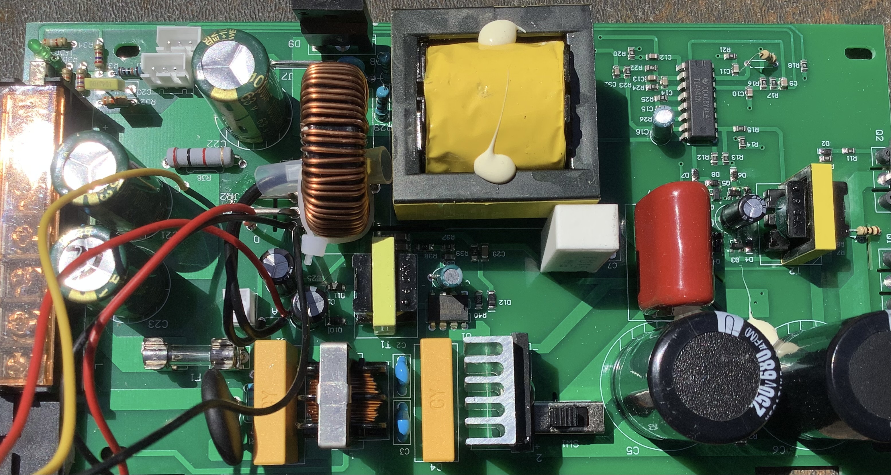

    I have been pondering this question for a while but now I have see if this doable but I need to answer this question once and for all
    I would like to know how to safely do this undertaking my first thought is to solder wires to the main filtering capacitors and see
    what voltage I am getting and seeing if I can build a battery pack with voltage or not and if
    I can find a BMS balancing protection board at this voltage level and weather or not do I have use more than one BMS balancing protection board

    This appears to be one of those voltage doubler input stage PSUs so likely you'll need at least 190V or so DC to get this thing started (set to 220V operation). At 160VDC or lower it will likely not work right.
        Is a 200 volt battery pack doable and if so how would you go about changing it yes a this voltage would be a little bit dangerous to play around with because the highest MPPT controller voltage I have seen so far is 160 volts is there any that go higher voltage than the ones that I have seen so far

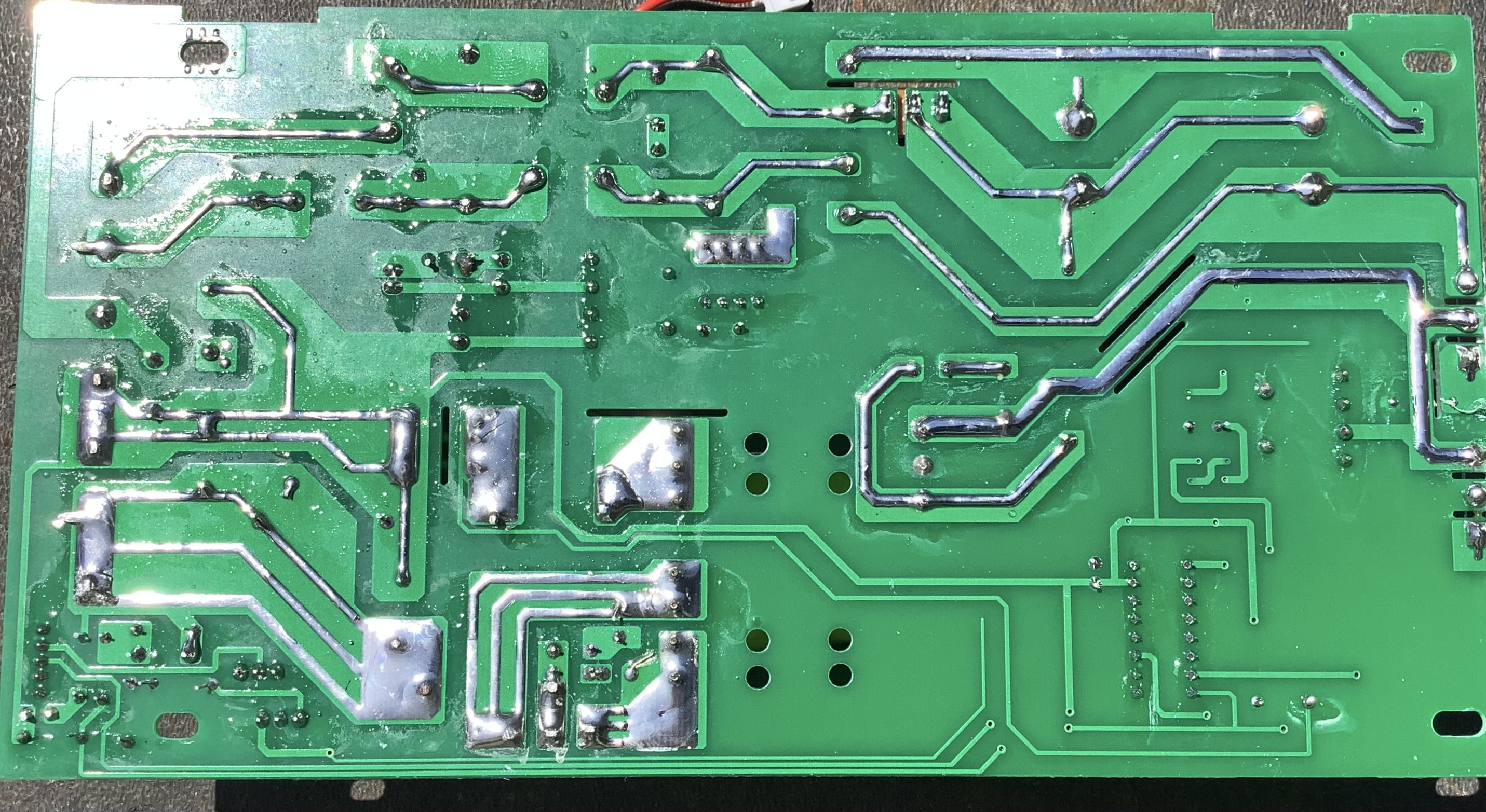

            Hooray it's one of those TL494 designs... i.e. old slower design, I'm surprised it would stay stable at 1V looking at the parts here...

              You'll have to build your own BMS as probably most BMS won't handle such high voltages. And I don't understand how you're integrating mppt into this, this is completely different, you have to get a fairly stable power input and not depend on sunlight.
              Another way to help make things easier is to design your own APFC and get rid of the input stage.

                    I don't think the transformer on that board can pass 500W or at least it seems a bit small IMHO. Then again it doesn't need to have as many windings as an ATX PSU.
                    And effectively building an APFC is building a wide input range boost mode 300V PSU. These can now deal with lower battery voltage input.
