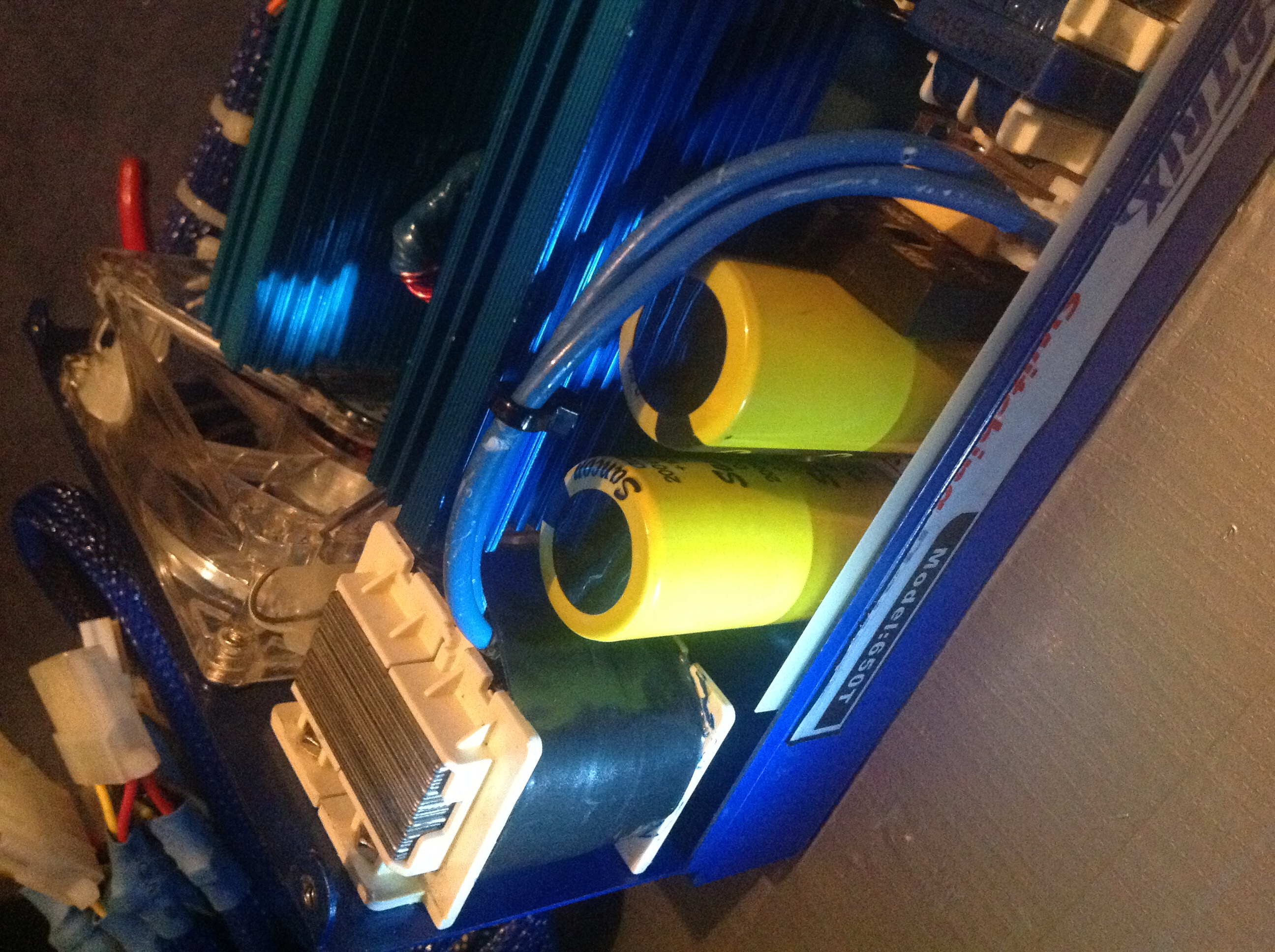

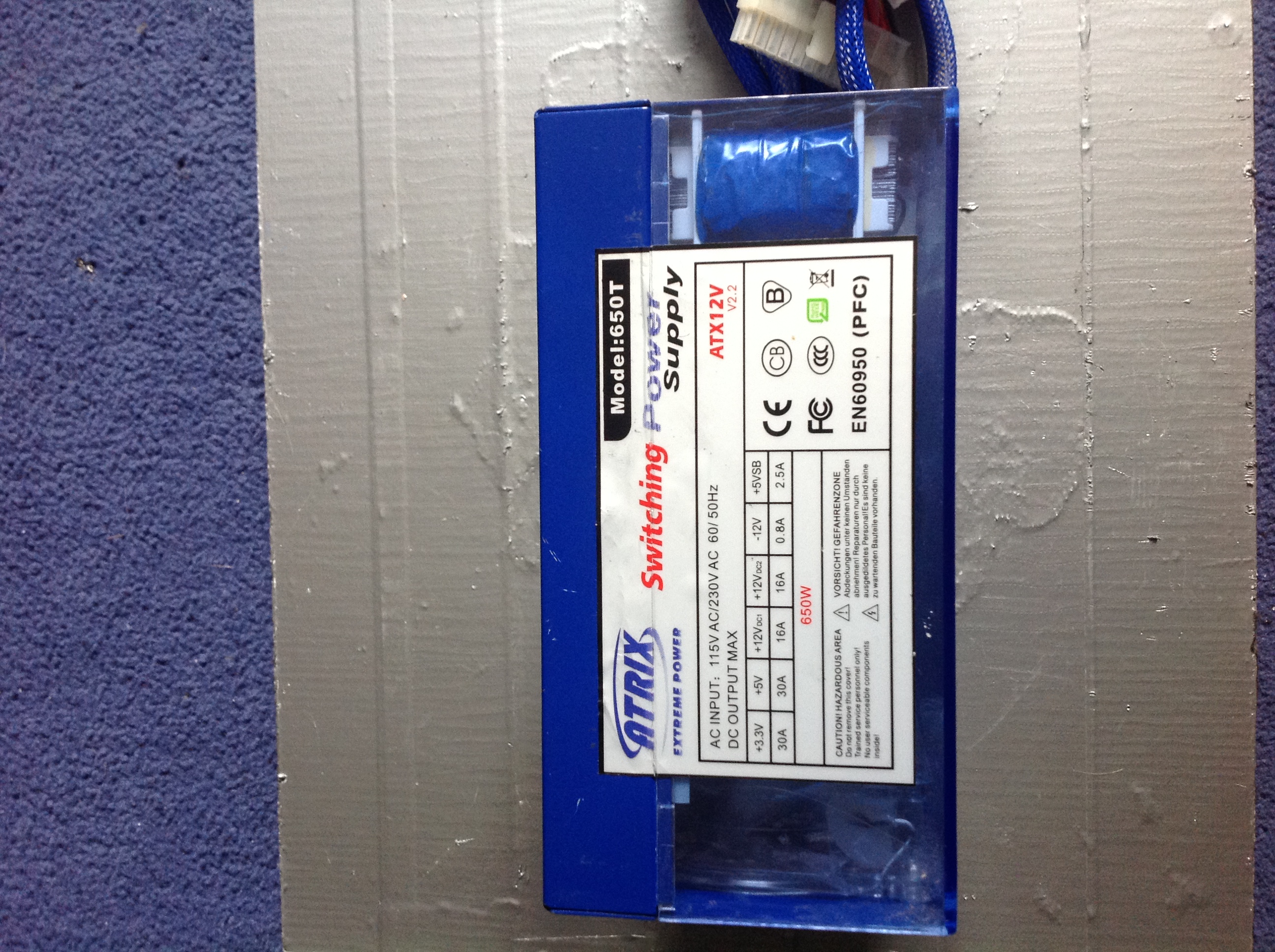

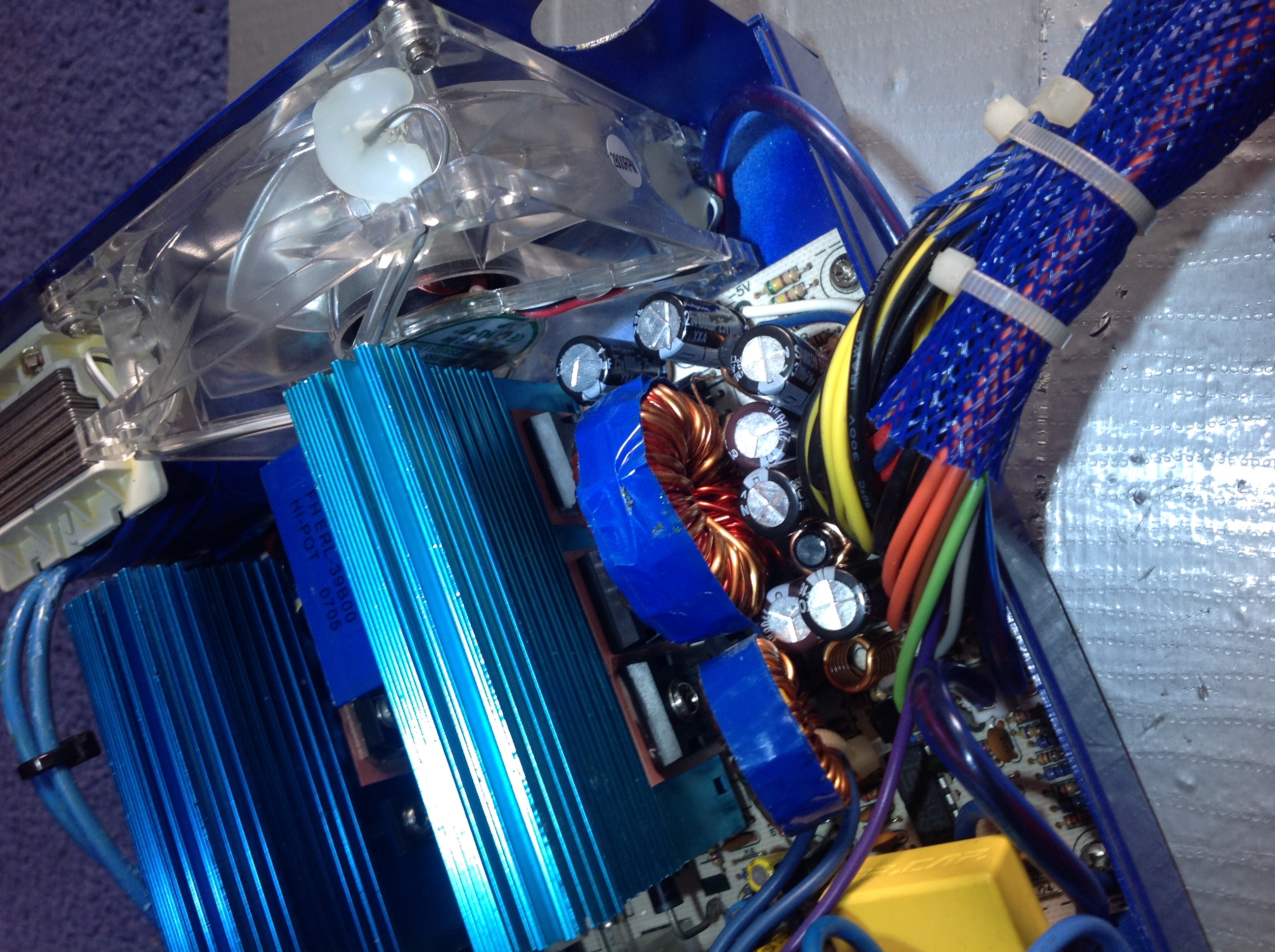

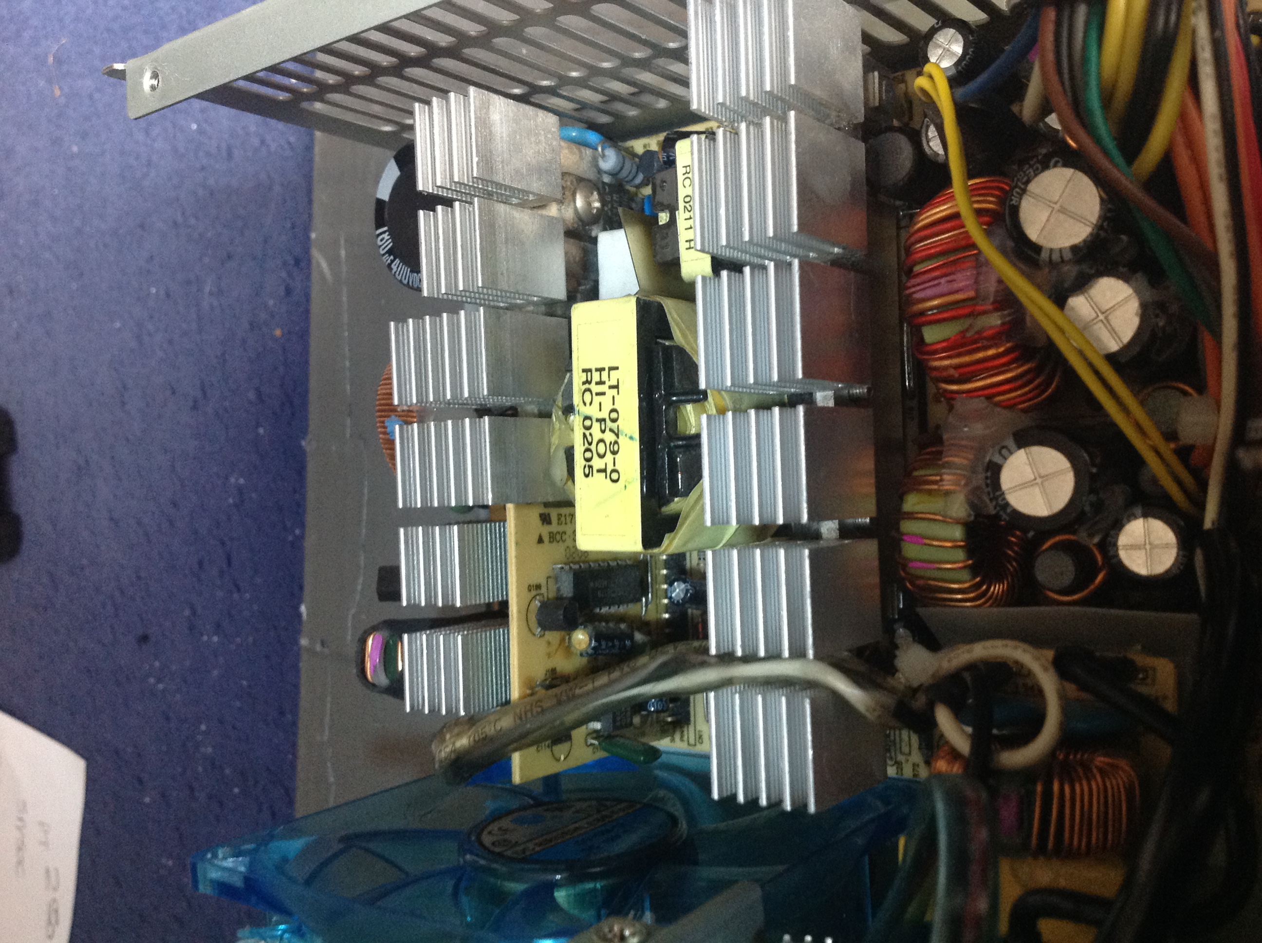

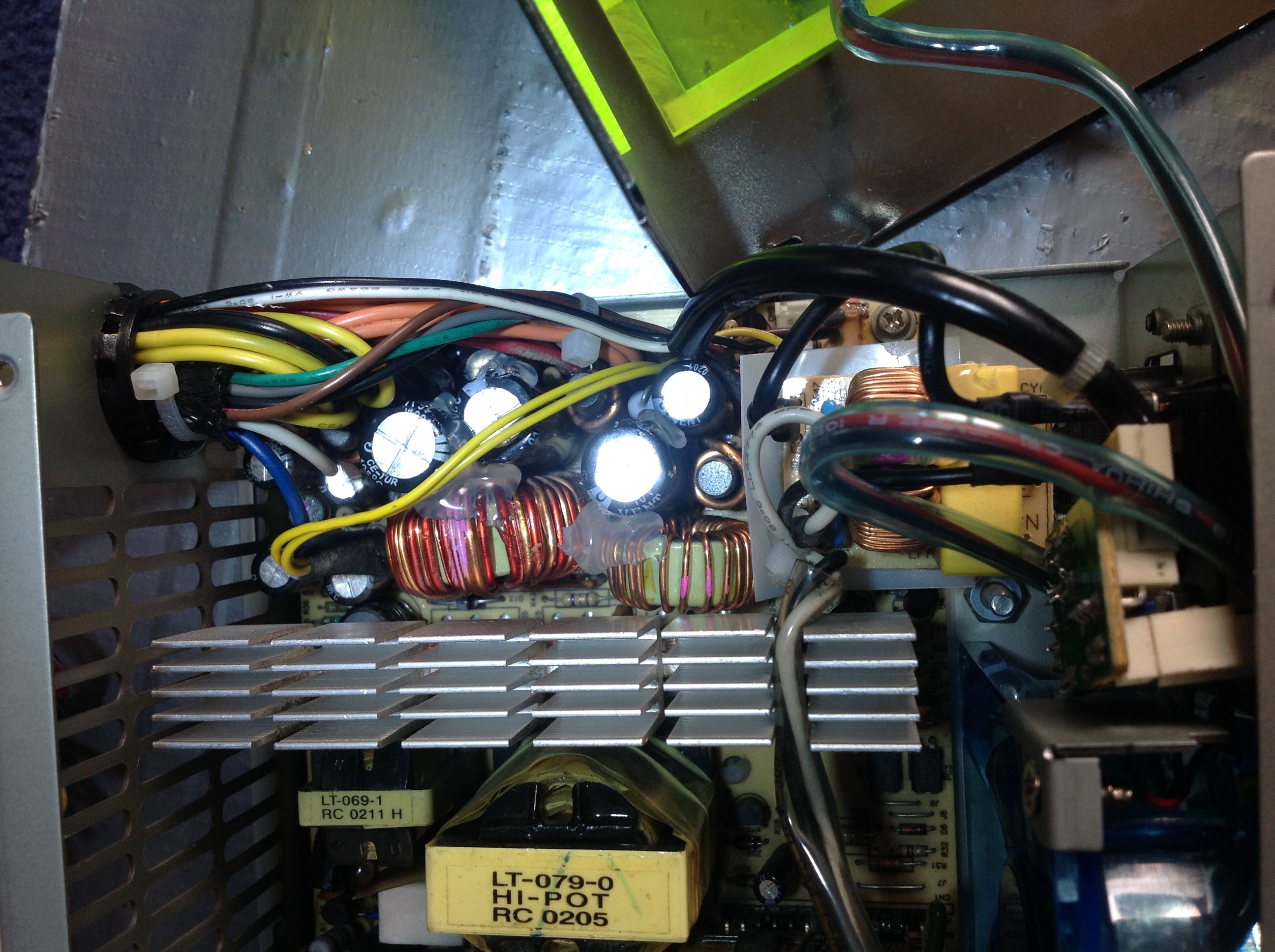

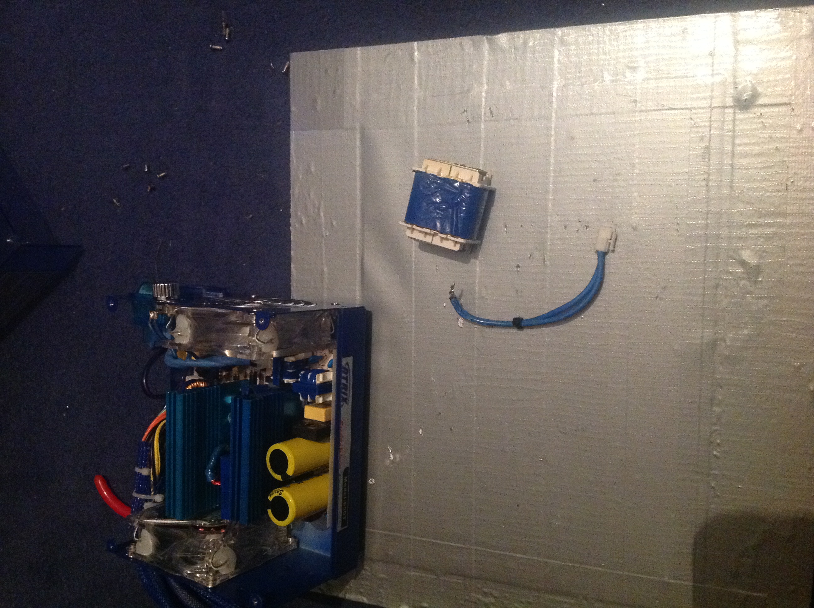

    This is the atrix 650t, 650w rated psu of course it isn't 650w I know their game with this one make the user think that the psu is good by its looks and put them off the quality of the internal psu board, it can do around 400w on a good day. It has a clear Polly acrylic case with two 80mm led fans that can be controlled by the potentiometer at the back, its of an ok quality I recapped it due it having sancon outputs causing bad ripple, Im sure I will find some use for it in a low end rig some day.
    Specifications listed:
    2* 13009 primary transistors
    5vsb transistor 5h01605r with a 1000uf rubycon and a 330uf sc capacitors for the filtering
    Passive pfc
    Bridge rectifier kbu 804g
    output rectifiers:
    3.3v sbl3040pt
    5v sbl3040pt
    12v sf2004pt
    Output capacitors:
    3.3v 1*2200uf 16v ucc kze 1*3300uf 10v samxon rs
    5v 1*2200uf 16v ucc kze 1*3300uf 10v samxon rs
    12v 1* 3300uf 16v samxon rs
    -12v 1000uf rubycon yxg
    -5v 1000uf rubycon yxg
    1000uf 200v sancon primary units
    Let me know what you think.
    • Behemot
      • 4845
      • CZ
      #2042
      It should be good for 500+ watts as long as you replace the +12V rectifier with some 30A one and if there is spot on the other side of the heatsink, with two in parallel. Than you should be able to draw those 32 A from the rail. It may require some load on +3,3/+5 V, it is still +5 V heavier topology.

        #2043
        Thanks for the reply, what rectifier would you recommend for the +12v I can add another 3040pt for the +5v
        • Behemot
          • 4845
          • CZ
          #2044
          Apart from 30+ A, than 60 V or more. I would not recommend adding anything to +5 V, it will be high enough already when you selectively load the +12 V rail.
          • 370forlife
            Large Marge
            • Aug 2008
            • 3112
            #2045
            Old YoungYear design. The primary switchers will probably blow before anything else at around 400W.

              Is that a fake PFC? Are those just sheets of metal?
                  I think its all genuine, I will check it later.

                      What Behemot means by this is that you need a rectifier with at least 60V peak reverse voltage. The one you have in mind most likely only has 40V. Interestingly enough, I have an Atrix power supply sitting on my bench (But it's made by Unitek Technologies) and the 12V rectifier on that PSU only has 45V peak reverse voltage. I'd still use one rated for 60V or more on that one, as that's what they used originally. As it is, that unit could already output quite a bit of 12V power for a decent system. Nice recap job!
                      It's probably fake. My Atrix (Although a different OEM) Had a very similar looking PPFC inductor with a loop-back wire, and very light sheet metal.

                      It could do more than 400W safely if you have some 2SC3320's lying around.

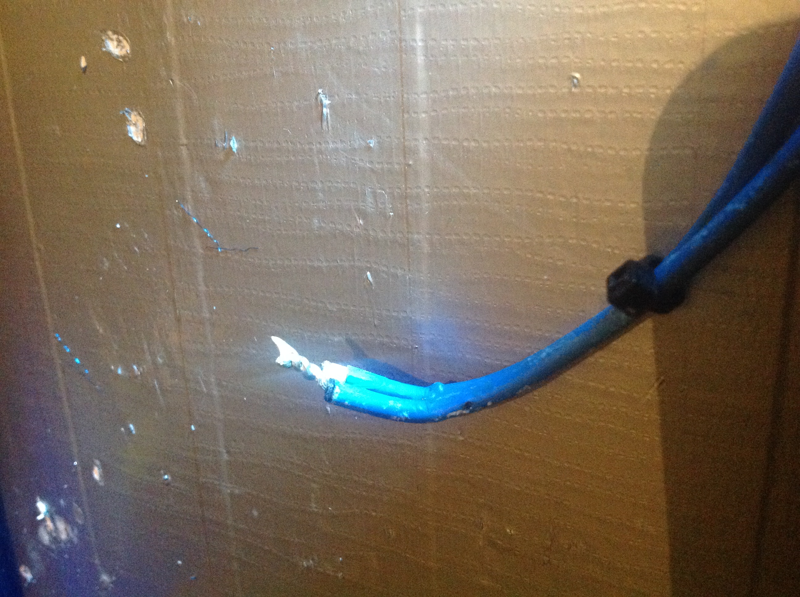

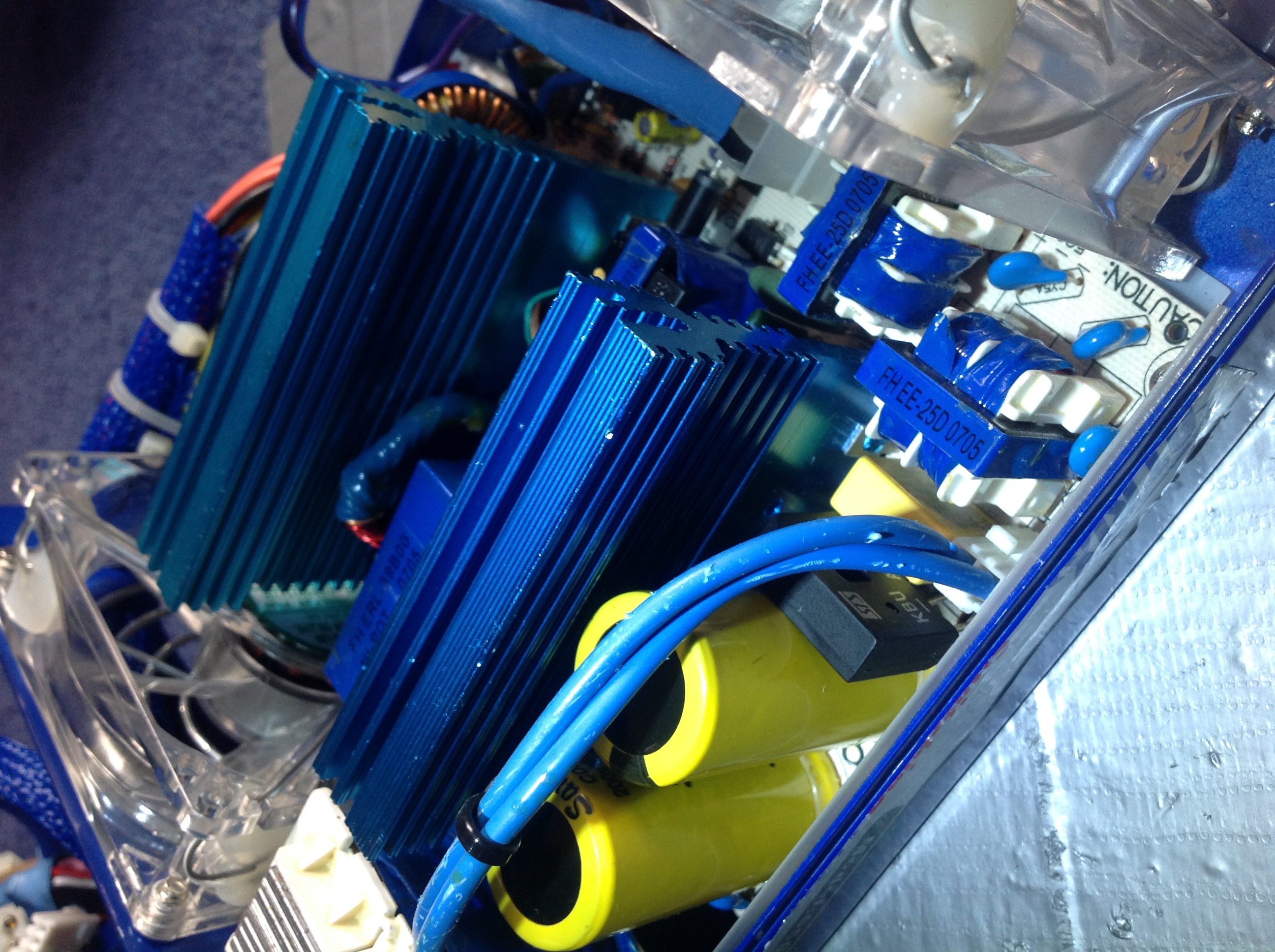

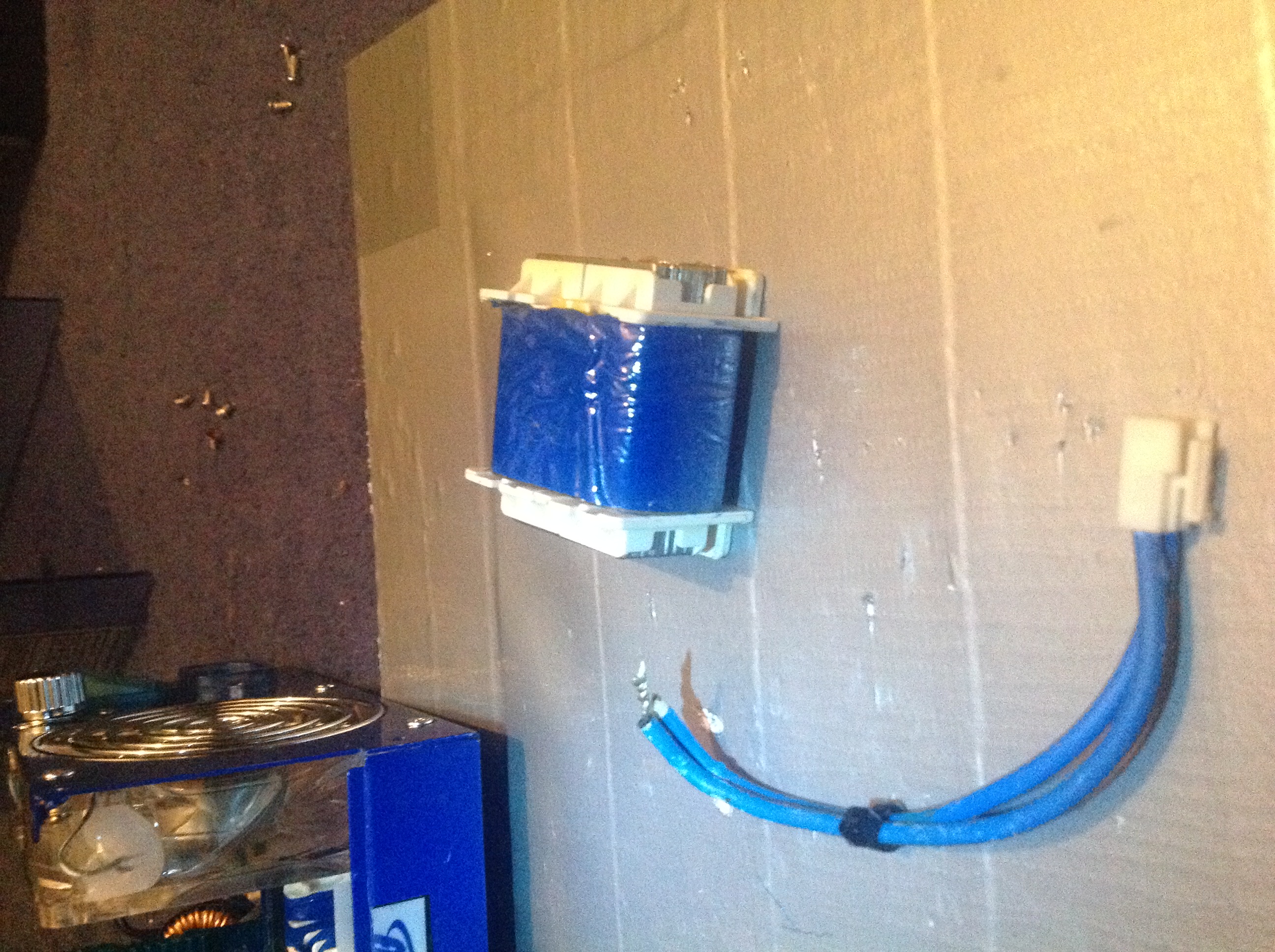

                          Well bad cappers you predicted correctley that pfc coil is fake, I tested it with my meter and got 1ohm then ripped off some tape and card and lone behold the wires are just jumpered.
                          • ReeceyBurger123
                            Never Give Up !
                            • May 2014
                            • 7325
                            • Britain
                            #2053
                            Here you have it the fake pfc coil such a shame as things were looking up for this psu, I have no idea why they even added this because it barley adds any weight to the psu I guess its just there to fool the user and fill in that corner gap, apart form that all it consists of is small aluminium sheets, plastic and a wire tapped to it.
                            Few images showing the fake pfc, I put it back together with electrical tape because its used as a jumper and I the psu wont start if that "pfc" point isn't jumpered, and the psu powered on.

                                • Behemot
                                  • 4845
                                  • CZ
                                  #2056
                                  You can use genuine coil from another ditched PSU.

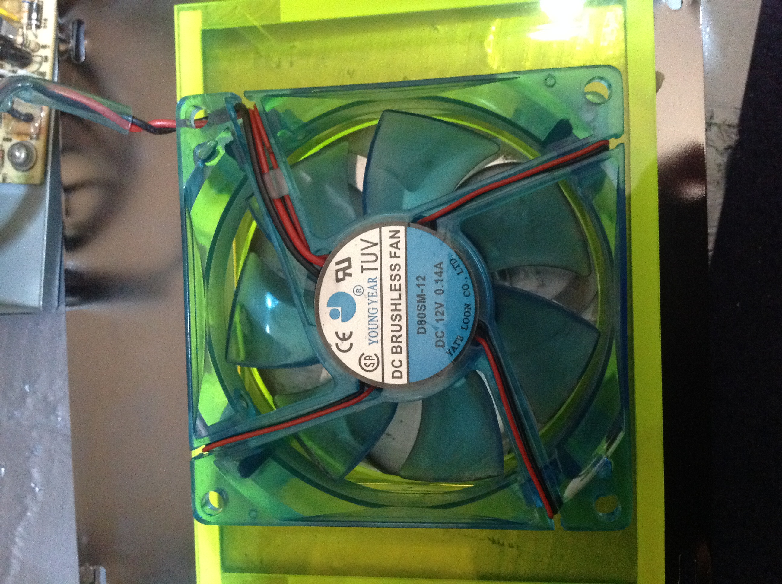

                                      Well im currently recapping that 250w fsp and removing the glue that has corroded everything, I took a break and opened this mystery psu that I brought off ebay for 99p, it has the top case of an ultra xconnect psu but the rest of it is a very nice 300w endermax I could tell this because I just used one in a pc build that I sold, the internal psu board is nice as it has all the needed components capable of 300w I will solder in a 24pin atx and sata connector when I recap this thing but apart from that its aesthetically pleasing and should be a good psu
                                      2*blue led yate loon fans from a youngyear psu that are controlled by a potentiometer at the back
                                      Active pfc
                                      Bridge rectifier bgkbl08
                                      I couldnt see the primary transistors
                                      Ic controlled 5vsb
                                      Transformers decently sized
                                      Output rectifiers:
                                      3.3v s40sc4m
                                      5v s40sc4m
                                      12v s3040pt
                                      Output capacitors:
                                      3.3v 1*3300uf 10v pcetur 1*2200uf 10v pce tur
                                      5v 1*3300uf 10v pcetur 1*2200uf 10v pce tur
                                      12v 1* 3300uf 16v pce tur
                                      -5v 1* 1000uf 16v pce tur 1* 470uf 16v pce tur
                                      -12v 1* 1000uf 16v pce tur 1* 470uf 16v pce tur
                                      Primary unit 180uf 400v hitiachi hp3
                                      Let me know what you think 300w definite ?
                                      • Behemot
                                        • 4845
                                        • CZ
                                        #2059
                                        It is strange but I don't see 300 W a problem.
