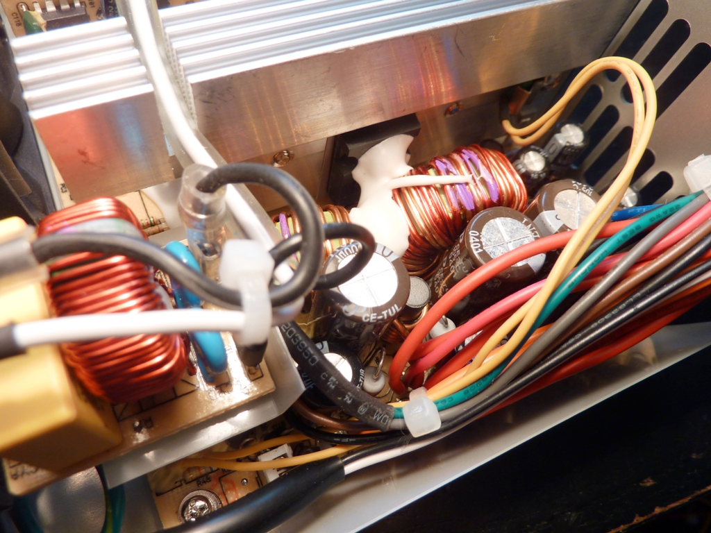

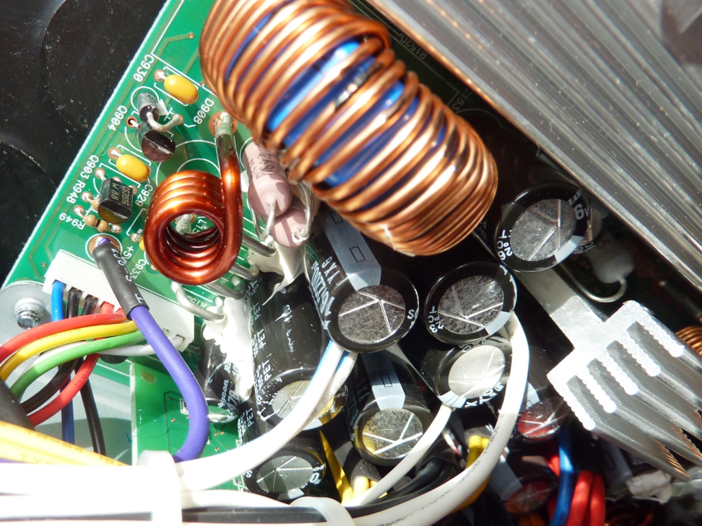

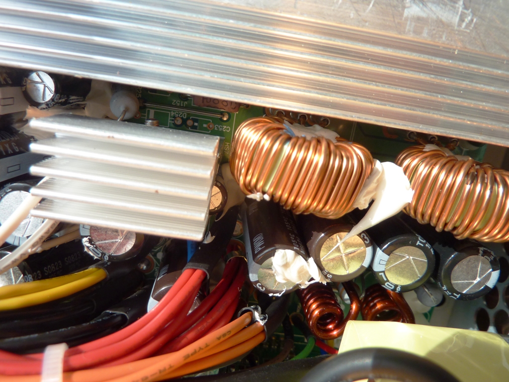

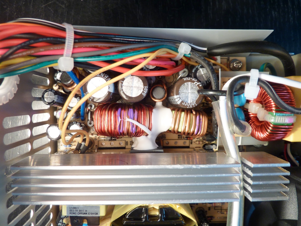

          I opened one of my old Enermax PSUs today, an
          EG365AX-VD
          made in 2004.
          It was working in a system that operated in a very clean environment so dust has never been an issue for this PSU.
          It has been runniung for several years so I was wondering abóut the condition of the components.
          Have a look at the pictures. I think this Enermax was built quite well and tidy. (Active PFC wasn´t a must in 2004.)
          There´s even a Hitachi HP3 in the primary section and the filtercaps in the secondary section are all "JP CE-TUL", a brand / type often to be foung in Enermax PSUs but I never found a bulged or defective one.
          I remember Enermax had a good name back in those days and this PSU seems to be a credit to the species.
            • 31259
            #1905
            that's a quality design!
            i love the way they even sleeve that wire & run it through the sinks instead of just jamming it down the edge!!
            a friend has an old "Enermax Bue", i wonder if it's that good inside?
            • Majestyk
              • Nov 2013
              • 96
              #1906
              I love the classic layout with just one reasonably regulated 80mm fan, ceramic standoffs for components that get hot and proper extruded alloy fins instead of simple cut and bent plates.
              Look at the tricky fixation for the little sub-pcb that has a notch fitting right between two fins.

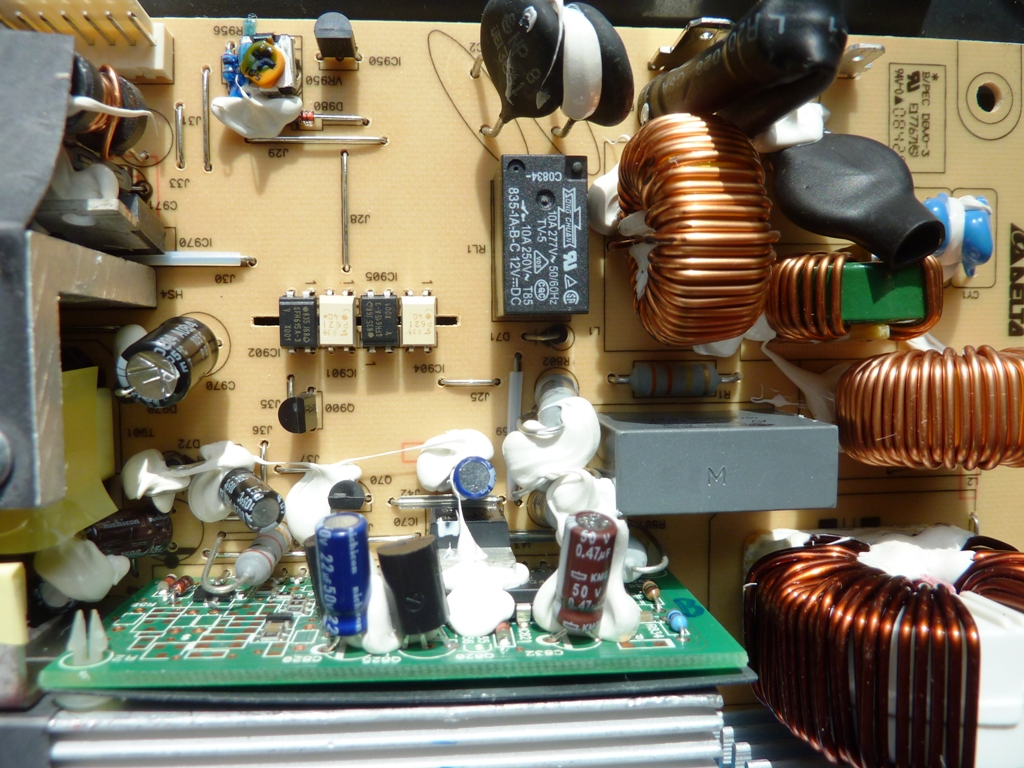

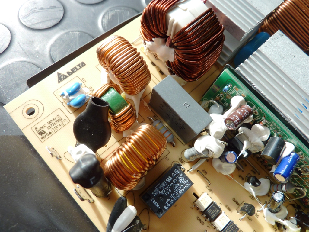

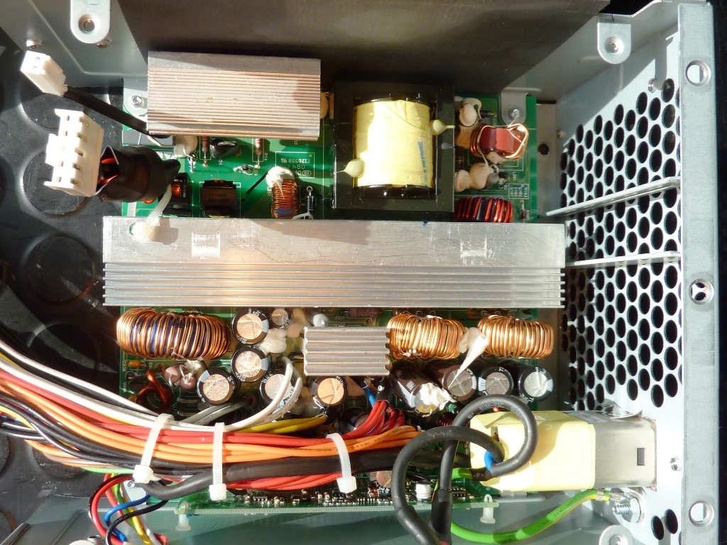

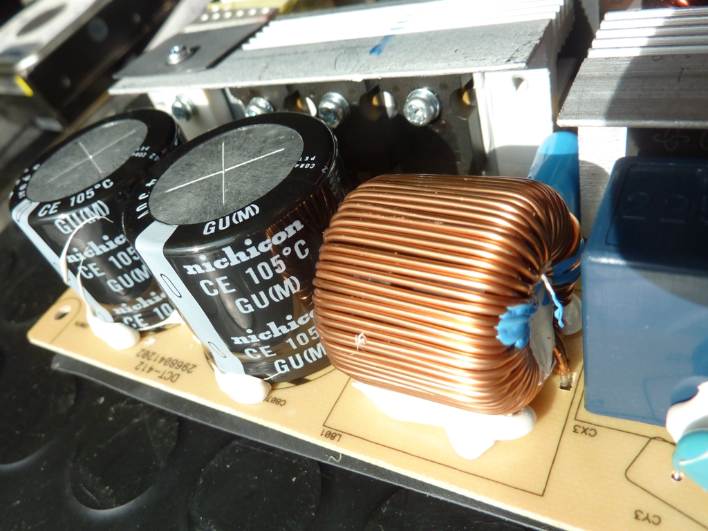

                            Speaking of build quality...
                            I opened a Delta Server PSU today, that is a couple of years old but still unused. It is constructed as a sandwich with one board at the top and another at the bottom. The air for cooling passes right through the middle.
                            As you would expect from Delta, the components are of excellent quality and only Tier1 suppliers! Strictly Nichicon and Rubycon capacitors, heavy alloy cooling blocks, loads of coils and toroids, a proper shielded filter for the mains connection... See for yourselves and imagine a world where all PSUs are built this way:

                              As Mrs. S in CA would call it, that really is beautiful power supply "porn". Looks like late 2008 build.
