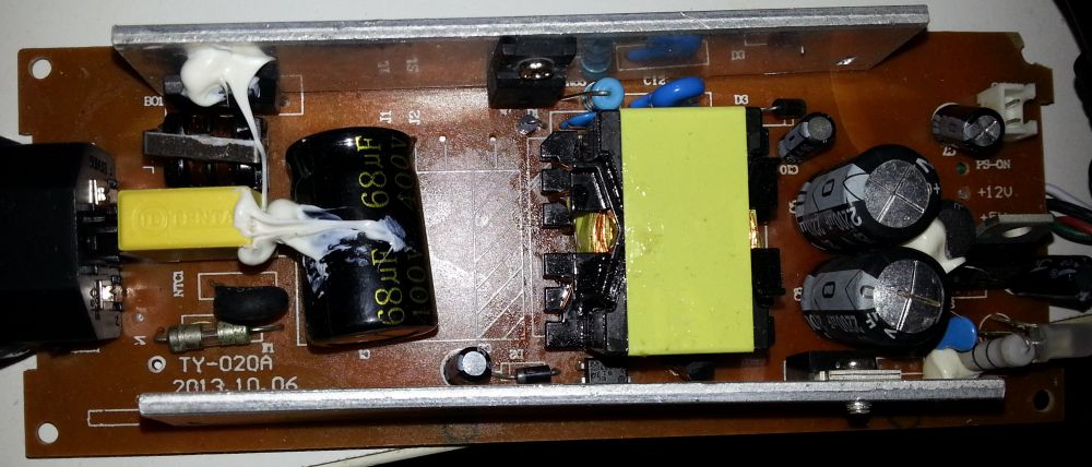

                          Two third-party Xbox 360S power supply units:
                          XP-360
                          150uF 400V Taicon AQ primary unit.
                          2200uF 25V ChongX before and after skimpy +12V inductor with 470uF 25V JWCO after +12V MOSFET switch.
                          470uF 25V JWCO after +5V regulator.
                          All other electrolytics are JWCO brand.
                          MBFR20100 x2 rectifiers for +12V.
                          WFF10N60 primary switcher.
                          KPL410 primary rectifier.
                          EMI filter choke has been omitted bridged out.
                          XP-360L
                          68uF 400V ChongX primary unit.
                          2200uF 25V FMZ (both bulging) before and after skimpy +12V inductor with 220uF 25V ZHC after +12V MOSFET switch.
                          220uF 25V ZHC after +5V regulator.
                          MBFR20100 rectifier for +12V.
                          18NM60N primary switcher.
                          KBP307 primary rectifier.

                            #2013
                            XP-360
                            XP-360L
                            The XP-360L actually looks less cheap. Looks like the caps are the only big issue.
                            (The transformer on the left-hand one looks real cheap!)

                              #2014
                              One big advantage of these cheap units is they are SIMPLE. They are just like the small wall chargers, just with bigger transformer and silicon, but build exactly same way. In 90 % cases only caps go bad, than you change them for japanese and you are done for next decade. Sometimes rectifier or transistor, but that's all.
                              Higher quality units may have slightly better efficiency, may have slightly lower ripple, may have somewhat more precise voltage control, but that is achieved by incredible field of dozens SMD components and complex feedback circuitry. Thus they are more expensive and when go bad, you are usually finished. Especially the modern flat units which have more glue than air inside, you cannot do anything inside even if you wanted.

                                #2015
                                Originally posted by goodpsusearch
                                I have many Linkworlds, one of them makes whining sound. It's from 5vsb circuit and I think it's because I used Panasonic FM for critical 5vsb cap.
                                And you think that yours is oscillating?
                                Obviously it's under-designed. It hasn't even been a year, and look how discolored the PCB is, and caps failed already.

                                  #2016
                                  I wouldn't be too worried about that, it just looks like they used really old and cheap SRBP board, which starts out dark brown to begin with.

                                        #2019
                                        I was talking about the wires on the transformer for the one on the left.
                                        (transformer wires sticking out)

                                          #2020
                                          Correction: XP-360L should be XB-360L.
