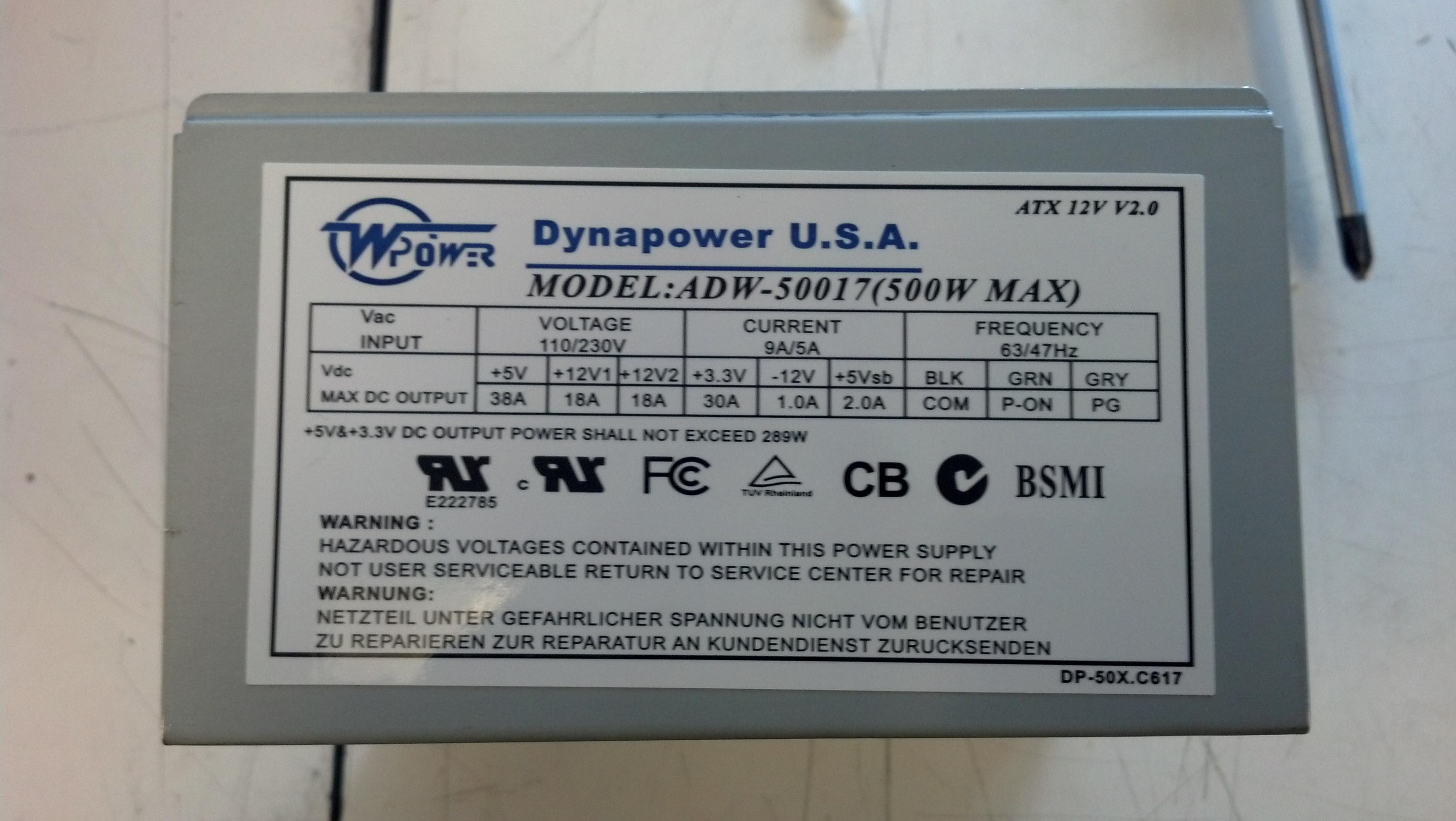

                                        Got a Dynapower here. Doesn't look too bad minus the crappy Teapo and Fuhjyyu. It's got 2 MOV's between the two big caps. Two 2SC3320 switchers, 8A bridge, 30A on 3.3V & 5V. Two 20A schottky in parallel for 12V. Good size transformer...Nice heatsinks. It fried a motherboard cause the caps went bad on the 2 transistor standby circuit. Is it actually made by Dynapower? Cause it looks CWT-esque judging by the label and the green transformers
                                          The UL number traces to "POWER TECH INDUSTRIAL CO LTD"
