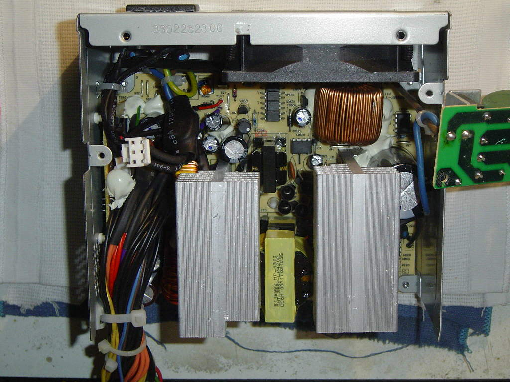

    but, i see a bridge rectifier in place of 4 diodes. not bad. heatsinks ok, looks fixable. but who in the hell would buy something with that name? sorry, but that name sounds a bit.... uh... girly...
    sigpic
    (Insert witty quote here)
    • 370forlife
      Large Marge
      • Aug 2008
      • 3112
      #102
      Sold in the US as kingwin.
      Actually pretty good now, just the soldering needs work.

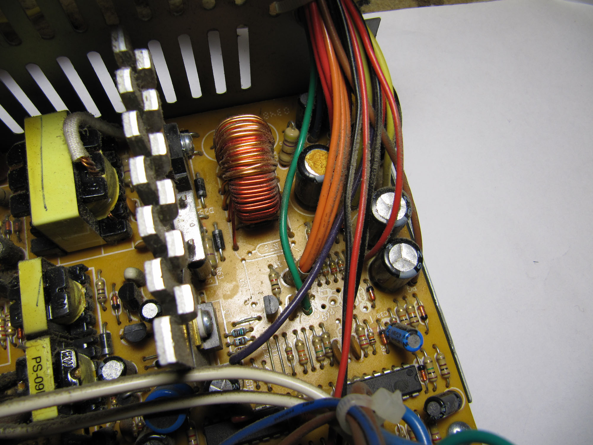

            Today a friend gave me a psu, asking me if I can examine it and find out why it stopped powering on his pentium 3 800mhz system.
            I uploaded some photos...

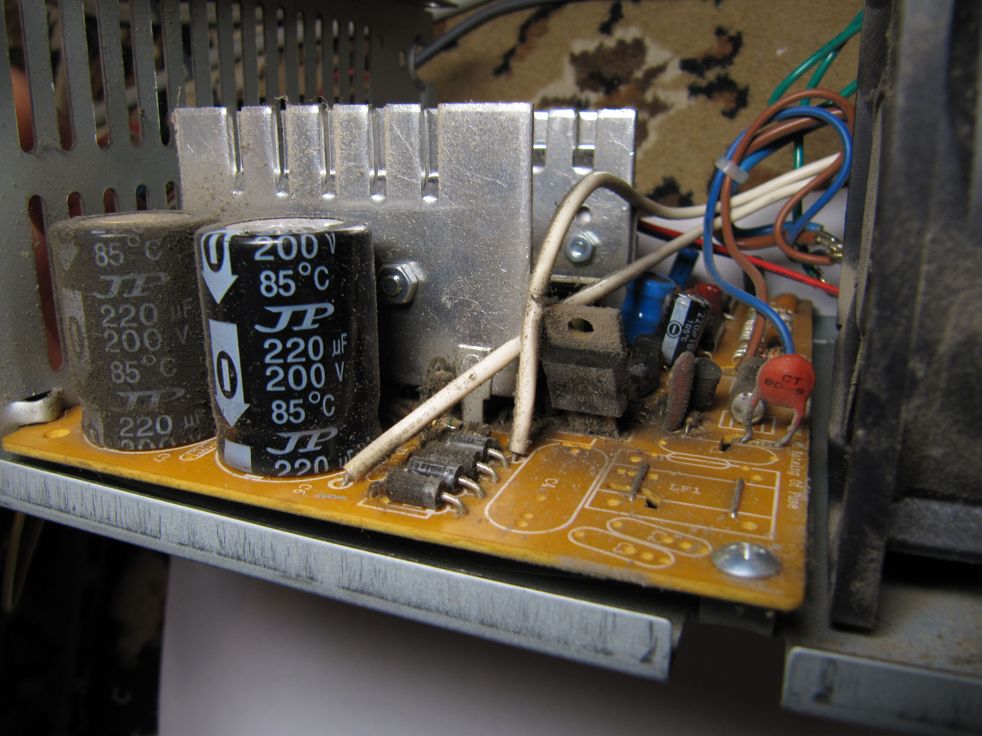

              pan star? geez, i think its time for a new rule:
              ____ (blue, echo, pan, ect.) star= POS that is too light for a paperweight.
              look at all the jumper wire!
              few/small/bad caps
              no x/y caps
              no choke
              wimpy heatsinks
              4 diodes
              tiny primary caps
              thin wire
              weak silicon
              i bet the metal is so thin that it would make a lousy doorstop.
              sigpic
              • Per Hansson
                • Jul 2005
                • 5895
                • Sweden
                #107
                Yea, secondary side is almost worse
                2 transistor 5vsb circuit
                2 diodes for +12v
                No Pi Filters
                Only one coil
                Only 3x Tiny Tiny capacitors
                goodpsusearch; This PSU is too much work to fix so it becomes reliable
                These two lengthy threads are about fixing PSU's such as yours incase you are interested... (A few pages in...)
                https://www.badcaps.net/forum/showthread.php?t=7193
                https://www.badcaps.net/forum/showthread.php?t=7530
                Or just buy this awsome PSU for 9 bucks and be all set
                https://www.badcaps.net/forum/showthread.php?t=8154
                http://cgi.ebay.com/POWER-SUPPLY-420...item53dd87ad58

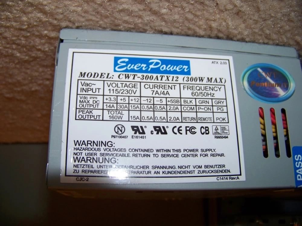

                                Got an old CWT unit, rated for 300w, never used, however this is a VERY old unit, having been built with a -5 rail. It's also filled to the brim with Fuhjyuu capacitors, except for one lone CapXon on the secondary. It does have decently sized heatsinks, and decent fannage as well (some Sunon unit), so it pisses me off to see this kind of penny pinching. My question is, is it worth the effort to recap it?
                                Last edited by Per Hansson; 03-03-2019, 10:40 AM. Reason: Offsite images uploaded & links fixed
                                • goodpsusearch
                                  • Oct 2009
                                  • 2848
                                  • Greece
                                  #116
                                  I would recap it and keep it. It seems well built.

                                    Look in that Blue label CWT (Channel Well Technology).
                                    The builders of the original Antec supplies bad caps but decent supplies.
                                    • Toasty
                                      • Jul 2007
                                      • 4171
                                      #118
                                      If you have a use for it, then recap it. If not, put it in the archive and recap it if you find a need. Check the voltages so you know -now- if there's a problem.
                                      >>... never used ...<<
                                      Umm..., I think the inside of the cover tells a different story...

                                          It did sit for a while gathering dust, but may have been lightly used. Obviously not for long, as those Fuhjyuu caps haven't puked their guts out. :P
