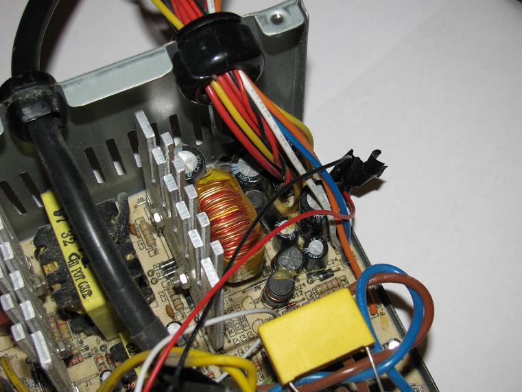

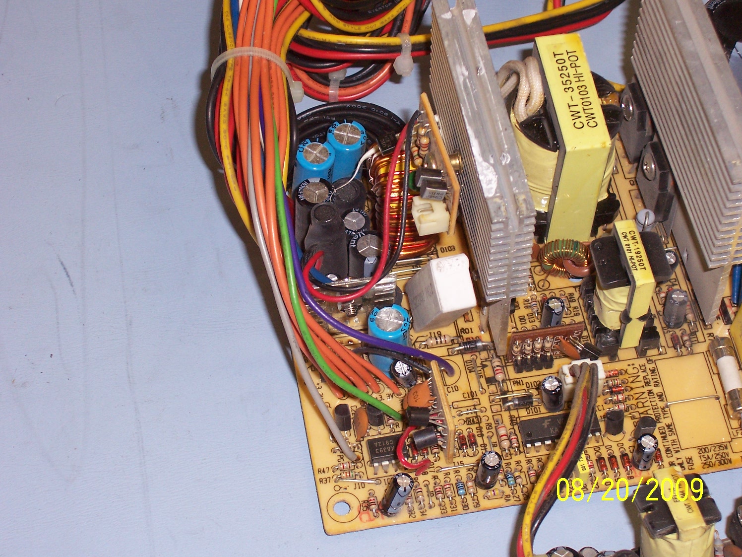

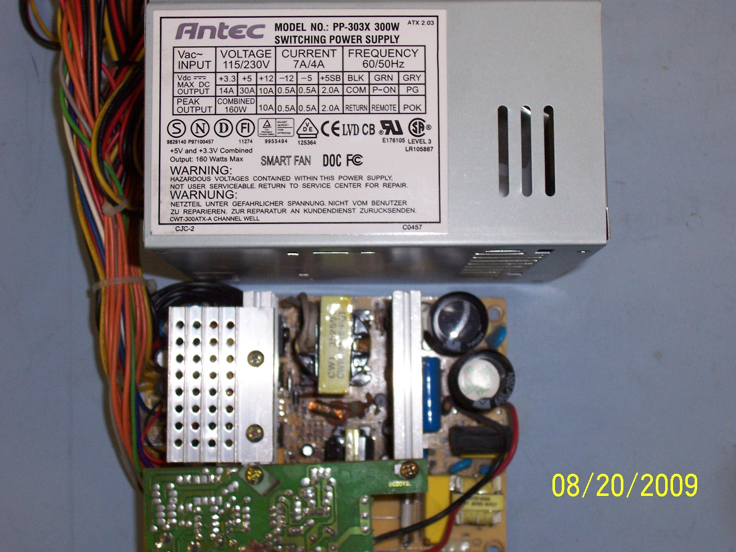

          BACK TO MORE PICTURES................................
          Antec PP-303X...............looks like an AT power supply retrofitted with a piggyback 5vsb pc board. Transformers are labeled with CWT - so I guess it was subcontracted to them.
          Old proverb say.........If you shoot at nothing, you will hit nothing (George Henry 10-14-11)
          • 370forlife
            Large Marge
            • Aug 2008
            • 3112
            Also the CWT-300 blah blah blah Channel well at the bottom of the label kind of gives it away.

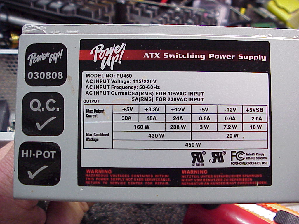

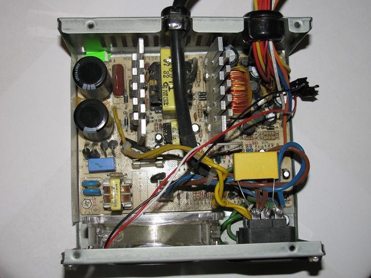

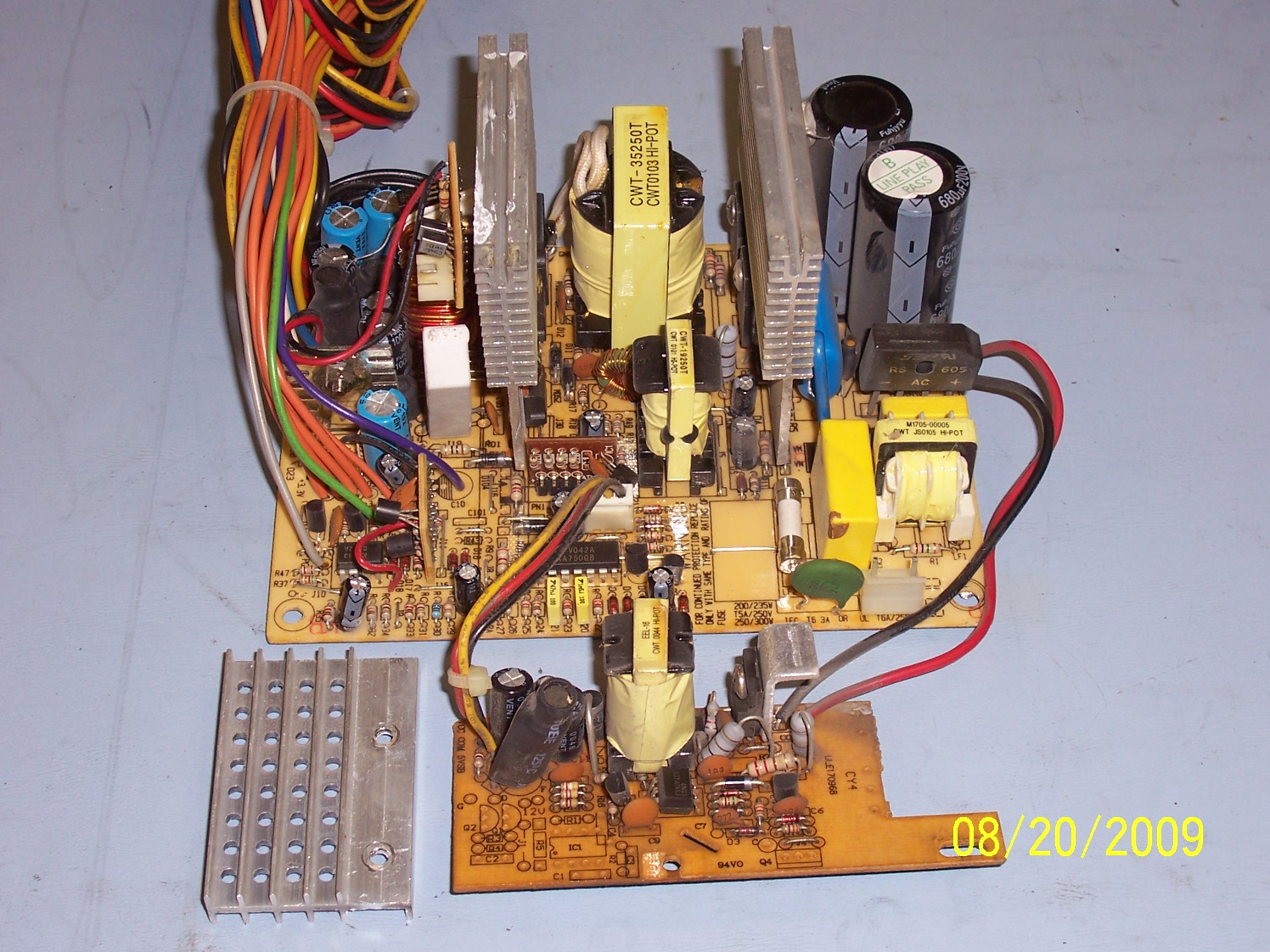

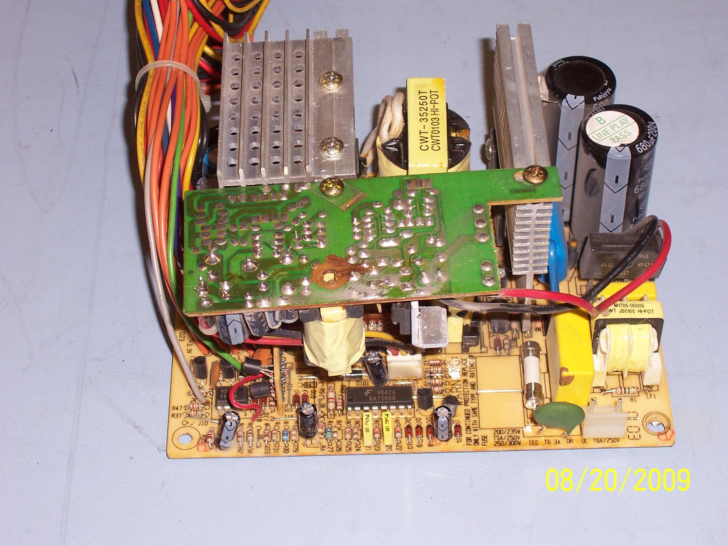

              power up! pu450
              looks gutless for a 450w.
              note missing parts.
              oem is wintech by the e178678 ul number.
              with the missing line parts that fcc stamp is forged too.
              • Newbie2
                • Sep 2005
                • 885
                Originally posted by kc8adu
                power up! pu450
                note missing parts.
                In my opinion that actually looks like a decent power supply. Just add the input coil and two X caps that it has places for on the PCB, along with a recap, and it should be a reliable power supply for a lower-end computer with a Celeron Dual-Core or Athlon II X2 processor (if it had the 24-pin ATX connector).
                It doesn't look like a 450W power supply, but it isn't a bad power supply.

                          even though it looks ok as in no blown caps,ect it would not run my neighbors e2200 dualcore box reliably.hangs and bsod were several times a day.
                          i put a bestec 300 in it that i recapped.
                          that was 4 days ago.it has been on since with no issues.
                          this unit is a pile of shit.

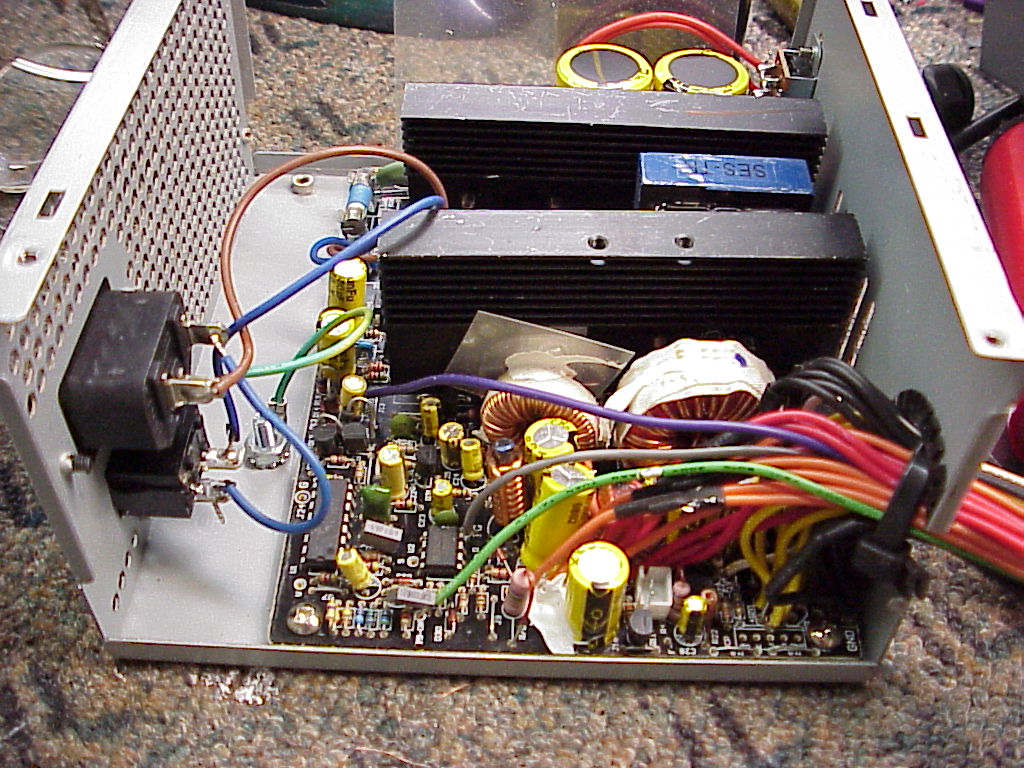

                                  AGI BPS 2504-4U 250W AT power supply
                                  I just recapped this one (got to school a week before class and I have nothing better to do)
                                  Before the recap overhead shot:
                                  Before the recap secondary side:
                                  Picture of the new caps (and the ones they replaced):
                                  The cap replacements were:
                                  +5v:
                                  2x JPCE-TUR 2200uF @ 10v -> 2x Nichicon HE 5600uF @ 10v
                                  +12v
                                  JPCE-TUR 2200uF @ 16v -> Nichicon HE 3900uF @ 16v
                                  -5v & -12v
                                  each 1x JPCE-TUR 470uF @ 16v -> Panasonic FM 680uF @ 16v
                                  Line Filter:
                                  Empty X spot -> 0.068uF X2 that I found in my basement
                                  Primaries are NCC SMG 470uF @ 200v
                                  After the recap secondary side:
                                  Overhead view after the recap:
                                  Pretty good little psu, I use it for testing things mostly. Years and years ago I replaced the fan. I wasn't having any problems with it, I was just bored and decided I could use the practice.
