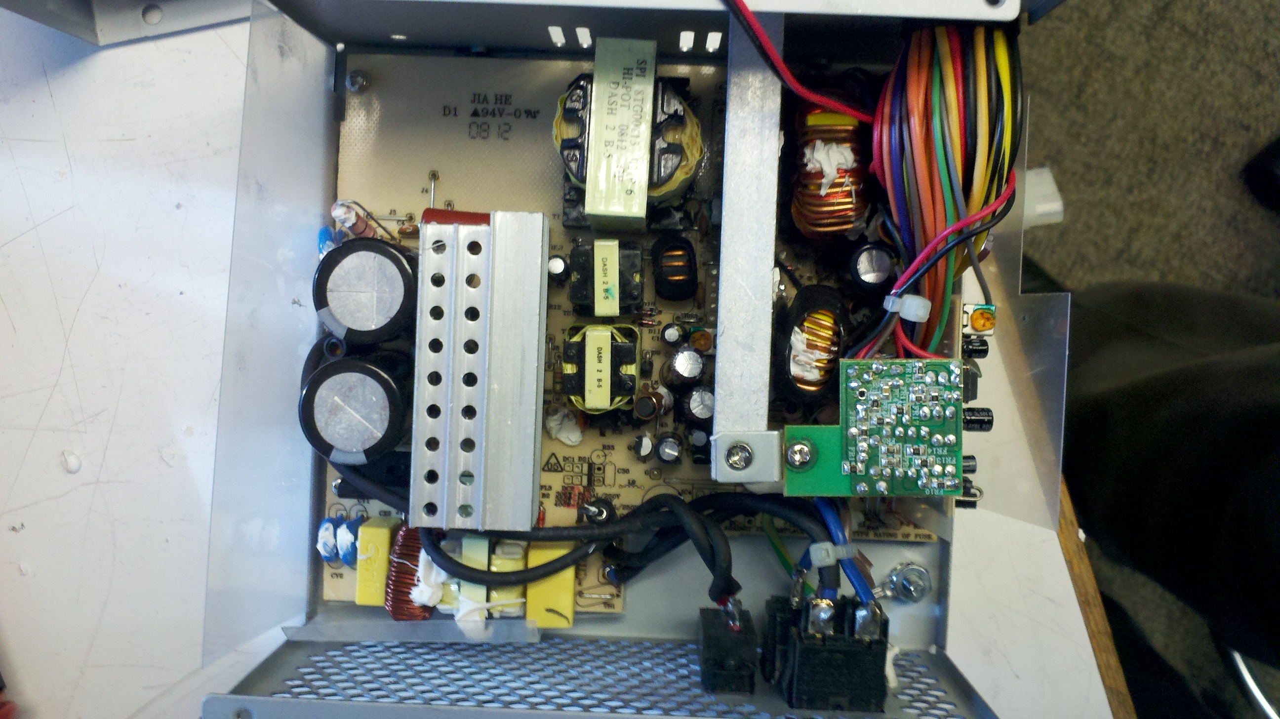

        Really disappointed with these Sparkle power supplies. It only had a 220uF 16V OST cap and a 2200uF 16V Teapo cap for 12V filtering so I replaced the 220 with a 470 and the 2200 with a 3300. Still doesn't seem like it'd be enough for 264W of continuous 12V. This one I just recapped and the thing looks great but it sends out 12.8V on the 12V, the other rails are perfect. I had another Sparkle that was same design but a 350W and the 5VSB failed, I recapped it and it started working but sends out exactly 13.00V on the 12V. What the hell is wrong with these stupid things???
          If there's room for an extra 2200uF or 3300uF 16V capacitor on the 12V rail that may help (I would recommend 2 * 2200uF, or 4400uF, as the minimum on the 12V rail). I don't think that 220uF 16V capacitor is for the 12V rail, though. I think it's for the -12V rail to be that small. In any case, something else may be wrong, though I think it's hard to say what. 2200uF/3300uF may be okay for the 12V rail depending on what its rectifier is capable of, though crossloading of any sort may be ill-advised at that point.

            Yeah I forgot to specify, those 2 caps for the +/- 12V. There is room for more caps on the secondary, I can see if they go to the 12V. Do you think that that could possibly lower the 12V reading? And also, the -12V reads high as well at -12.43V

              The 12v should go down once your computer puts some load on the 5v - typical for group regulated power supplies. -12v doesn't matter anymore. It's only used by some obscure SCSI controllers on PCI slots and by the serial or parallel ports which I doubt you use.

                Yep, you're right. I just tested that right before I read your post and once I upped the 5V usage, they both dropped to 12.44V and 12.39V, perfect!!! Oh man, no wonder he was having issues! That thing has a nice sized heatsink though.
