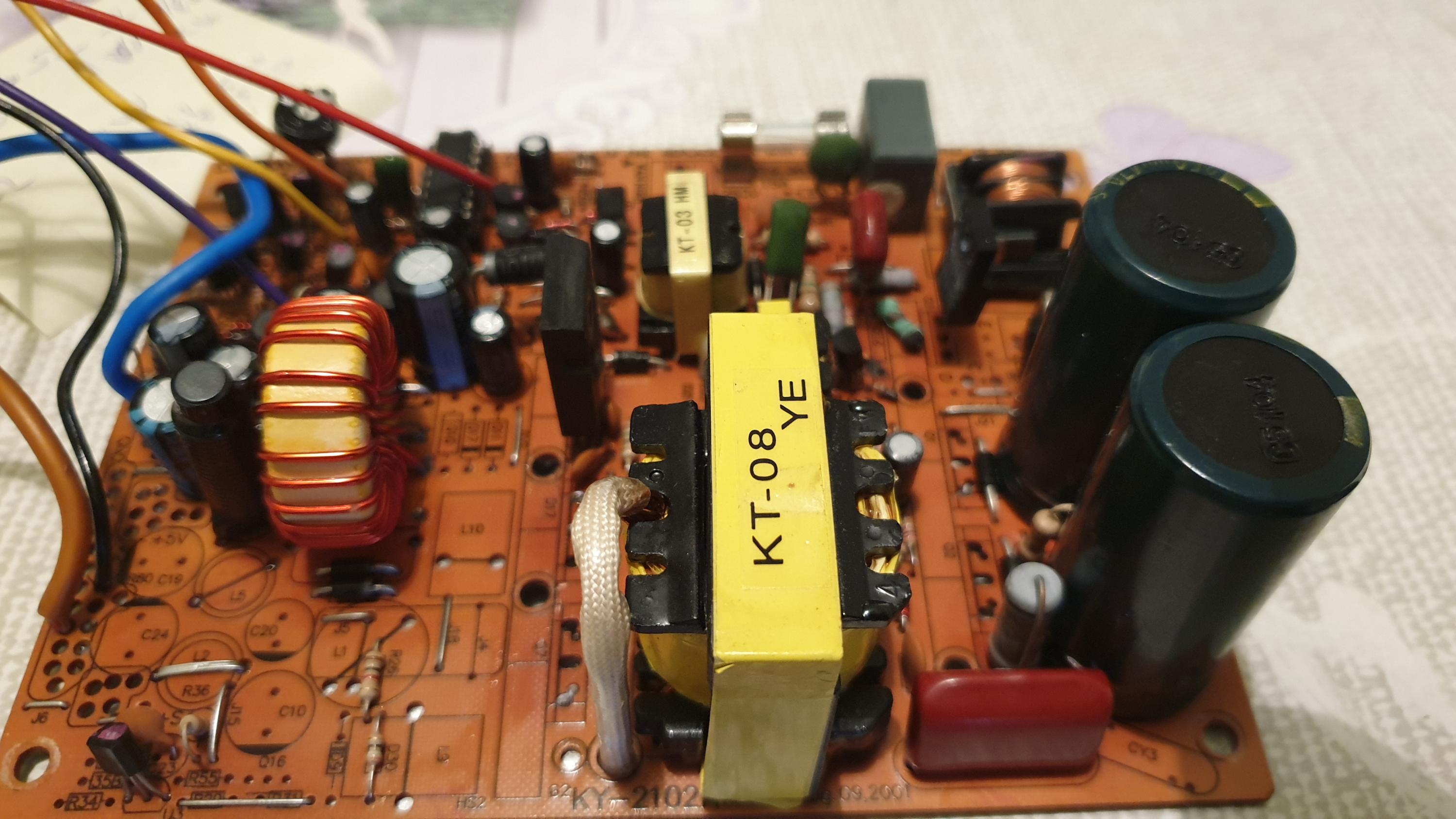

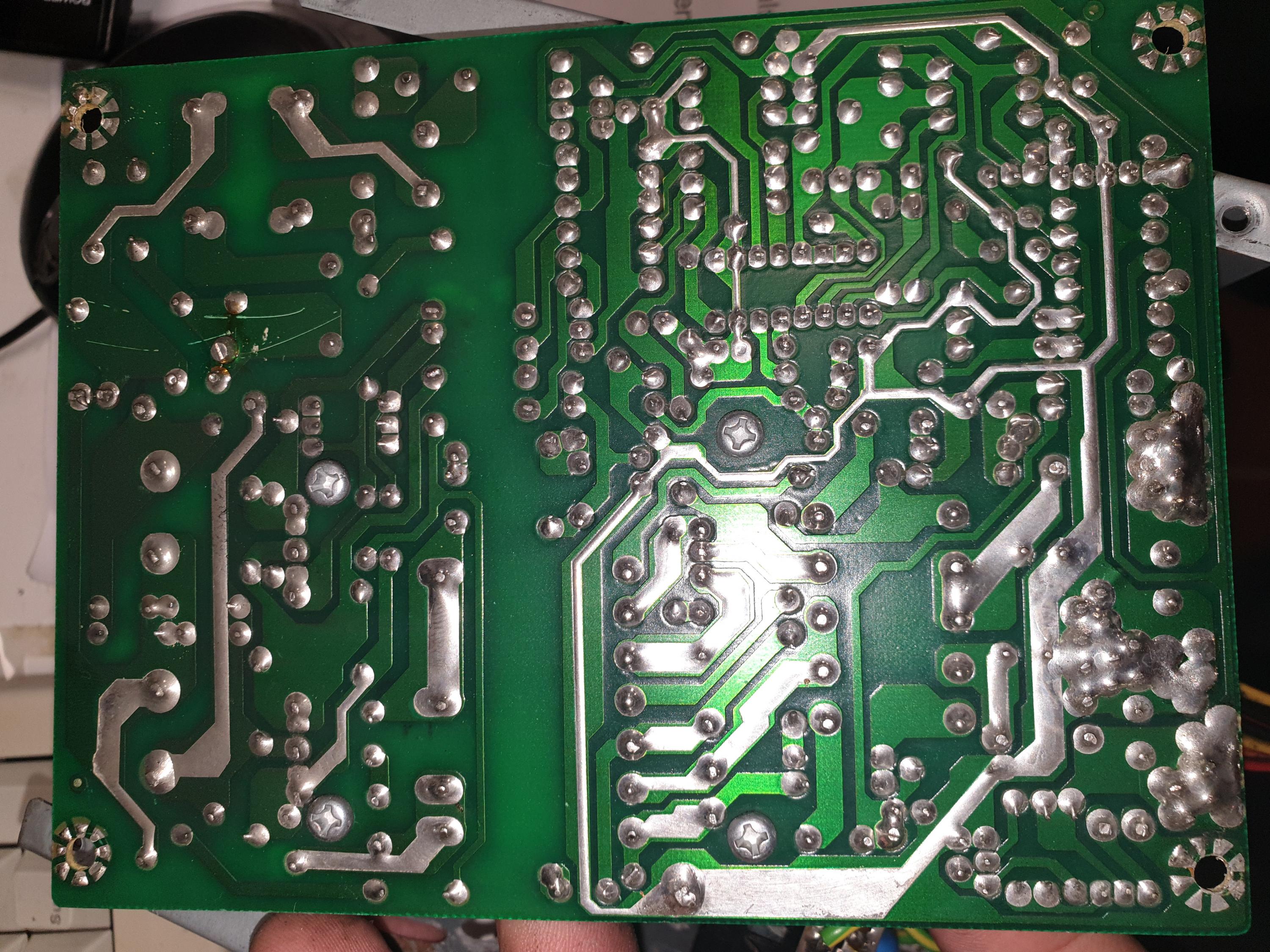

    Hi Guys Im from Croatia hobby player And Im burned my power supply.. im looking for schematic ... because my restors is burned in less then one second..
    board is KY-2102A REV:1.3
    If you can help me with schematic.. pleas.. i need to know values.
    Im apologies for my bad english ..
    thank you in advance

      This is my problem

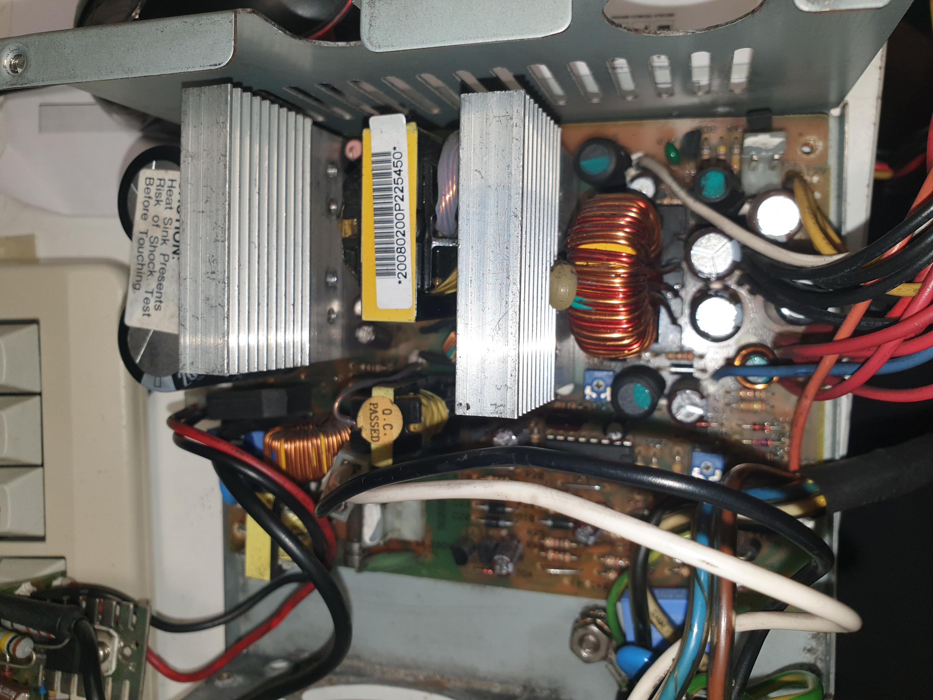

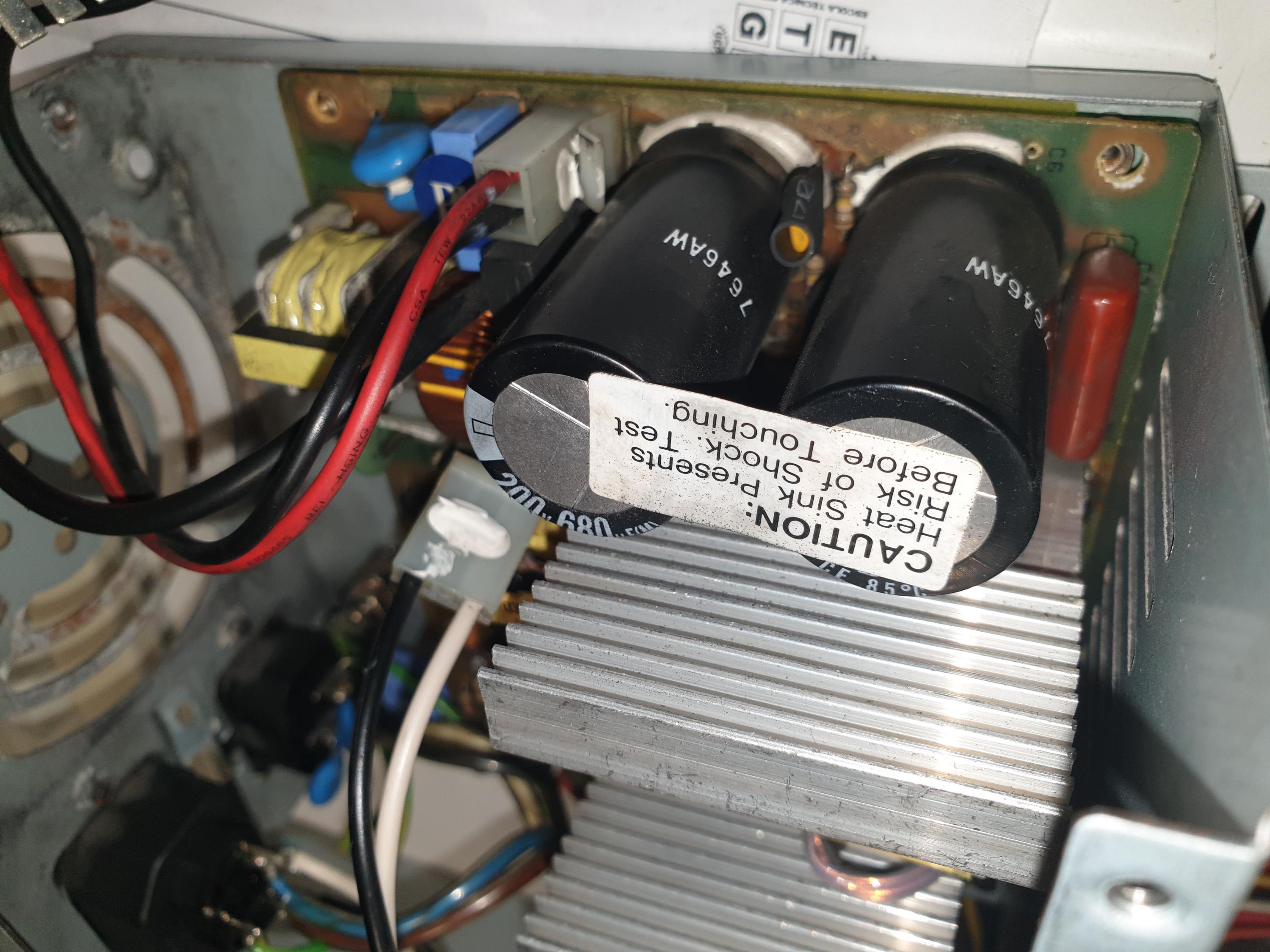

        I bring new photos of another PSU, this time it's from an AT, this is one of the best AT psu I have, it came from an ADLink industrial computer. according to UL, manufactured by ZIPPY TECHNOLOGY CORP.
        Even the fan is of quality, this unit never ceases to amaze me.
        The PSU has more than 50,000h, and still works (according to the smart parameters of the HDD that came from the same computer where the PSU comes from)

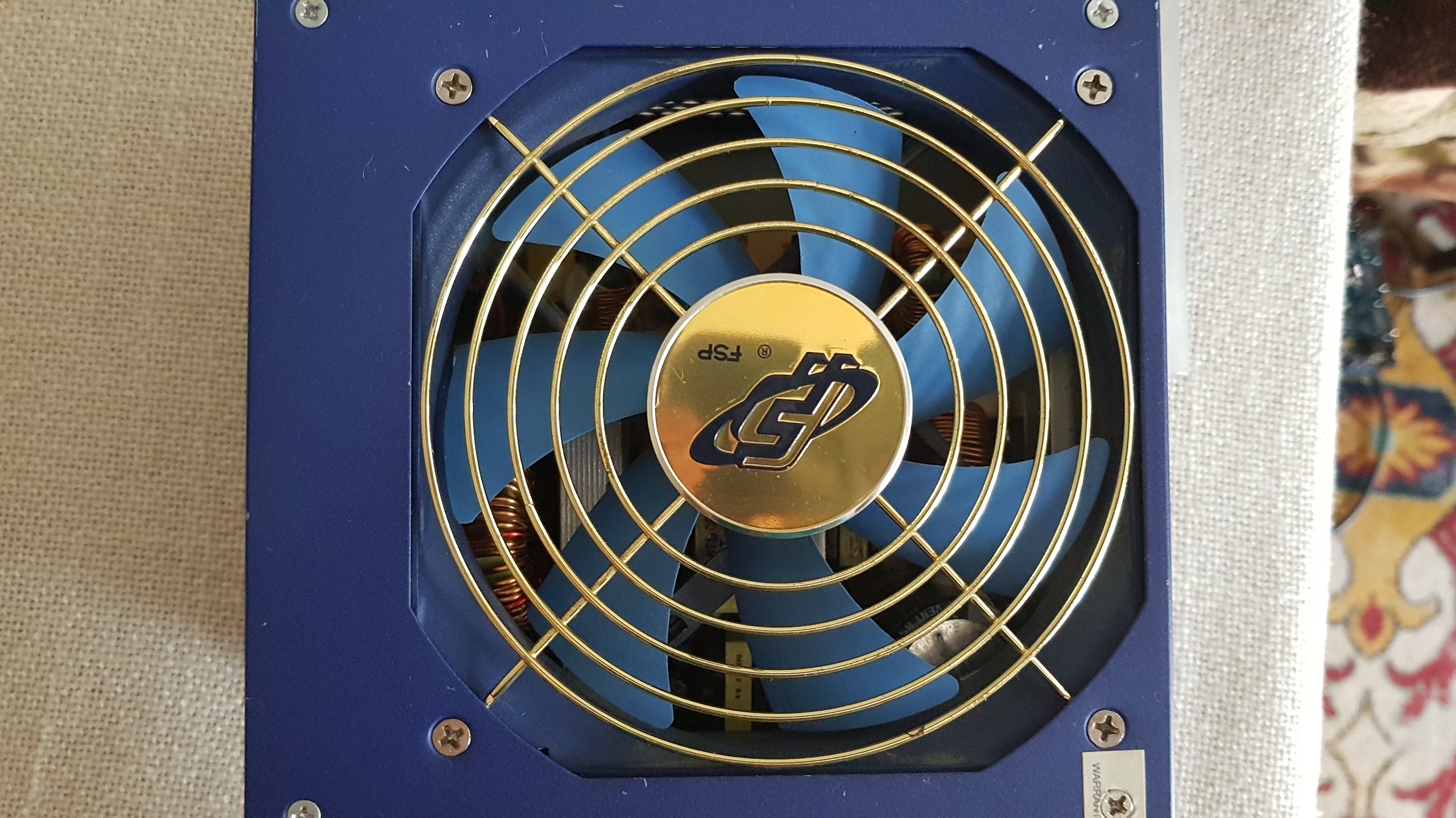

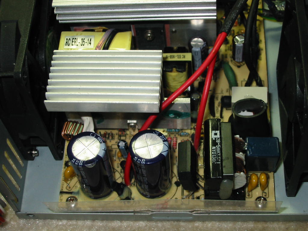

          Okay, might as well post my FSP.
          Here it is, a FSP Bluestorm II 500W I got for $3. Had bulging Capxons in the secondary and 5vsb, althpugh the main cap (420uF 400V) is fine.
          Replaced most caps with what I had on my hand, as well as a few caps from a dead Delta.

            And its a rather late part, end of 2007, so it should be fine and not have the "Material Issue". That's something that happened with this plattform in the 2005/2006 time frame.
            And I doubt there are any left. At least lower wattage ones.

              I haven't seen any GLN/GLY low wattage here. Maybe a 350W PNF about 4-5 years ago but the store that had it has long since closed down.
              Anyways, don't mind the primary cap looking like that. I was suspecting it was bulging when in fact it was the black plastic sheet over it that made it look that way, and I couldn't get it back there.
              Great to hear that the later units (late 2007 onwards) are more reliable. Guess that doing the recap got me safe for another 10-20 years from now on? It's gonna power a Q9400 w/ 4GB DDR3 (planning for either 8 or 16GBs tho) and possibly a R9 270x in the future.
                I doubt you will find a schematic for this particular power supply anywhere on the internet. However, there are several popular "generic" schematics floating around for the old crappy half-bridge PSUs.
                Looking at your pictures, I want to say that power supply really is NOT worth repairing (or only for fun/learning.)
                But if you really are deadset on repairing this, I'd suggest starting a new thread and posting all relevant pictures and information there. From what I can see here based on these pictures, that burned resistors appears to be part of your 5VSB circuit. So do this: plug in the power supply and see what voltage you get between the purple (5VSB wire) and ground (any black wire.) Should get 5V. If not, you have to troubleshoot that 5VSB circuit before anything else in the PSU will work. Speaking of which, that 5VSB circuit appears to be a 2-transistor design, and those are known to go in a puff of smoke when something goes bad, like the electrolytic caps on the output or the "critical" small startup cap (if this PSU has one.)

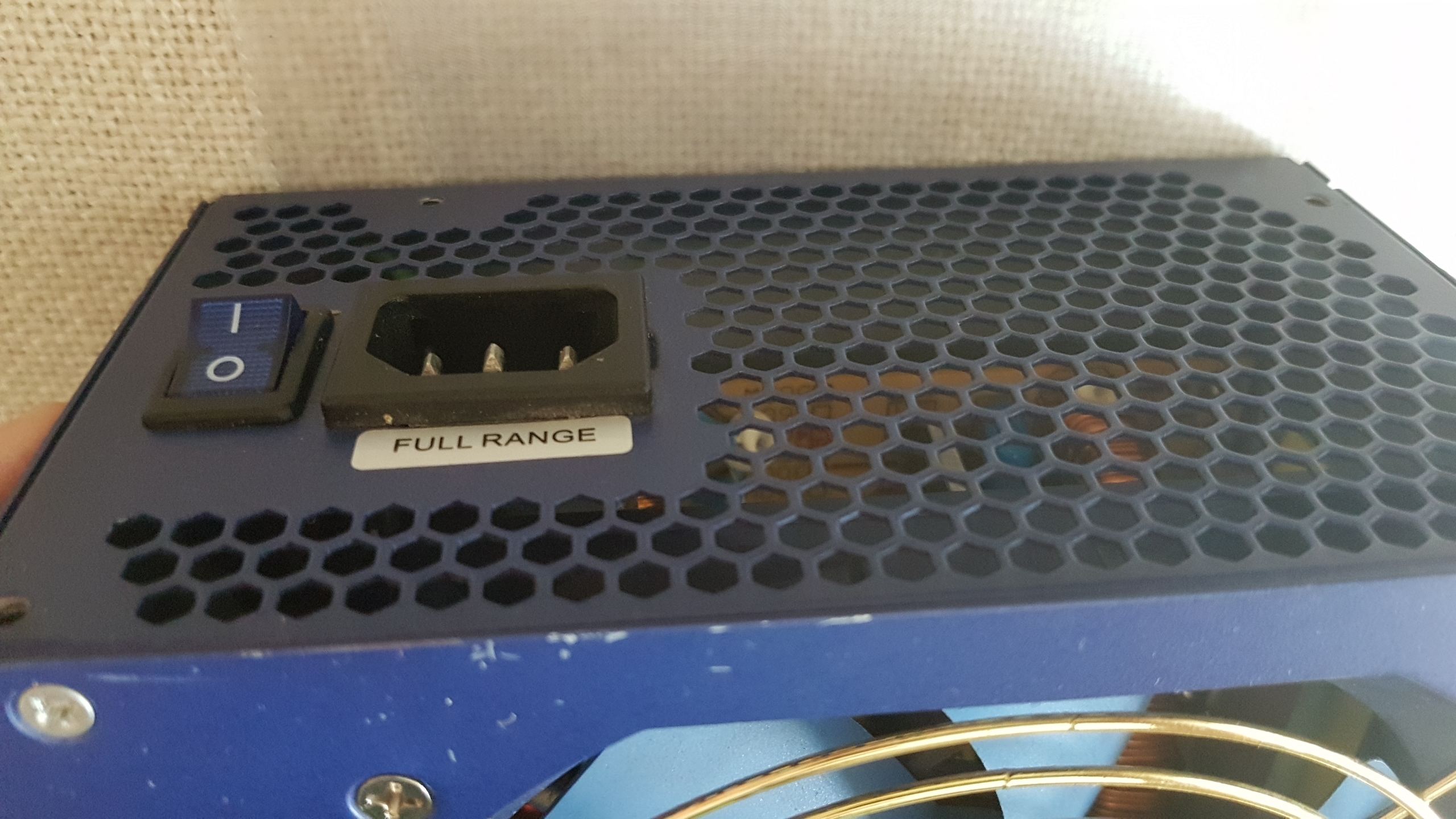

                An eMacs PSU... Yup, those are as solid as a PSU can get: Japanese caps, nice fan, good quality parts throughout, and excellent soldering. But what I like the best: that blue "Pb" sticker, indicating leaded solder and components.
                This was definitely made before the era of RoHS crap and of course would last a very long time.
                I also like the automatic line voltage switch. This is a feature I've only seen before on certain Astec PSUs. On that note, Astec PSUs are of similar quality.
                Very nice deal for $3!!
                Should be a solid PSU with the new caps now.
                Only thing I suggest doing is adding a 2 to 4 uF polypropylene 450V or 630V in parallel with that main CapXon cap. This PP cap will soak up all of the high-frequency crap so that the CrapXon won't have to. Also, in the event that the CapXon primary cap does go bad (it more than likely will eventually, due to APFC), the PP cap should still present enough capacitance to prevent the primary side from blowing up. Otherwise, a blown open primary cap often leads to blown APFC components and sometimes even other ICs behind the APFC.

                  #3048
                  In that detail of the lead solders I had not noticed, you're right, those welds will never break. This PSU is for life .
                  I have an AT case to mount a computer for classic games based on a Pentium MMX, and I will use this great PSU.
                  If I am honest, I did not know the emacs (Zippy) brand, I was very surprised with its construction quality, and I am right, it is at Astec level.

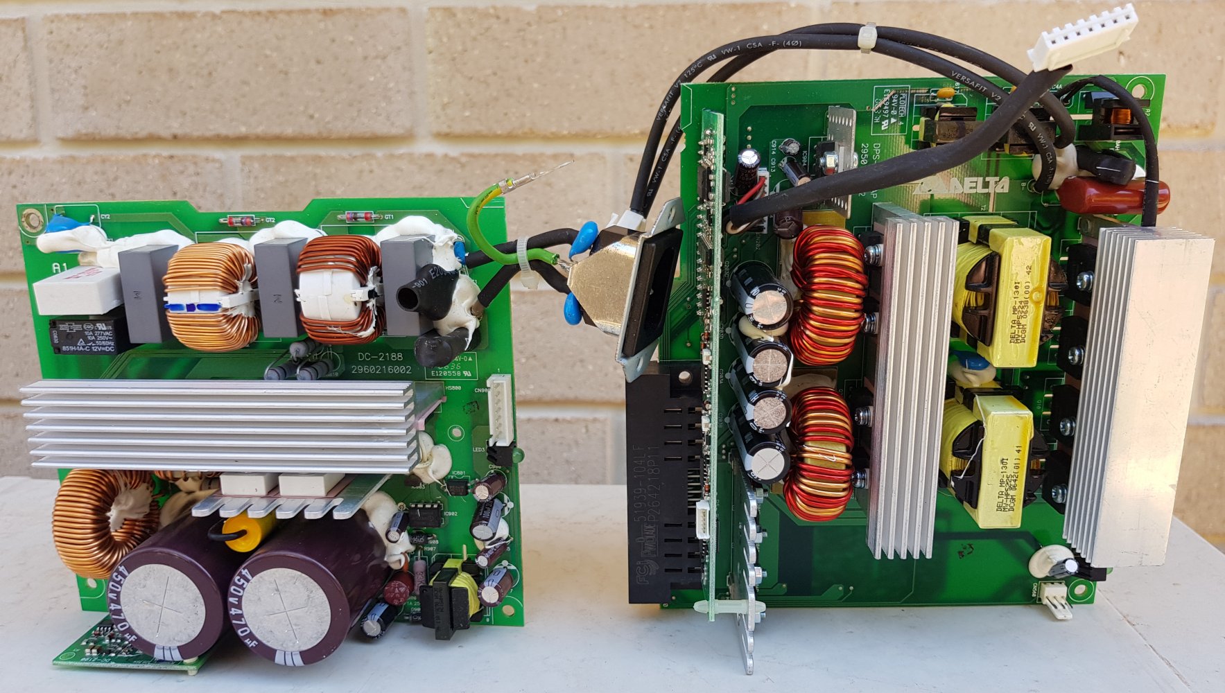

                      Delta DPS-1400AB (IBM part 43X3254)
                      PFC board:
                      Chemi-Con KMM 470uF 450V x2
                      D25XB60 input rectifier
                      20N60 x2 PFC stage
                      RHRP3060 x2 PFC rectifier
                      Main board:
                      20N60 x2 (two sets) main converter
                      IPP054NE8N x4 (two sets) synchronous rectifier
                      3300uF 16V Nichicon HD x4 for 12V filter
                      80NF03L x4 output switching
                      Common to both: All electrolytic capacitors are Japanese units

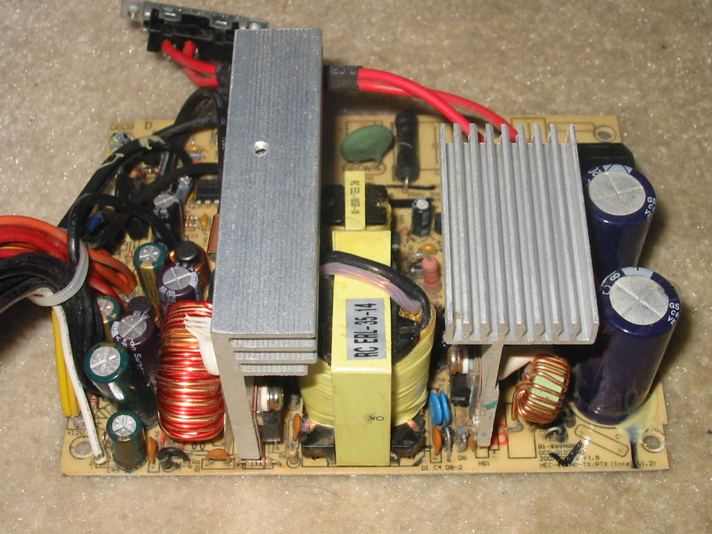

                        HEC Orion HP585D
                        Oh what the HEC! –My turn to post something and hopefully keep this thread alive.
                        I still have a few PSUs on my repair pile that I’ve been trying to reduce over the years (as in, fix stuff). So for today’s post, I have a HEC Orion HP585D. This and its re-labeled versions (namely the ThermalTake TR2-430W a.k.a. XP550-NP) were popular low budget PSUs in the mid-late 2000’s that weren’t actually terrible or gutless wonders.
                        Yes, yes, that 585 Watt rating on the label (along with all of the individual current ratings on the rails) is a complete lie. You might wonder then why I’m posting this in the quality pictorial thread. But it’s the potential that this PSU holds (no pun intended ) is why I post it here. IIRC, HardwareSecrets tested the TR2-430W, and it help up fine all the way to ~350 Watts. Given this HEC PSU is the same exact unit (minus a few small things, which will be noted below), it too will do about 300 Watts continuous and maybe 350W peak. Of that, the 12V rail is limited to about 16-17 Amps – so right inline with most 250-300W OEM PSUs. Don’t believe me? Let’s see some pictures then.
                        Right away, I’m sure someone noticed the missing EMI/RFI filters on the inputs. That and the crap caps used inside this PSU are probably its only downfall. The ThermalTake TR2-430W mentioned above does come with the EMI/RFI filters installed, though (along with better/longer cable selection, sleeved cables, and painted case.) However, if recapped and with proper EMI/RFI filters installed, the HP585D can be a decent 250-Watt PSU. It has good amount of output filtering, adequate heatsinks (for 250-300W anyways), good airflow, and quite fair soldering quality
                        In terms of design, this PSU uses a bog-standard (and highly outdated for ATX PSUs nowadays) UC3843b current-mode PWM IC to drive a single-transistor forward converter circuit. The 5VSB is also very rudimentary, using the well-known 2-transistor self-oscillating 5VSB circuit. And it does have a 10 uF 50V “critical cap” that should be replaced (if anyone is recapping this PSU), even though it rarely fails on this particular PSU model (my TR2-430W is still going strong with all-original caps.) Picture of the primary side:

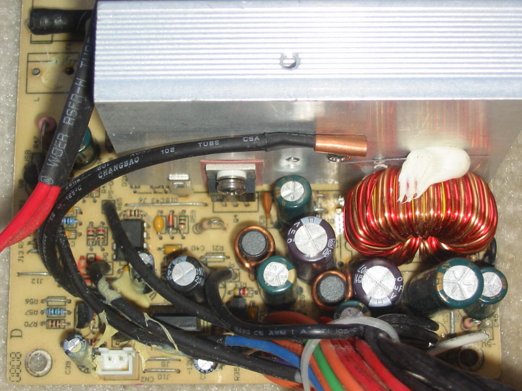

                        As crude as it may be, the primary side for the main PS does have working OPP. I remember reading one review back in the day that repeatedly tried to overload and blow up this PSU, but couldn’t. Every time, the OPP shut down past a certain point (around 350 Watts, if I remember.)
                        Next, we move to the secondary side.
                        https://www.badcaps.net/forum/attach...1&d=1576985654
                        If you wonder why there is only one output toroid, it’s because this PSU uses a MOSFET to generate the 3.3V rail in a linear fashion – hence the lack of a 3.3V toroid and mag-amp circuit. The PSU also has temperature-controlled fans, as evident by the thermistor on the secondary heatsink. On that note, the two fans are Young Lin Tech model DFS802012M, rated for 12V and 2 Watts. Caps, of course, are not Japanese - just a mix of Su’scon and Teapo, which isn’t that terrible, IMO. They usually tend to last a decent amount in this PSU model. All protections for the main PS are handled by a TPS3510 supervisory IC. Although this IC does not offer OCP, I think HEC might have implemented OCP on the 12V rail, as there is a jumper/shunt before the 12V wires (it’s not well visible in my pictures above).

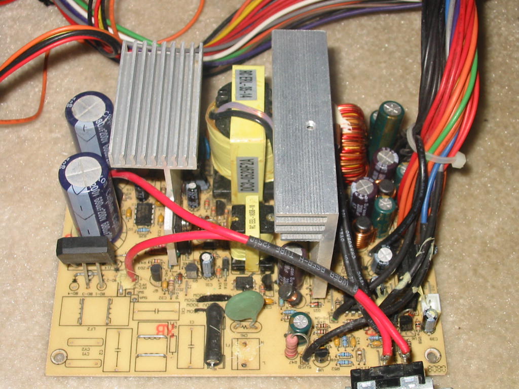

                        Finally, the soldering:
                        It’s OK – no major gobs of solder or leads that are too long. The PCB tracks are laid out well and have the proper separation between primary and secondary side. So despite looking like a cheap PSU with over-blown label and missing EMI/RFI components, it has a pretty reliable design. With good caps, it makes for a decent test/low-power PSU.

                                  HEC Orion HP585D – improved v1
                                  And here we go: I made some basic improvements to this PSU with mostly scrapped parts I had on hand. The first item on that list, of course, was the missing EMI/RFI filter, which is no longer missing. Now this PSU has the following EMI/RFI components:
                                  - 1x 0.33 uF X2-class cap across L-N lines (in parallel with a 470-KOhm resistor) after the main fuse
                                  - 1x small common-mode choke (not sure what inductance, but possibly around 1 mH)
                                  - 1x 0.47 uF X2-class cap across L-N
                                  - 1x 5 mH common-mode choke
                                  - 3x 2.2 nF Y2-class caps (L to GND, N to GND, and negative bus to GND.)
                                  The 0.33 uF X2 cap came from a discarded dead PSU. The small CM choke came from another ATX PSU that originally had this soldered to the receptacle plug in such a way that I couldn’t get the PSU apart. So it had to come off, and I never put it back on, due to that PSU already having enough filtering. The 0.47 uF X2 cap came from a dead Sony PS3 PSU (Nichicon-made). And finally the 5 mH CM choke came from a mashed Samsung CRT TV PSU board (curbside find - someone busted the TV to get the copper coils out of it.) Only the Y2 caps are new parts. I grabbed these a while back for some other PSUs, though (a bag of QTY 10x for better price break.)
                                  Up next was the 5VSB circuit. I changed the 10 uF, 50V Suscon SK critical cap for a Panasonic FC of same voltage and capacitance. That Suscon SK cap was still in spec, measuring 3.6 Ohms ESR, which is not bad for a small 5x11 mm cap. The second output cap on the 5VSB – originally a Teapo SC, 16V, 330 uF, 8x12 mm – was also replaced, as I like to have at least one quality cap on my 5VSB outputs. It was still in spec, too. I used a 6.3V, 1000 uF Chemicon KY cap in 8 mm dia. (Note: this second 5VSB cap spot has hole for both 8 mm and 10 mm diameter caps, and both will fit. So keep that in mind if recapping this PSU, as it gives you more choices.) Finally, I also changed the 5VSB minimum load resistor (R47) from 27-Ohm 2-Watt to 47-Ohm, 2-Watt. This cut down on the 5VSB idle power consumption from the wall by an entire 1 Watt (from ~4.5 Watts originally to 3.5-3.7 Watts afterwards.)
                                  The last thing on my list was I filled the empty 8 mm cap spot on the 12V rail with a Chemicon KZE 16V, 680 uF cap. I figured this should help lower the output ripple on the 12V rail a bit and also serve as a warranty of sorts, should the 2200 uF Teapo SC decide to fail.
                                  And that completes all the improvements/modding I did to this PSU. Ideally, I should have done a full recap on it. But I am saving my caps for other PSUs I have on my repair pile for the time being. When I order more caps eventually, I may come back to this PSU and recap it. For now, though, that is all. Here are some pictures of the work.
